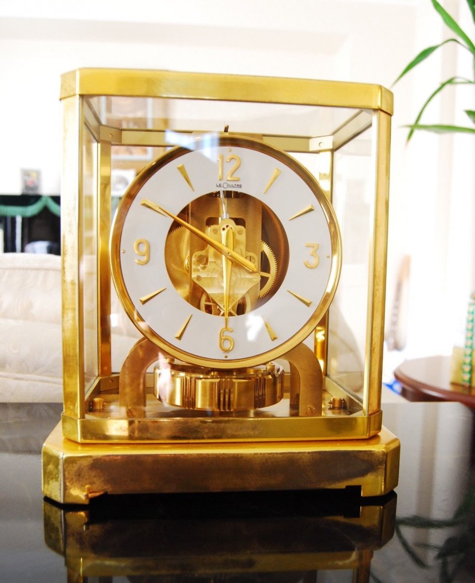

    Im not normally into clocks but the JLC Atmos is something rather unique and special being what it is. There are numerous cheap (sub $1000) two hand variants on eBay that all seem serviceable but I'm wondering a few things:
    Are these cool enough to be worth owning?
    Are they reasonably accurate enough long term?
    Are they a big risk of damage in shipping?
    Are they expensive to maintain or difficult to find a clockmaker to work on them?
    Do they turn off watchmakers as much as normal clicks do (Archer is one among many who avoids them in part due to the hazards involved but I'm wondering if the mainsprings are less meat mulching than normal clocks)?

    I have always been fascinated by these Atmos clocks. I find that they have a lot of class and I plan on getting one as soon as I settle down.
    I recently inquired about the transport issue and was told that there is a clasp/lever at the bottom to protect the clock during transport. The clock was originally sold with a cary case and if you're lucky you can get one that comes with this original box. As you stated there are many variations and taste is dependant.

    Yes they have a lever on the bottom which locks the whole mechanism in place for transporting. They are supposed to be very sensitive to movement so must always be well packed when sending in the post.
    The older models provide incredible value for what you get, considering the new ones in the JLC boutiques look practically the same.
    If looking at getting one I would definitely go for one which has been recently serviced as I understand that repairs on these cost an arm or maybe leg. There are a few eBay sellers which specialise in Atmos clocks.

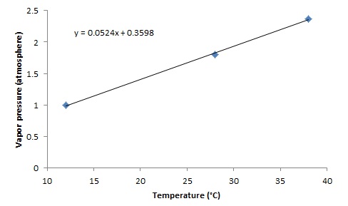

    It is the variations of temperature that causes the bellows to expand/contract, not pressure. Wikipedia.

    In fact atmospheric pressure variation is minor contributor to winding the clock. I pasted a graph of variations of vapor pressure versus temperature of the gas in the Atmos bellows (ethyl chloride). We see that the slope of that curve is 0.0524, meaning the pressure exerted inside the bellows varies by 5% for each degree of change of temperature. Assuming that a typical household has variation of 3 degrees Celsius within a day then pressure varies by 15%. Atmospheric pressure rarely varies more than 1% within a day, so we see that it has little influence on winding the clock. Here are other links here and here on the workings of the clock.
