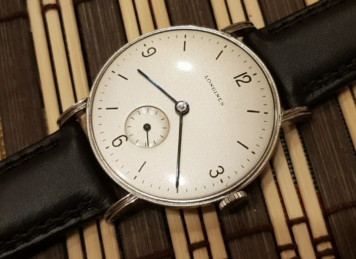

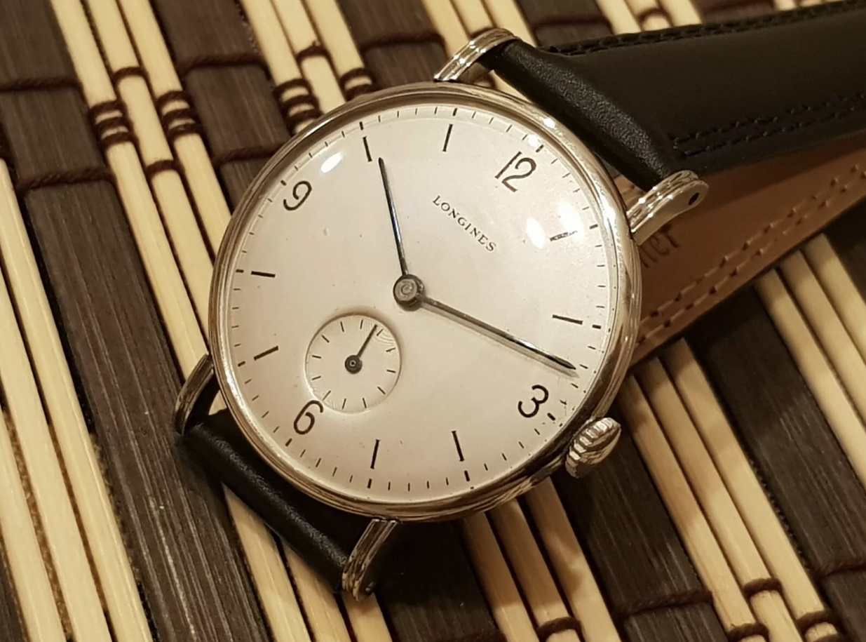

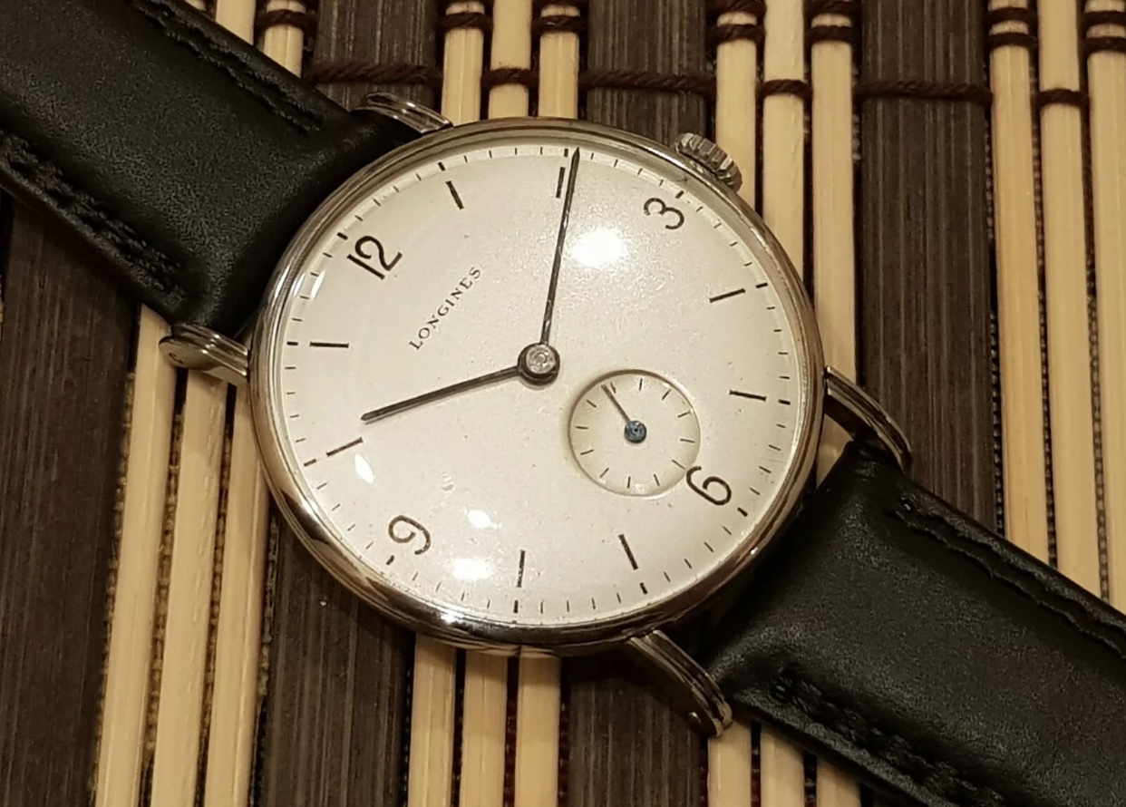

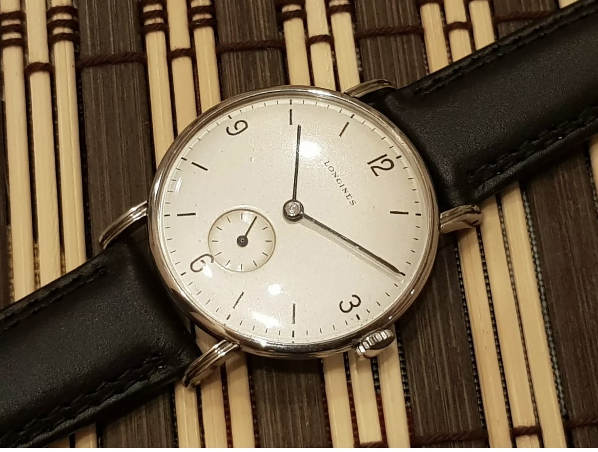

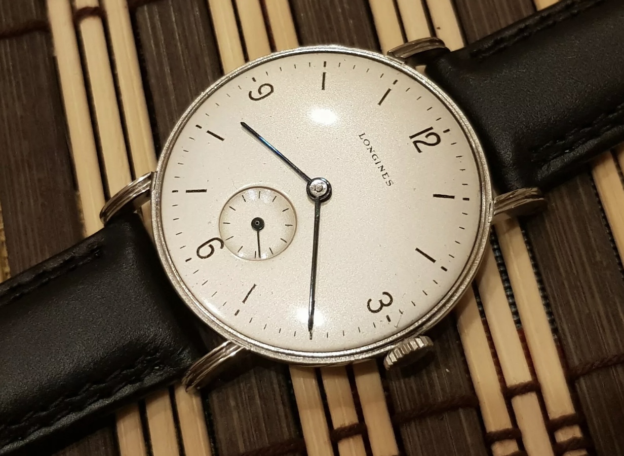

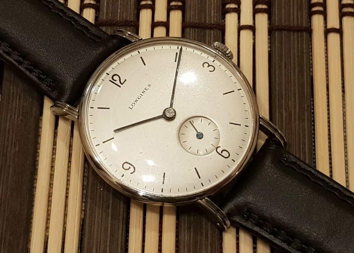

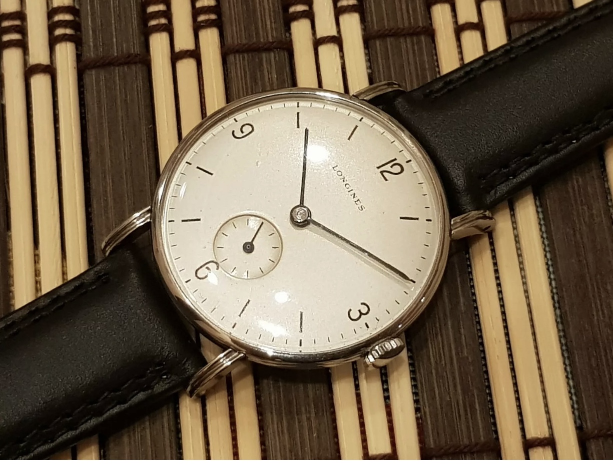

If you’re braver than me, this might be worth a shot. Seller out of Hungary with not a lot of feedback. I can’t tell if the dial is legit or not, something about the Longines font looks off (maybe?). But the subdial edges look sharp and I can see ridges. Price is right to go fishing if you’re a gambler.

1. It is a redial.

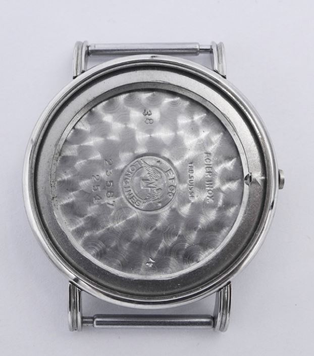

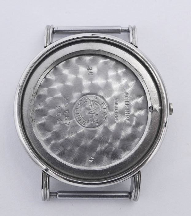

2. The movement serial number dates the watch to the mid-late 1950's however the case-back markings suggest a watch from the late 1940's. I suspect a franken.

1. It is a redial.
Thank you. Later Longines are my focus, so I don’t know these earlier references as well.
Good example of go with your gut. If it feels wrong, it probably is.
1,155
592
I was about to post that I feel like it's a redial as well. For such an old watch that dial is far too clean and new-ish looking.
7,689
22,049
Clean and newish looking is not synonymous with redial. This one has uneven indexes, a subdial presenting tell tale signs, and the logo font is wrong.

Like-new clean dials of vintage watches are very rare and most of the time we're just talking about redials.
Also, keep in mind that we're talking about a watch that is approx. 70 years old. The chances of finding such a watch with the original factory clean dial are very slim and even then, most often the paint won't be white as chalk.
I didn't say that a clean dial means a redial all the time so please keep your assumptions to yourself if you woke up on the wrong side of the bed.

It looks like a redial to me as well. Sparkly-looking, uneven paint surface, sloppy printing on the "2" in the 12, rounded edges at the sub-seconds recess, pretty sloppy 9 also. It just screams redial. Everyone is entitled to their opinion. I would not personally spend money on this one, or too much time thinking about it either. There are too many beautiful, original dials out there to look at.
