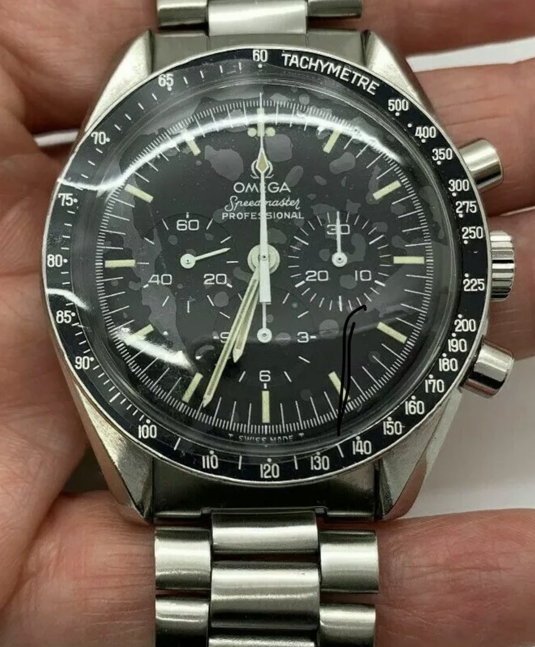

The end pieces of the bracelet look uncommon.

Yeah, the end link not pictured is a correct 633. The one you see in this picture is obviously not correct. The 1171 bracelet it came with is pretty stretched. I have already put it on a NATO strap.

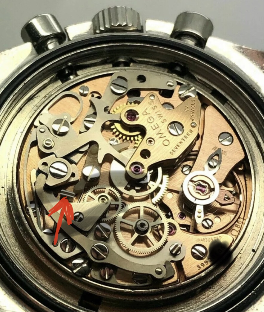

It just sounds like your coupling yoke part 1724 isn’t sliding across properly.
Pretty common problem.
Maybe it needs a little grease or the screw releasing slightly?
Also part 1724 might not be sliding over enough, the concentric screw might need adjusting so it slides over a bit more, be careful and adjust it a tiny bit at a time.
