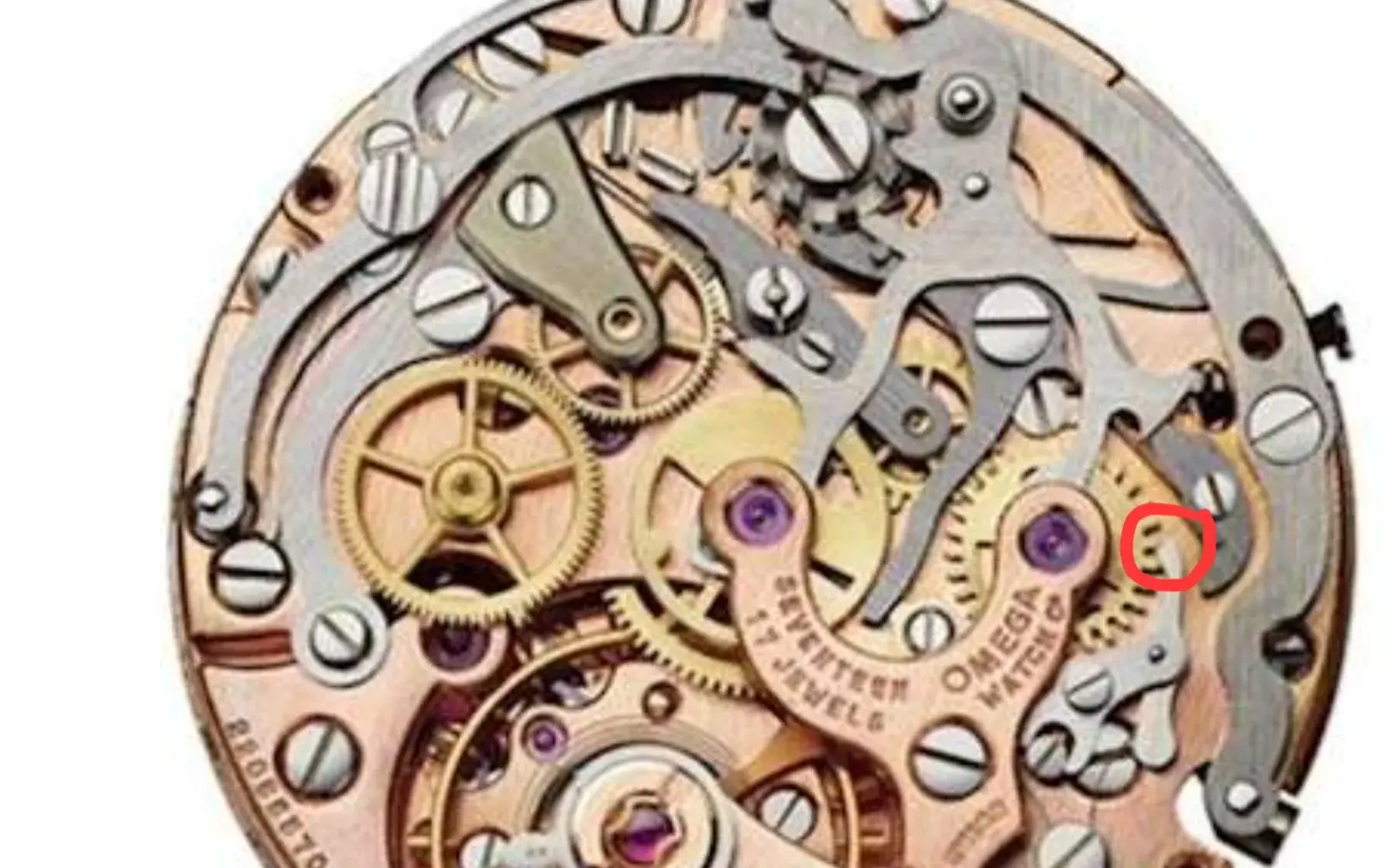

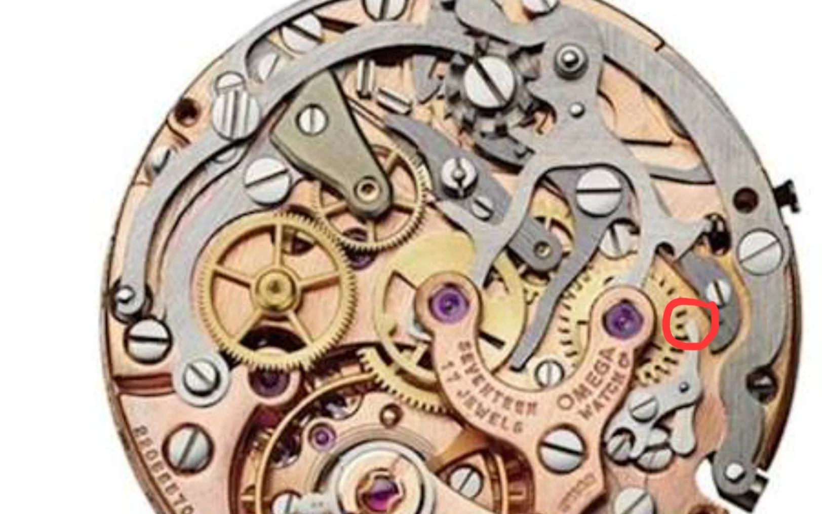

start the chrono and than look at the movement, what
happens after 56, 57, 58 seconds
i descriped / asumed what could be the problem
look at the minutecounter wheel lock
353
1,081
and of course - generelly:
if/after the second hand stopped, as you descriped - you have to
use first the chrono stop pusher and than the chrono reset pusher
