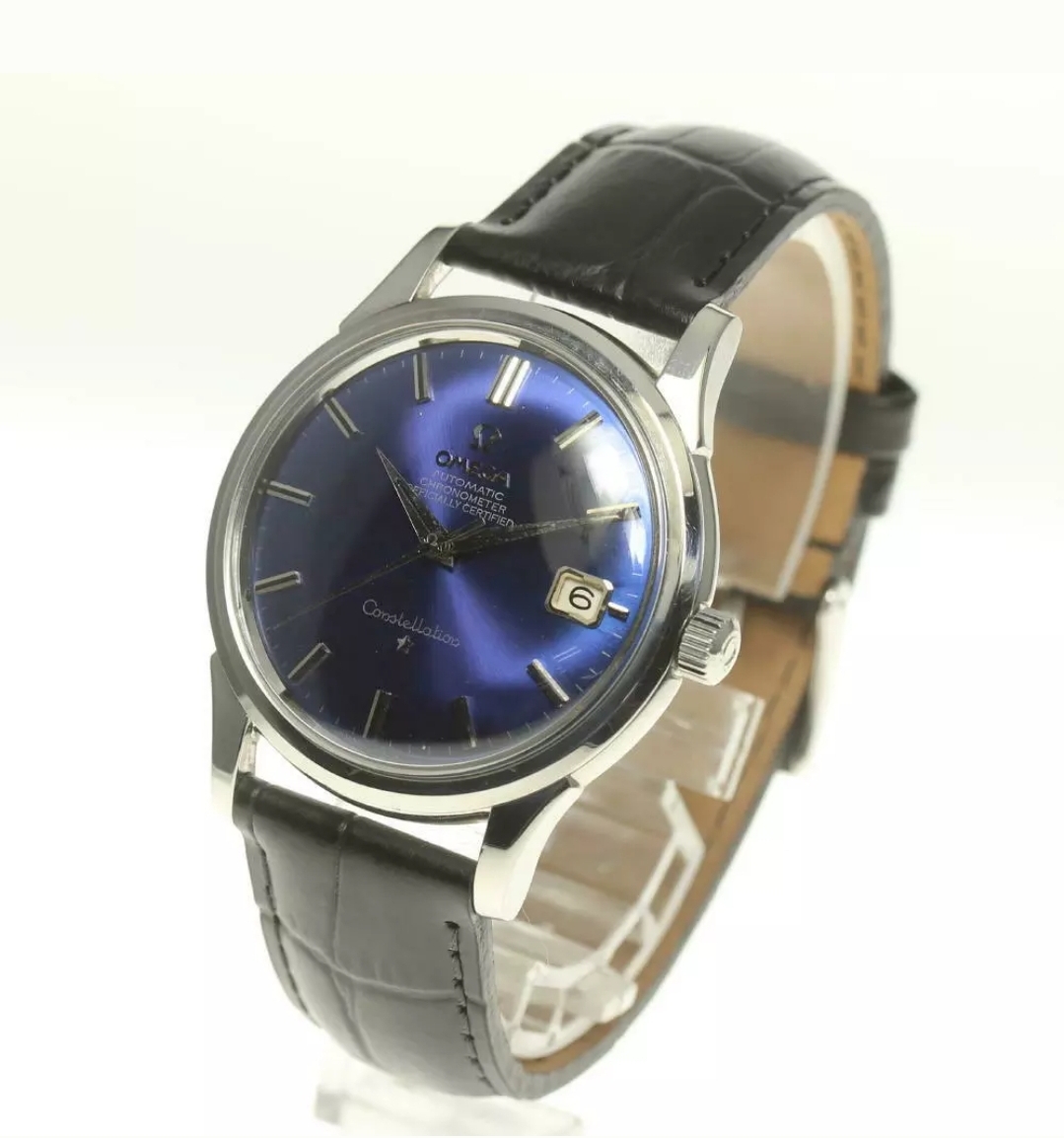

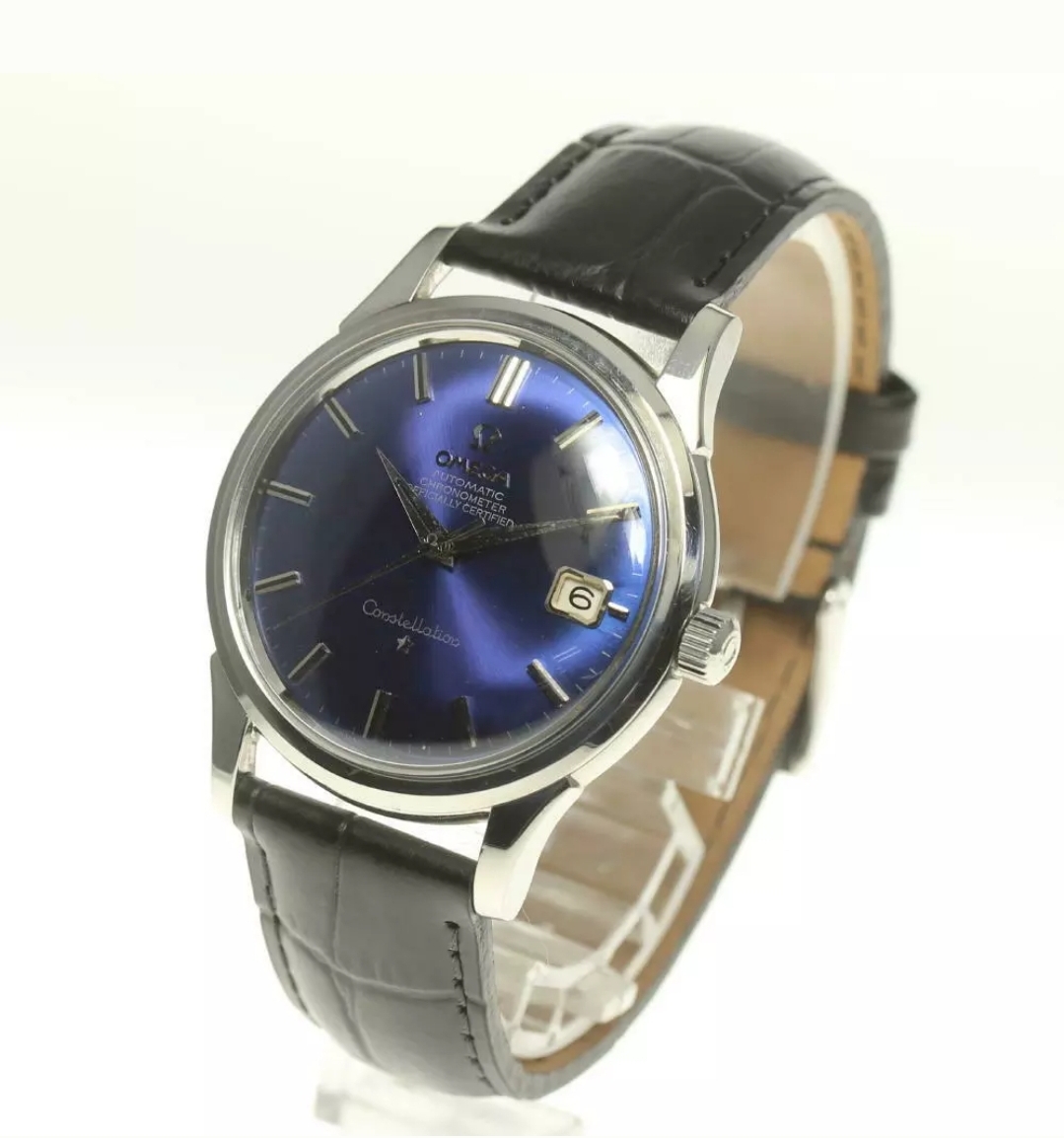

Never saw one like this. Looks original. What do you think? Redial or legit?
5,026
18,608
I cannot imagine that it isn't a redial.

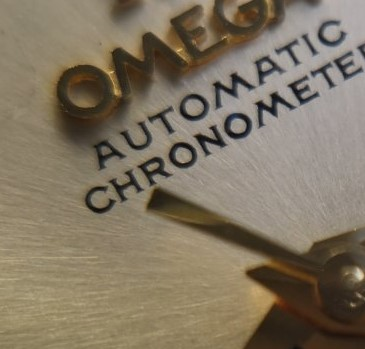

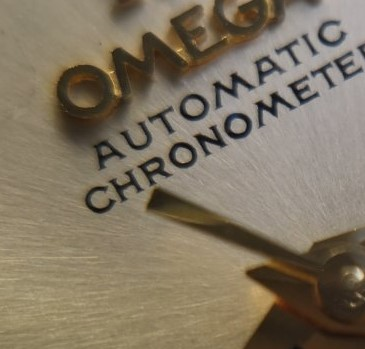

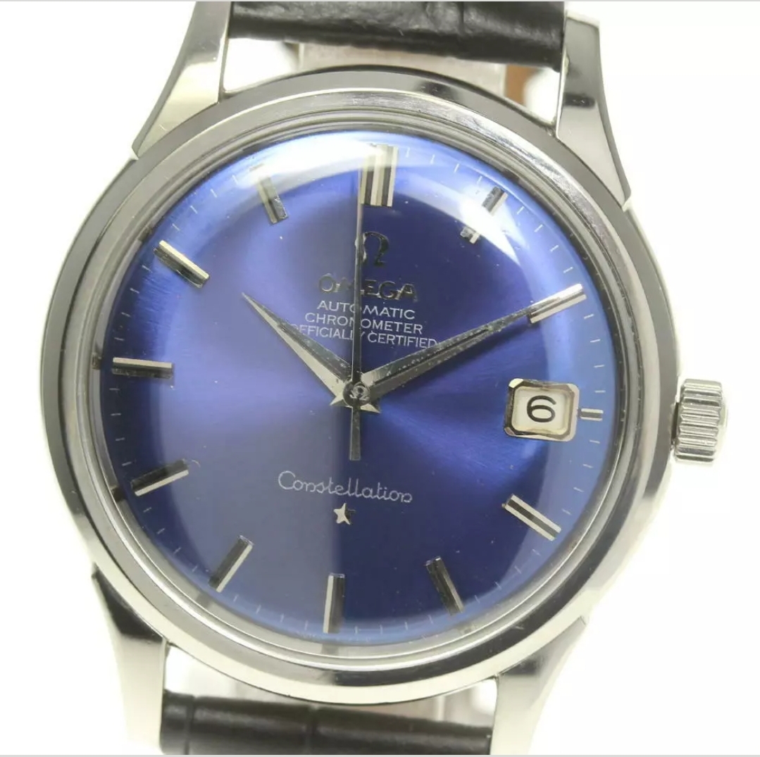

Yes. I agree. But the second picture made me think it could be original. The text and minute markers looks to be fading. My explanation was this can only be done by time.
9,588
27,706
I think it is due to less-than perfect application.
The overall condition of the item with the slightly moisture damaged hands, polished case and wrong crown doesn't gel with a perfect dial, especially since it is in a colour tone I have never seen on a vintage Omega.

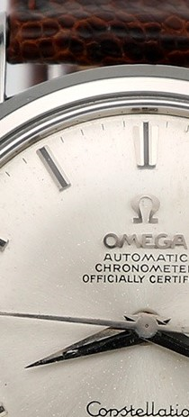

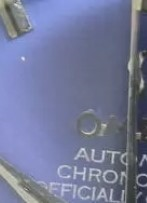

You have a few of the jumbos, right? Could you do a font comparison?
2,298
3,157

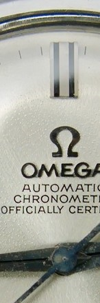

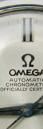

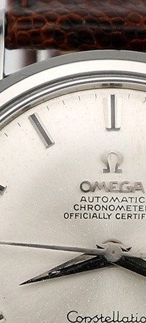

First: Thats not a reference that I'm familiar with but if you look at the "A" in "Automatic":
Here are other ones from OF:
From this comparison alone there should be no doubt that this is a redial
(unless there are other 168.001 dial models I didn't find; as stated I'm not familiar with this reference 😉)

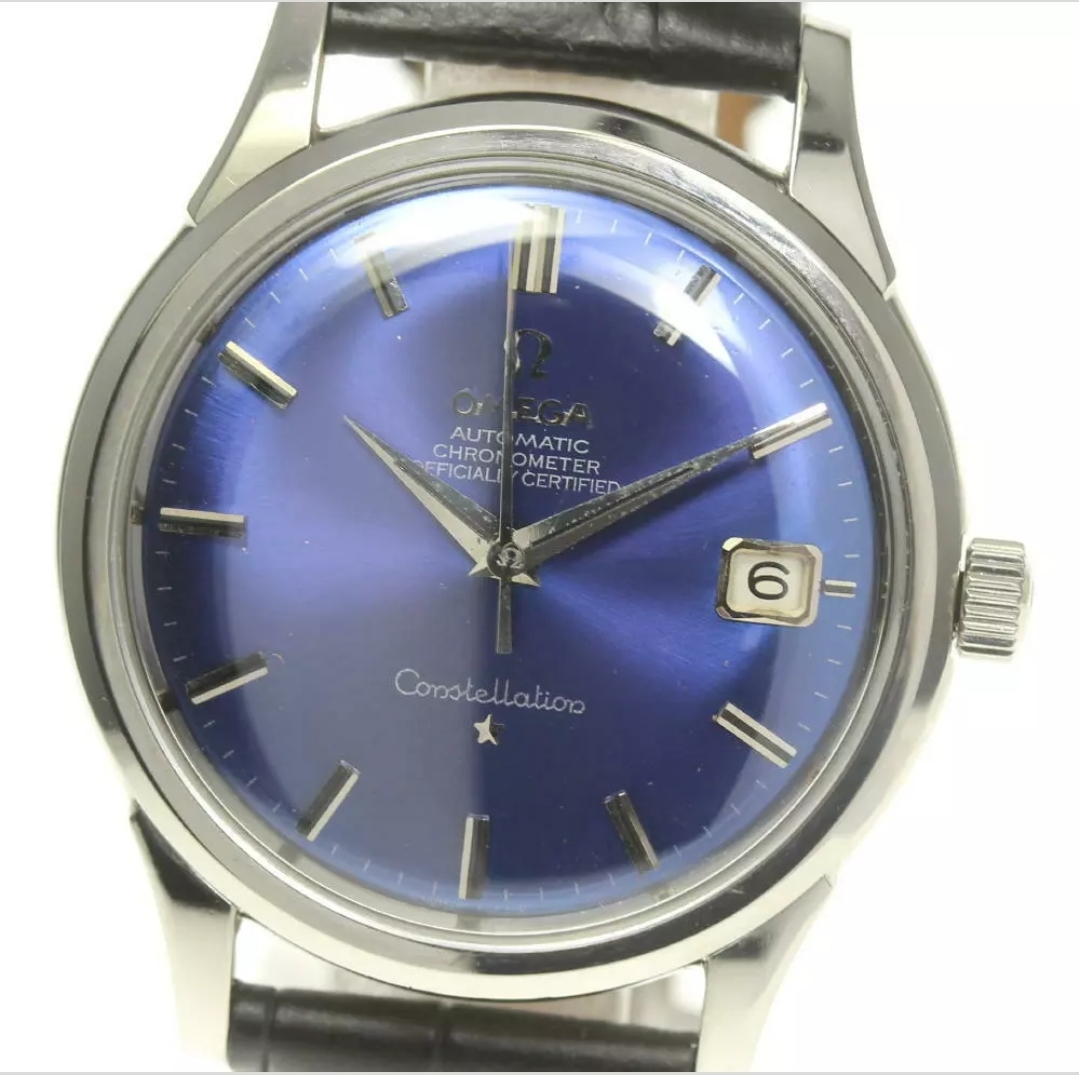

Maybe I wanted to believe this was a one of a kind funky japanese blue dial connie... 😁
Yes. They are different I'm afraid.

I stumbled on this on eBay yesterday, had to smile to myself and think fondly of this thread 😀
323
1,135
I saw that, I have another 168.001 in my watched items that is a redial - on it's 3rd re-list since I started watching it! I have no intention of buying it but interested to see if it sells and for how much!
