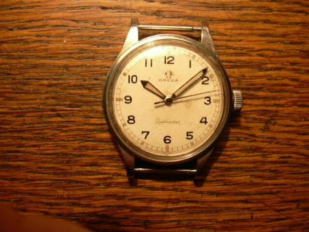

    Back in 1999 I came across a odd looking Omega on eBay. I was very interested in buying the watch. I placed what I thought was a high bid for the watch. The auction did not make its reserve price. I then proceeded to contact the seller. We had a few back and forth emails but was not able to "close the deal". i said to him please let me know if plan on selling in the future. I would send an email every 6 months or so to check in. Then he stopped returning my emails ( approx. 2001).
    Well life goes on and so did my watch hunting. i have found other interesting timepieces over the years. Then one day in 2005 I was viewing MWR's PX and saw FS post titled " FS Omega while dial Railmaster ". Most people did not even clicked on the post, as Omega in the 1960s a while dial Railmaster automatic that is NOT in demand. In comparison to the earlier manual wind Railmaster that was introduced in 1957 that had as special case construction that shielded the movement from magnetic interference.
    Upon opening of the post the image that appeared was white dial Railmaster that was the same odd model of the one I "lost" back in 1999. As fast as my mail program would open i sent a email to the seller that I would take it. As soon as I sent it and email came in from a friend on the west coast saying he was going to buy the watch! I gave him a call and asked when he sent his email to the seller and it was before me. I thought oh well but at lest my friend will get it. During the phone conversation he then said to me " I really cant buy it as cash is tight". i took that as an opening for me to say " Hey, you know I sent him a email also but it was after yours and if you decide to pass on the watch please email the seller to let me buy it next.". To make a long story short I was able to purchase the watch but had a problem getting it back home to the USA. As the seller did not want to ship it outside of Germany. I had the watch shipped to my close friend Steve Waddington. Upon getting the watch Steve told it arrived OK. He asked me about shipping the watch to me I replied " How far away are you from Munich ?" He asked why and I mentioned to him about watch fair that coming weekend. Steve said no problem he will deliver it to another friend at the fair who will bring it back to the states ( I did not realize that it was a 3 plus hour trip one way for Steve). Steve got the watch to Rick at the show and gave Steve a tour! Rick had to show off my new watch to multiple dealers at the Munich fair. I got an email from one of them., James Dowling who is also a close friend. James thought it was great and never saw another one like it. I agreed.
    A week later I finally received the box from Rick. Upon opening the box and under close examination I realize this was the EXACT watch that I missed buying back in 1999. This watch was originally posted for sale in Canada, sold to someone in Germany and then I was able to buy it. I just started to laugh.

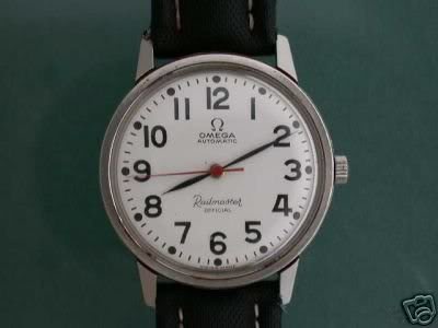

    The typical White dial Railmaster Automatic
    Here the sellers photos of the "watch that almost got away !"

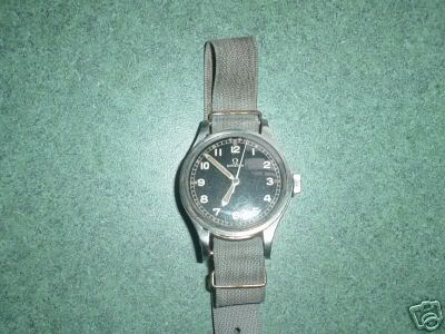

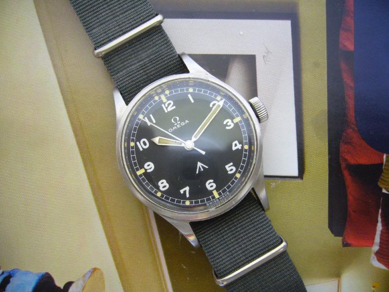

    Here are photos of a Typical RAF 53 "Thin Arrow" Pilots watch from 1953
    ( Yes, this watch as a NOS dial that I got the from Omega in the early 2000's).

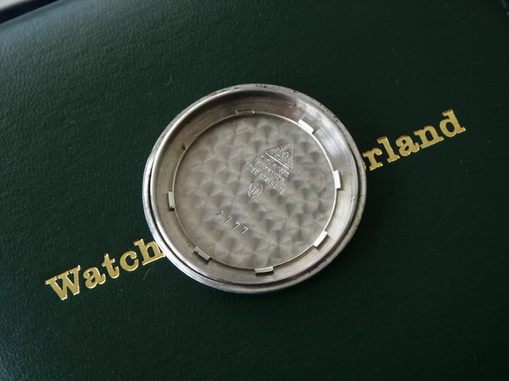

    There are three things that are uncommon to this watch.
    1) The case ref 2777 was the case ref for the RAF 53 Pilot watch from Omega. This reference was never offered in a civilian model ( until this watch came up !!).
    2) The dial is a white version sans the Broadarrow of the RAF 53 dial . i have never seen this before. On top of that it was signed " Omega " " Railmaster".

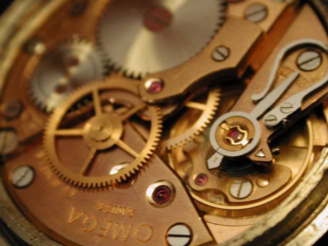

    3) Close examination of the caliber 283 movement shows that it actually has a Swan neck regulator for micro adjustments. I never came across any Omega documents that mention Omega used a swan neck regulator on any 30 mm family movement. The only micro regulator on a 30 mm was the "Omega System " used on a 30 T2Rg ( that model did not have shock protection).

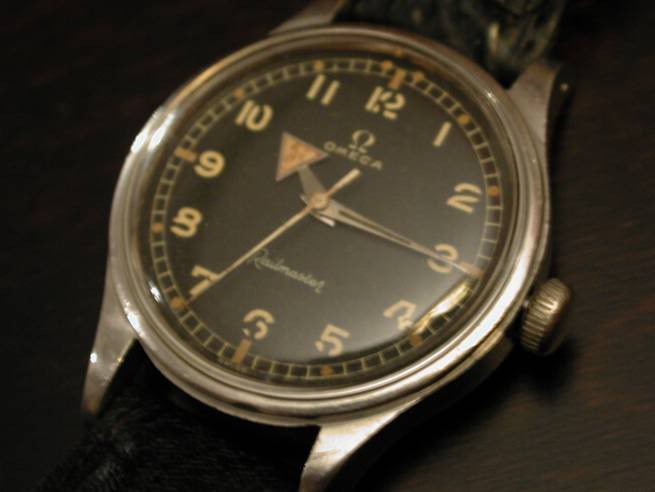

    Hi John
    I just got an email from another collector, He recently bought a CK 2777-2
    with a black dial that is signed Railmaster. The caliber 283 also has the
    swan neck regulator. The watches serial number is 13 units away from my
    White dial example that I bought a few years ago.
    I have included your original research on my example. I would assume this
    watch was also shipped to Canada at the same time in 1955.
    Black dial same style as the RAF 53 ck 2777, but is signed Railmaster and
    has removable strap bars.
    Case ref: CK 2777-2
    Movement: Caliber 283 with swan neck regulator, s/n 14,158,9xx
    Any additional info on the above watch would be great.

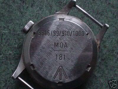

    According to the movement number we found some traces about the 3 watches ref. CK 2777 mentioned:
    N° 14’158’9## - MOA -Production date : 31.10.1955 – Delivery date from factory : 18.04.1961 – UK

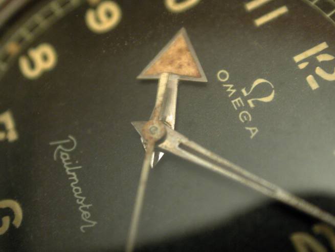

    N° 14’158’9## – Black Dial Railmaster Production date : 29.10.1955 – Delivery date from factory : 17.01.1956 – Canada
    I am not sure if the hands are original on this example. I think it would have the same hands as a RAF 53.

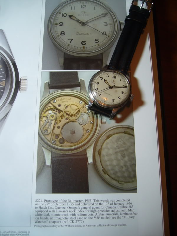

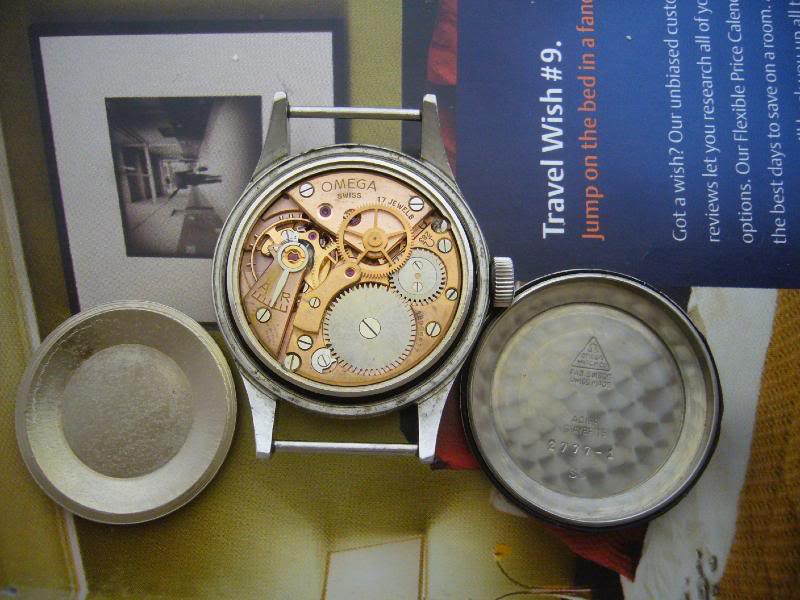

    When I first read John email above I had a feeling that we were getting somewhere FAST ! Then a few days later I got another email...
    Omega has CONFIRMED my 283 with swan neck is original from the factory. They found only TWO pieces of documentation that shows the regulator and balance cock with the proper engravings. Both of these drawings are dated June 29 1955. They are drawing of the two parts: balance bridge 284.1006 and the swan neck regulator 284.1356. There is no other documentation at Bienne, no spare parts, no other indication that this watch was ever produced. The part number are referenced to the next caliber they were designing caliber 284. Also on the drawing of the balance bridge written in pencil “Cancelled on December 14th 1957”. A very small number of these 283 Swan neck movements were produced, aka caliber 283 Rg.

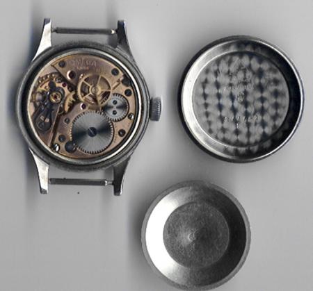

    Actual movement pics
    with case back and anti magnetic inner cover.
    [​IMG]
    Close up of the swan neck regulator
    I think the email from Omega says it best ....
    “ this type of product has certainly been manufactured during a short period of time which corresponds to the time of production of your watch. For any reason, this version has been cancelled soon, which explains why the watches same reference belonging to the Museum, produced at a different period of time, have a well known 283 calibre with standard regulator.
    *Unfortunately we have presently no trace of destination or amount of movements produced in that version. “
    The other question outstanding about the two 1955 Railmasters ( one black dial example and one white dial example). The Railmaster wasn’t introduced until 1957, but both examples were sold in Jan of 1956 and produced in Oct of 1955 according to Omega records.
    According to Marco Richon : ( Omega Museum, Bienne)
    - This white dial is original and produced in small quantity for specific order or purpose … (or) ( have not seen another white dial example).
    - This white dial has been refurbished according to customer desire … (or) ( No this is an original dial)
    This watch is a prototype for the future “Railmaster” model.
    Well since that email. Marco Richon was writing a new Omega book " A Journey Through Time". He had asked me for hi res photos of my watch as he thought it might be interesting to have it in the book. Well about a 15 months later a box showed up on my door step ( I purchased it ). On page 221 Marco has a picture of two Railmasters one of them happens to be mine !
    And the close up of the text !

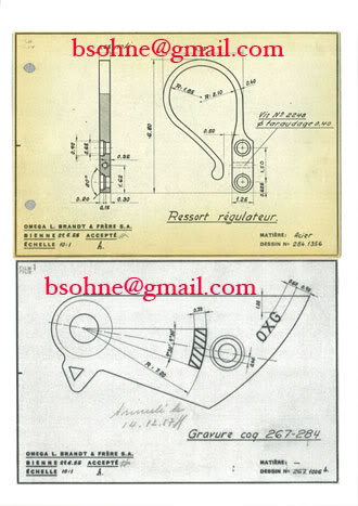

  2. X350 XJR Vintage Omega Aficionado Jul 16, 2017
    12,620
    29,918
    Interesting that the drawing for the balance bridge is marked with the Norman Morris import code, OXG.
  3. Bill Sohne Bill @ ΩF Staff Member Jul 16, 2017
    3,889
    8,951
    Hi @X350 XJR
    I would assume that it would be just a "STUB" and would not be engraved unless it was going to the US market... From the few examples I came across I dont think any had the IMPORT code engraved.
    Good Hunting
    BIll
