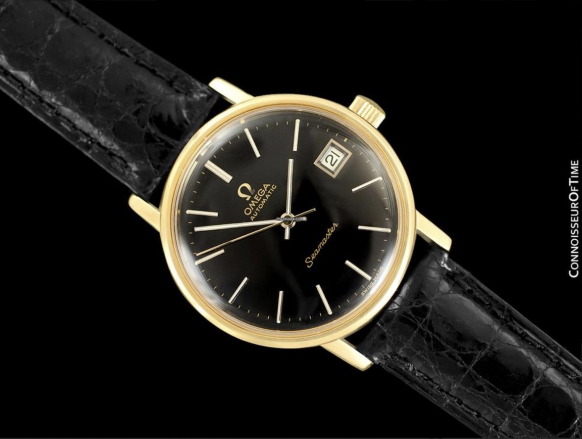

Hi all - My partner is very into the vintage Constellations with a black dial and gold or two-tone case. I have been looking for one for weeks and can't seem to find the right thing in my price range. I came across this Seamaster which seems great:
https://www.chrono24.com/omega/1975...atch-automatic-date---18k-gol--id12620171.htm. It is about $500 cheaper than any of the comparable Constellations. This would be his first vintage watch, so I don't think he is all that stuck on the Constellation but I'm wondering what you all think of this particular option. Thanks!

Very few collectors would have any interest in a watch like this due to the refinished dial and polished case, which have an adverse impact on the value of the watch. There are people who want a vintage watch that is shiny and looks new and tend to overpay for a watch like the one you found on C24.
I’d recommend taking a look at some of the watches listed for sale on OF - there are some very nice vintage Omegas in your price range.

$1400 for a gold plated case and a refinished dial, what a joke!

It's also deceptive.
Ignorant or deliberate falsehood, I could not say.
There is no such thing as "18k gold plate". Electroplating is 24k.
18k usually implies cap or fill or solid gold.
As David Byrne says, "run, run, run, run, run, run, run away!"

The black dial is going to be the problem. They were much less common in the era you are looking at, and many watches that you will find with black dials have been repainted. I think you may need to decide how important the dial color is, because the restriction to black is going to make things much more difficult.

There are a few ways you could go.
- an actual Connie, which carries a bit of a premium.
- a decent Seamaster, which should be cheaper than a Connie (need to find a "decent" one— this ain't it)
- solid 14k or 18k gold, which could be out of your budget
- gold cap or gold fill, which have a heavy layer of gold sandwiched on top of stainless steel
- gold electroplate (worst option, as it tends to wear off easily). If your partner will only wear it on "date night" and dressing up, could be okay
If you want to see a range of "decent watches" for sale, check out the "for sale" section of Omega Forums.

And just to warn the OP, most of the black dialed Constellations found on CH24 have redials too, so if you do manage to find something there you think worth considering a good idea would be to run it by OF first. A lot of sellers will insist the dial to be original when it isn't and the dial holds around half the value of the watch so you want to really make sure that is correct.

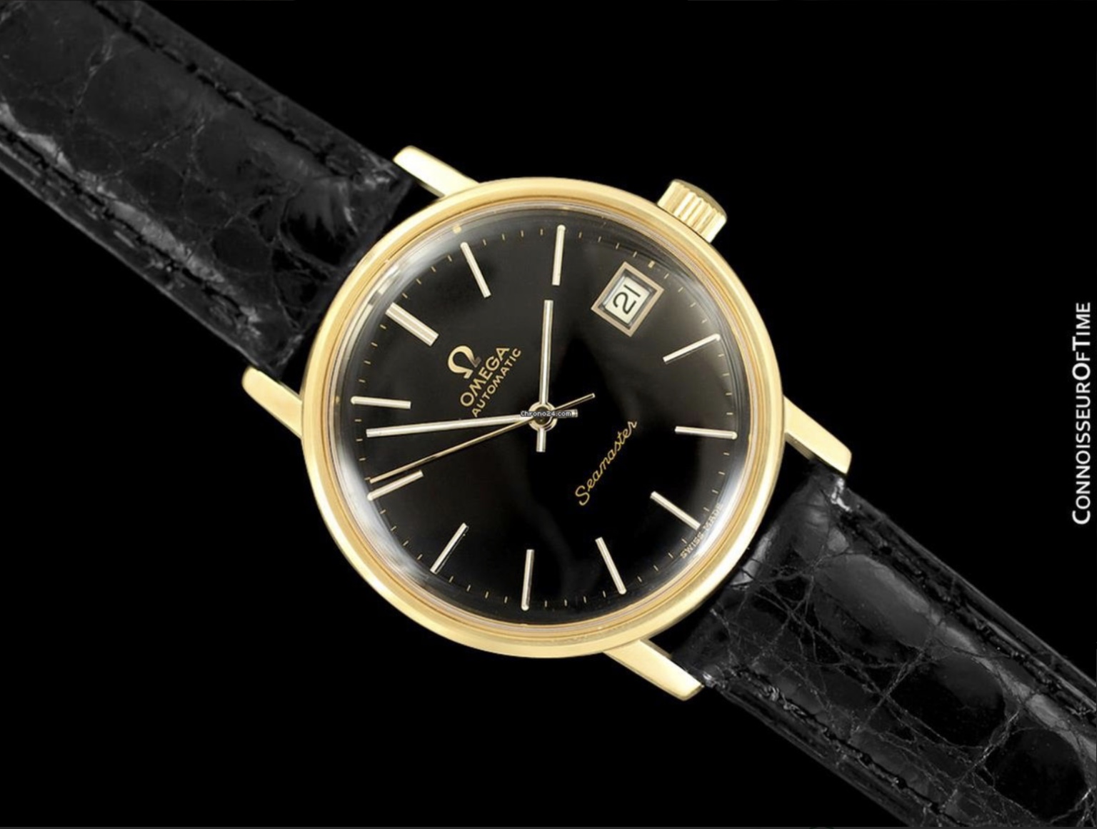

Any thoughts on this as an alternative? https://www.ebay.com/itm/Vintage-Om...4-1967-35mm-steel-gold-top-shell/124138703260

When the seller writes "Moby Dick" as a description, I am always very cautious.
And the price is $3-400 USD too much "if" all correct. It appears so with the pix shown.
And the plate is worn to base metal in many places.
Plus, then, you gotta hope that it ever comes to you for that $50 shipping cost.
This is partly what I had in mind.
You could also search for the reference 168.010 - this watch’s earlier cousin
I think the watch you posted is okay.
(I think the ‘wear’ Is badly reflected lighting - it even looks pink in some shots)
It’s slightly polished, although gold cap is never as sharp as SS.
There’s quite a ding and scratch on the upper right lug.
I think the ‘dial marks‘ showing up in the pic are on the crystal but there is some degradation to the paint on the 6&8 indices.
The crown is an incorrect replacement - it should stick out prominently on this reference.
it would need a service but you should allow for that on any vintage watch you buy.
It is overpriced but it was only a matter of time until these references began to find their feet price-wise.
Probably a couple of hundred over if all spot on rather than 3-400, but probably 3-400 over in this condition.
