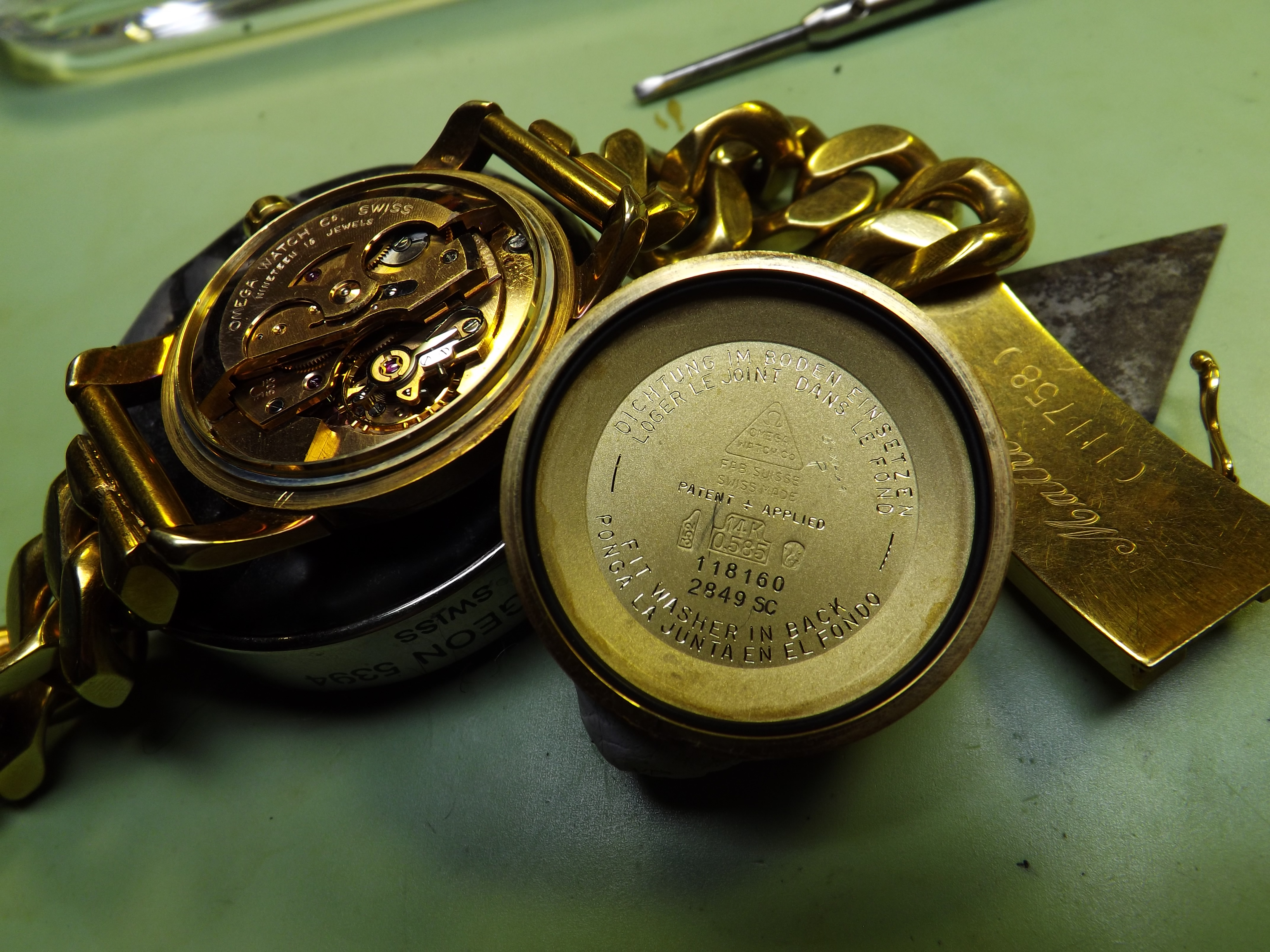

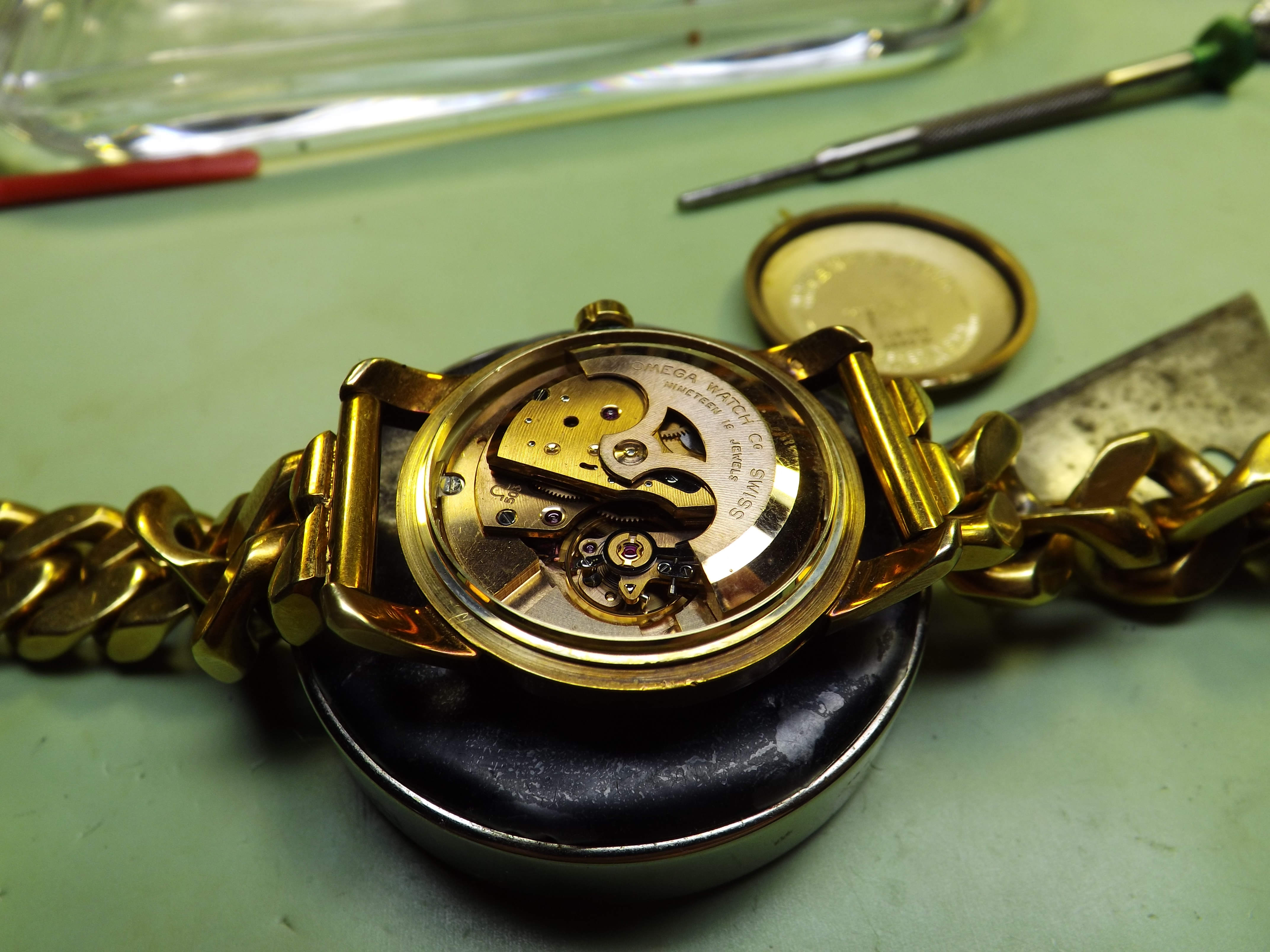

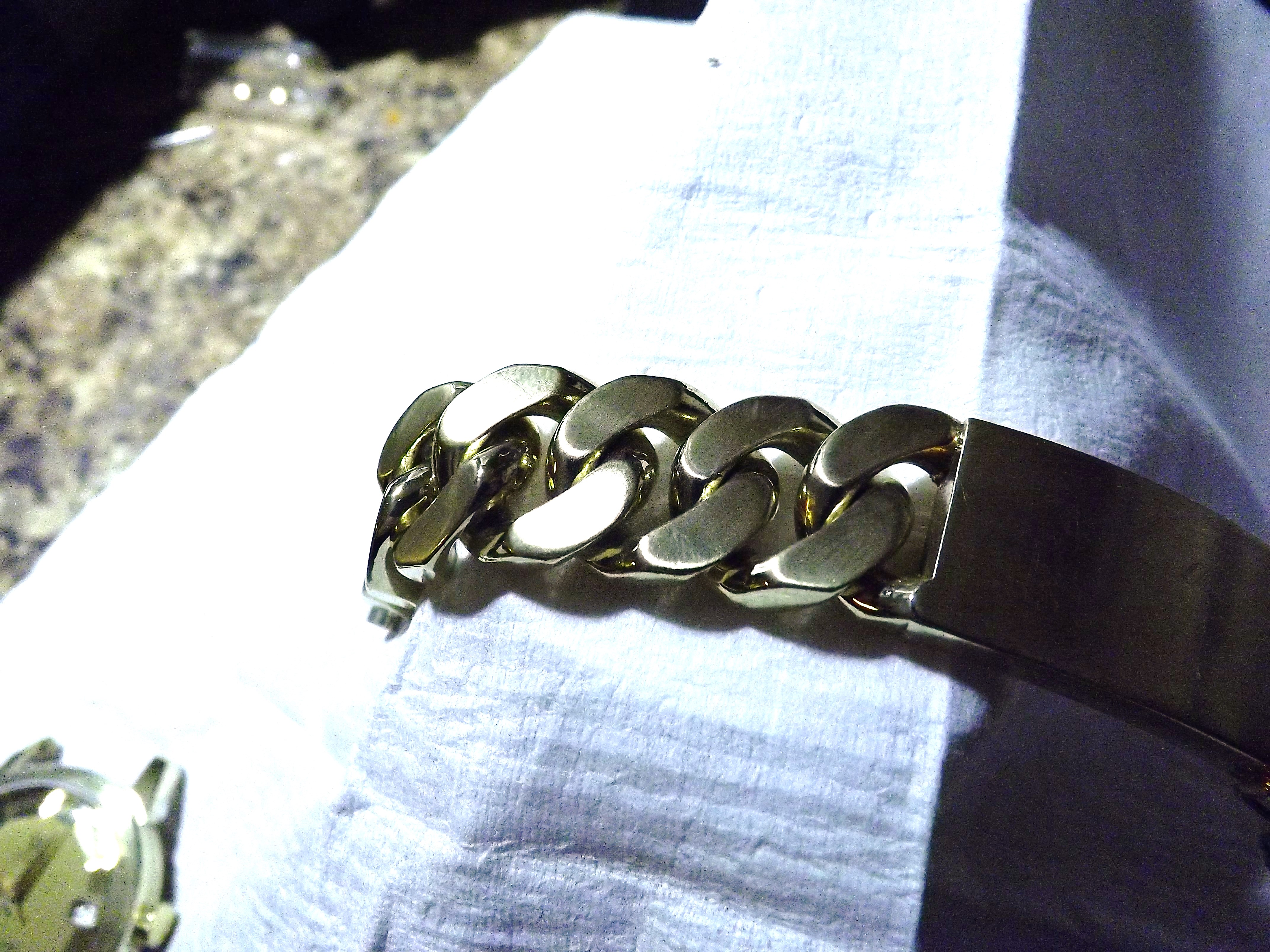

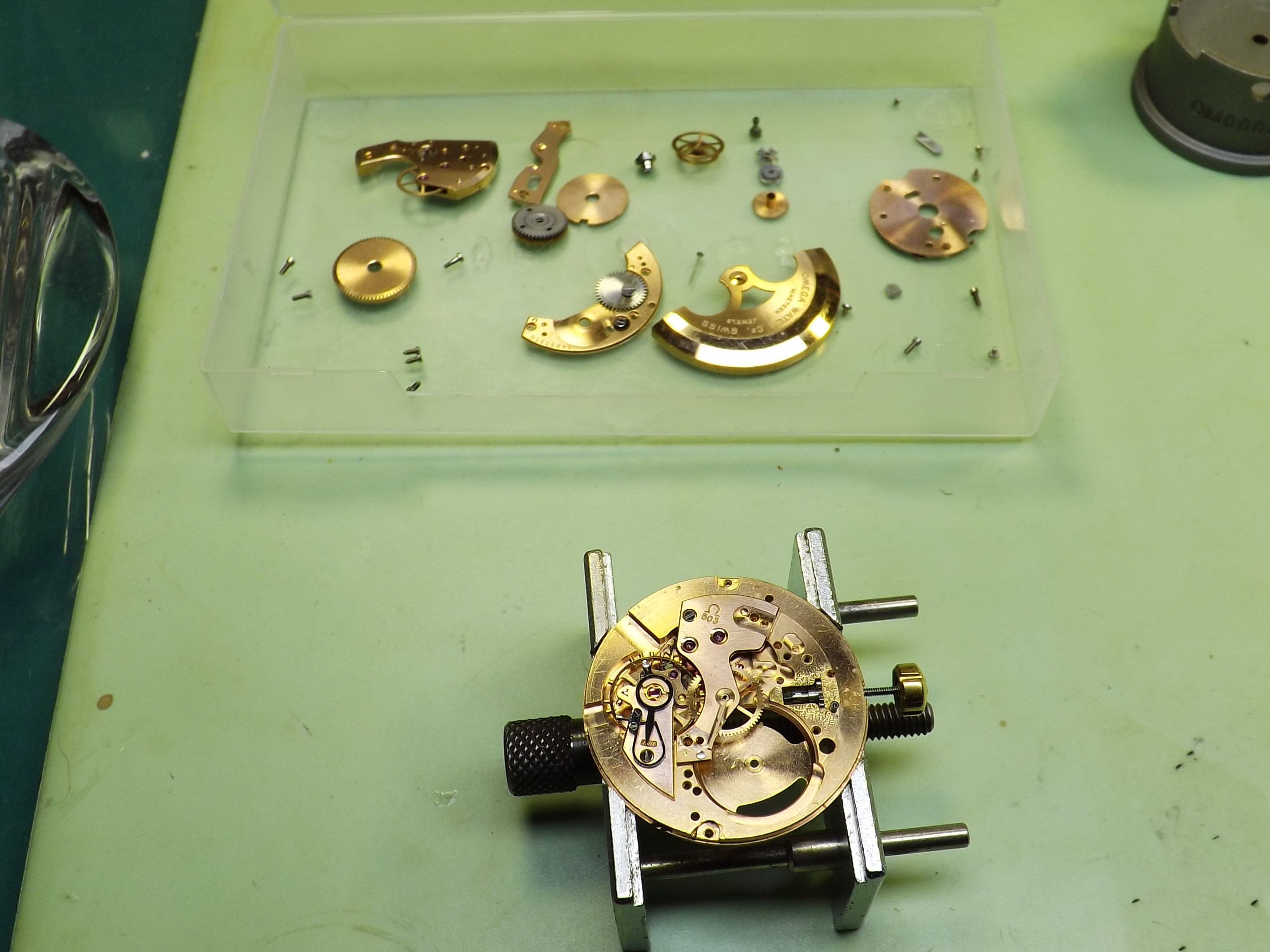

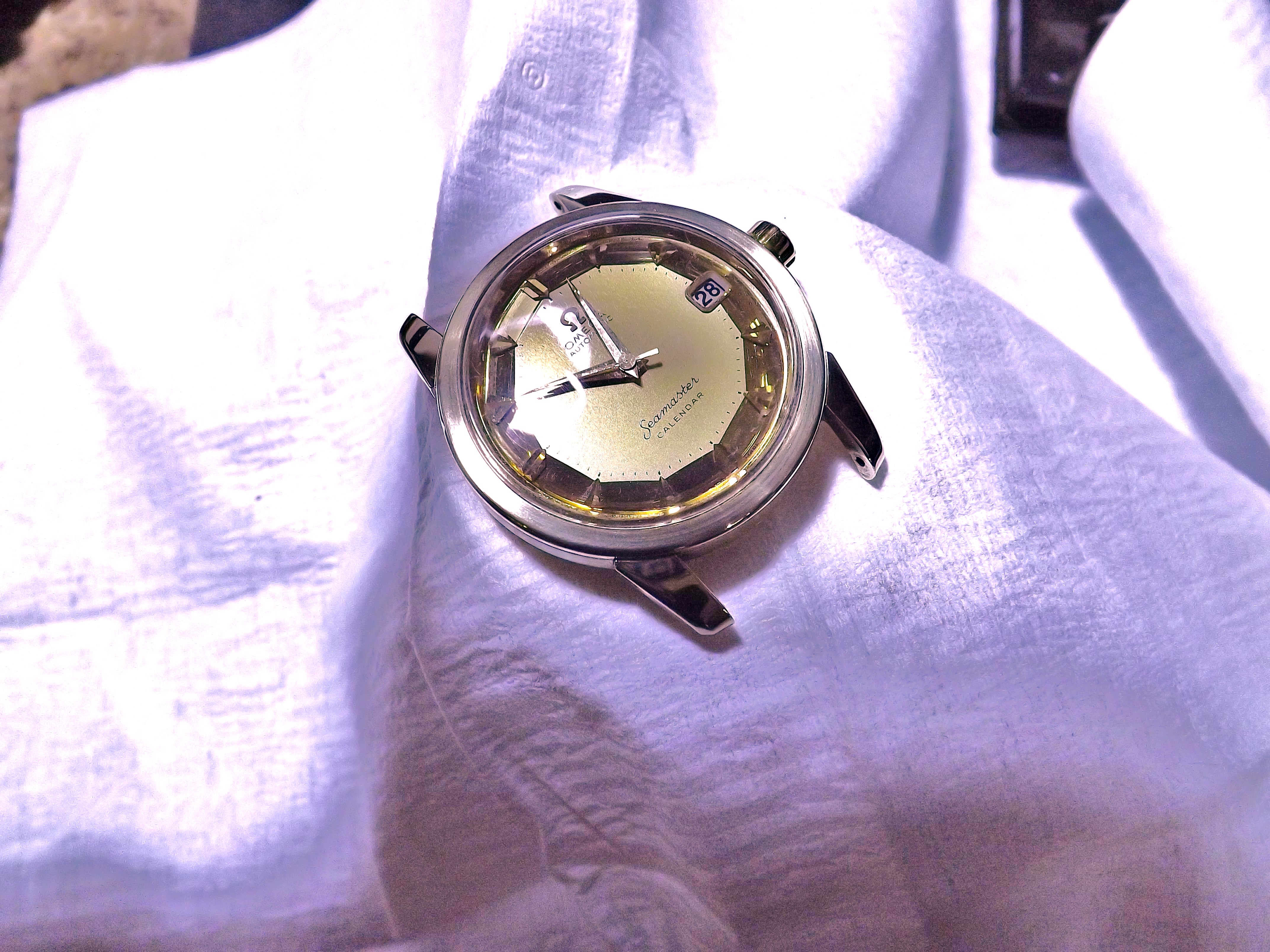

Greetings,
So I sent the Seamaster out to Jesse Hueg in NY for evaluation/cleaning Attached are some pictures he sent me. He stated by the serial number it was from 1955 and added the comments, "
The watch is amazing !! It's by far the best example of the model that I've ever seen and I've been at this for 29 years"

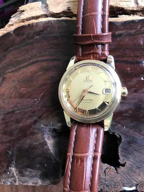

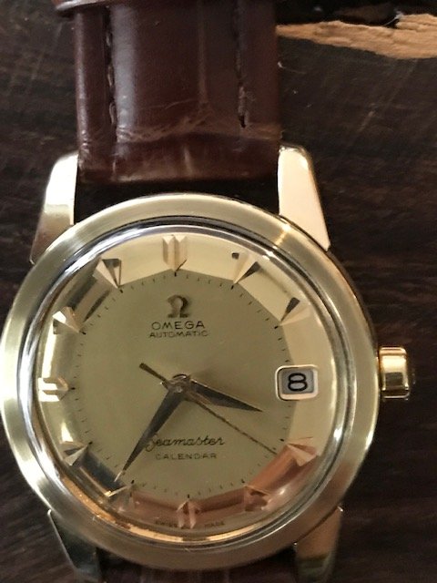

Well I finally got my watch back. Take a look 😀 Only small detail I would have liked is if he had set the time and date; I will not complain too much since he did add the leather strap for "free" and I did get it back! He did nicely clean and polish the chain bracelet as well.

Looks stunning! Enjoy it!👍

Well after waiting months for my watch I could not wait to wear it. Now it will randomly stop, even after wearing it all day! When I pull the crown out to change the date the second hand will start to move, as do the hour and minutes ones! I am not sending it back to Jesse but WTH. He cleaned it but also polished it, which somebody said would hurt the collector's value, although I intend on keeping it I am bummed he did not listen. Anybody used these folks before? https://www.govbergwatchrepair.com/watch-repair/omega-repair-washington-dc/

Could be an easy fix. Sounds like a stem/ setting section oversight. Could be the wrong stem as well, if he changed the stem. Polishing without consent is a No No. Fortunately yours was hardly used and a polish might not have taken much material off......enjoy. kind regards. Achim

I personally think a light polish, say with a Cape Cod is preferable on a gold watch to a scratched up dull case. Obviously I would not want any edge definition to be lessened, that is the key to maintaining the look of the case but removal of a few superficial scratches on a polished surface isn't a major negative, quite the opposite. Steel watches with mixed or brushed finishes often need material removal to refinish property, polished gold not so much.

I wouldn’t sweat the polish if he just gave it a hand shine-if the case seems softer at the edges than before (like he used a buffing wheel), then I would be a little steamed. It looks lovely in your picture.
If you were happy with his service and communication then I see no problem sending it back to iron out the issue. Sometimes something gets overlooked or loosens in shipping (lots of vibration in transit). I had a 1917 trench watch serviced by a watchmaker that specializes in them. When I got it back, the hands wouldn’t keep time. It would set and wind and I could hear it running but the hands just stayed where I set them. I sent it back and it was a loose canon wheel/ very easy fix and common part to come loose. He turned it around in 3 days, been perfect since.
