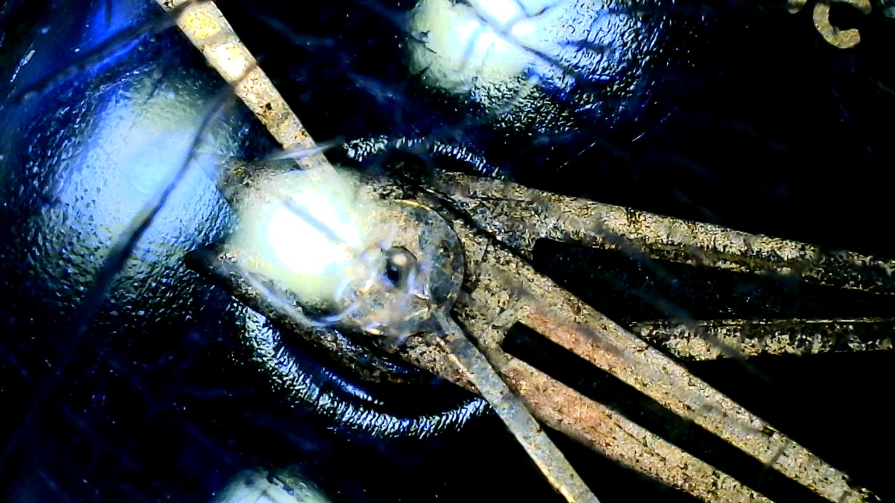

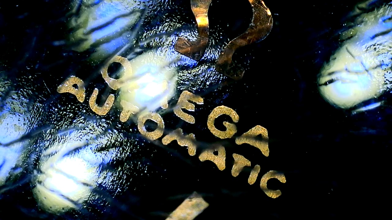

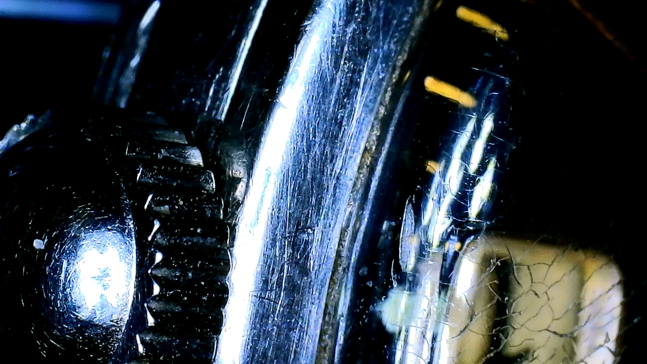

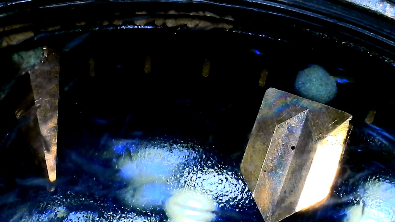

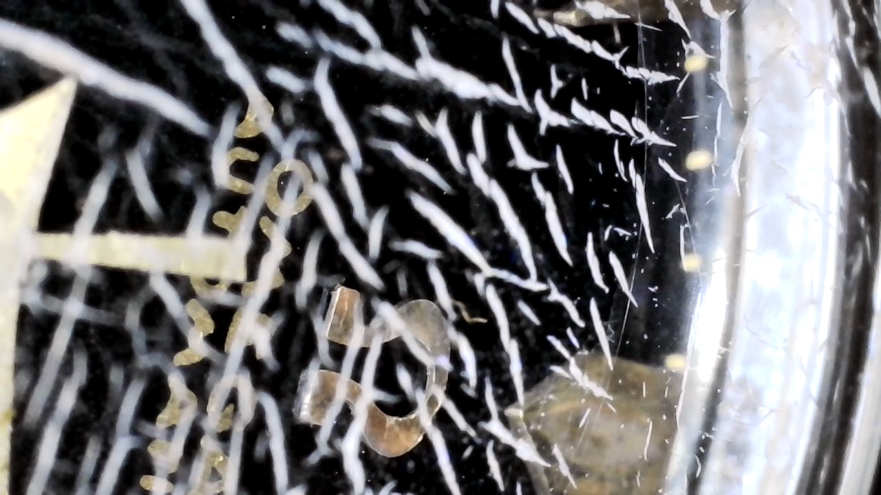

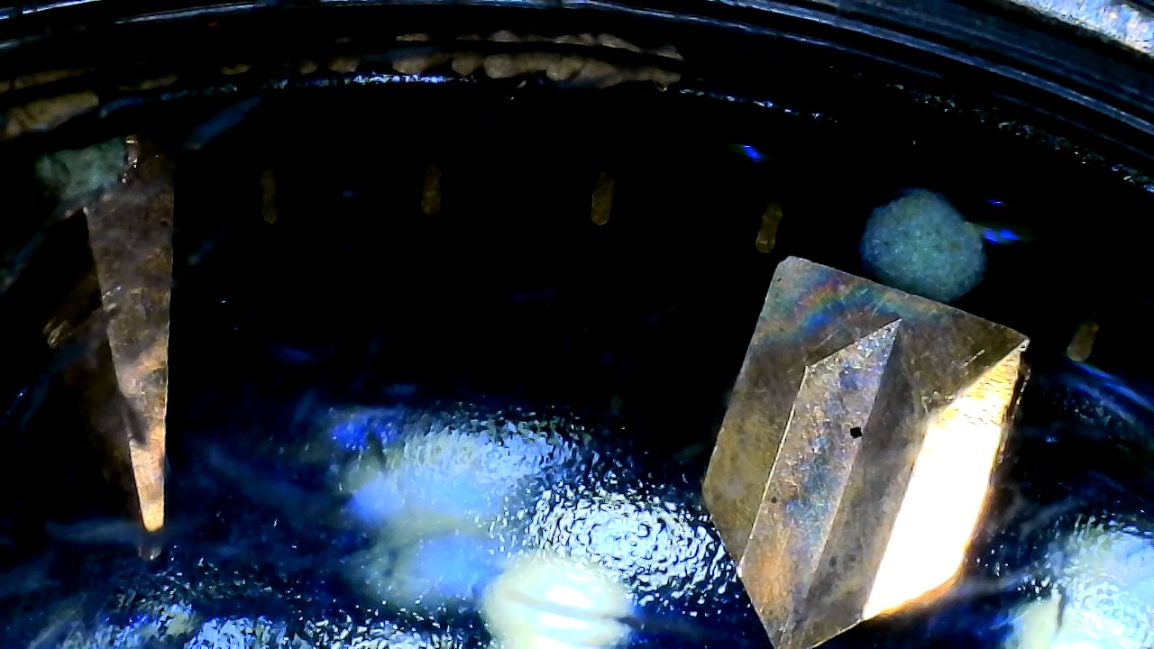

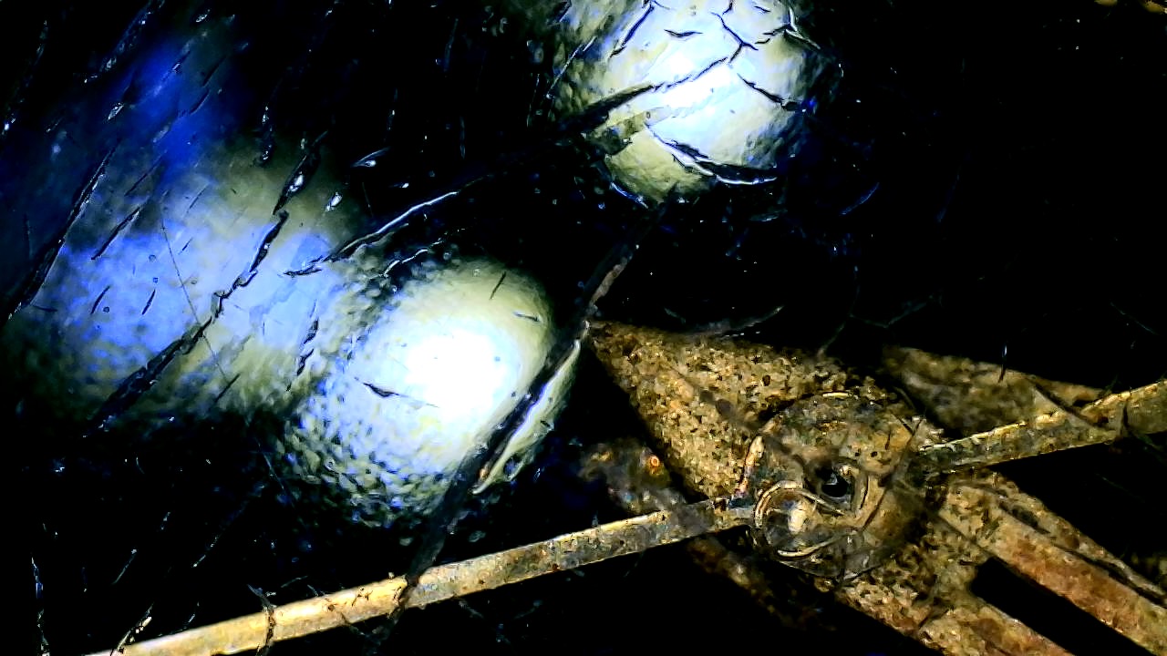

I'm a little concerned as well with the lume plots for the shields. On an original dial, you would expect those to be perfect little round domes.

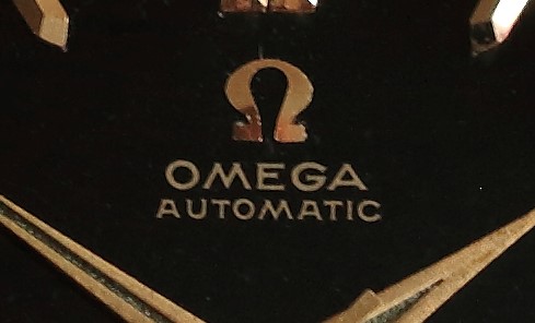

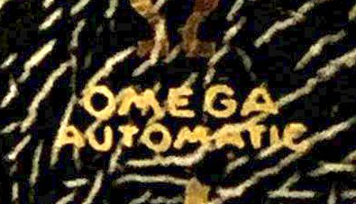

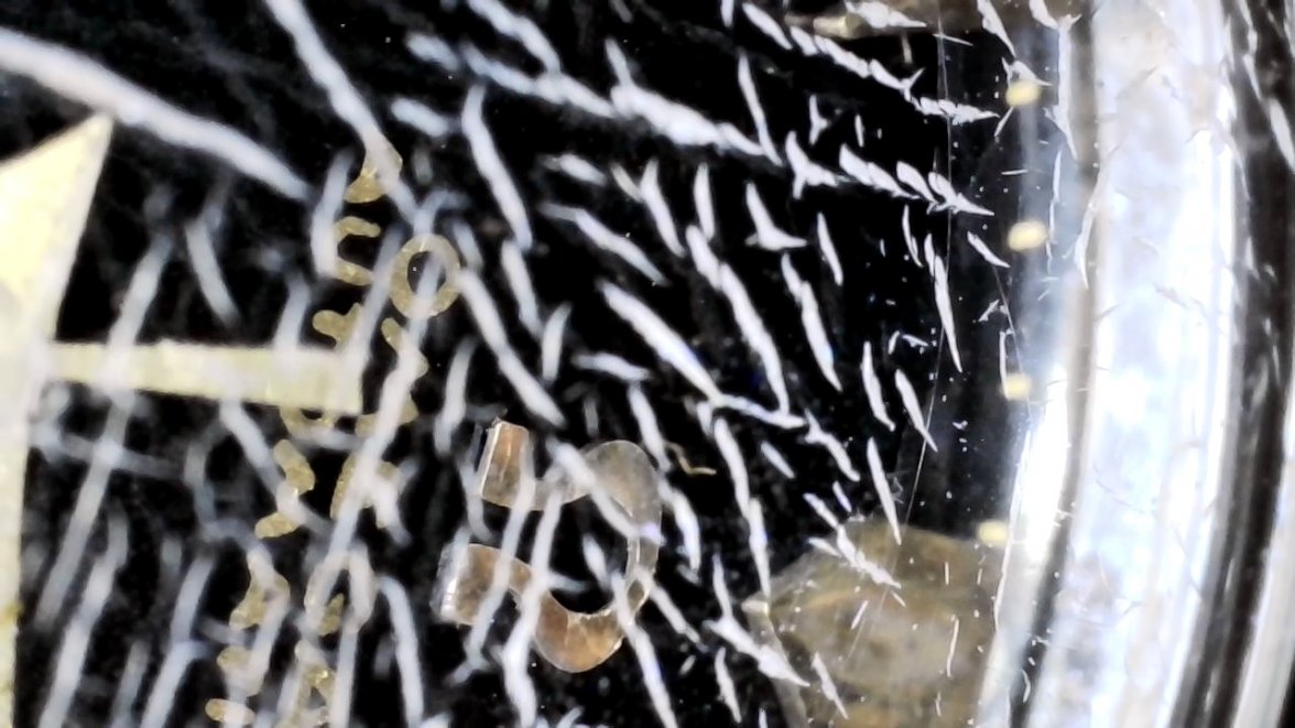

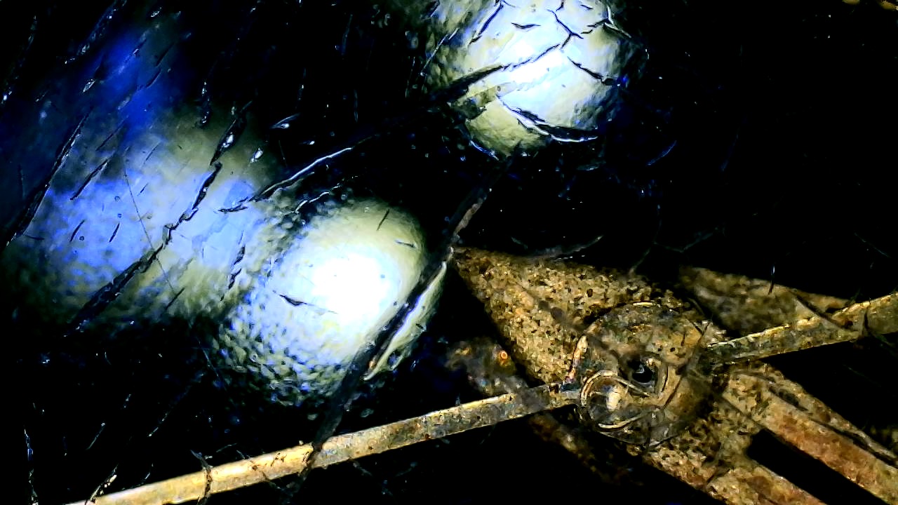

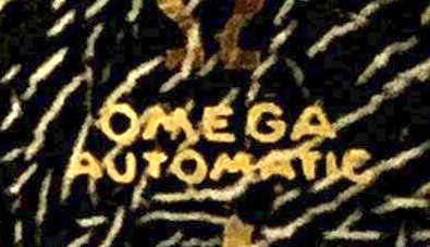

The blow up pics posted by Dan S don’t look great it must be said. Remember Padders rule: every black dial Omega dress watch is a redial.
I concede there are exceptions but follow that and you’ll not often be wrong…

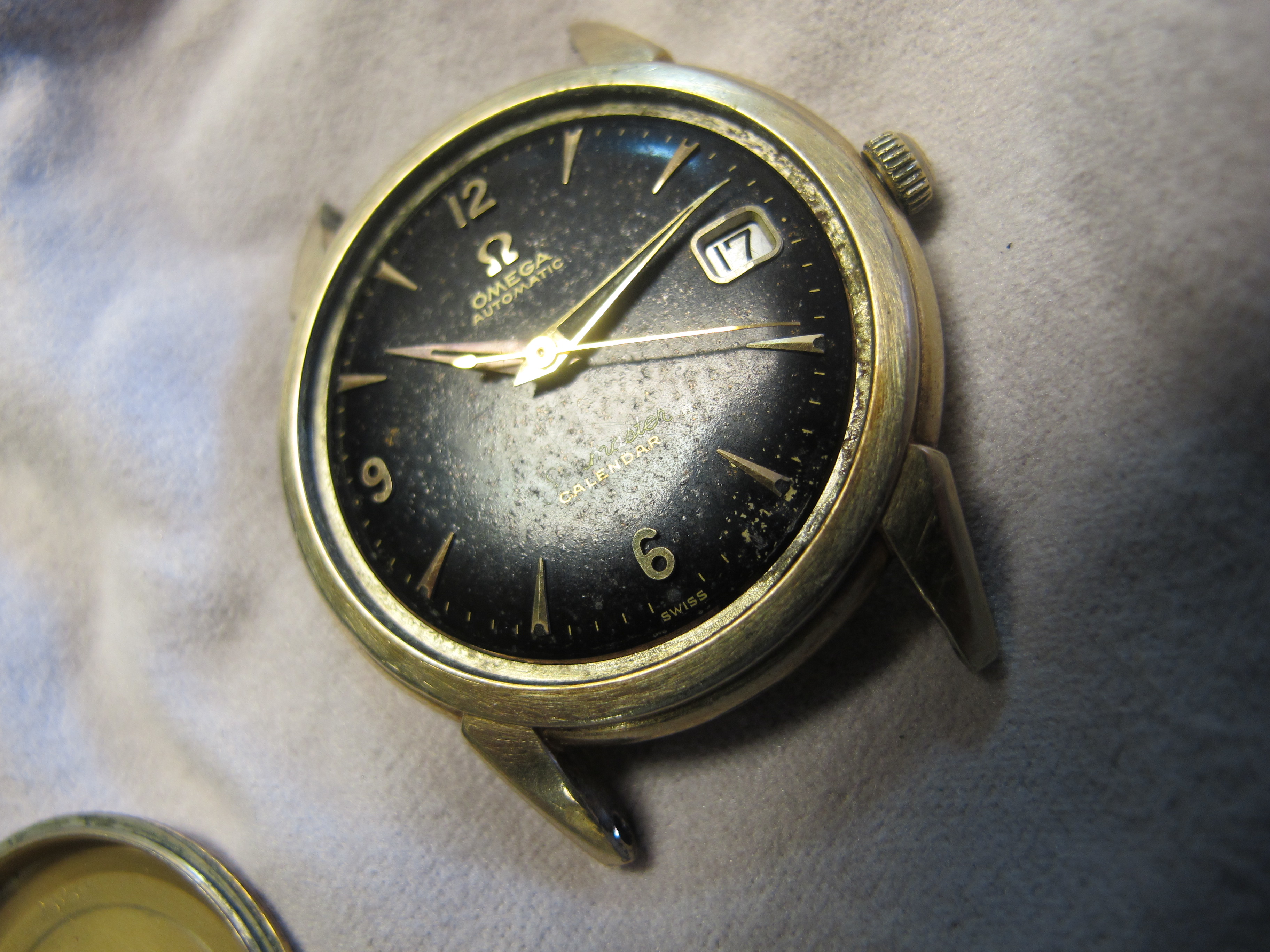

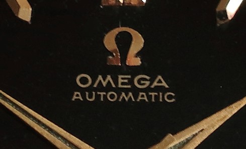

Looks like it will clean up very nicely with a service and new crystal. I love these black glossy dials, there's nothing else quite like them and when you get one in good condition it's a beautiful thing. Here's my 2849 for comparison
Very nice! I can’t wait to see it with a clear crystal. Do you mind sharing the winding instructions for this? Can it be overwound? How many winds till it’s fully wound? Anyone have suggestions on when not to wear a watch of this age?

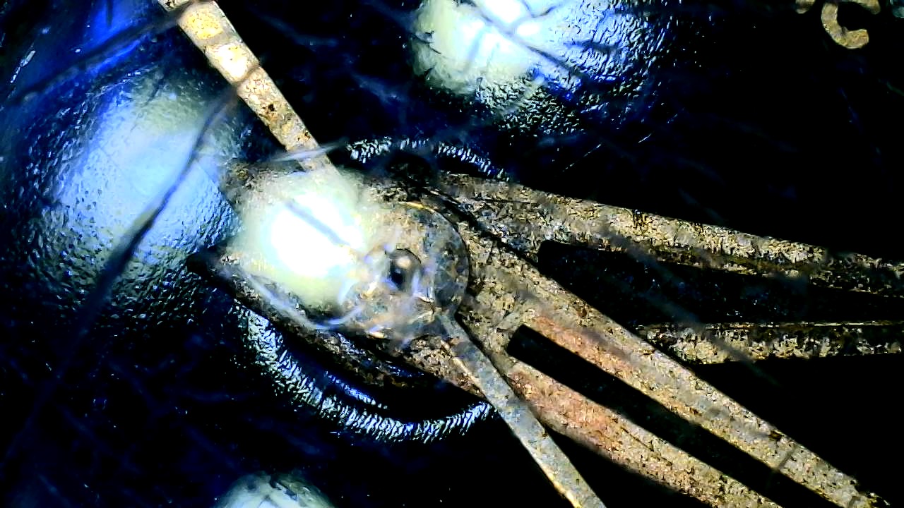

It seems to me that the crystal is distorting the view of them. I just tested it for radium, and I can confirm they are made from radium.

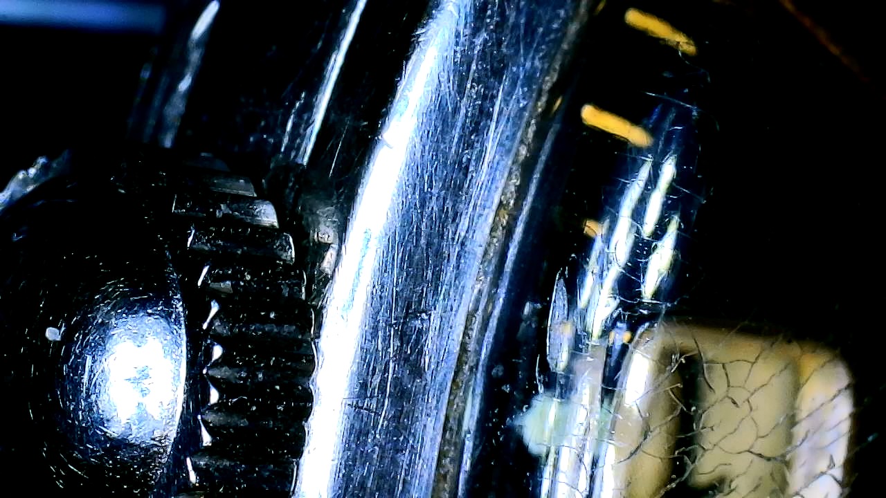

in addition to @gbesq: the crown is not original.
The black dial is a big + when selling the watch. I would keep this Seamaster when restored as mentioned above, offered at the flea-market, I would pay maximum 900 w/o opening the case.
Nice hairloom and welcome here!

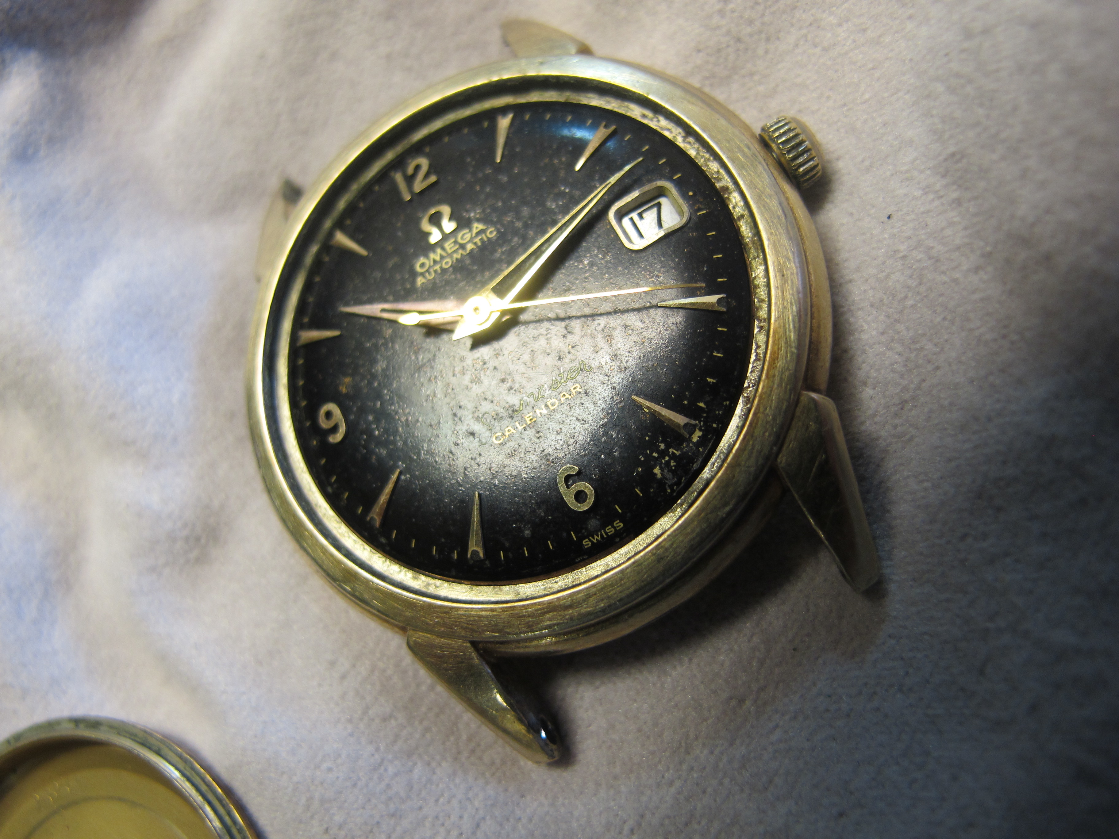

The crown might be original if the OP's Seamaster was cased by Norman Morris.
About ten years ago I acquired this NM KX6275 from the estate of the original owner.
Note the crown. I assumed it was incorrect. When I dropped it off at the watchmaker I was employing at the time, I asked him to source a yellow clover replacement.
A few days later, one of the regular participants on WatchProSite asked my opinion of a Seamaster Calendar on eBay he was considering. When I brought the listing up, it turned out to be a NM model. Same reference number as mine but with a white dial and cal 503 movement. (Mine was a cal 502.) The movement numbers were within two digits of each other. And they had identical crowns.
I rushed back to the watchmaker's shop the next day. Fortunately he hadn't discarded the original crown, and was able to cancel the order for a replacement.
My sense is the OP's crown is likely original if the Seamaster was cased locally.

100% redial* and relume.
*this means the original dial has been stripped and repainted. It wasn’t uncommon back in the day.

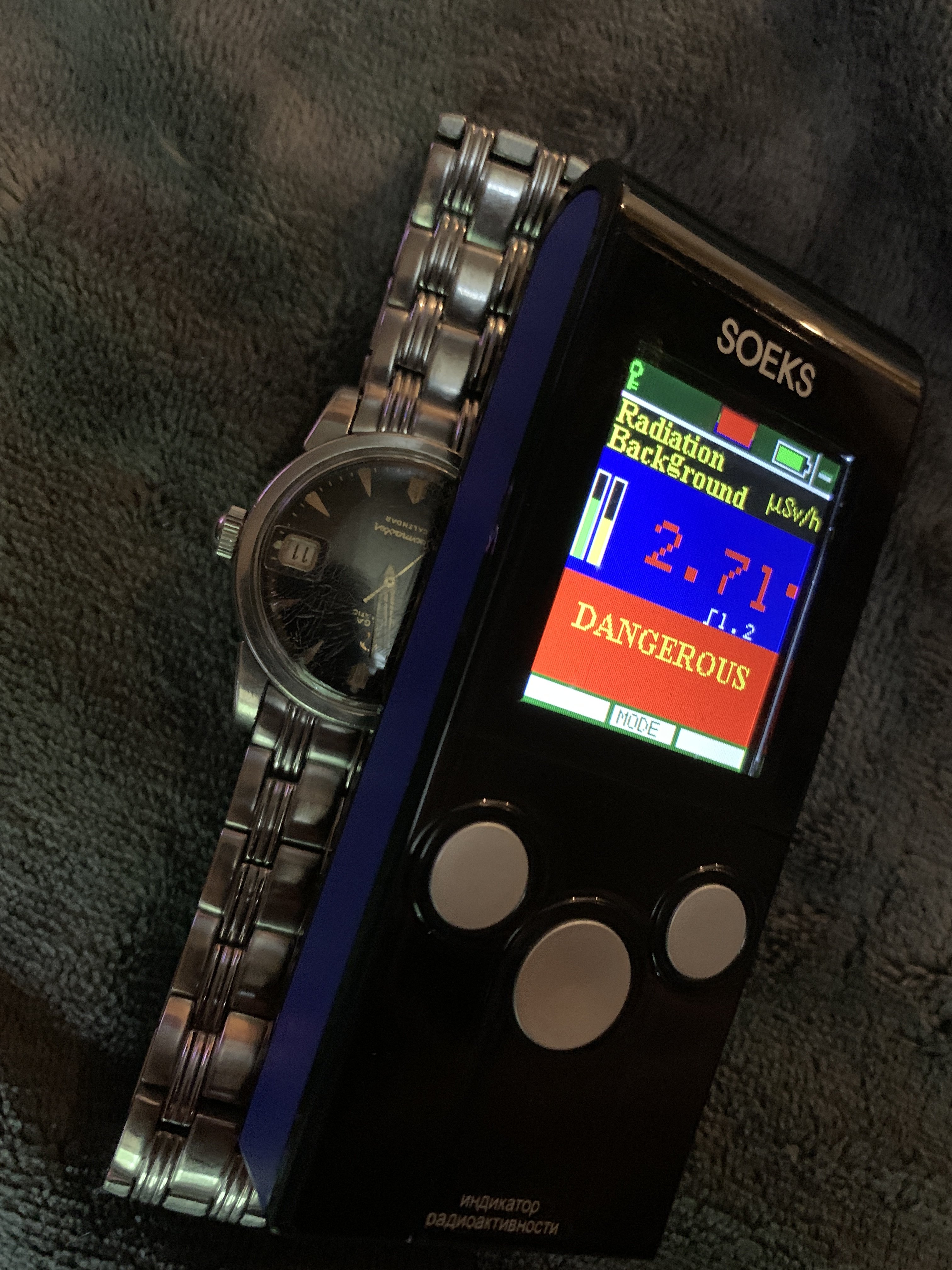

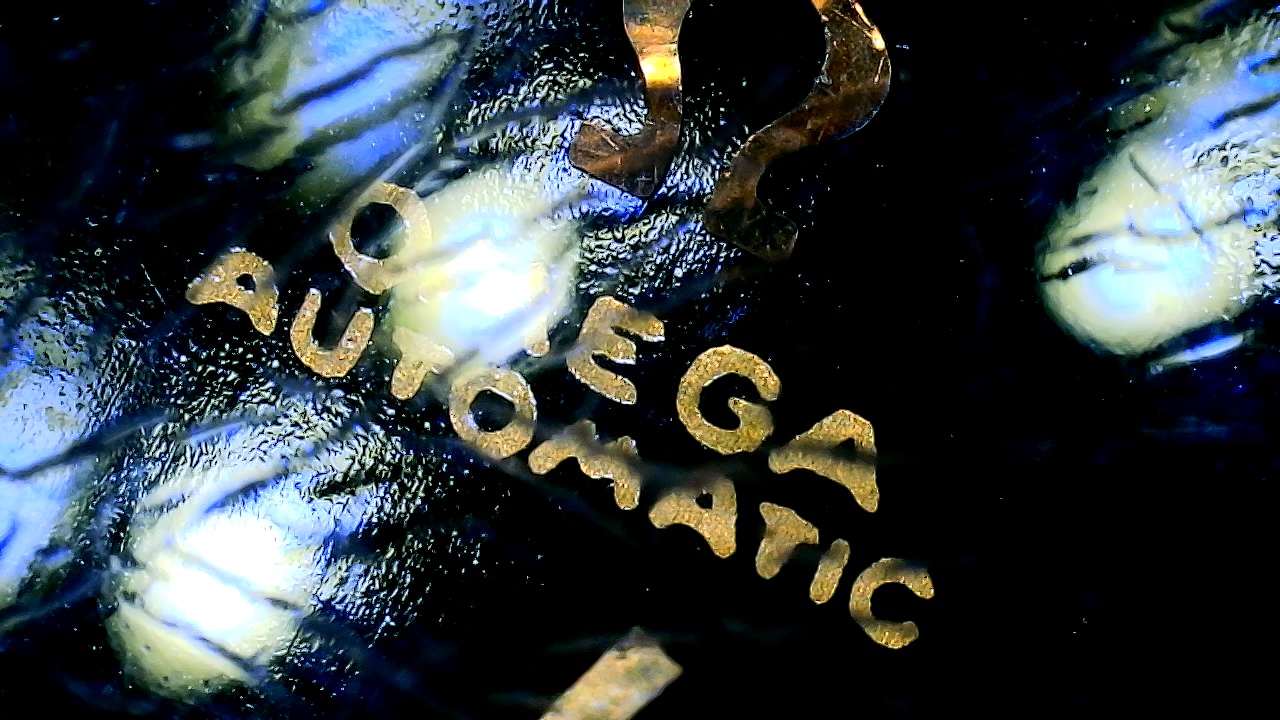

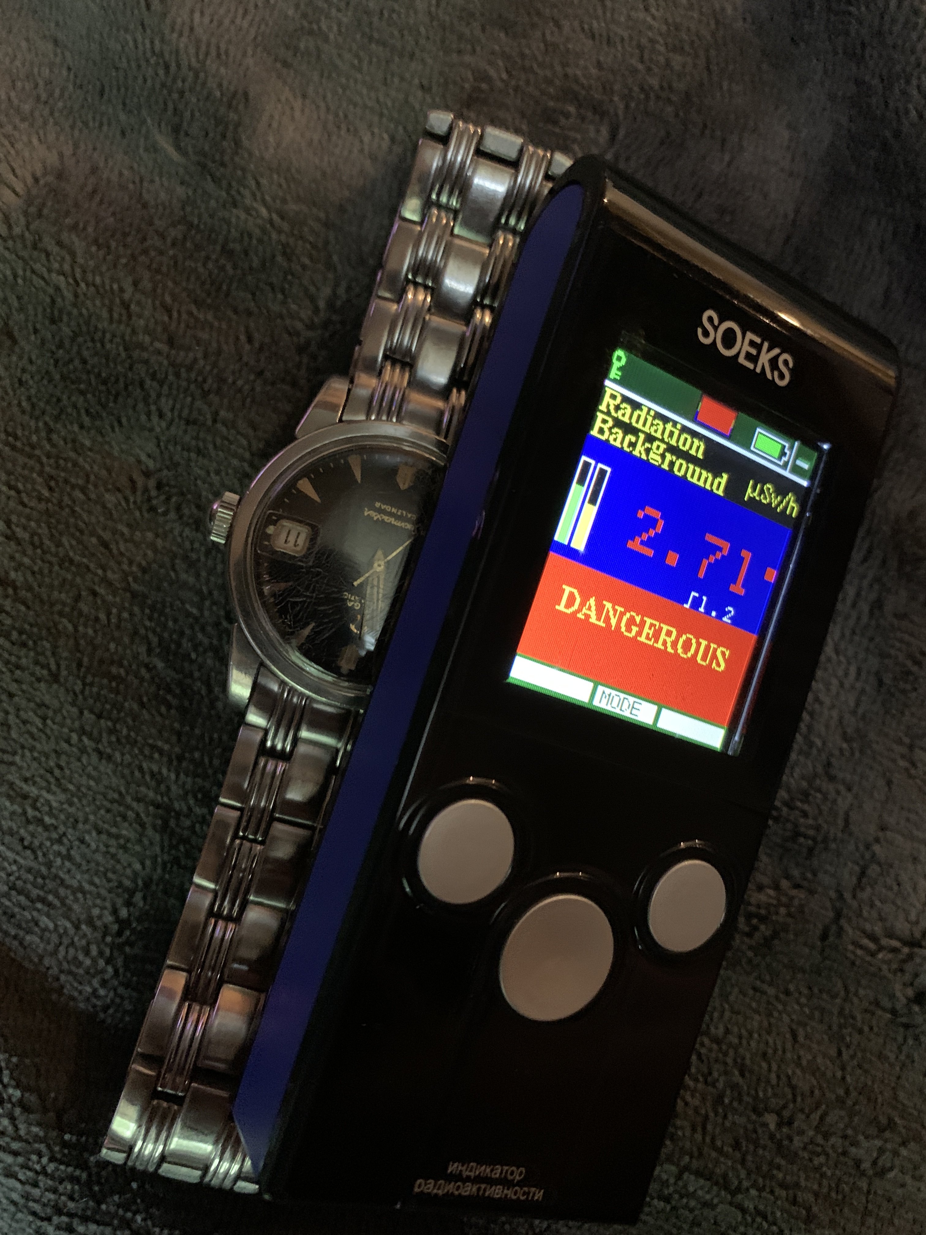

This being fairly unanimous, I guess getting it redone again won’t hurt anything will it? I feel like removing the radium would put me at some ease about it. They still glow, so I can assume it’s not the original from the 50’s.
614
836
To be quite honest, even if removing the radium would "hurt originality" on your watch (it won't) I would not want to wear it as-is with that kind of activity. I have a low tolerance for radium though.
24,836
55,256
Nothing about the dial is original. You can certainly have the dial refinished again, but the results are often not particularly good. Alternatively, you can just have the lume replaced if the radium concerns you.
