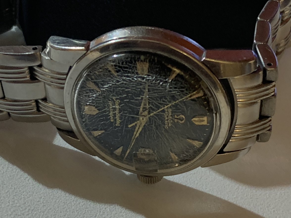

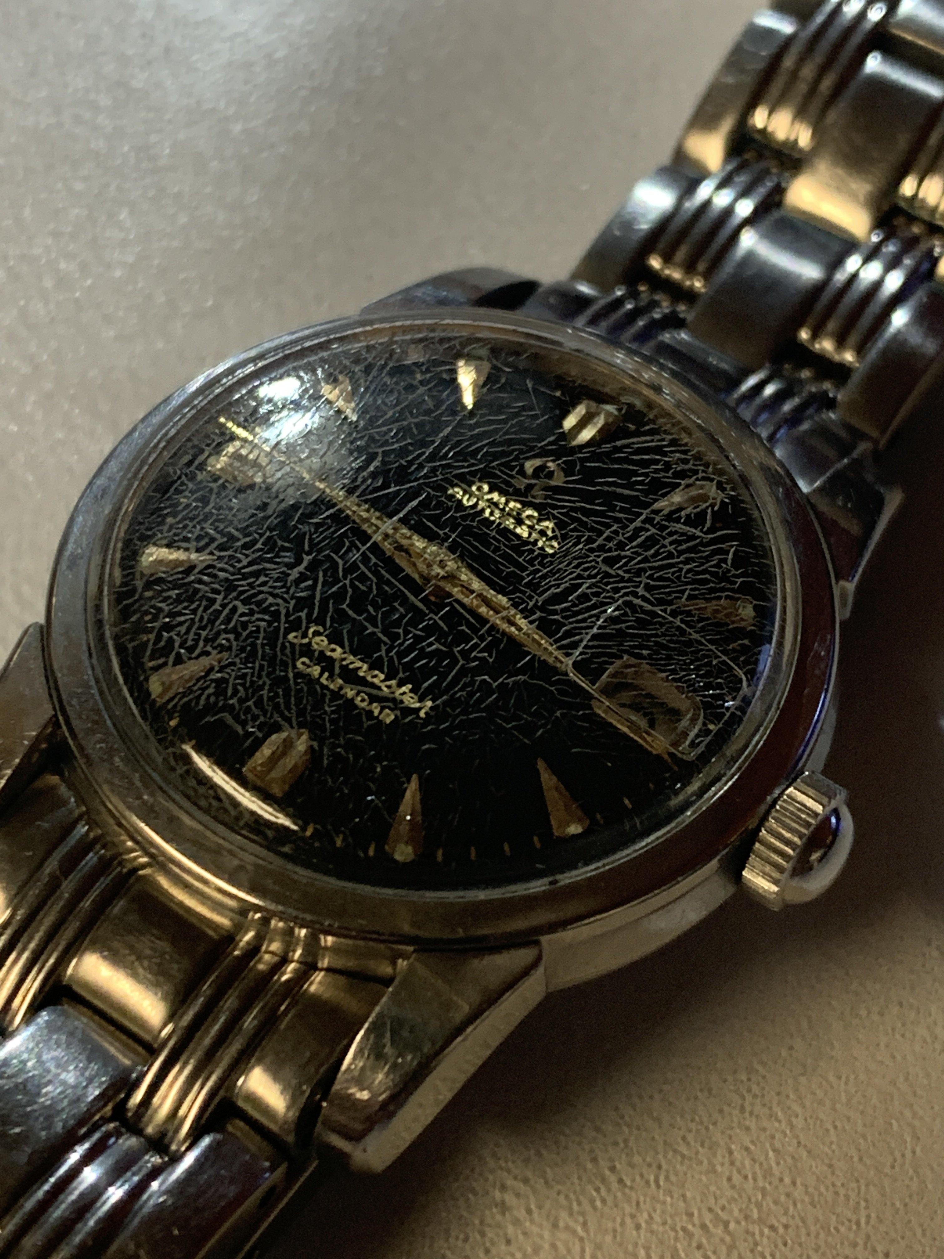

With my Grandfathers passing, he and my Grandmother wanted me to have his wrist watch. I gladly accepted what she explained was the watch he wore everyday for many years. He was a humble man who retired from the Air Force in 71 and when on to become the 117th employee of FedEx as a airplane technician. He retired as head of QC over the refurbishment of many of their planes.
I’d like any advice I can get about this really cool watch. I am very proud to wear it and would love to know more about it. She told me that she witnessed a man offer him 8K for it one time. It means a lot that he didn’t take that offer. Maybe he knew it wasn’t worth that much, or maybe it meant something very special to him. Maybe both.
I’d like to have the crystal replaced but I don’t know who I can take it to. The local Omega shop attempted to polish it with no luck. I’m in Georgia, and I would like to hand deliver it to a watchmaker. I’d also like to source the part myself so I can be sure it’s genuine Omega. I understand I need to have to back opened to identify it properly, but I also think it can be identified by an expert without this. Am I wrong? Does anyone know of a watchmaker in Georgia?

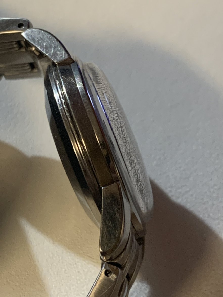

The OF experts may correct me, but I believe that this is what is generally known as a "beefy lugs" Seamaster calendar. If memory serves, the very first version was reference 2849 which was introduced in 1955 with a 20 jewelled caliber 503 automatic movement. There are other versions of this model, so the only way to be sure is to have a qualified watchmaker open the caseback to give you the case reference and serial number, both of which should be on the inside (case reference on the inside of the caseback and serial number on the movement). I would like to see better photos of the bracelet, front and back, and especially of the inside of the clasp and the end links where the bracelet attaches to the watch case. The watch will likely need a full movement service and an ultrasonic cleaning of the case and bracelet in addition to the crystal replacement. The work should be done by a watchmaker who has experience in the sympathetic restoration of vintage watches and who also has an Omega parts account. I can't recommend a watchmaker in Georgia, but I'm sure that other OF members will chime in with recommendations. This is a nice watch and a lovely heirloom, but I'm not aware of anything that would make it worth anywhere close to the $8k figure noted in your post.

in addition to @gbesq: the crown is not original.
The black dial is a big + when selling the watch. I would keep this Seamaster when restored as mentioned above, offered at the flea-market, I would pay maximum 900 w/o opening the case.

I will second Fallout Boy's comment about the crown not being original and correct for this watch. I noticed that and forgot to mention it, so shame on me. He is also correct that the black dial in original and unrefinished condition is a rarity on this model as it is on most vintage Omega Seamasters and Constellations. It's much more common to find these models with repainted dials, and black dials in particular, which detract from the value of the watch even when they are well executed.

The black unrefinished dial makes it something of a rarity within that particular case reference. Just understand that rarity doen't always equate to valuable. The critical question is what is the watch worth to YOU? Given that it was your grandfather's and can be sympathetically restored to its former glory, I would say that it's priceless.

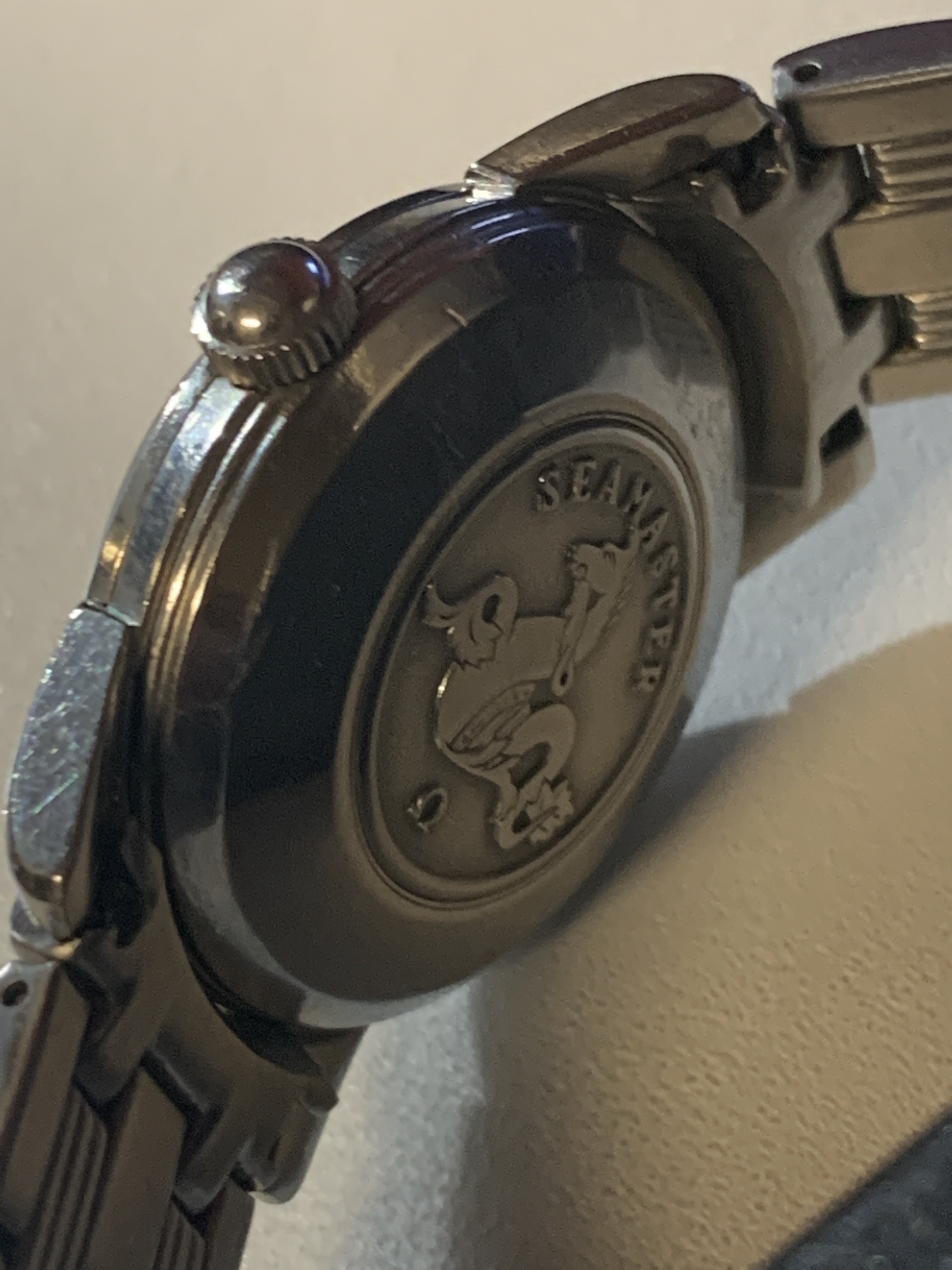

Big hippocampus on the caseback - 1958? Love the bracelet, even thought not sure it’s original. Me, I’d spring for sending this in to Omega for a refurb given the original black dial, and family provenance… but it’ll come at a cost obviously.
Omega will ruin its vintage character. The dial and hands will be the first things they replace.
I don’t think it is original, but I love it. I do believe it is a 58, thanks for the input! I was finally able to find a comparable one. https://corrvintagewatches.com/prod...al-gloss-black-and-gilt-dial-on-bor-bracelet/

This I great advice. I will likely need it serviced because it doesn’t seem to be automatically winding. I will state clearly that it does not need any of the patina removed and the only thing I really want to change is the crystal and possibly the crown. Finding the exact replacement crystal may be problematic as it seems the magnified “Cyclopes” crystal is fairly rare.

They didn't always have the Cyclops crystal and some people think they look better with a plain one, so it's your choice which to go for. I don't know if that's an Omega bracelet or not but it looks good on the watch and I would keep it.
