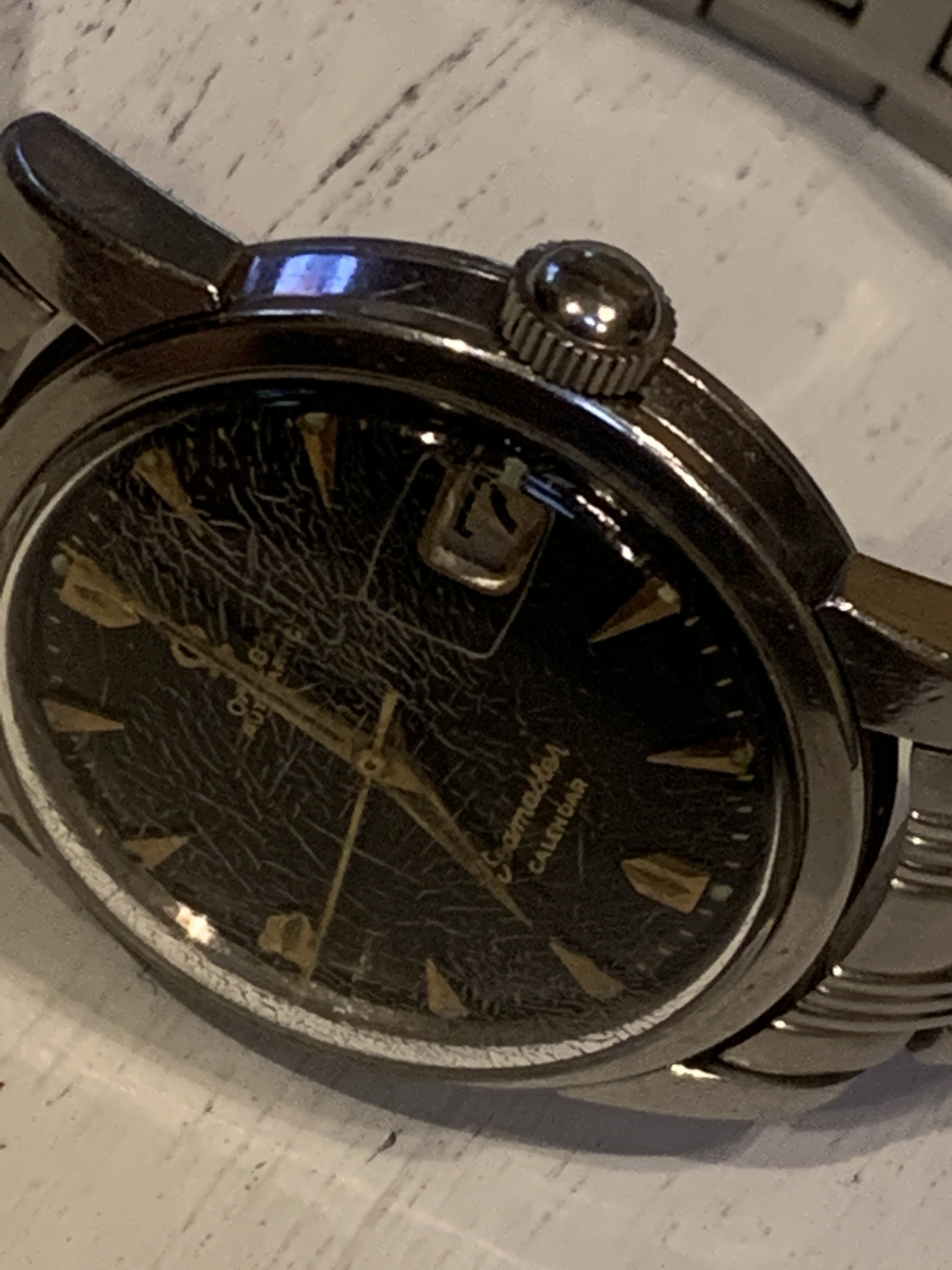

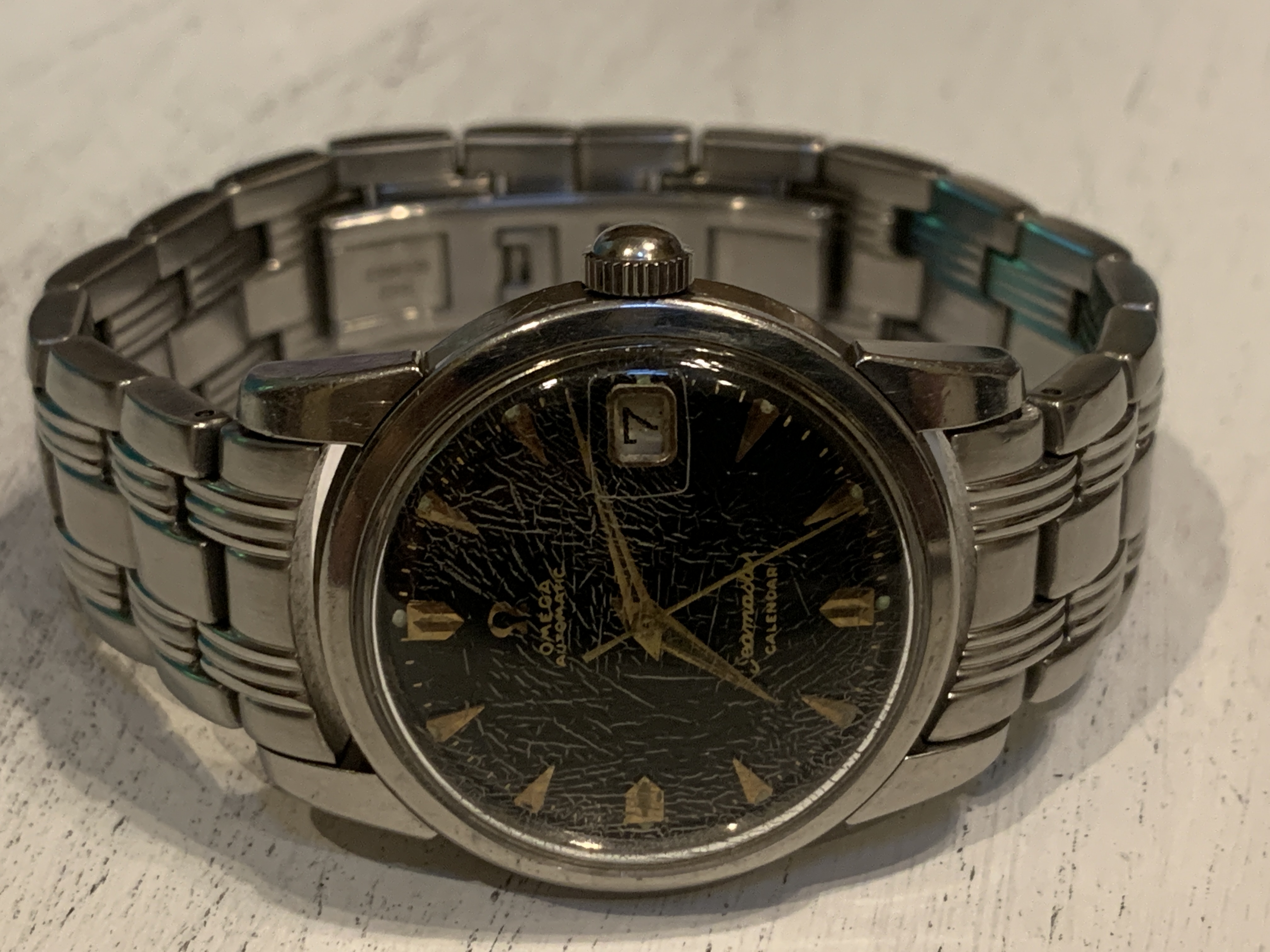

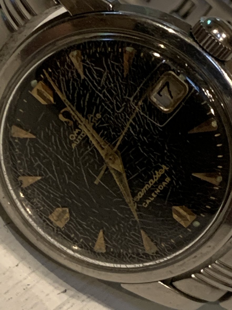

Looks like it will clean up very nicely with a service and new crystal. I love these black glossy dials, there's nothing else quite like them and when you get one in good condition it's a beautiful thing. Here's my 2849 for comparison
12
8

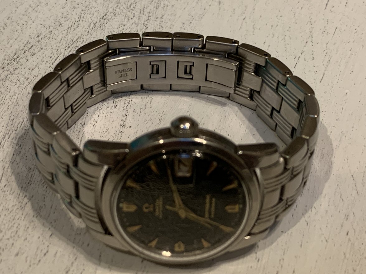

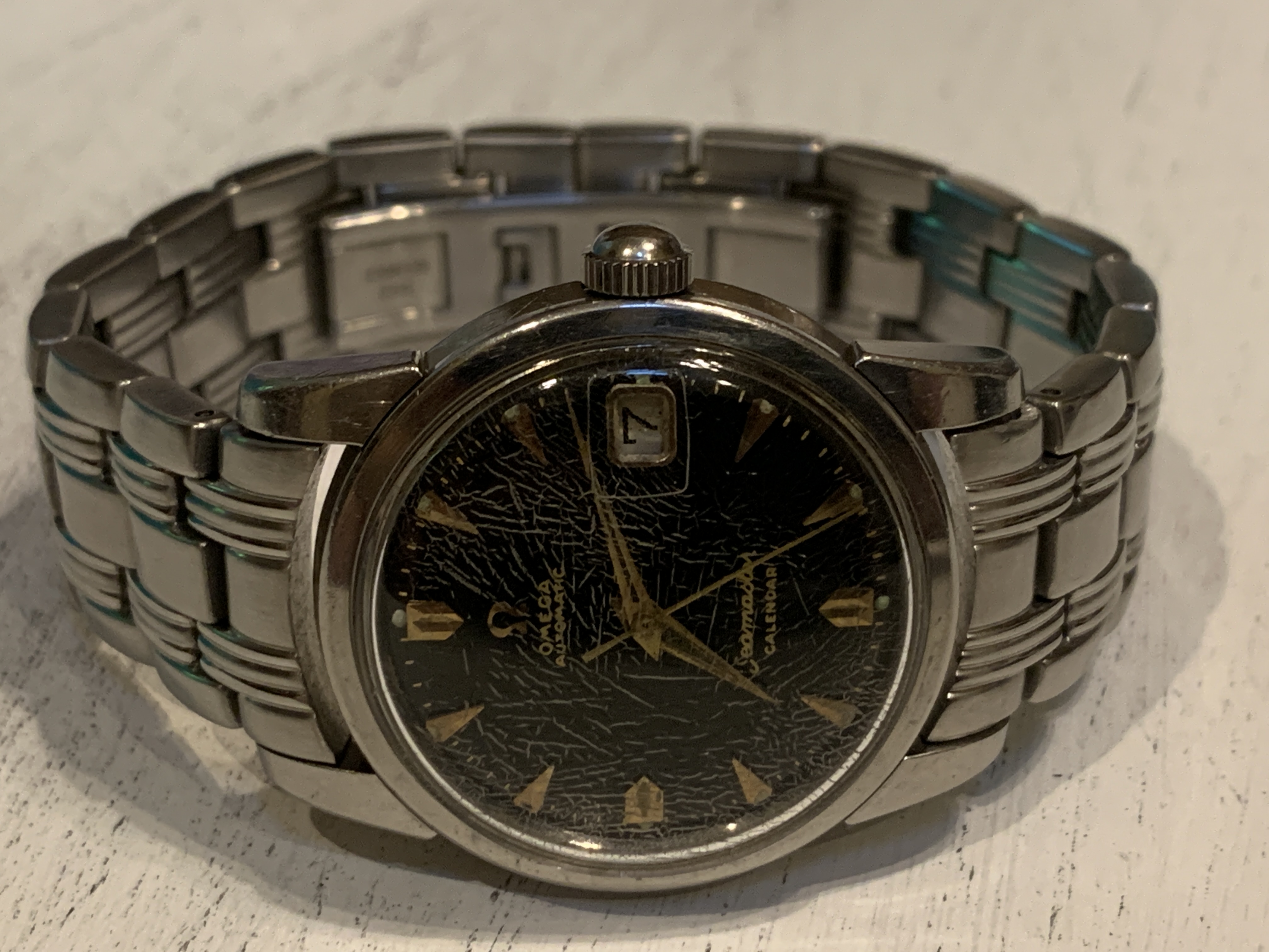

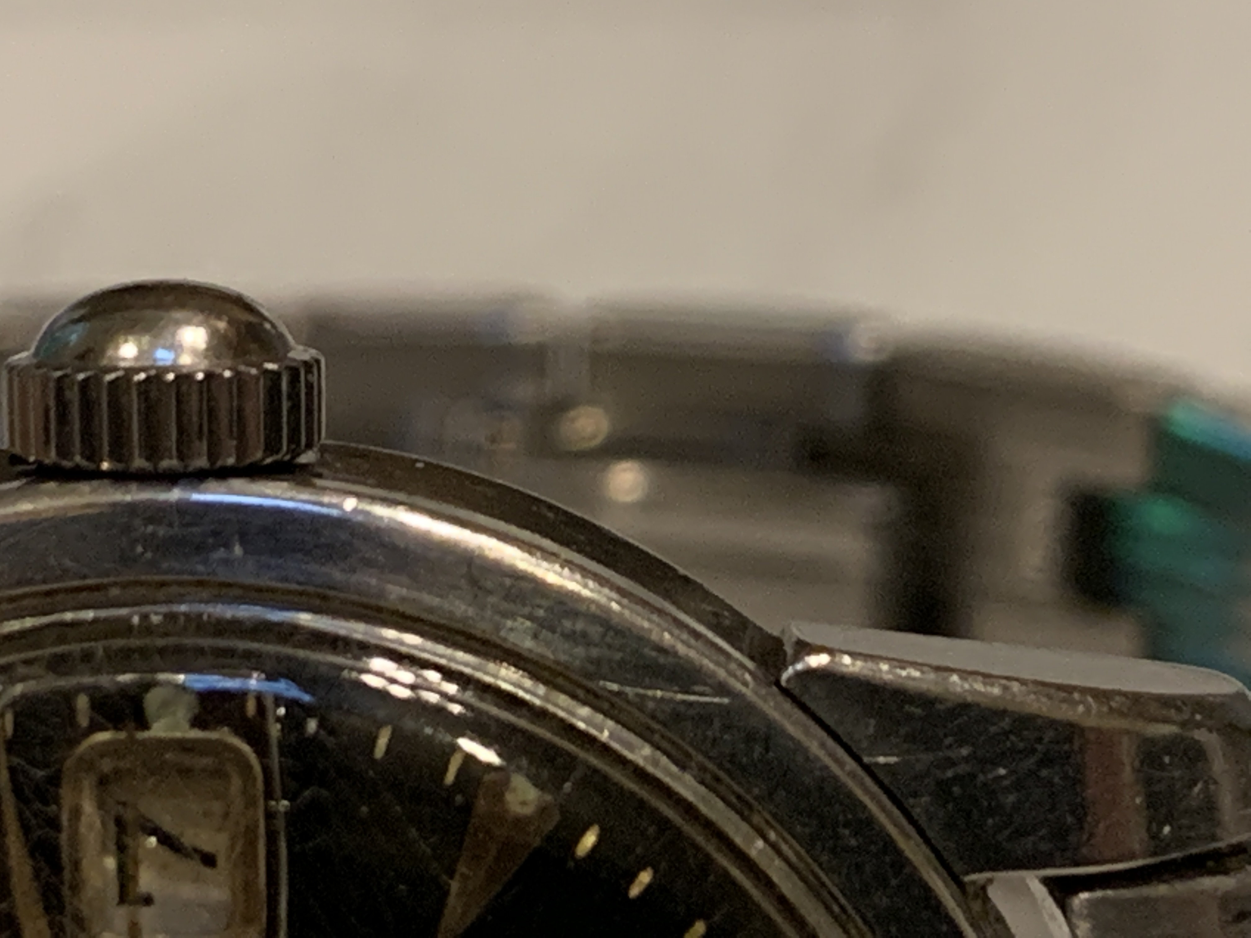

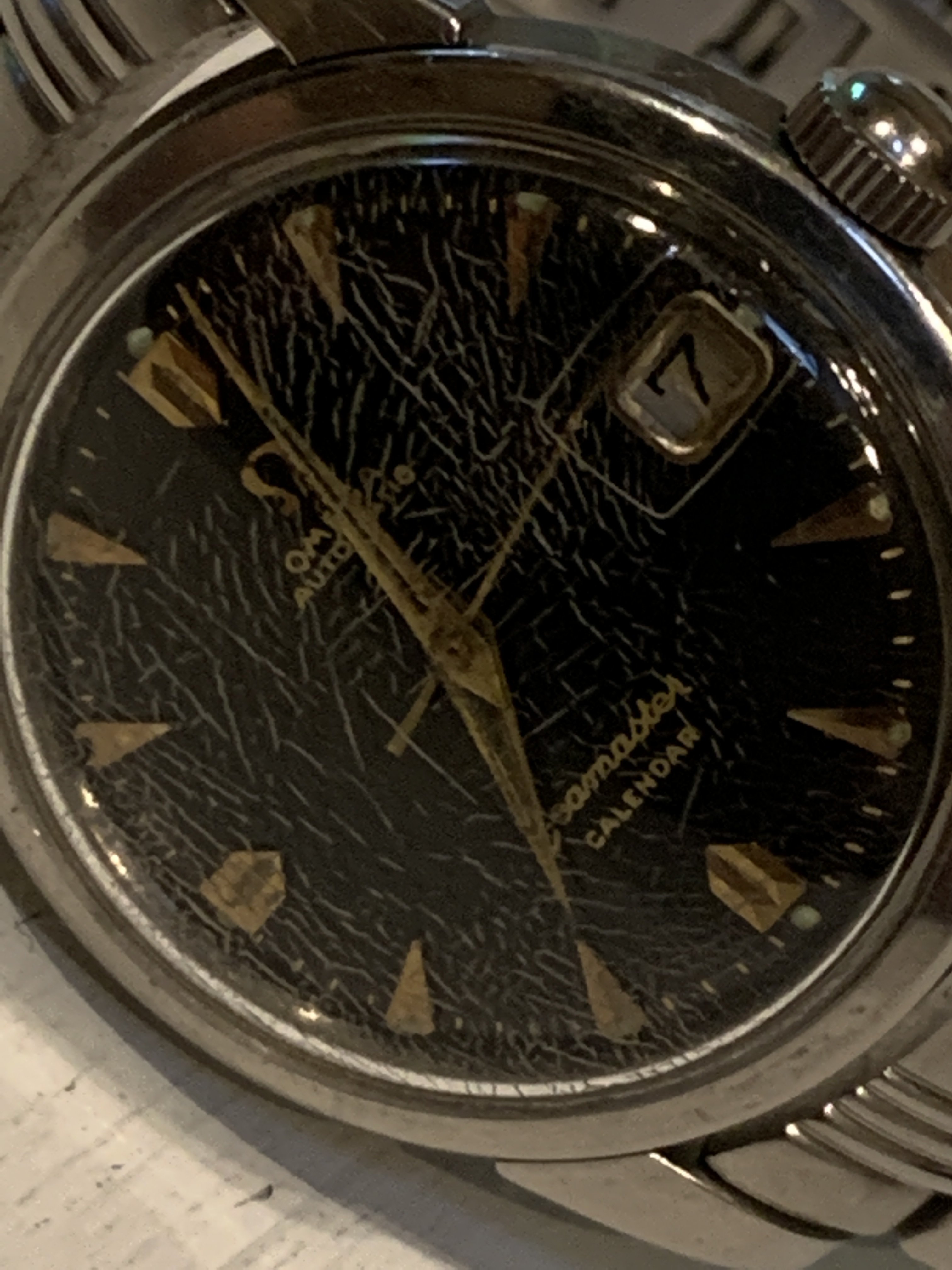

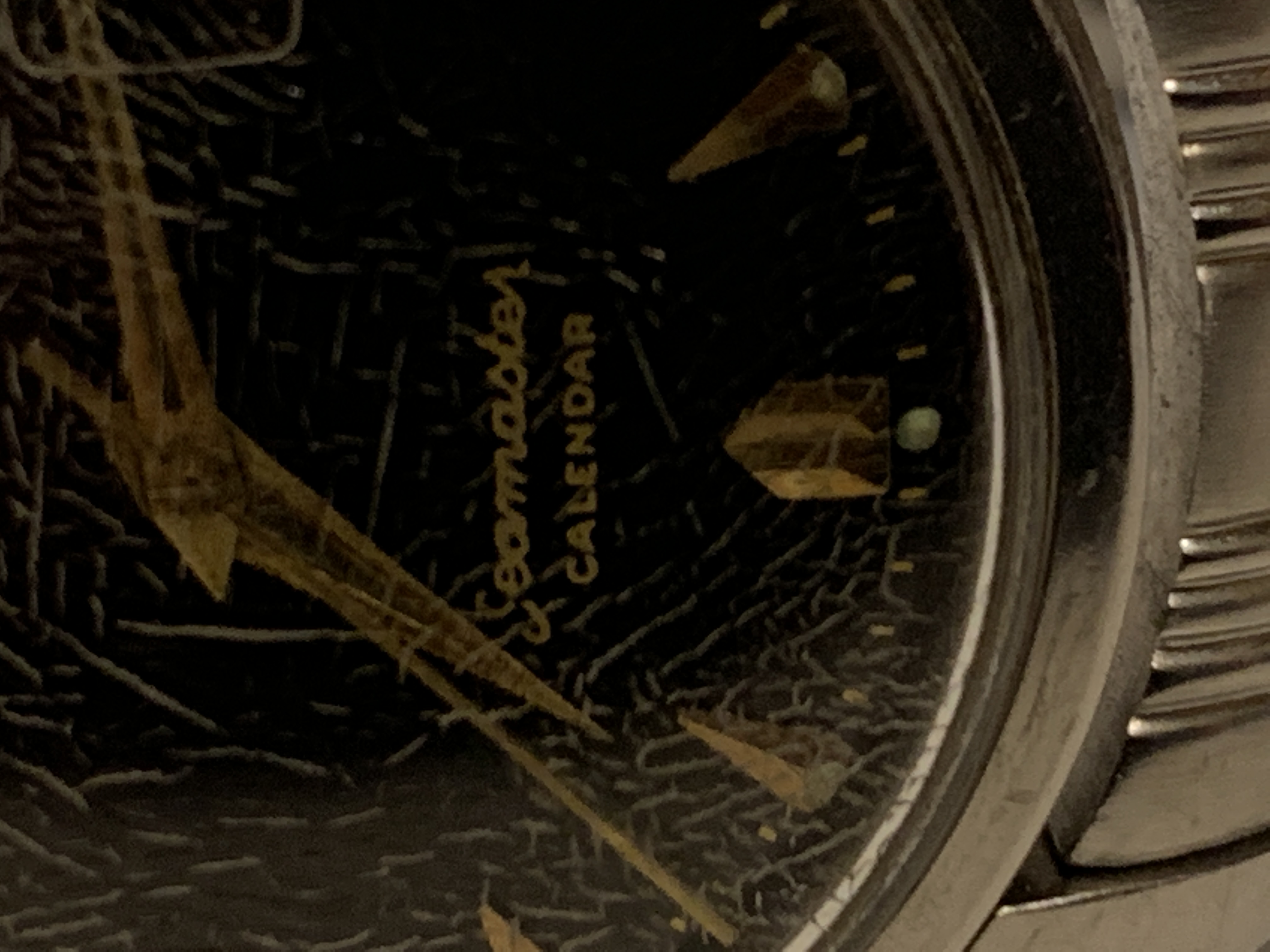

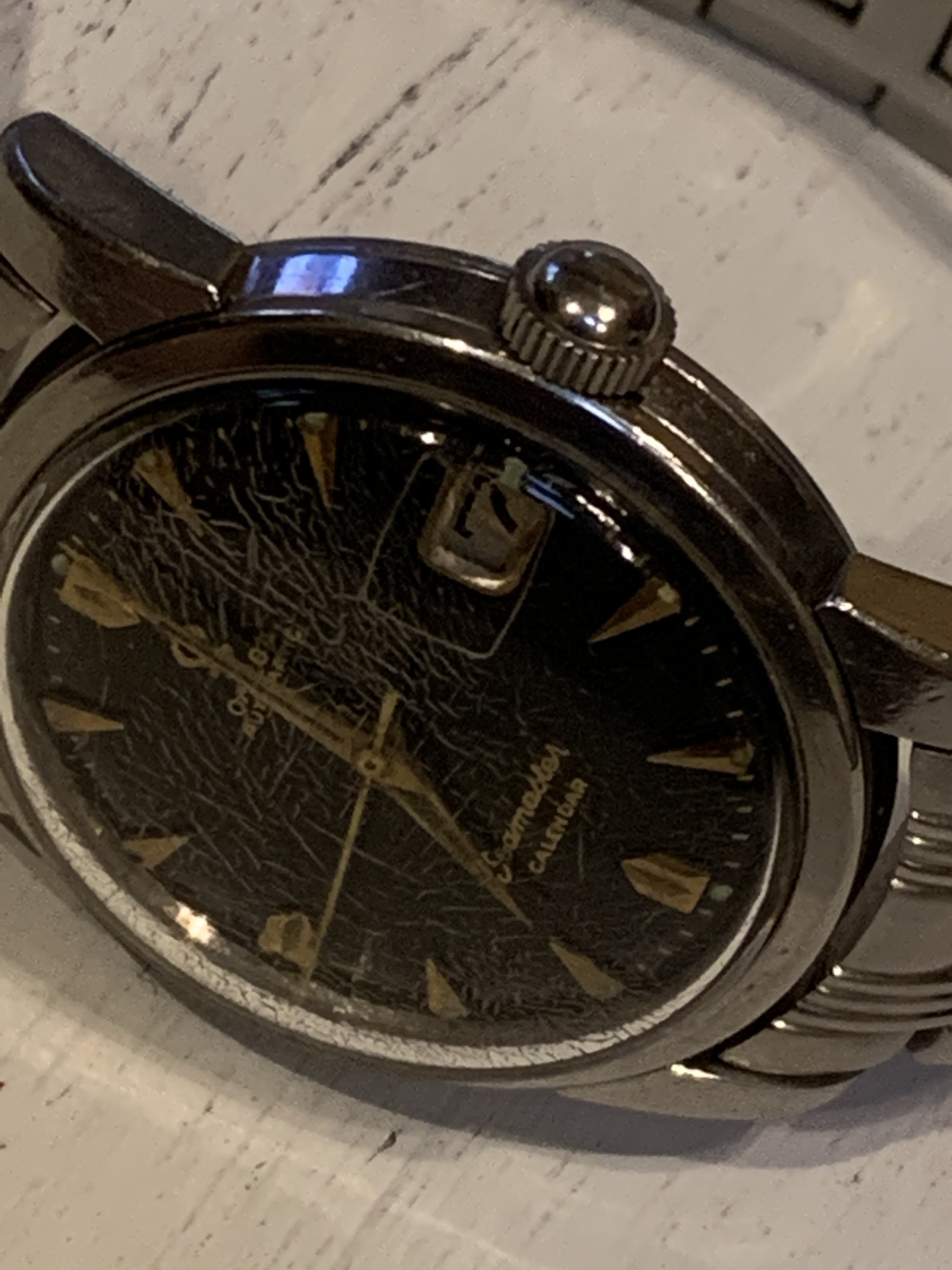

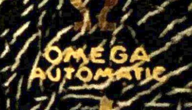

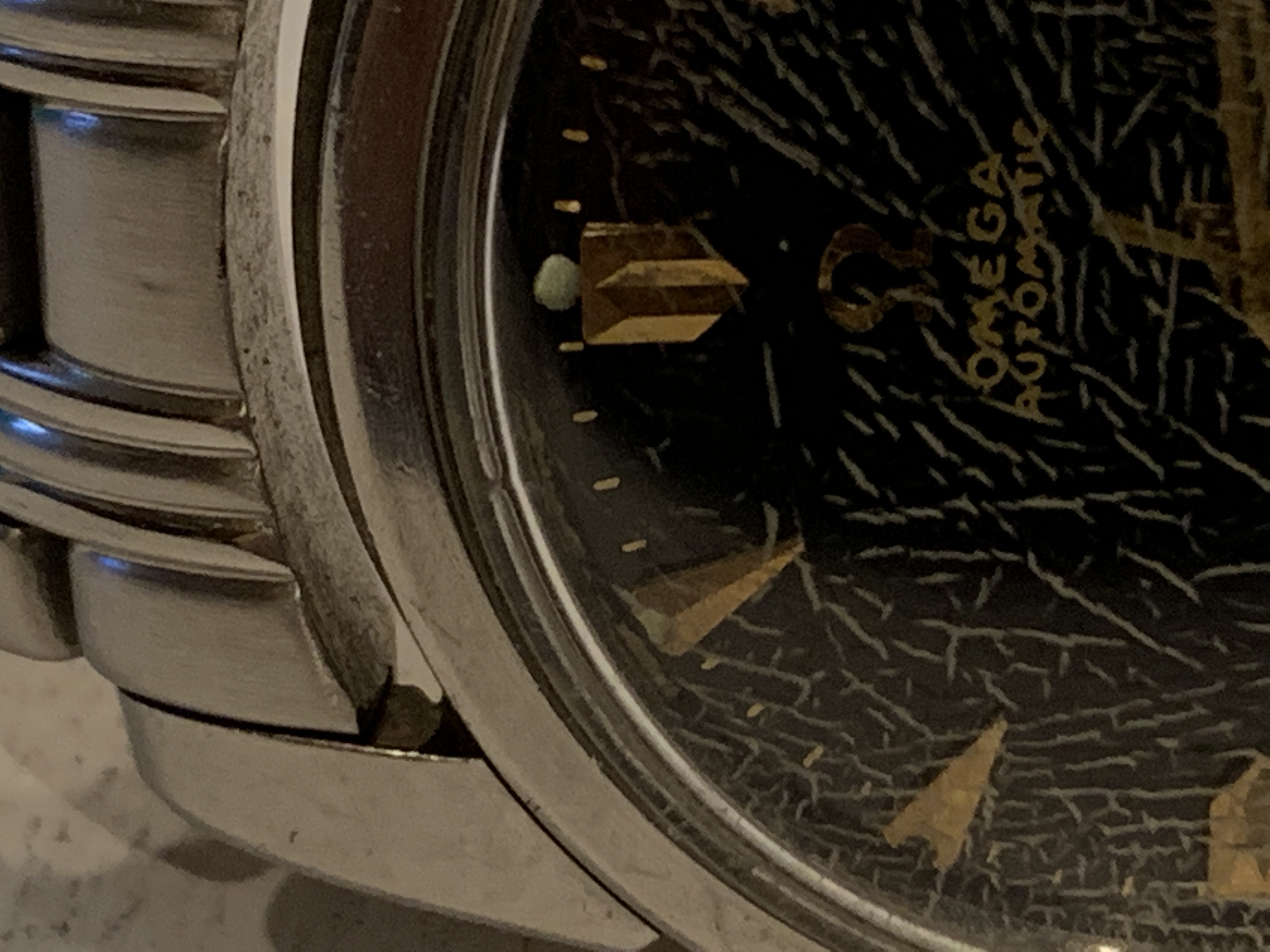

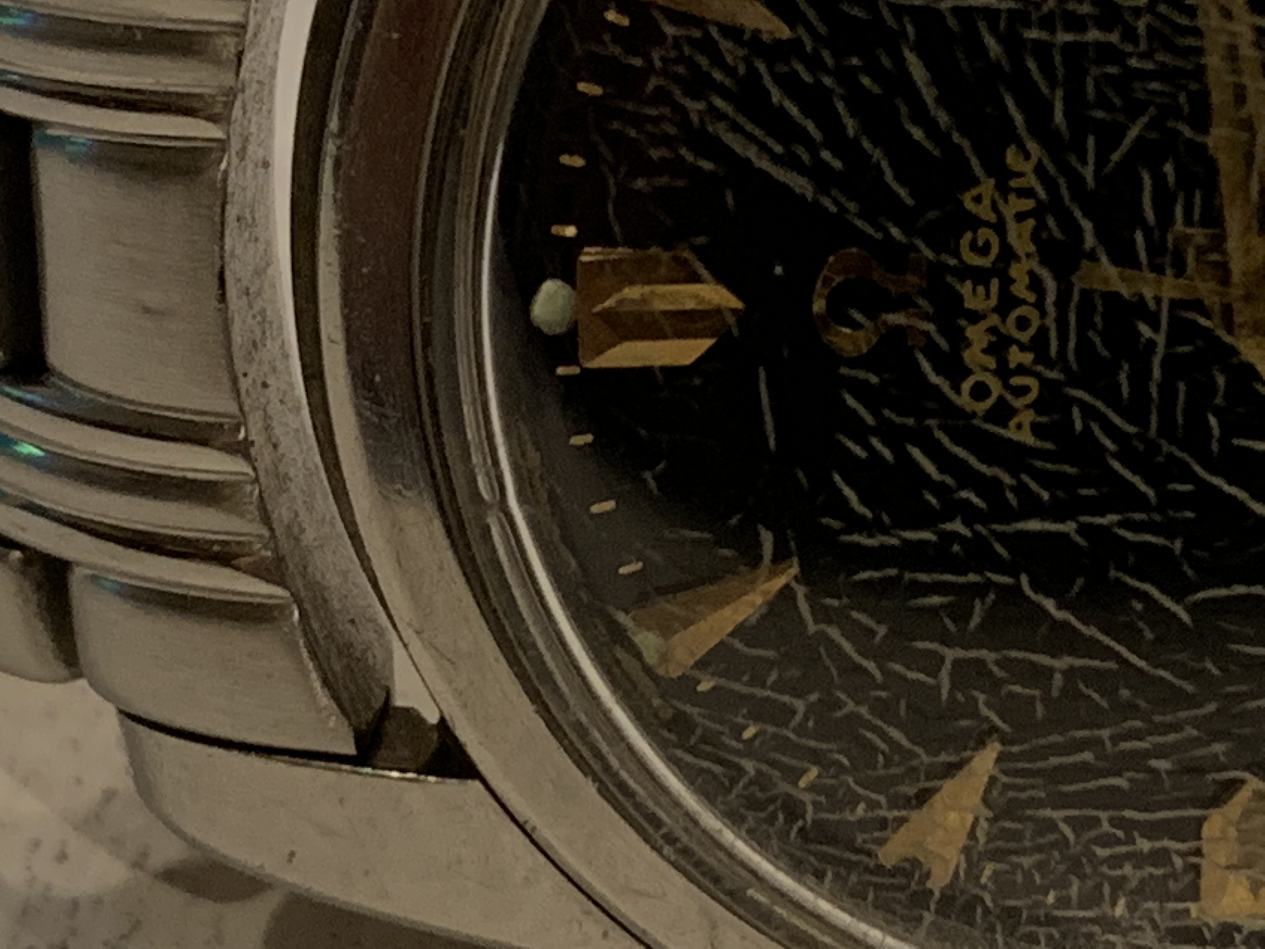

Does anyone know the correct crystal for this? Is the the PZ5140? I’ve also seen PZ5000.
5,631
5,815
The PZ5140 is a half millimeter taller than the PZ5000. Either will fit but....
As for sending to Omega, they wouldn't replace a dial like that in good condition. They would, however, refinish the case.
Omega service is not evil, it just depends on your goals. You've said you prefer the case as it is, so a local watchmaker would be better.

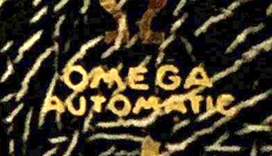

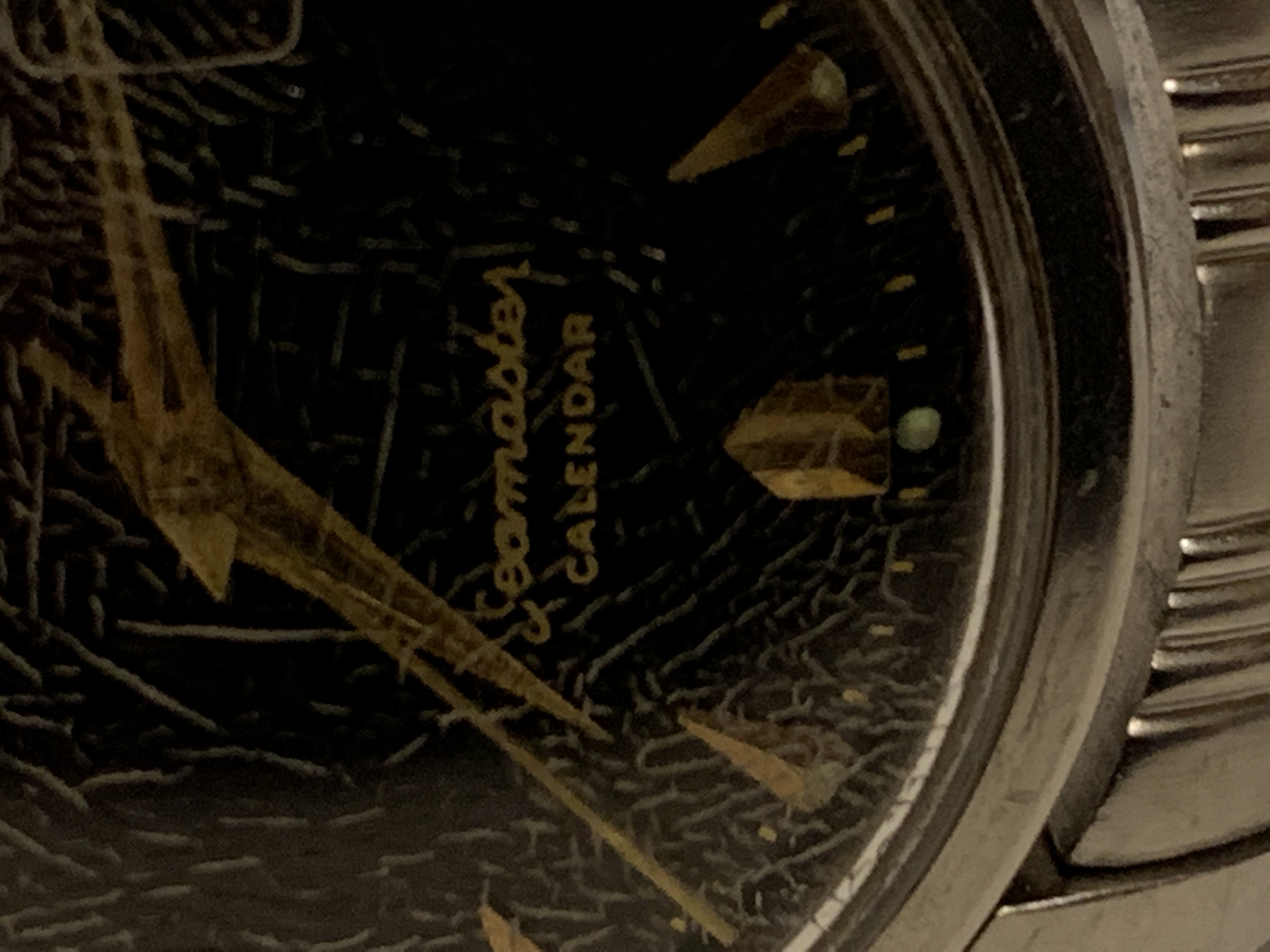

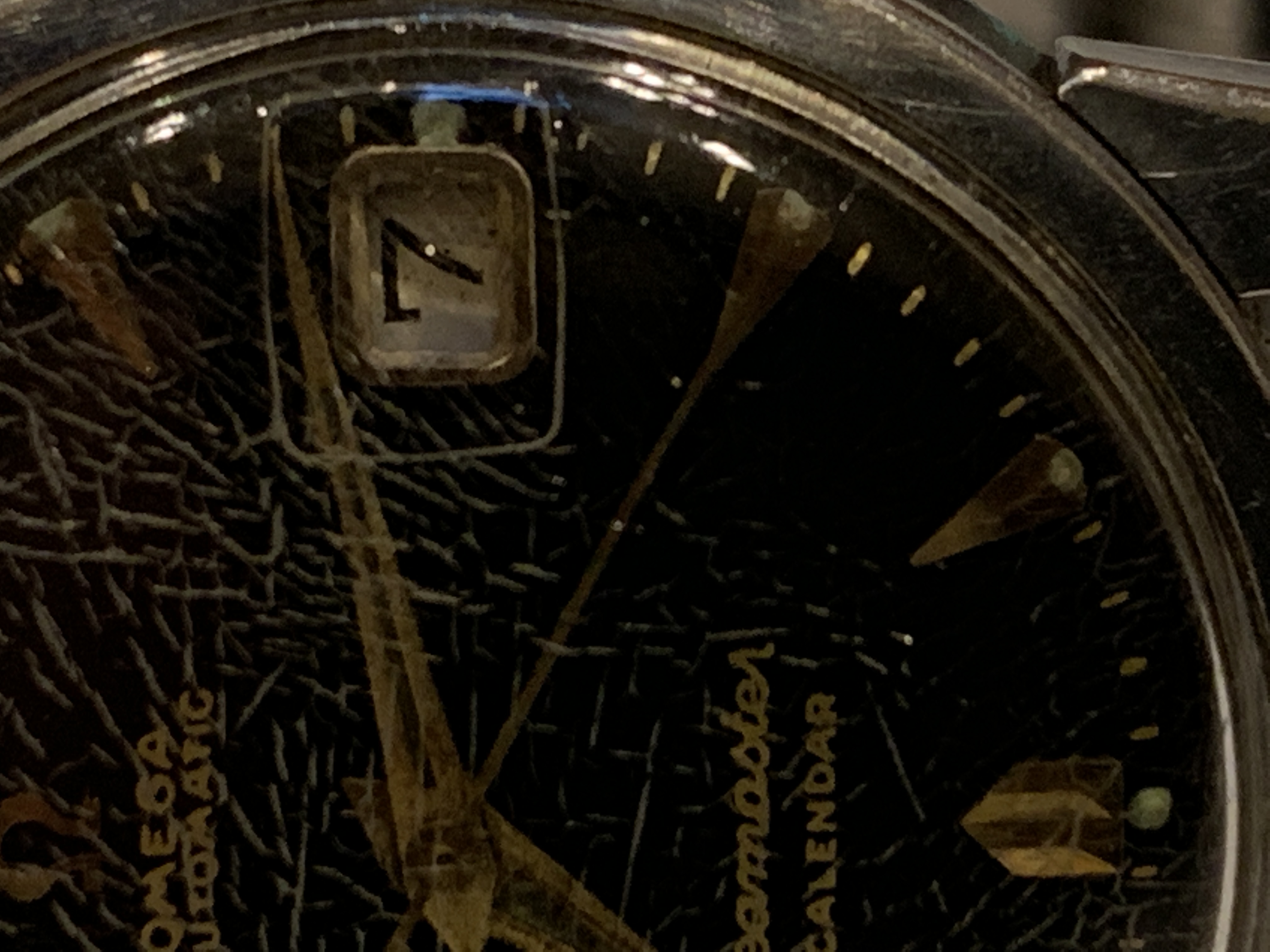

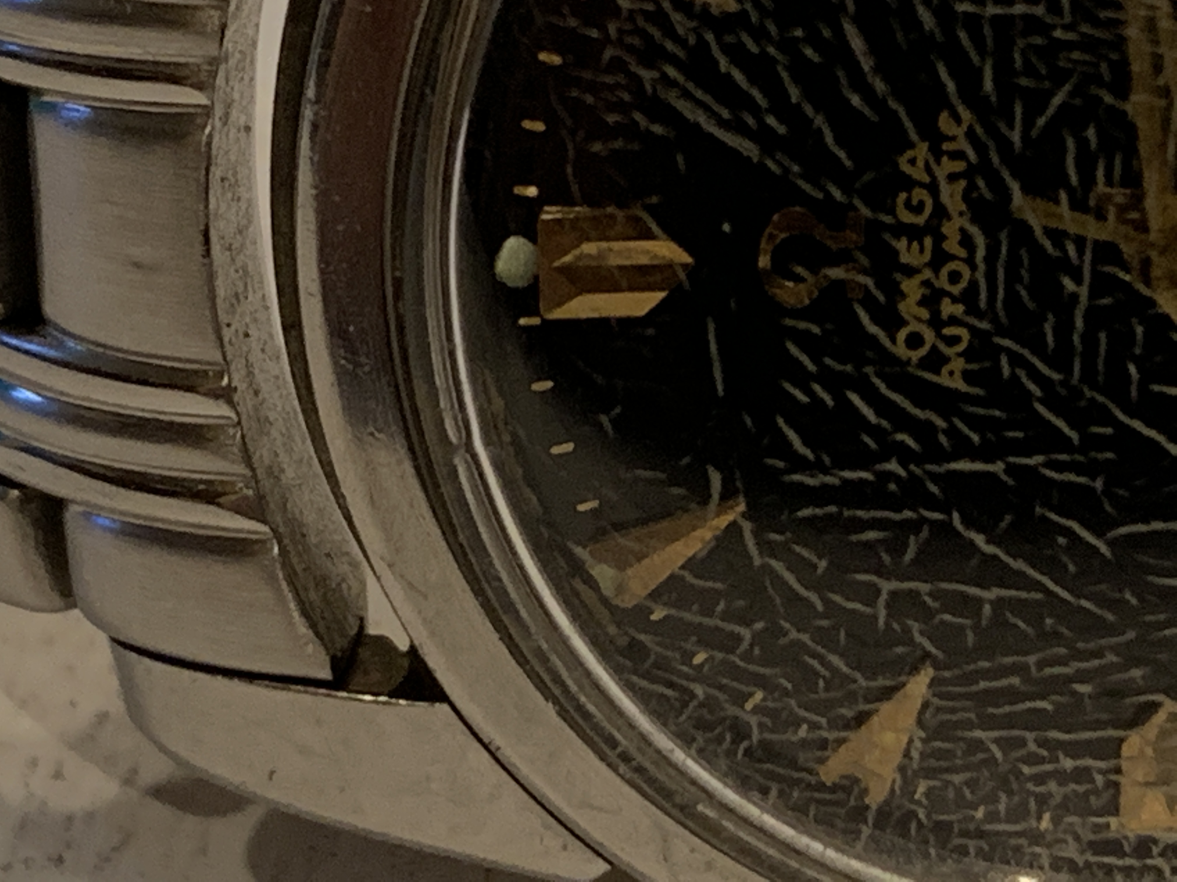

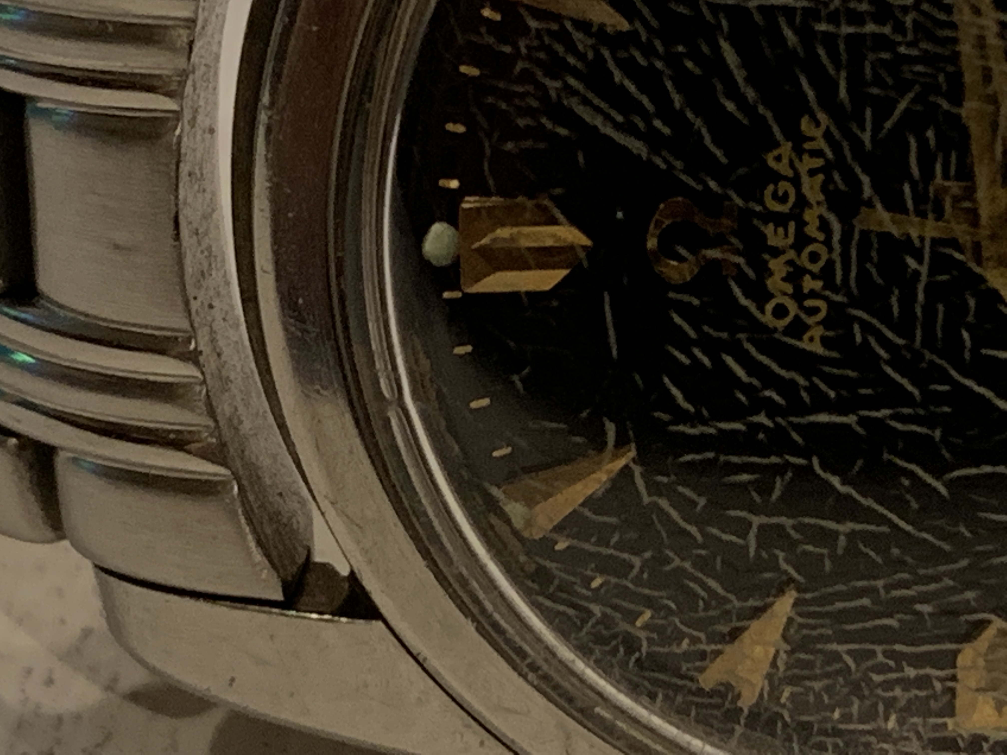

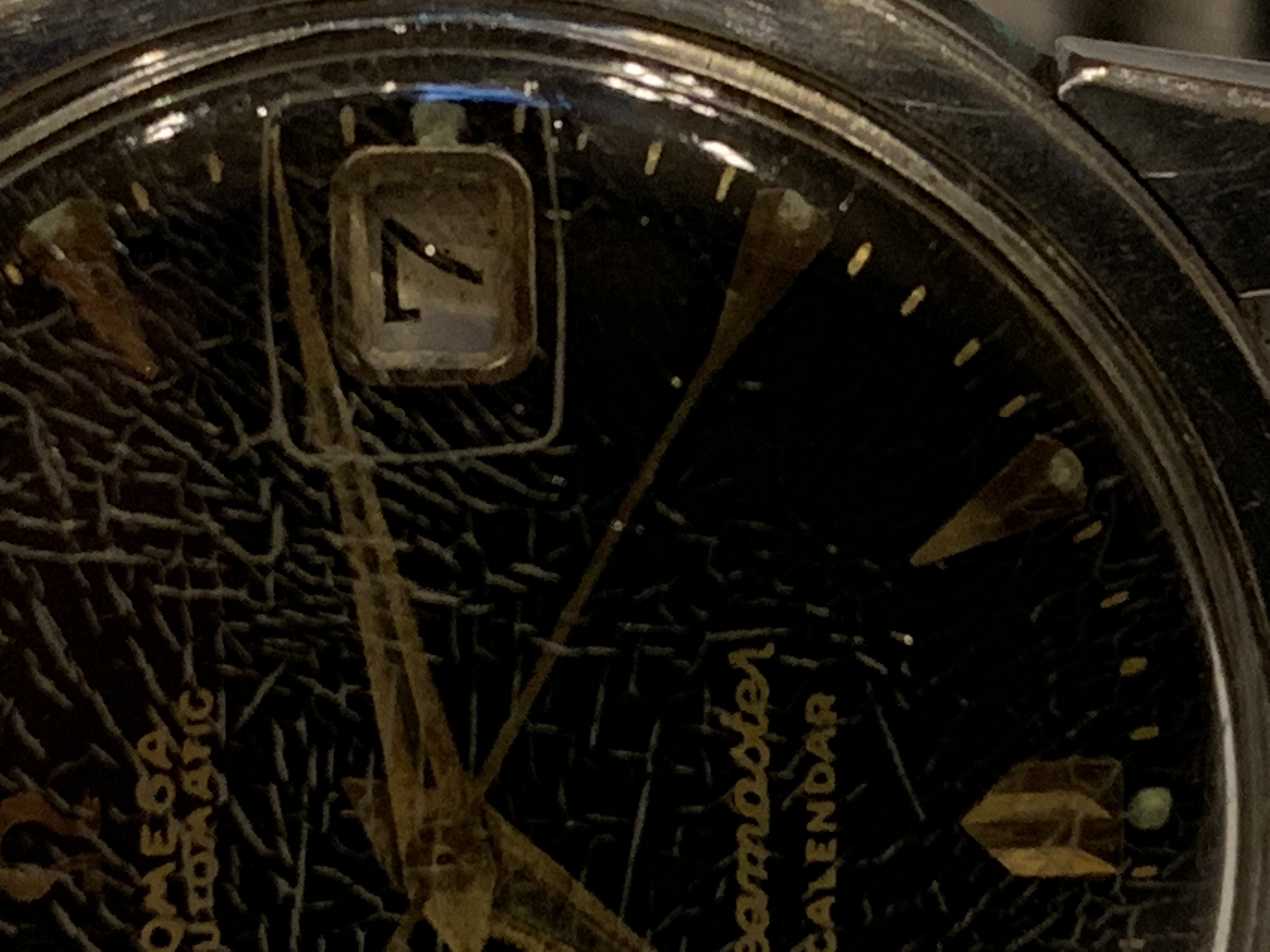

The printing looks quite crude in those photos, but it's hard to know how much of it may be associated with the condition of the crystal.
