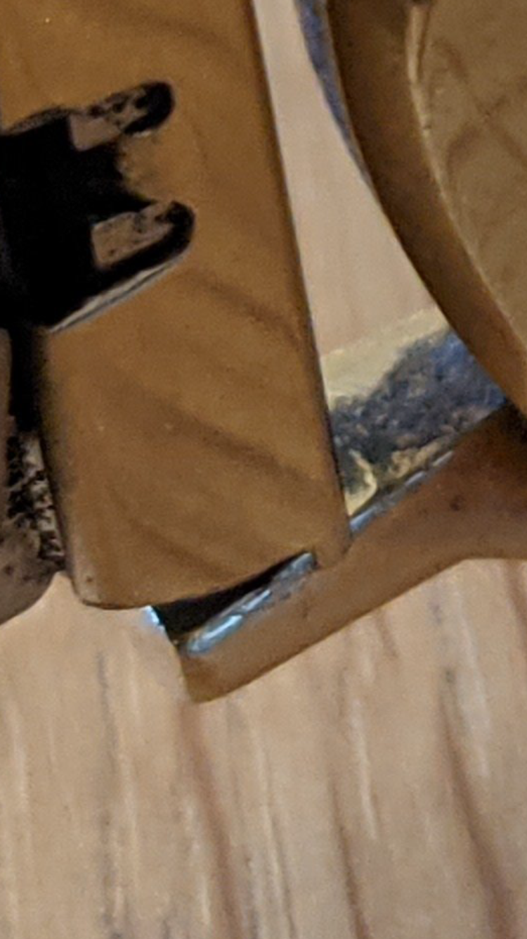

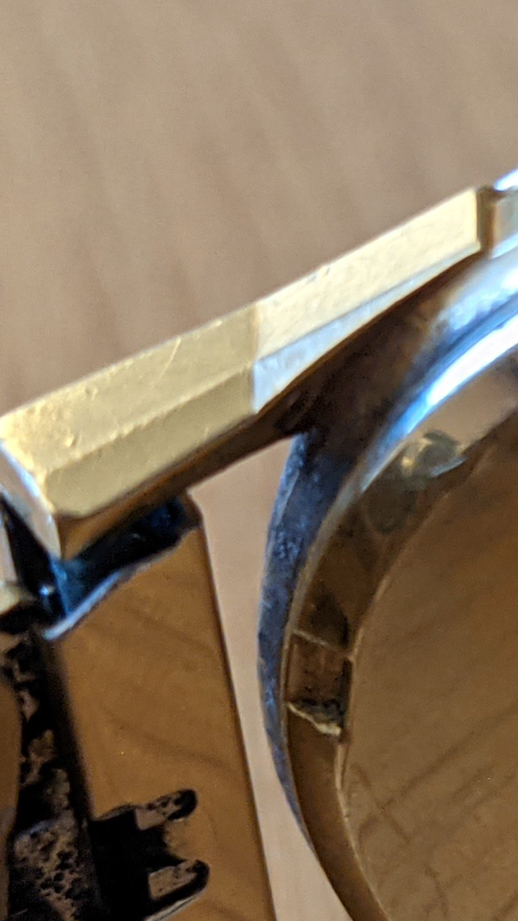

6,801
10,456
I am fairly sure the case back is gold as well.
this may change matters significantly.
You may have a solid gold dogleg case.
which would make sense of the side facets on the lugs.
One lug looks like gold cap but the one above it looks like it may have a hallmark. (see below)
if gold cap, it is worth less than a SS watch.
If solid gold it will be worth significantly more.
best find out from your watchmaker tomorrow.
