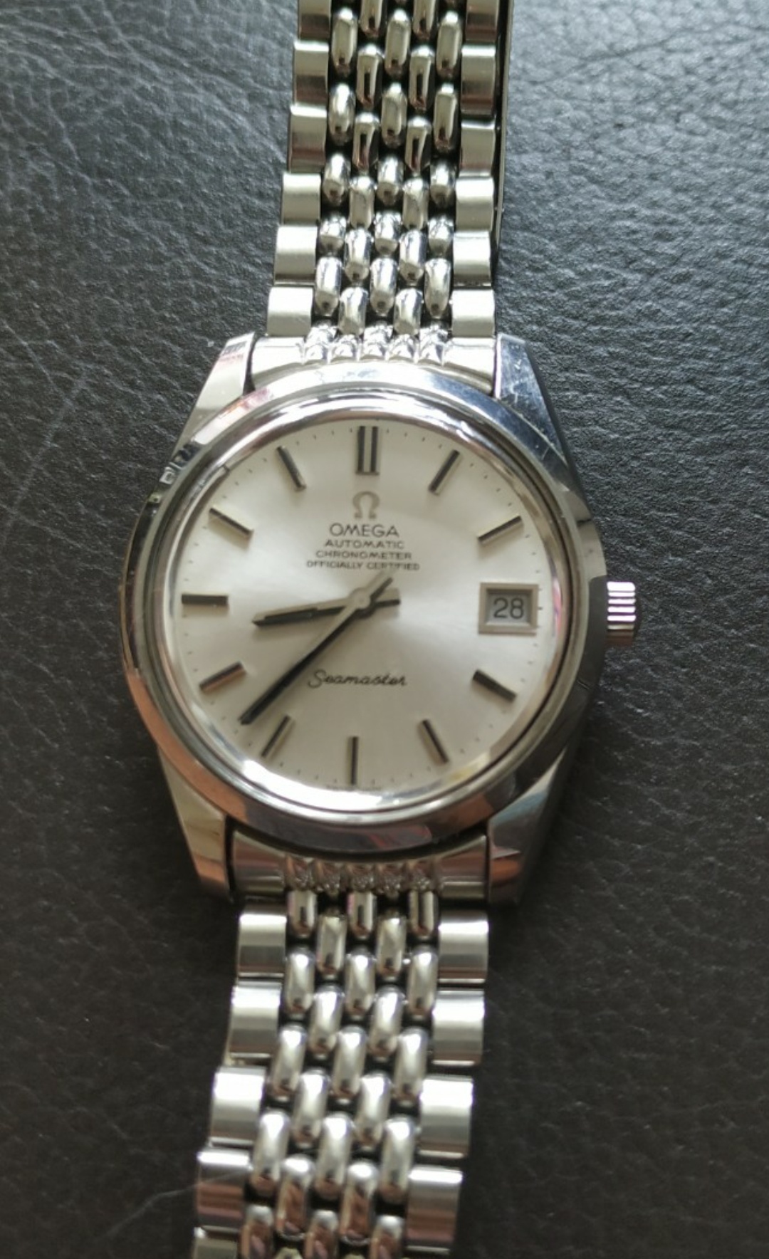

Hi,
I recently acquired a vintage omega seamaster ref 168.0061 but the crystal is not original. I would like to purchase a new one myself but cannot find the part number or specs like diameter or height. I tried to ask Omega directly but no luck there.
Does anyone here would have this information?
Thanks
30,280
78,141
063PZ5236 | GLASS PLEXI ST RING D30.62 H4
Cheers, Al
21
6
@efauser and especially @Archer thanks a lot for the information.
I already found the part online and placed an order.
By the way, there are 2 small cracks on the bezel, not scratches, any idea if it is possible to repair? Like a filling?
Otherwise, It looks like the bezel is removable, can it be replaced in this case?
Thanks!
8,701
14,612
laser weld. Do a site search, there are a lot of posts on the subject.
