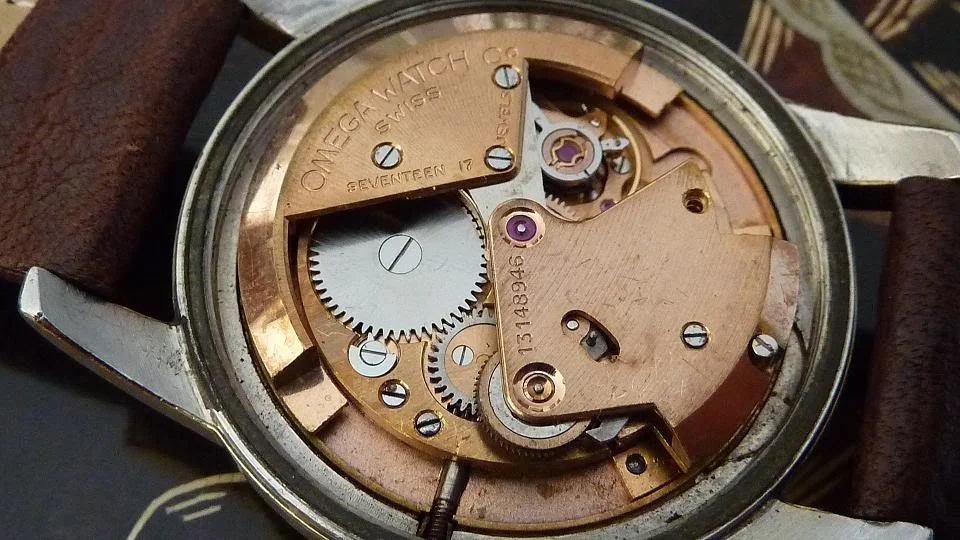

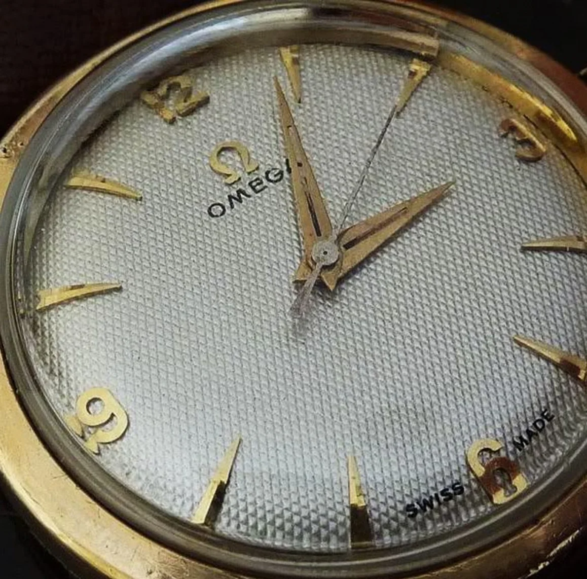

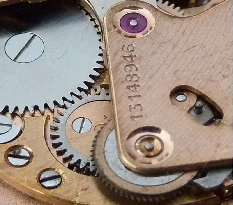

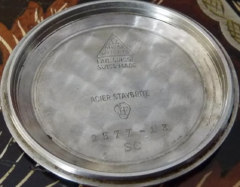

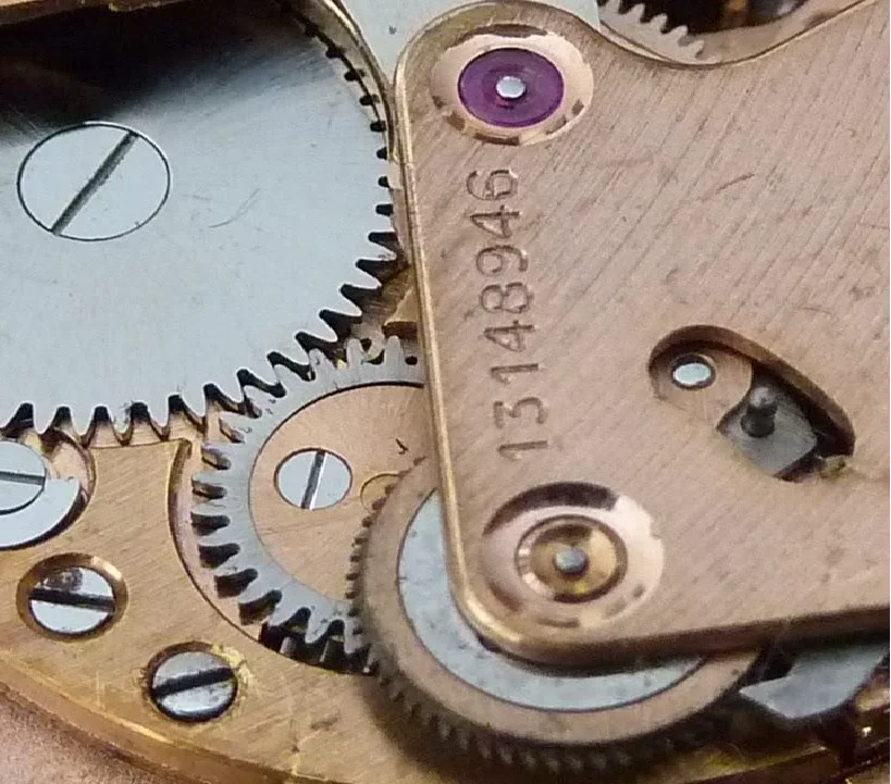

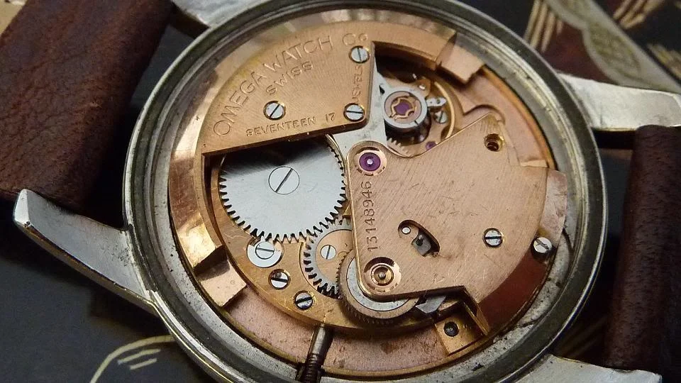

Gentlemen,
I have this vintage Omega - cal. 354, "Tropical Waffle" dial, Omega ref. 2577 13 sc, ref. 13148946 (pls see the photos). But I cannot place this particular model!
Everything points to early Omega Seamaster series, but there is no "Seamaster" written at the bottom of the dial...
Please help to identify the piece.

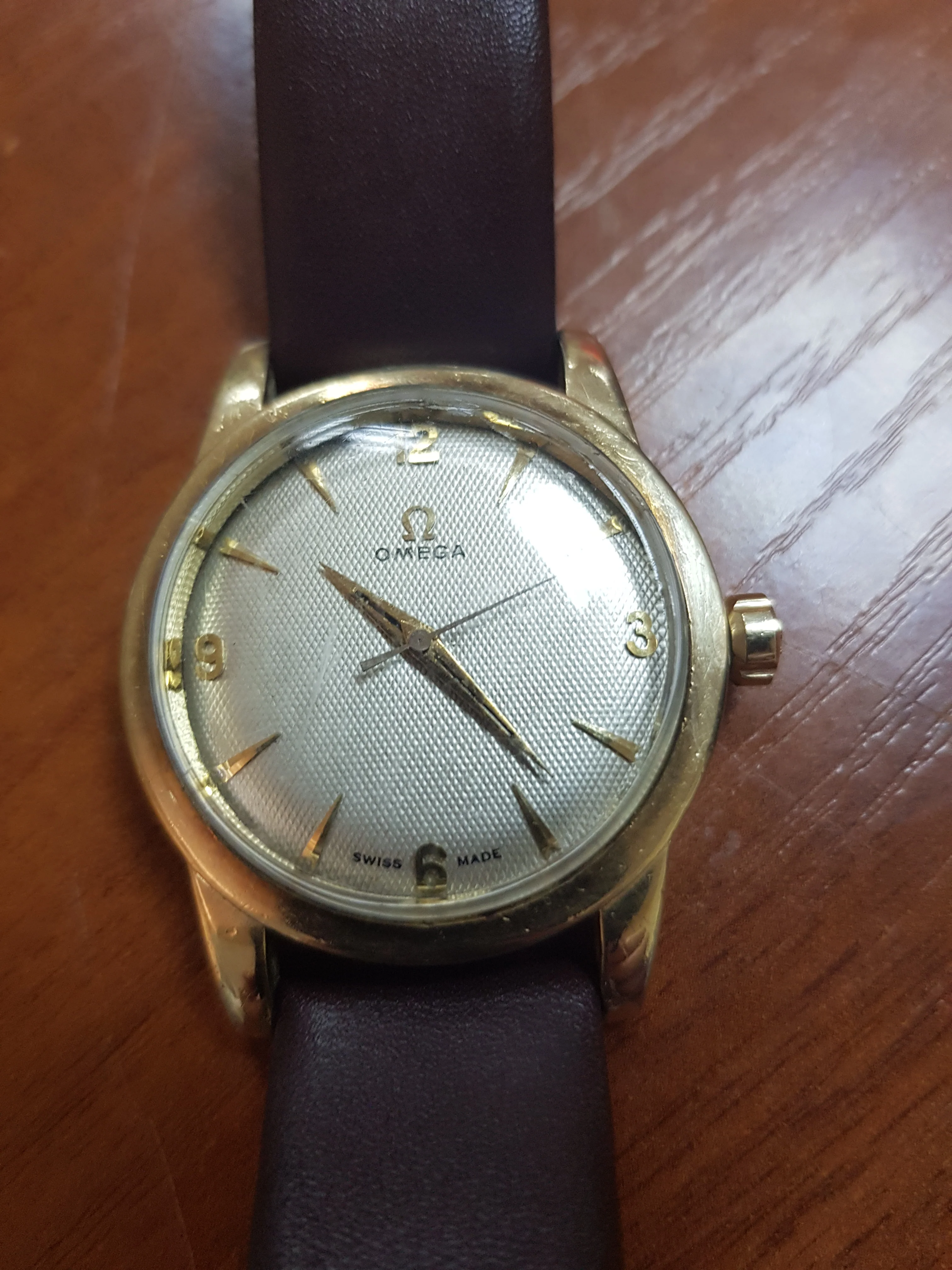

It’s ok that sometime there is not the word Seamaster on the dial.
Now someone pointed out it is refinished already 😀 so I was wrong
2,816
6,951
The dial has been repainted. Missing Seamaster is ok for earliest serials, but missing Automatic is never ok on these.
24,843
55,270
I think there is a whole thread for the ref 2577, and many of them don't have Seamaster on the dial. The OP dial is definitely repainted though, not because of the missing Seamaster.
