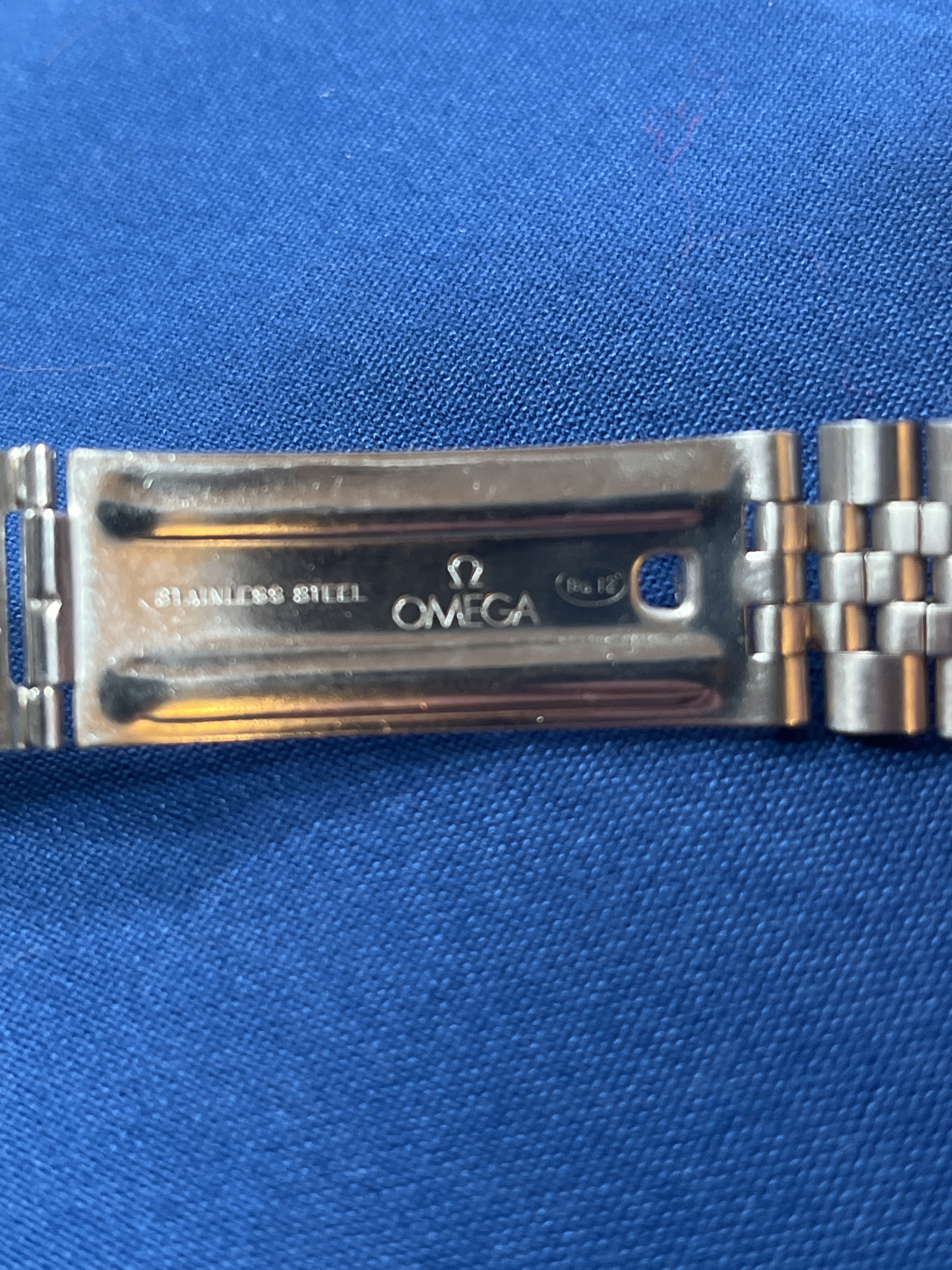

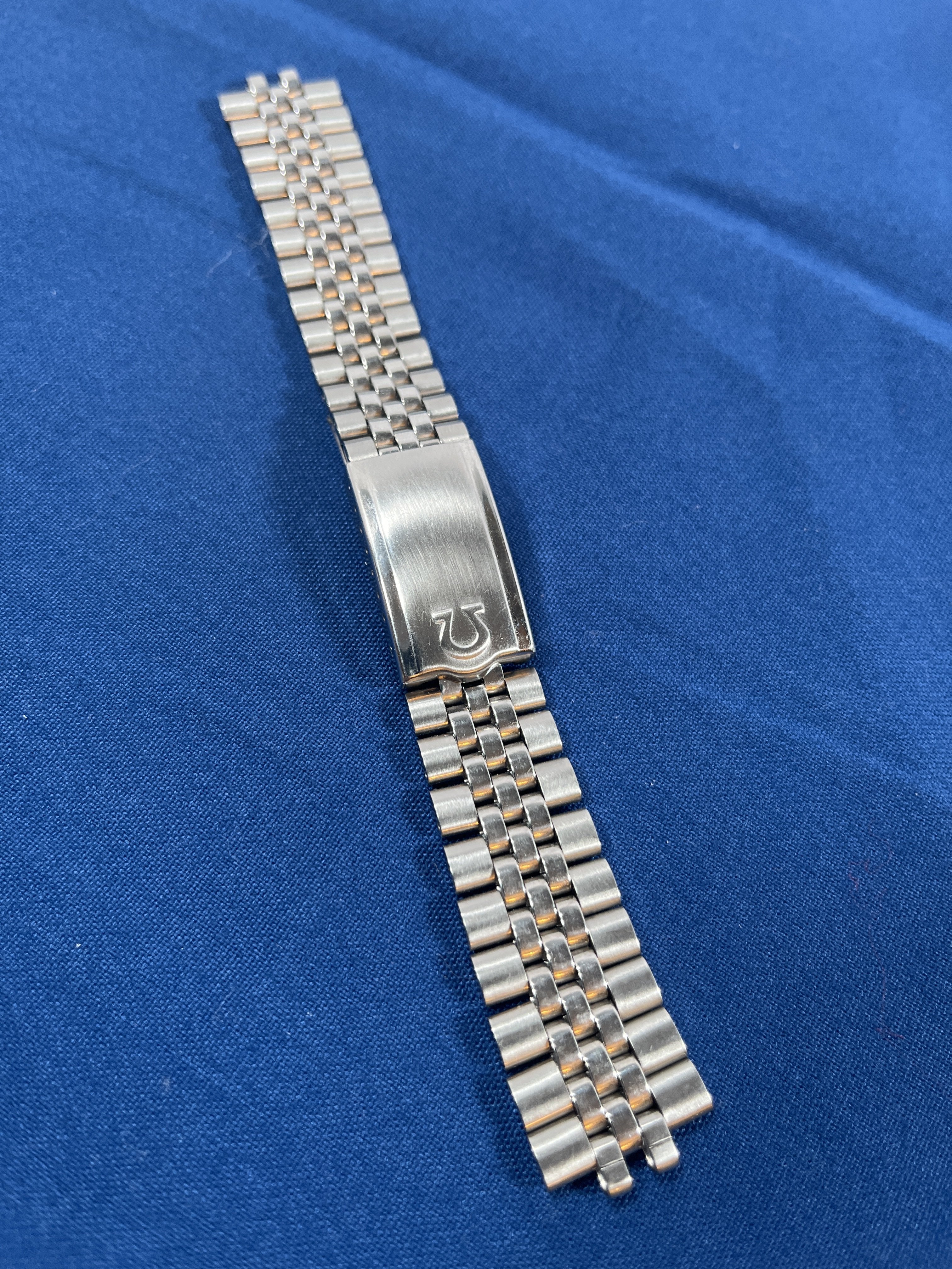

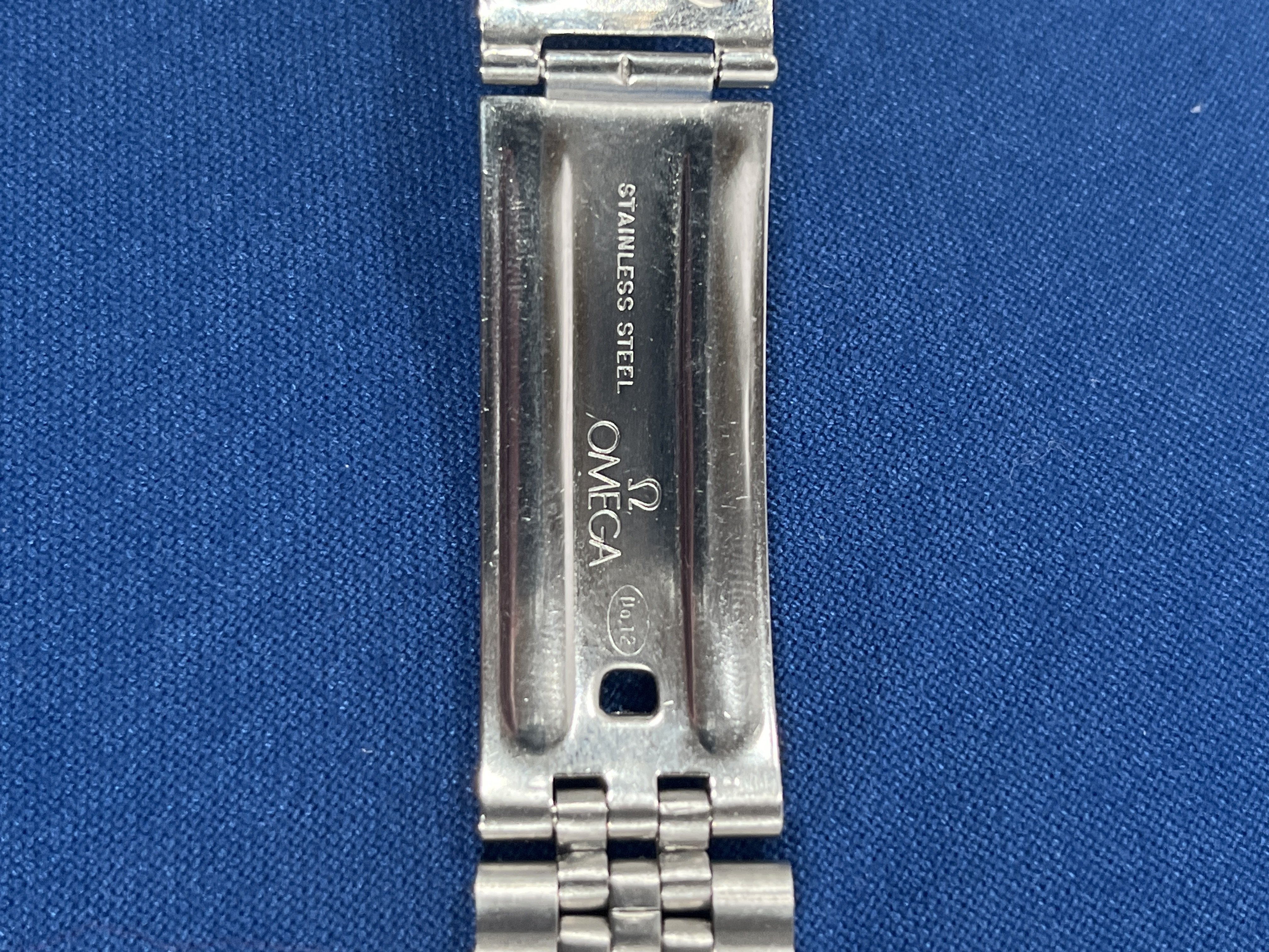

This is an estate sale find. Hoping someone can confirm it’s authentic and give me some direction as to date. Thanks for any help you can offer!
792
845
Probably late 1960's or 1970's. Sometimes they have a date on the clasp, but this isn't always the case. The clasp is authentic and the rest looks right. However, it is hard to say what it goes to without the endlinks and reference number. Oftentimes the four digit reference number is stamped on the clasp.
4

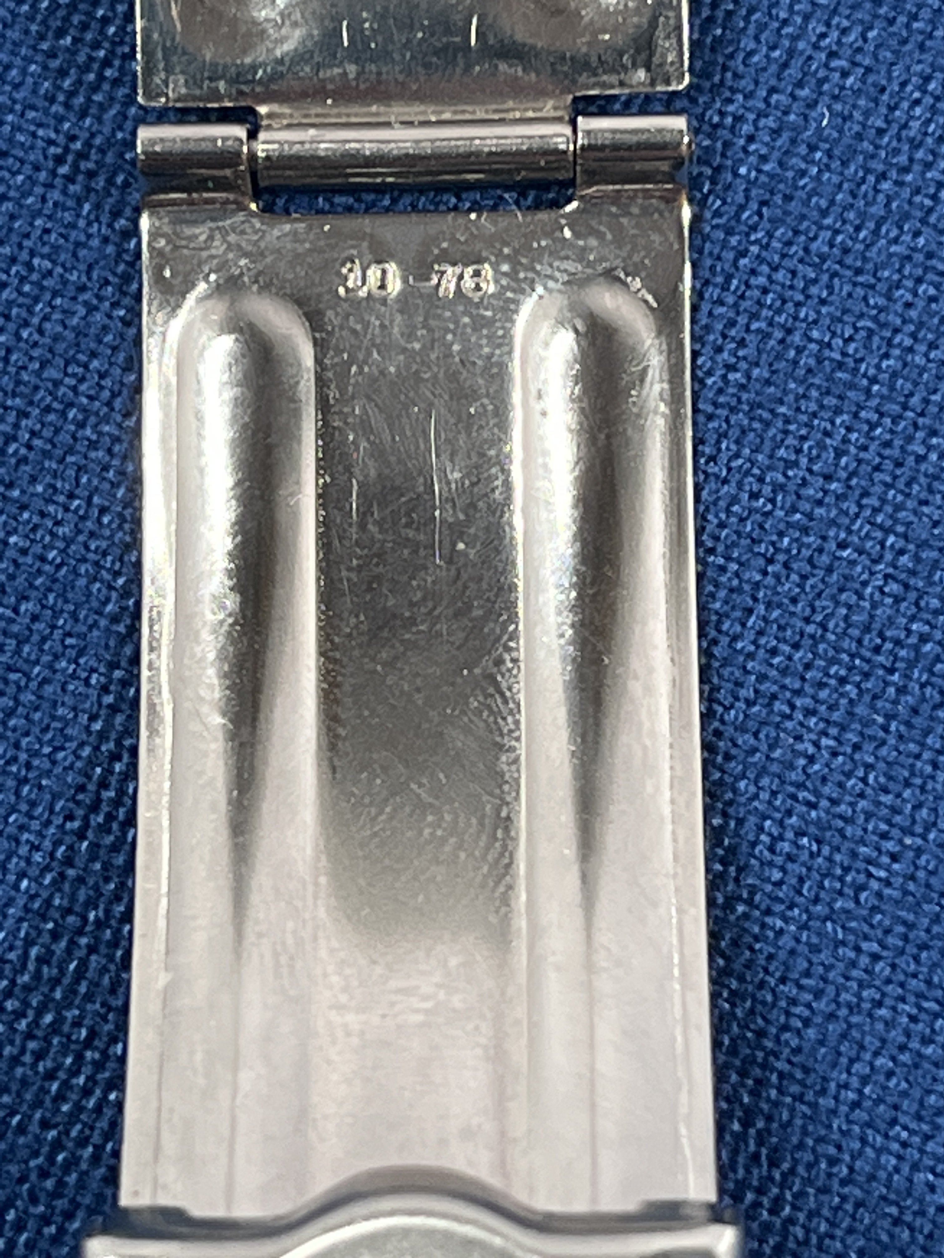

That’s what I was thinking, thanks for the confirmation! Here is the number on the clasp. It looks like a date instead of a model number to me. What do you think? It says 10-78
1,024
4,126
Hi, I think the clasp looks original but I'm not sure about the bracelet.
However, why don't you post the photo focusing the clasp, not the background (red arrows).😁
