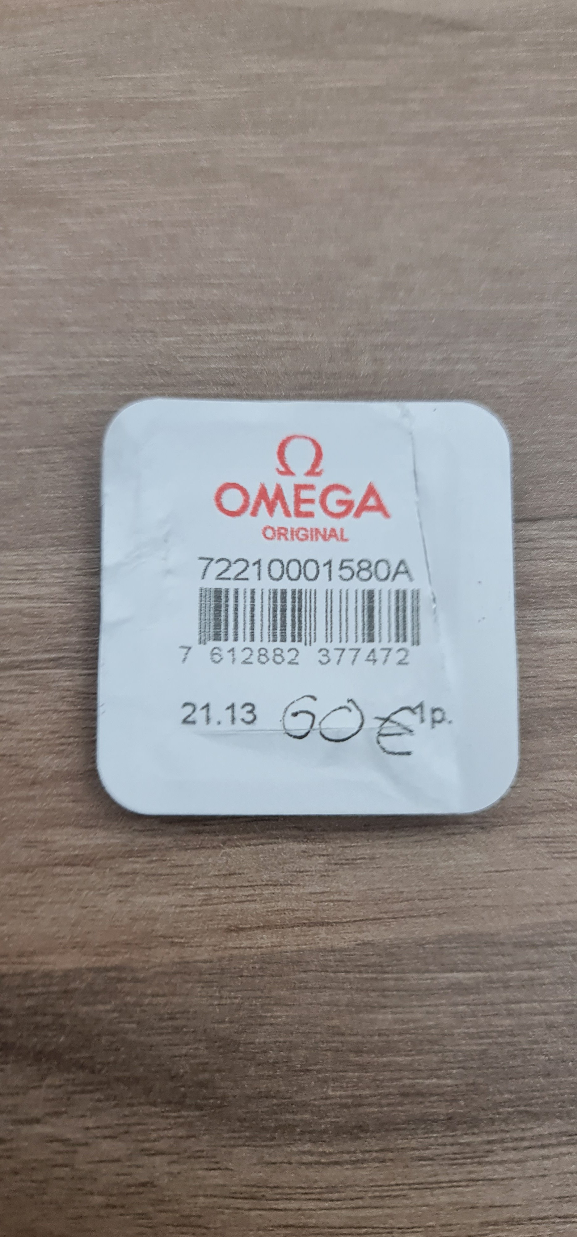

Hello to all friends, can anyone tell me the part number for the disc date of the ploprof 600?
It's twice that Omega sends me the one sent to mount it on the right hand.
This is the part number of the wrong one.
Thank you for those who will help me.

If you are ordering these directly from Omega you would have access to the Omega Extranet for looking up the part number. Omega will only send you what you order, by part number.
That is the correct date indicator for the stem at 3, and the date at 3.
The date indicator for the date at 3, and the stem at 9, is 72210001589A.
Again, all this information is readily available for watchmakers with parts accounts, on the Omega Extranet.
Cheers, Al

Thank you very much for your valuable help and sorry for the delay in responding
Max
