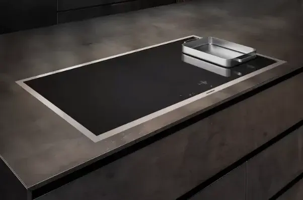

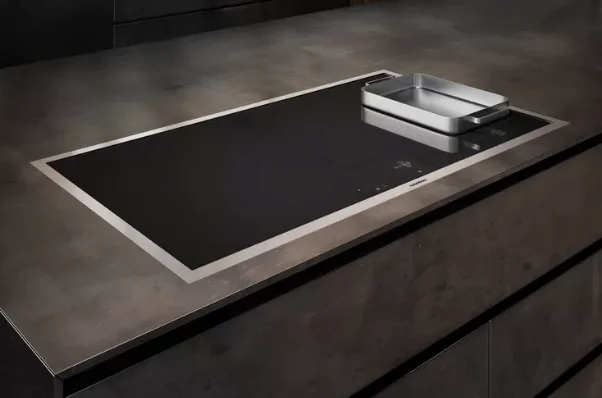

We did a total makeover, and renovated our entire kitchen a few years ago.
And I did a lot of studies regarding gas versus induction.
Even tried them out for some cooking etc…
And we choose the full surface induction cooktop.

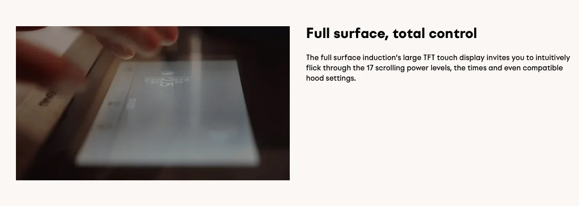

Up to five pots/frying pans, and you can move them around, the entire surface is active (when in use under the pot/frying pan).
17 different levels, and instant heat if needed.
Both Miele and Gaggenau has this system, and other brands might have it as well.
One minor issue…. the controls are digital, like an Iphone….so it took some time to learn and scroll when cooking!
And pictures of course!
I will cost you as much as a good Speedmaster! 😄
