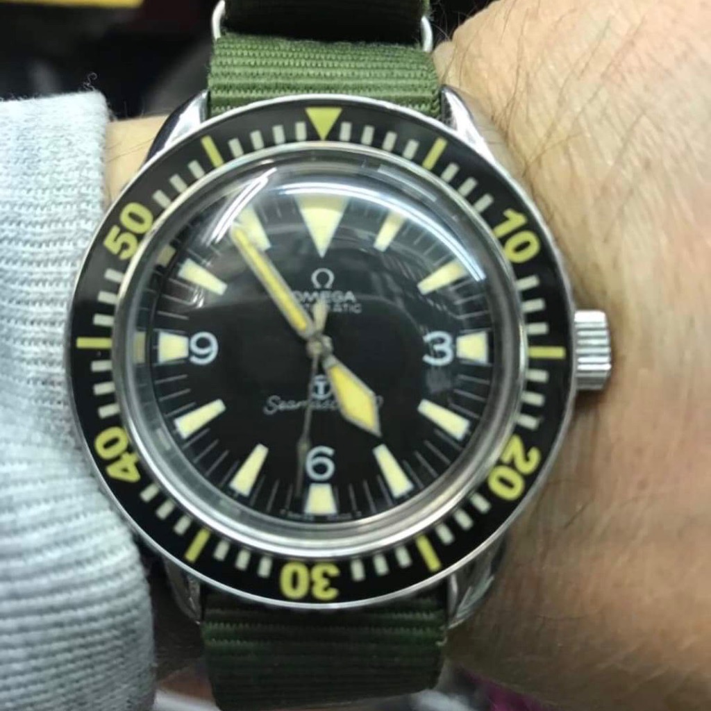

Good question. I’ve not seen a case that looks like this from Omega. That doesn’t necessarily mean there’s a problem with it, but the case I ordered a couple of weeks ago doesn’t have the sort of crown guards that look like the OP’s, they look like what you posted.
I can't find the forum post but I remember reading about a recent change to the case design with the straight crown guards and also changes to the teeth of the bezel and different font. Of someone could find it....not even sure if I read it on this forum.

I would personally be extremely wary if I were considering buying one of these. The SM300 and its modern recreations has to be one of the most faked Omegas out there, if not in fact the most faked, and if I were buying I would want to see invoices from a reputable parts supplier like Ofrei, Cousins etc for the parts and/or paperwork supporting assembly from a reputable outfit like Watchco, Lewis, STS etc. There are countless fake parts out there, enough to build whole watches and plenty of owners who have spent thousands on 'Watchcos' that are in fact no such thing, and cost a few hundred bucks to assemble. Here are a couple of examples of poor fakes*, but there are also flawless ones too:
* I believe it is forum policy to not discuss or condone fakes. I show them as an illustration. If I have contravened that here I will of course happily take these down.
