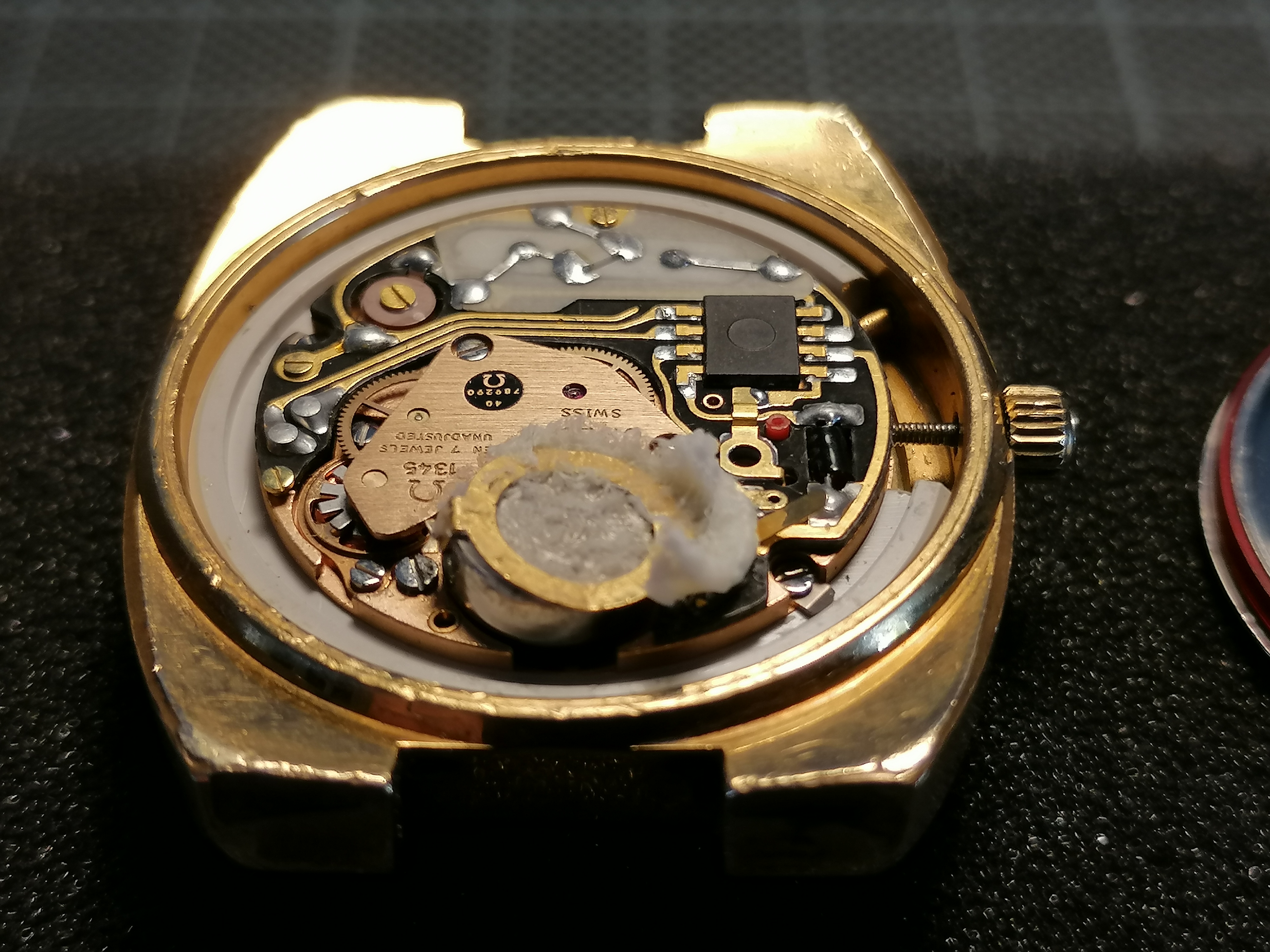

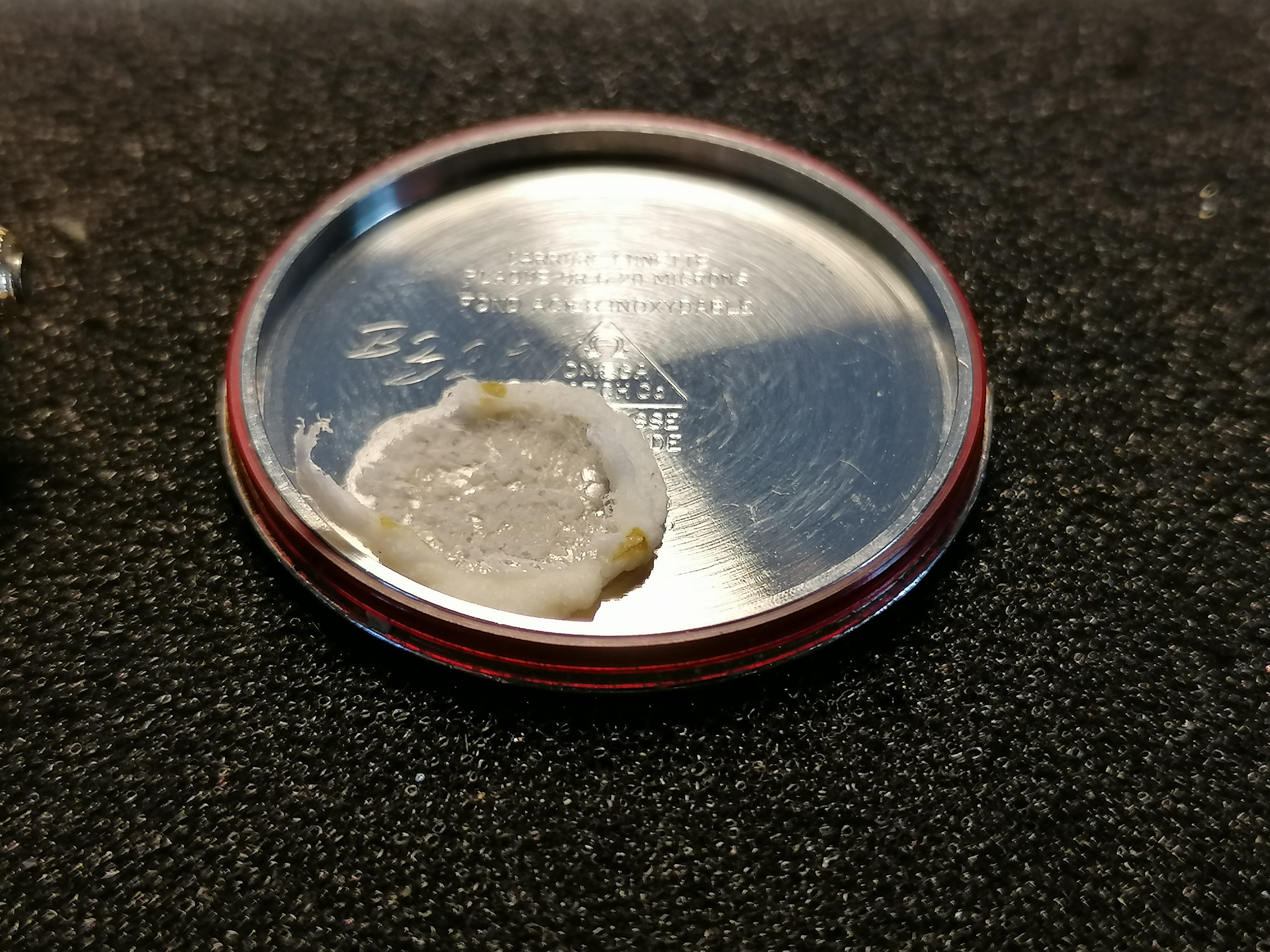

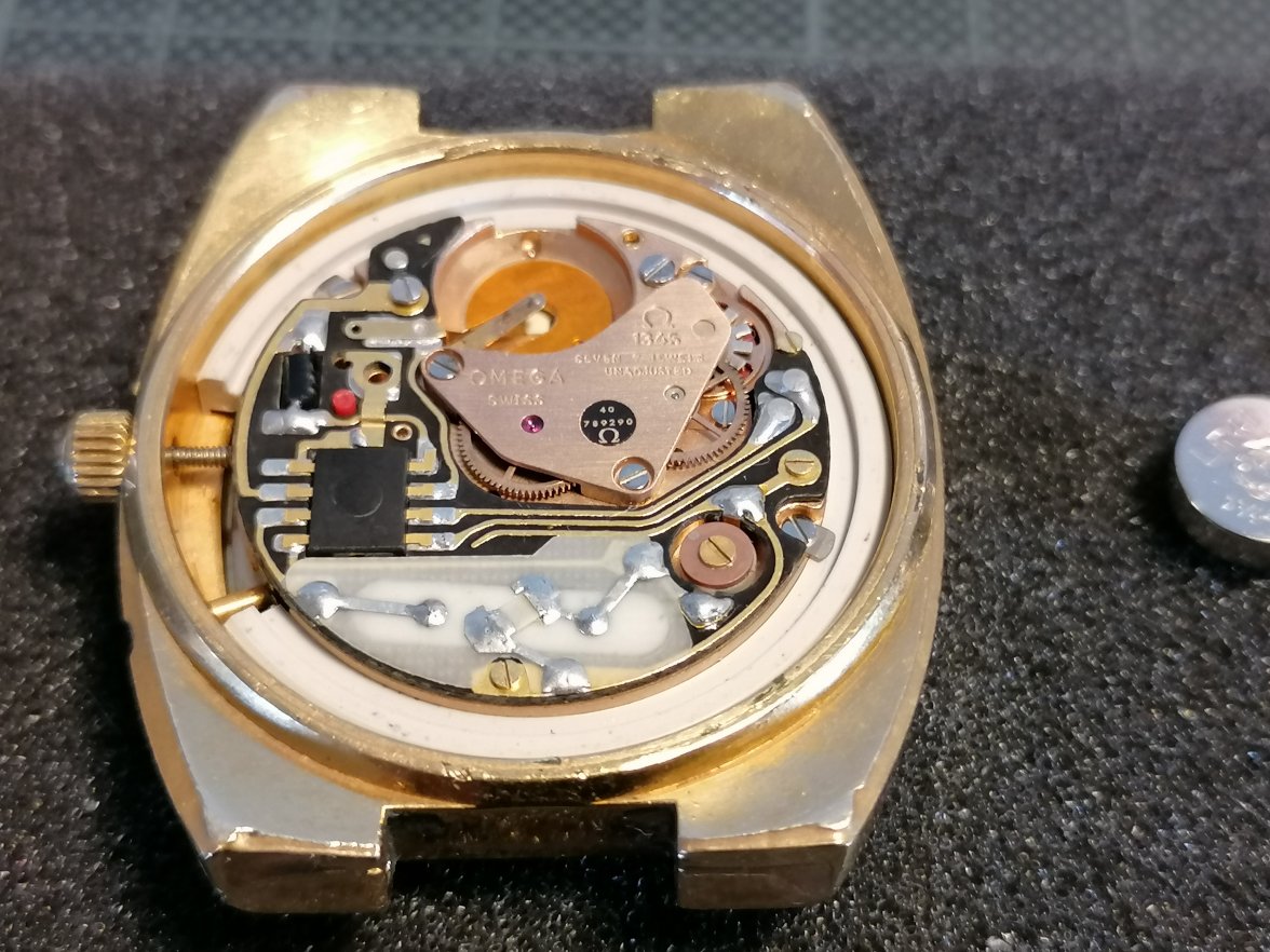

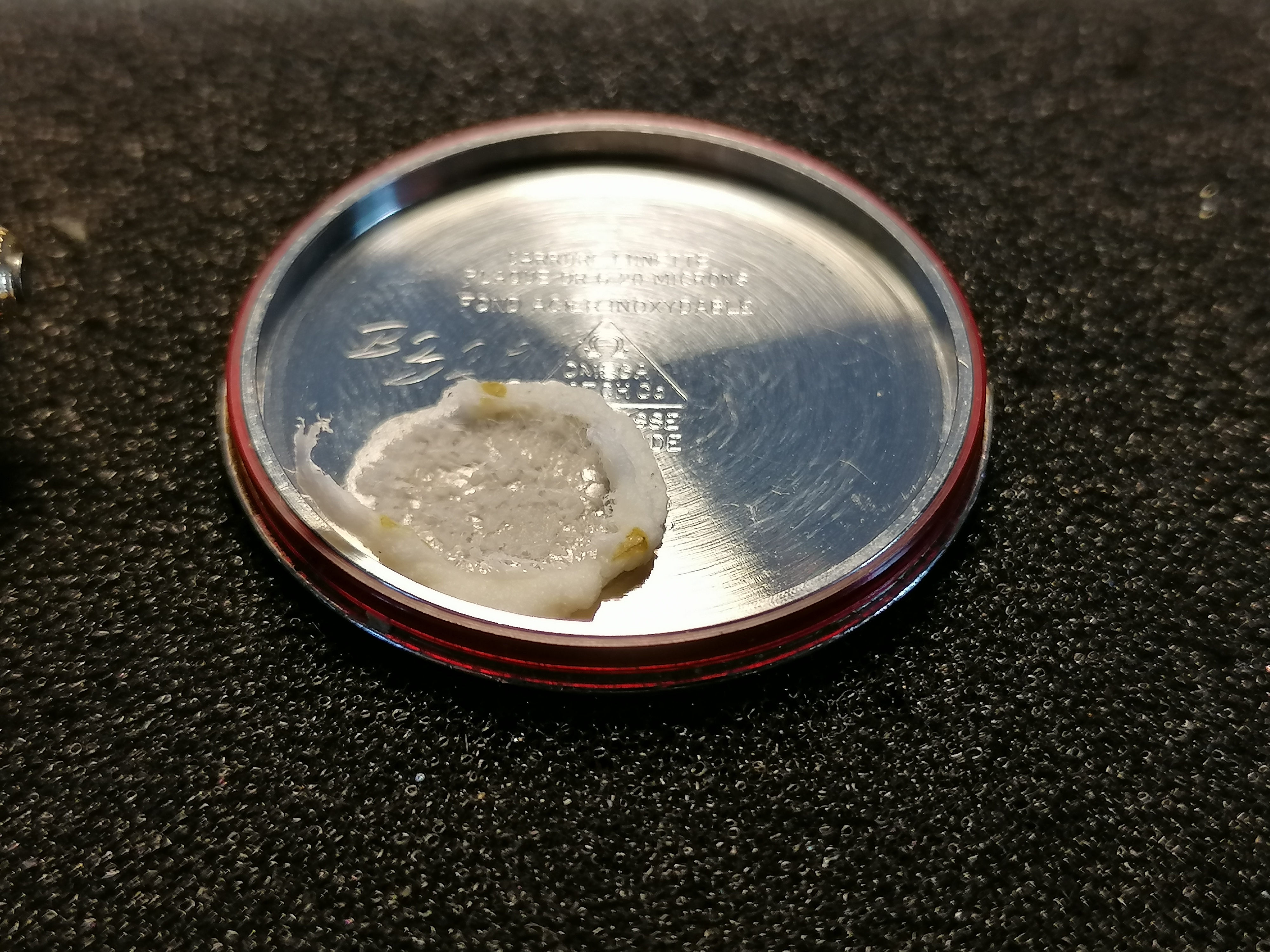

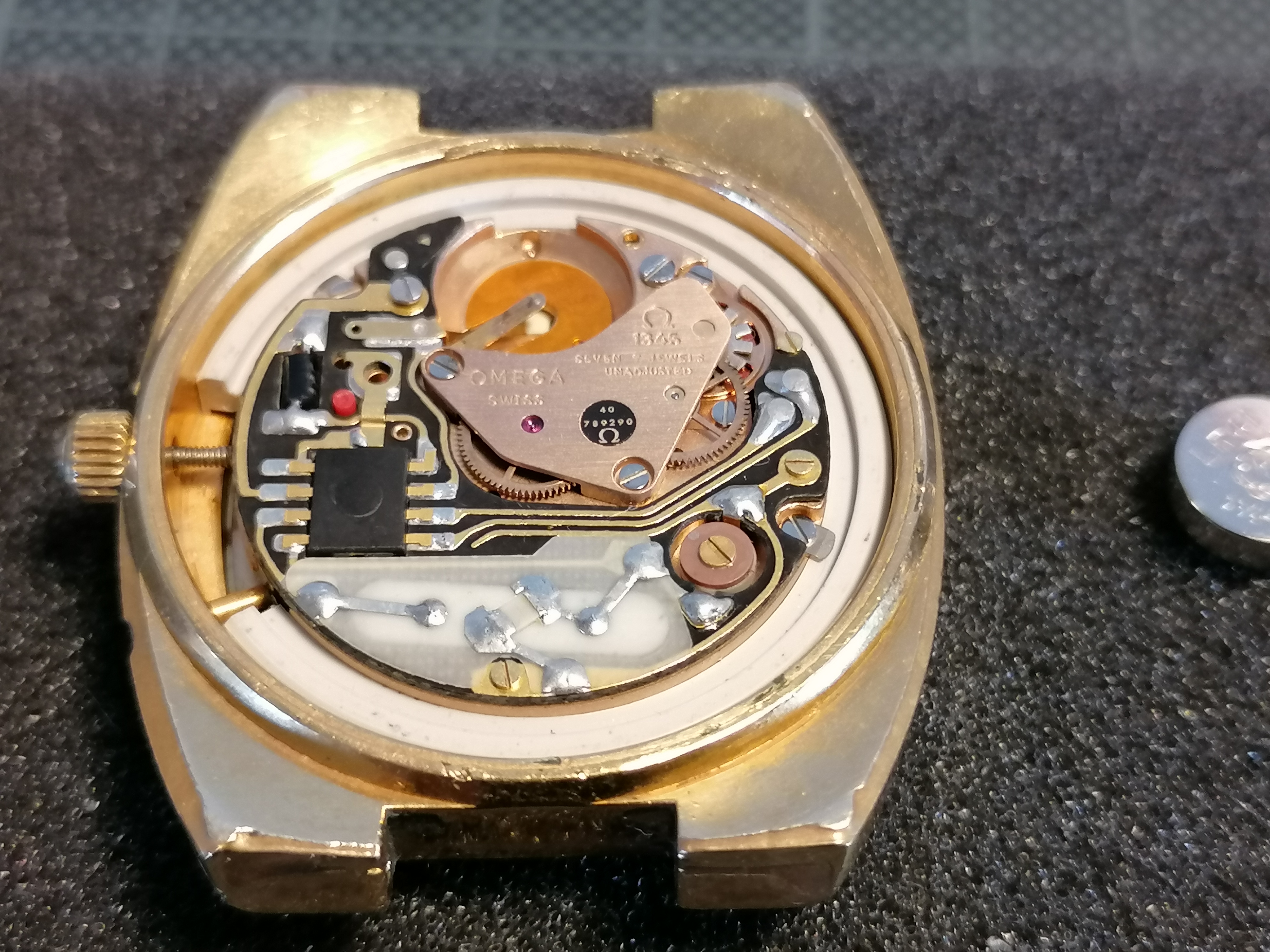

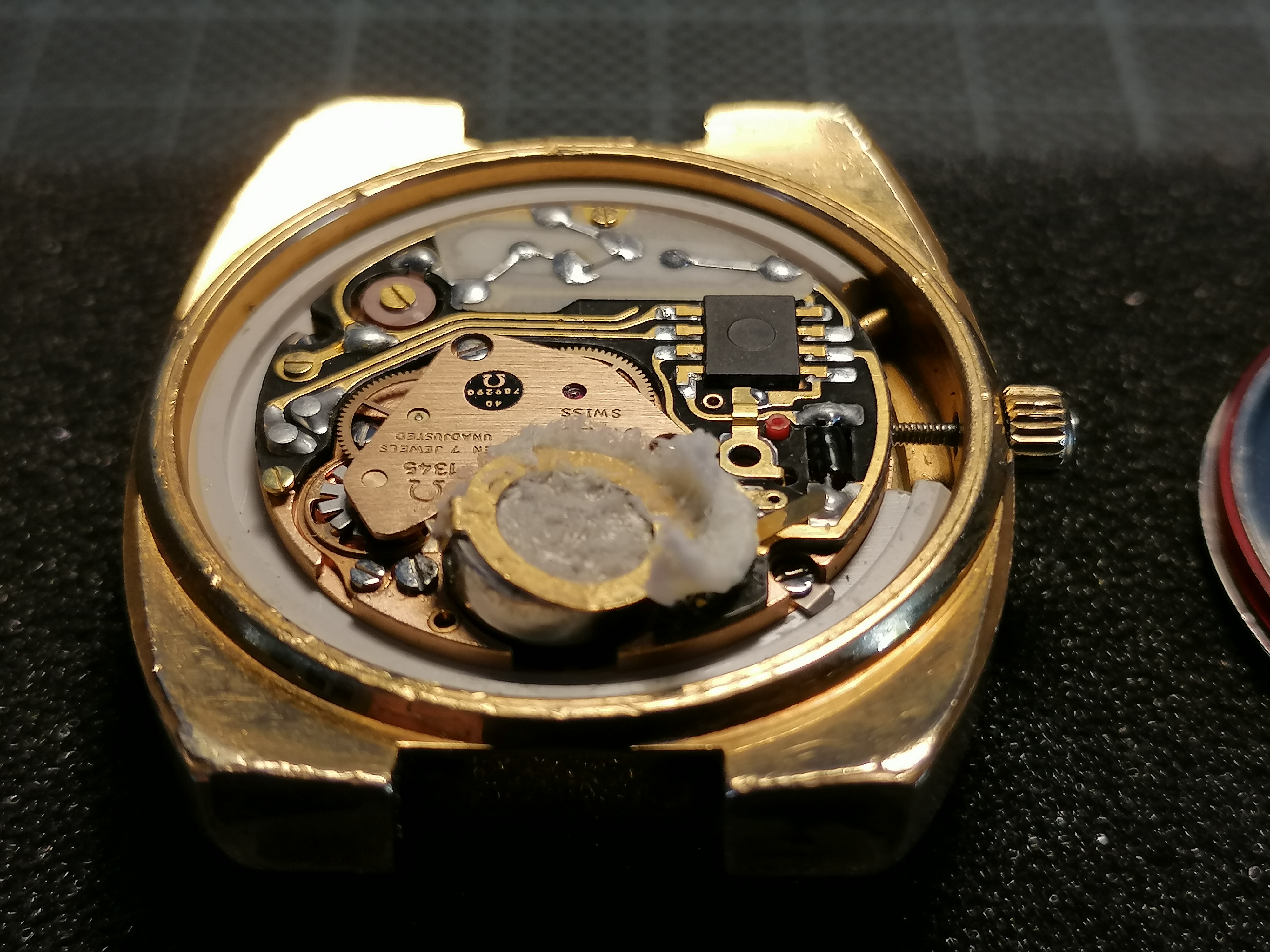

And I did, and you know what, it smelled like peppermint because the battery contact was fixed with chewing gum, one of the contacts had broken. Obviously, the owner didn't know what else to do. Nice idea, the clock was running. I admit it was disgusting, but with Q-tips and alcohol the gum was completely removed.
Of course I ordered a suitable spare part immediately.
This is what it looked like inside (gentle minds should look away now ::facepalm1:: )
And so after the cleaning

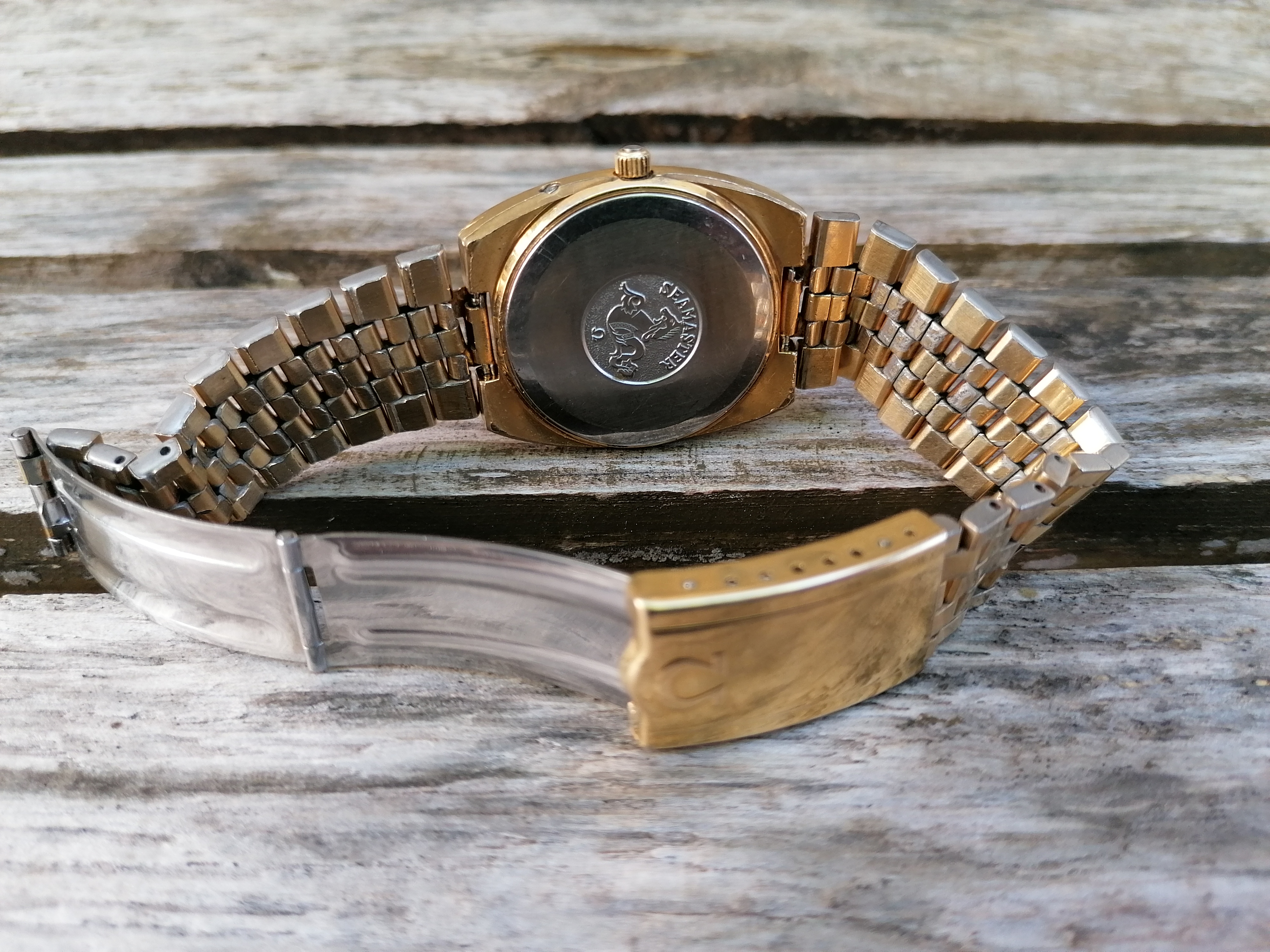

Just a Little update:
Today i found out why the owner used his chewing gum.

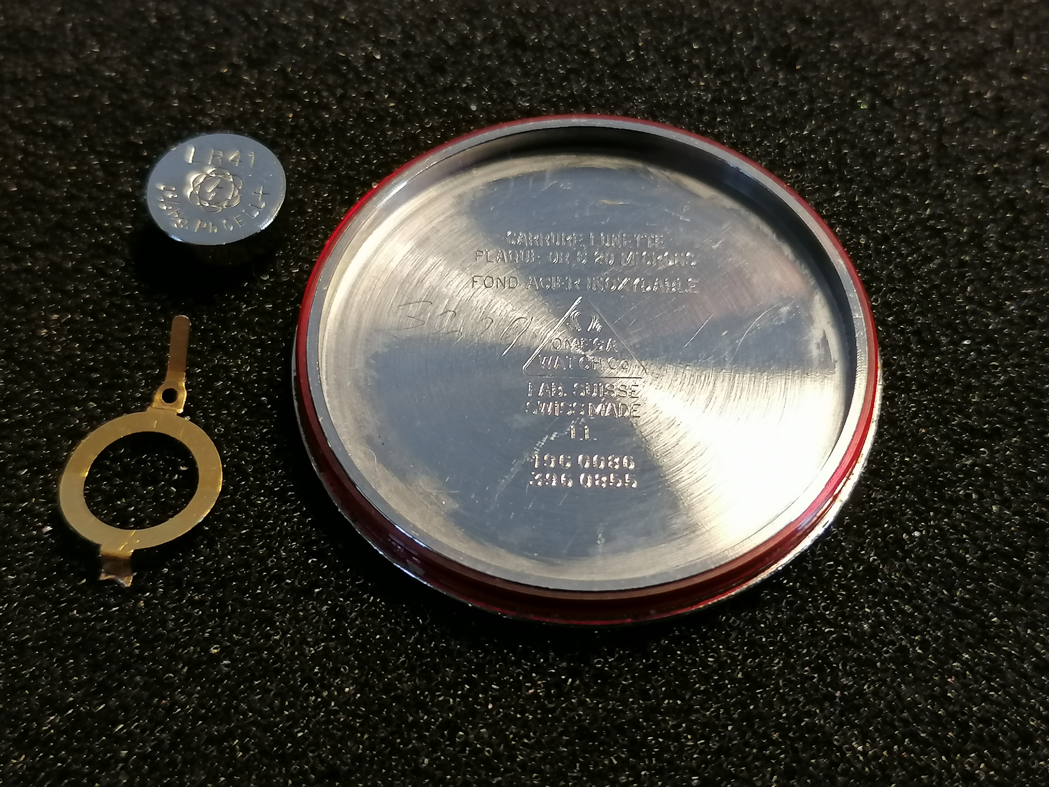

The caliber 1345 needs a batterie N° 388, today you can´t buy them anymore, they are forbidden. I have ordered an adapter ring so i could use a batterie numbered 329. The chewing gum was also a replacement for the ring 😀
We'll see if it works that way after i put all the pieces together and maybe it will help one of you 😀

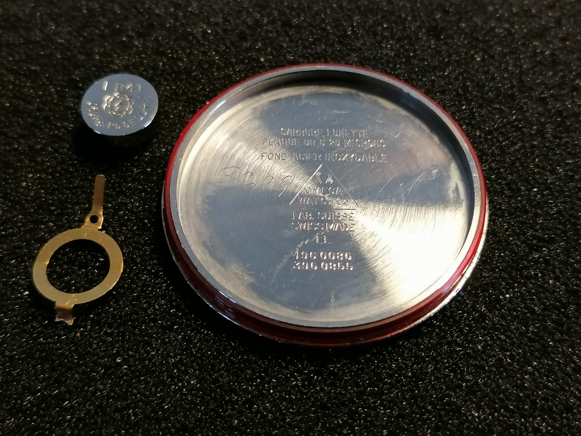

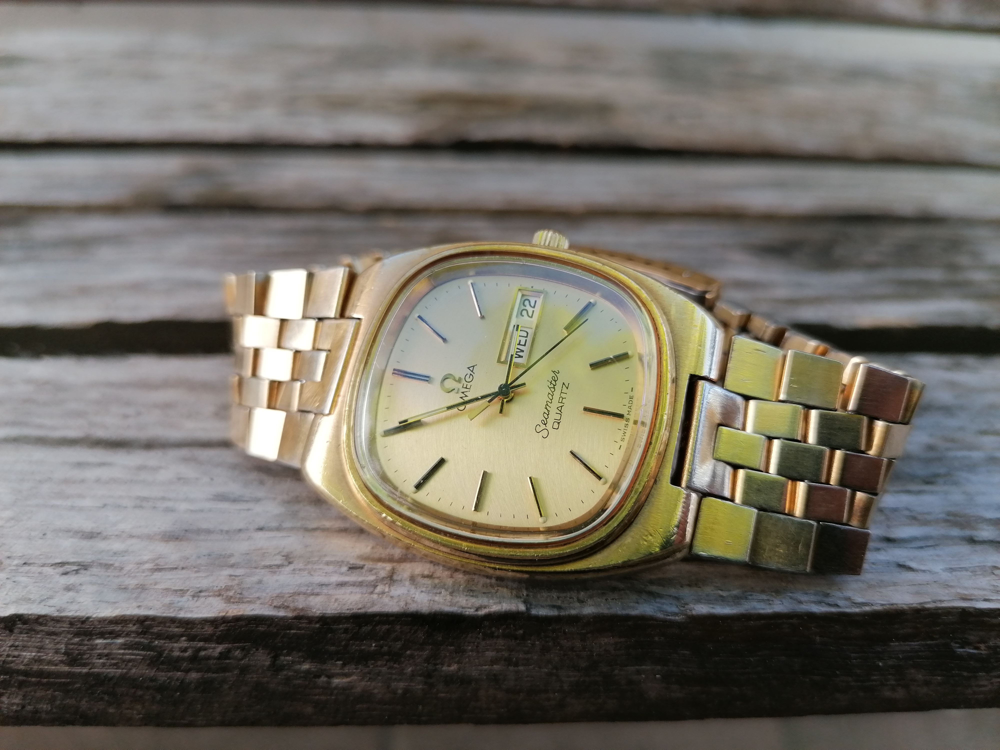

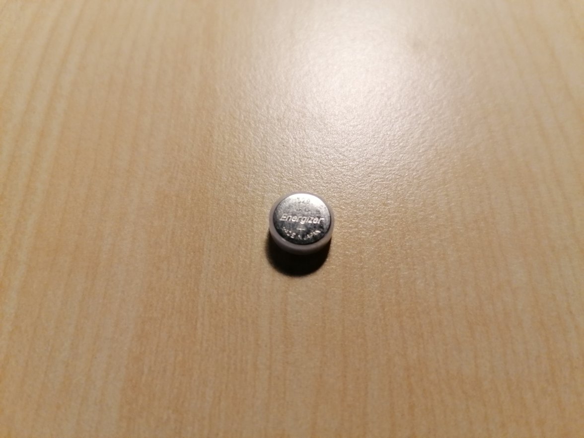

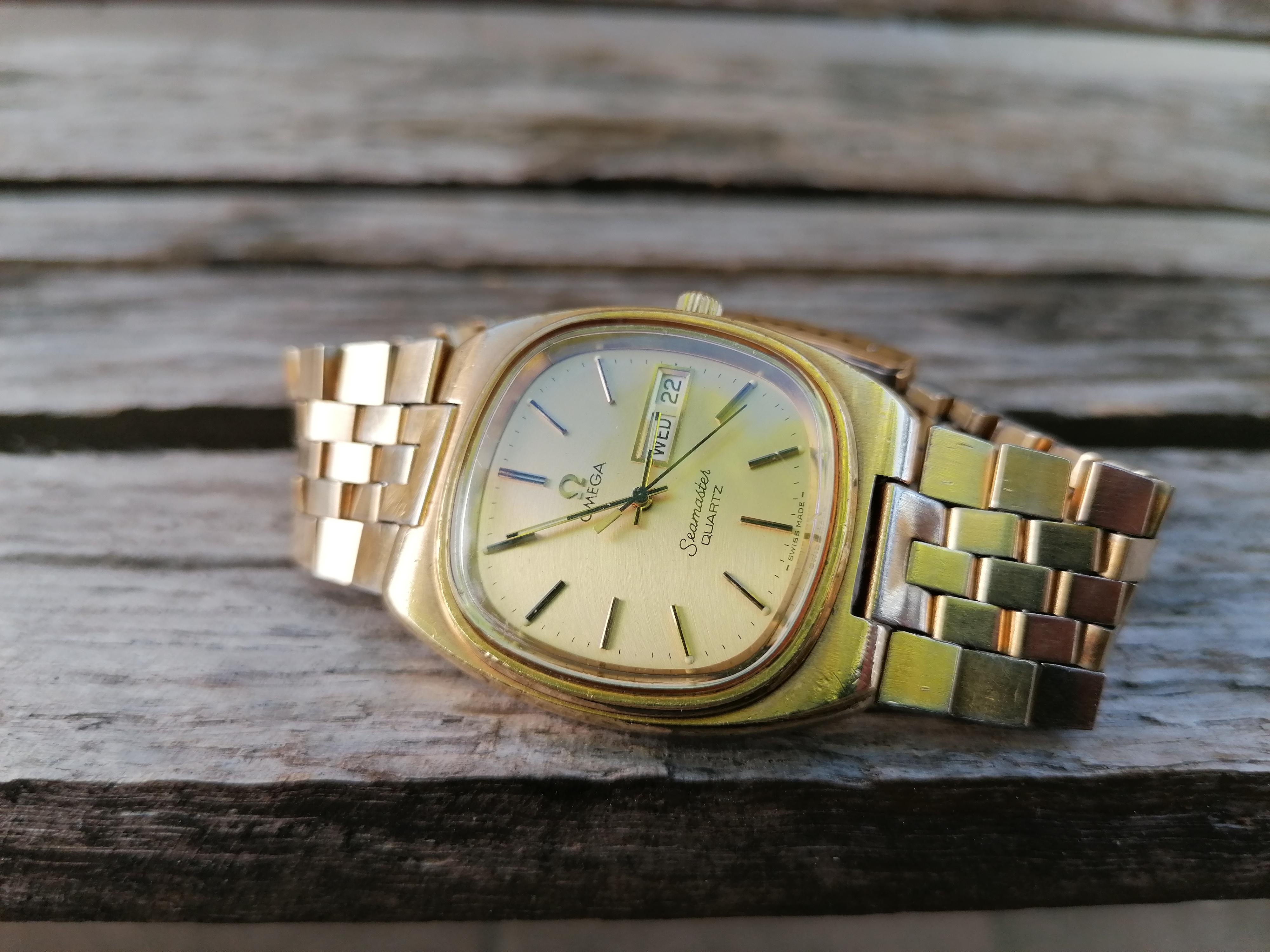

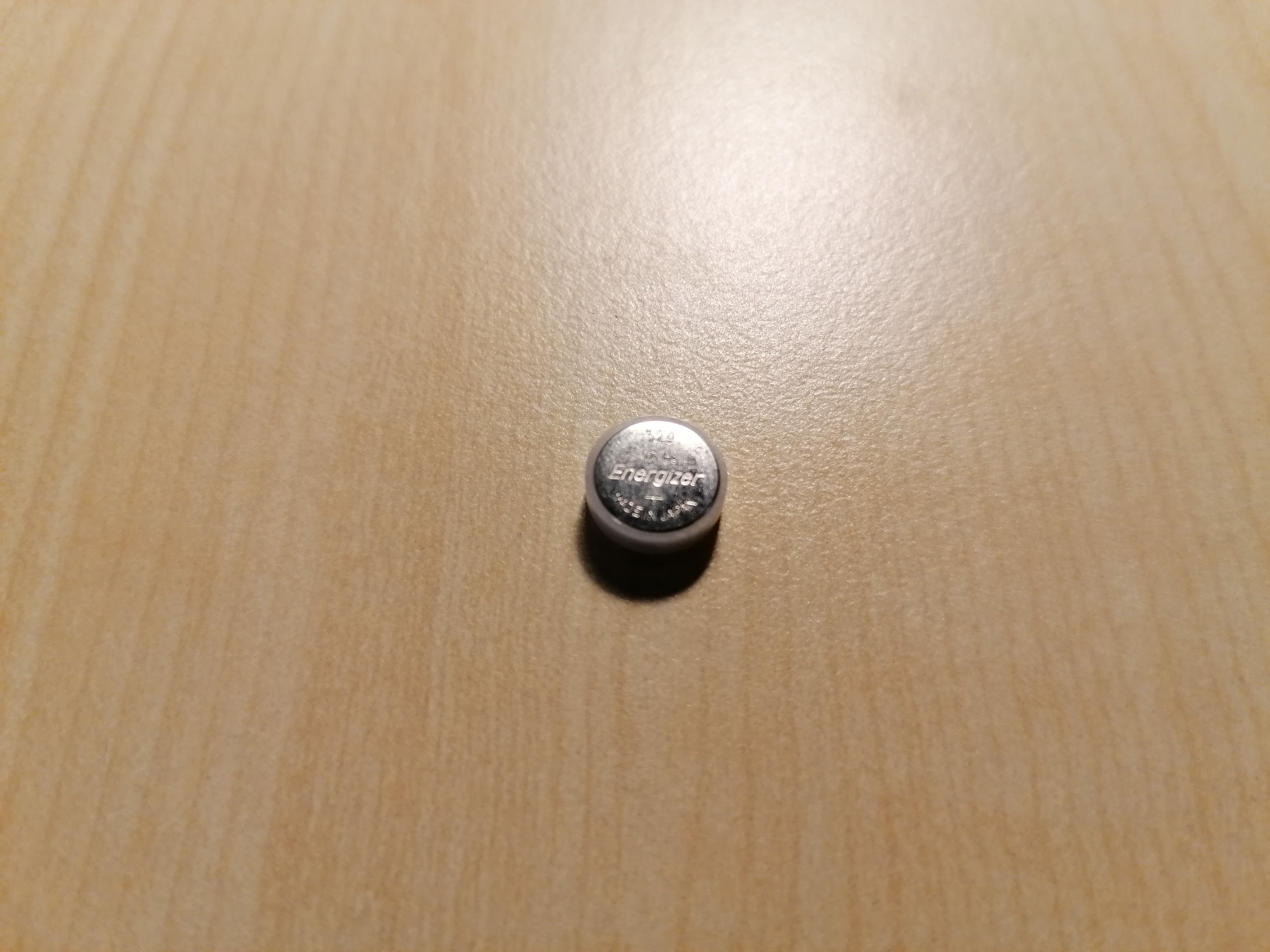

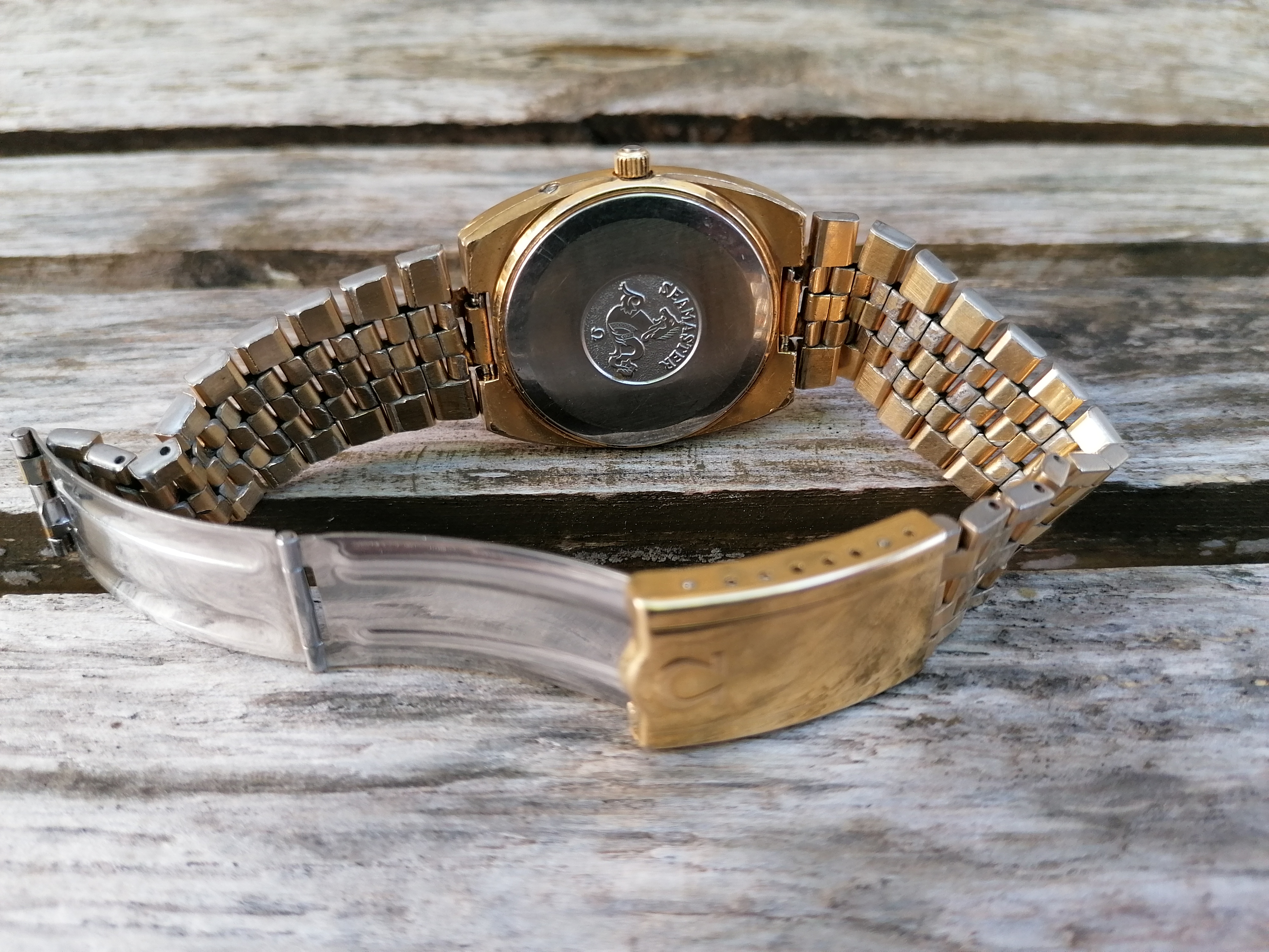

Last but not least i finished this little project with a cleaned and running watch that will stay in my Collection.
For the archive a picture of the adapter ring and the new Batterie N°329
And a picture under the sun 😀
… or two
