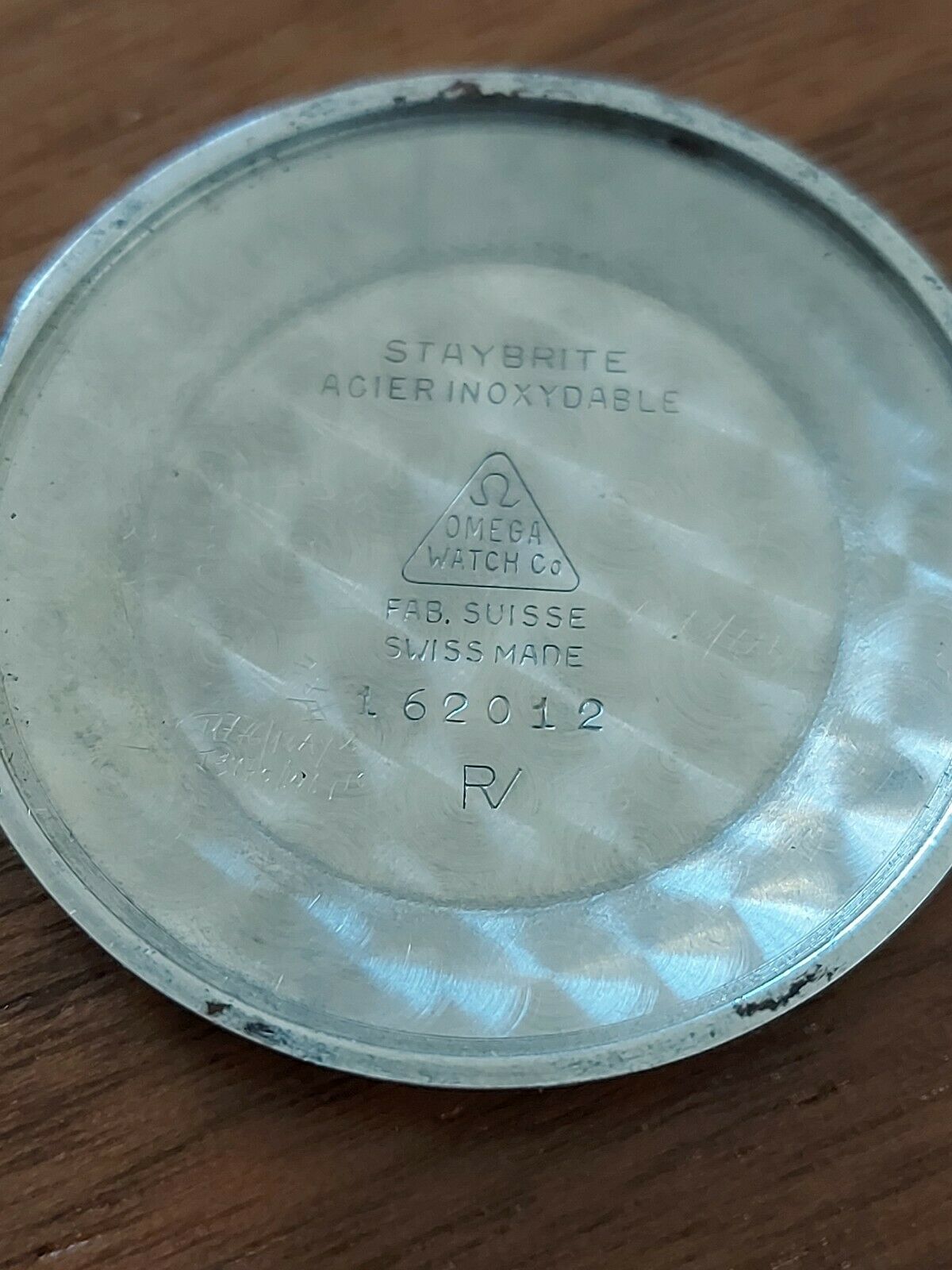

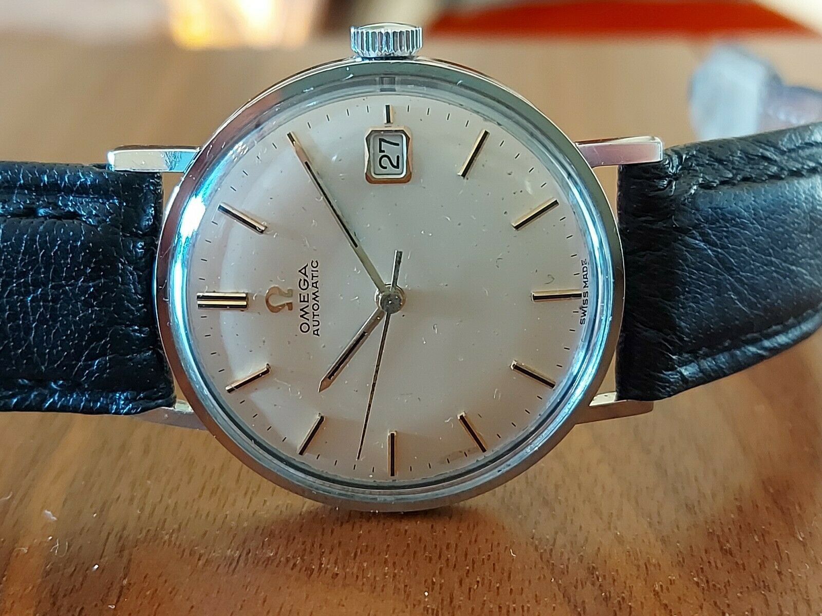

Hi, I ve seen ref. the number and cannot find that ref. anywhere else. Everything looks legit including case but I can find that ref neither on omega official page nor else. Also I ve never seen third number to be "2". I attach photos of the watch.

The reference is 162.012
the omega database is not complete.
1 = men’s
6 = self winding center seconds
2 = water resistant calendar
So I don’t see any issues with the reference number.
