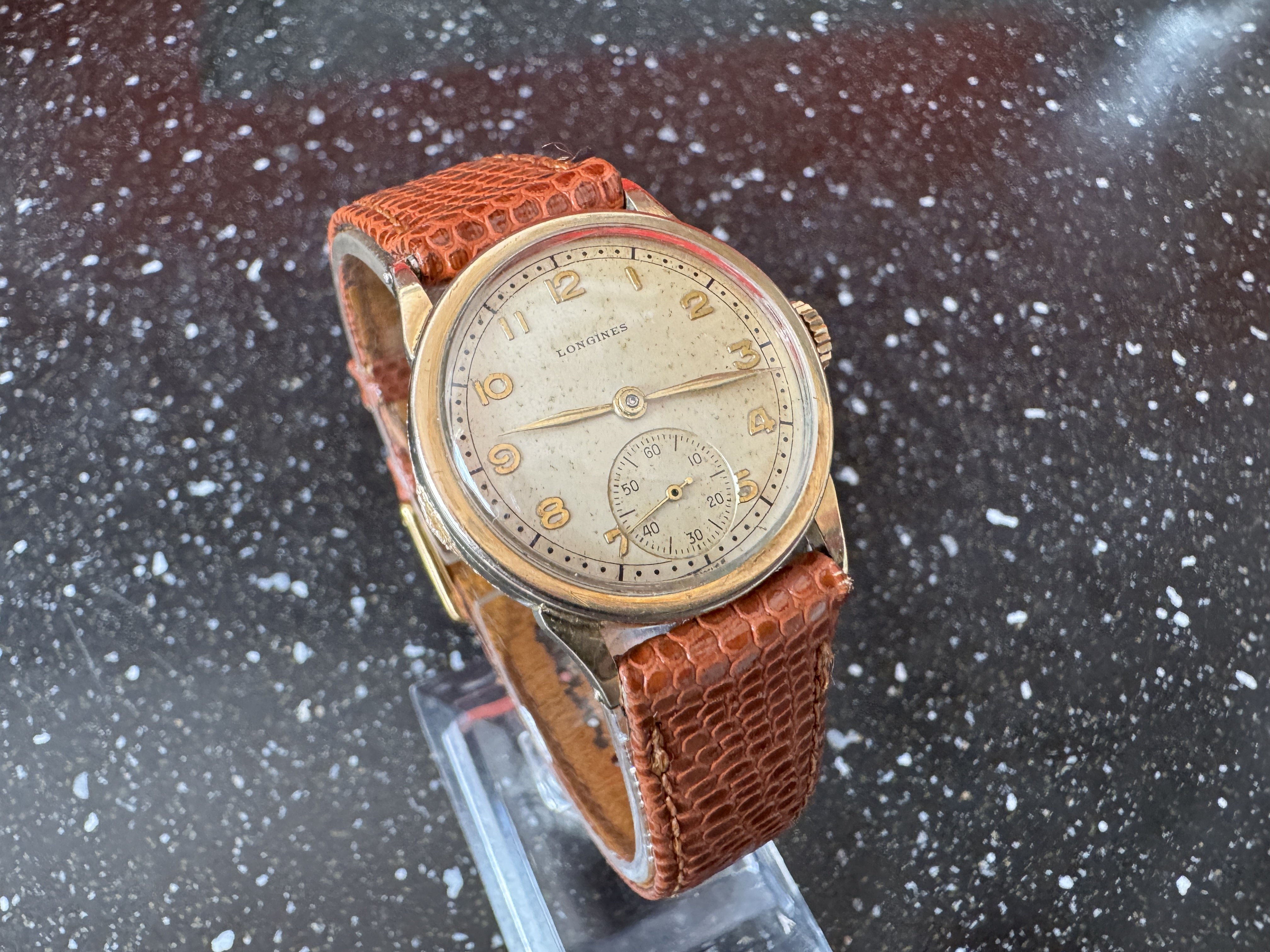

Looks like a dress watch to me, is it 18k gold or just gold filled or plated?
76
70
Just gold plated

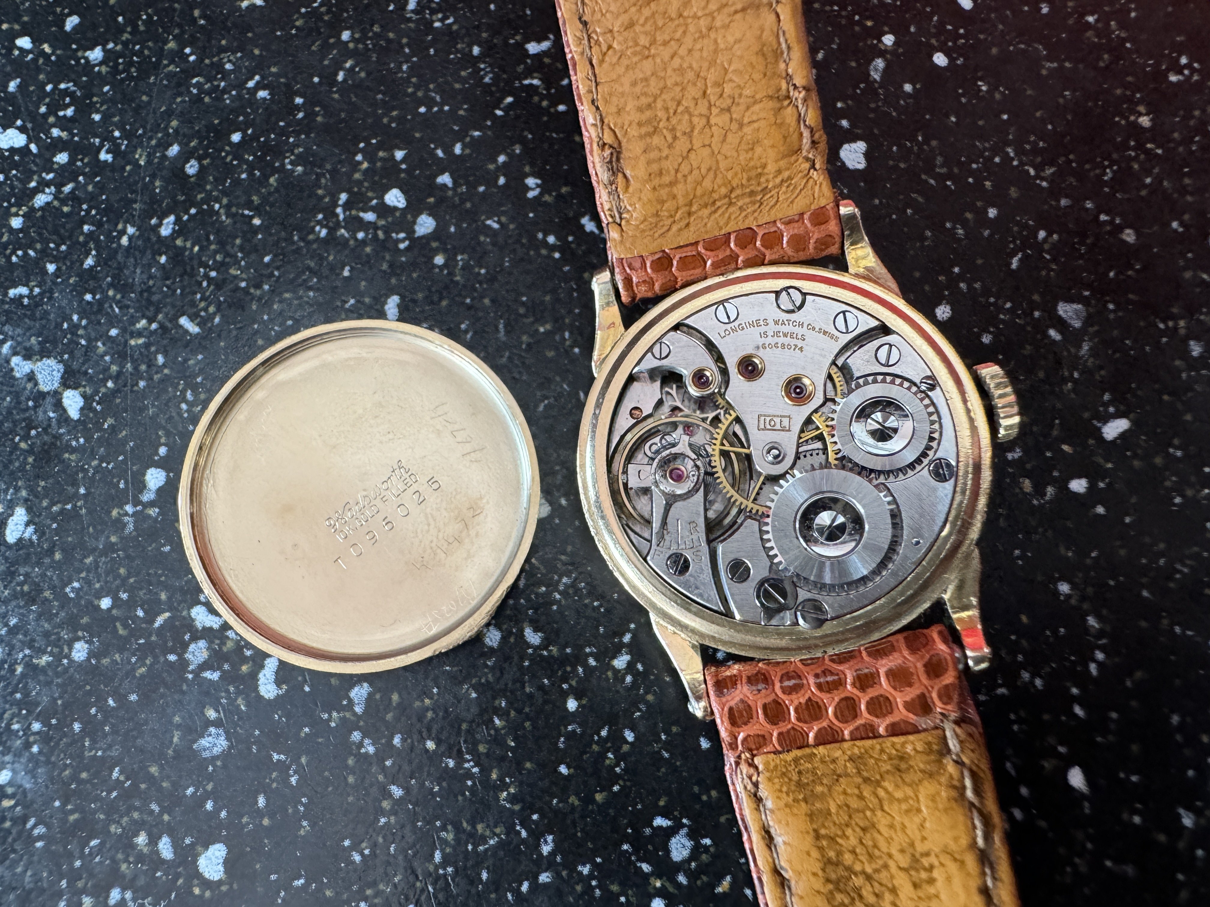

Take a photo of the movement with the back off. If I were to make a guess, it has a 12.68z movement.
2,829
4,948
I would guess that the case is American-made, which means that there is no Longines reference number associated with it. Maybe the movement is a caliber 10L.
Indeed , the caliber is 10 L

diameter?
btw: one picture - five words: cool post👍
Approx 27.3 mm without the crown. Sorry for my five words, I’m just a beginner ☺️

Just gold plated
According to the cb, it's gold filled, meaning a much thicker gold layer. I'm not an expert on military watches but never saw a military watch with such heavy gold coating (except for some dictators here and there).
Thank you ! Indeed make sense for a military watch not to be gold plated. Now I'm convinced it's not military but a dress watch. Regards
