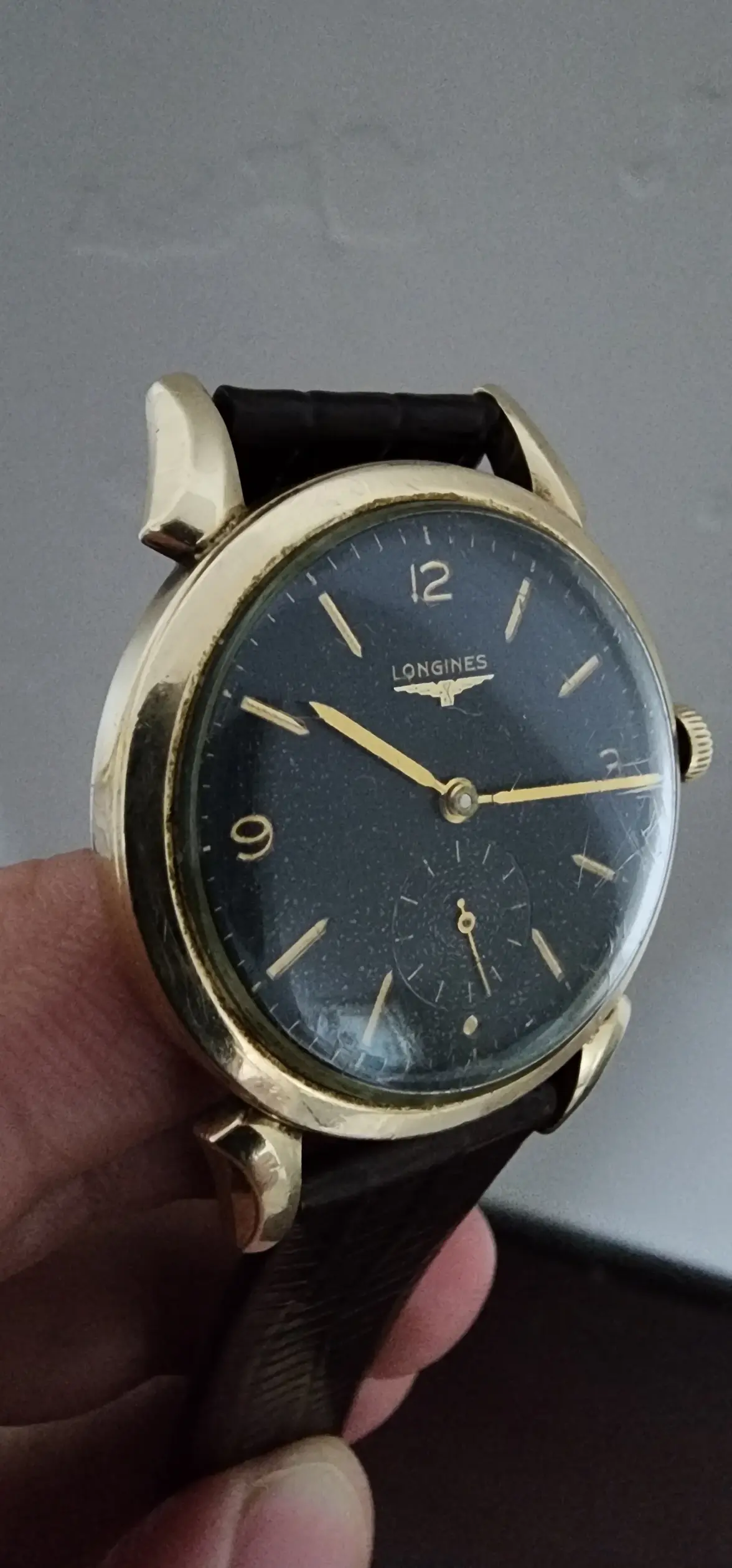

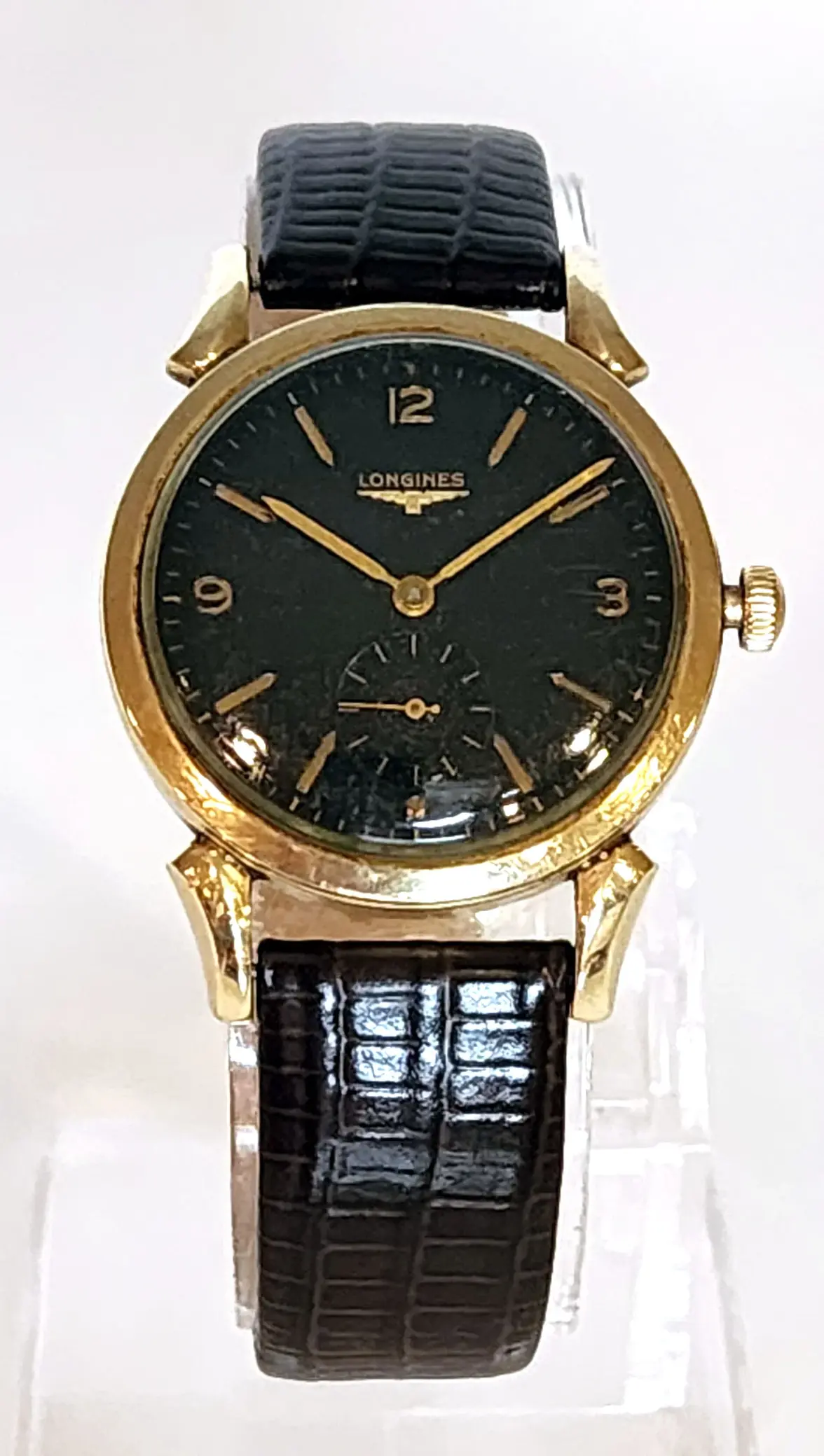

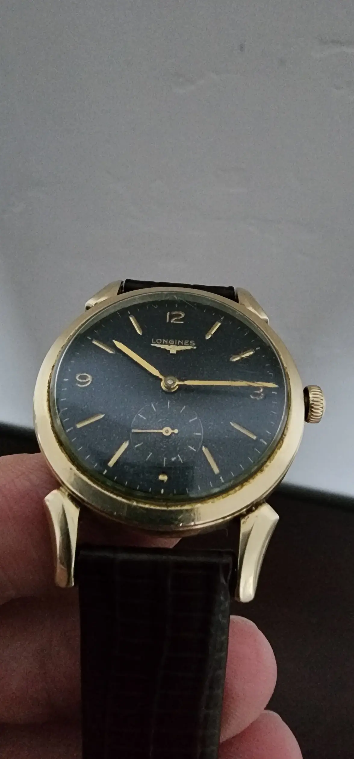

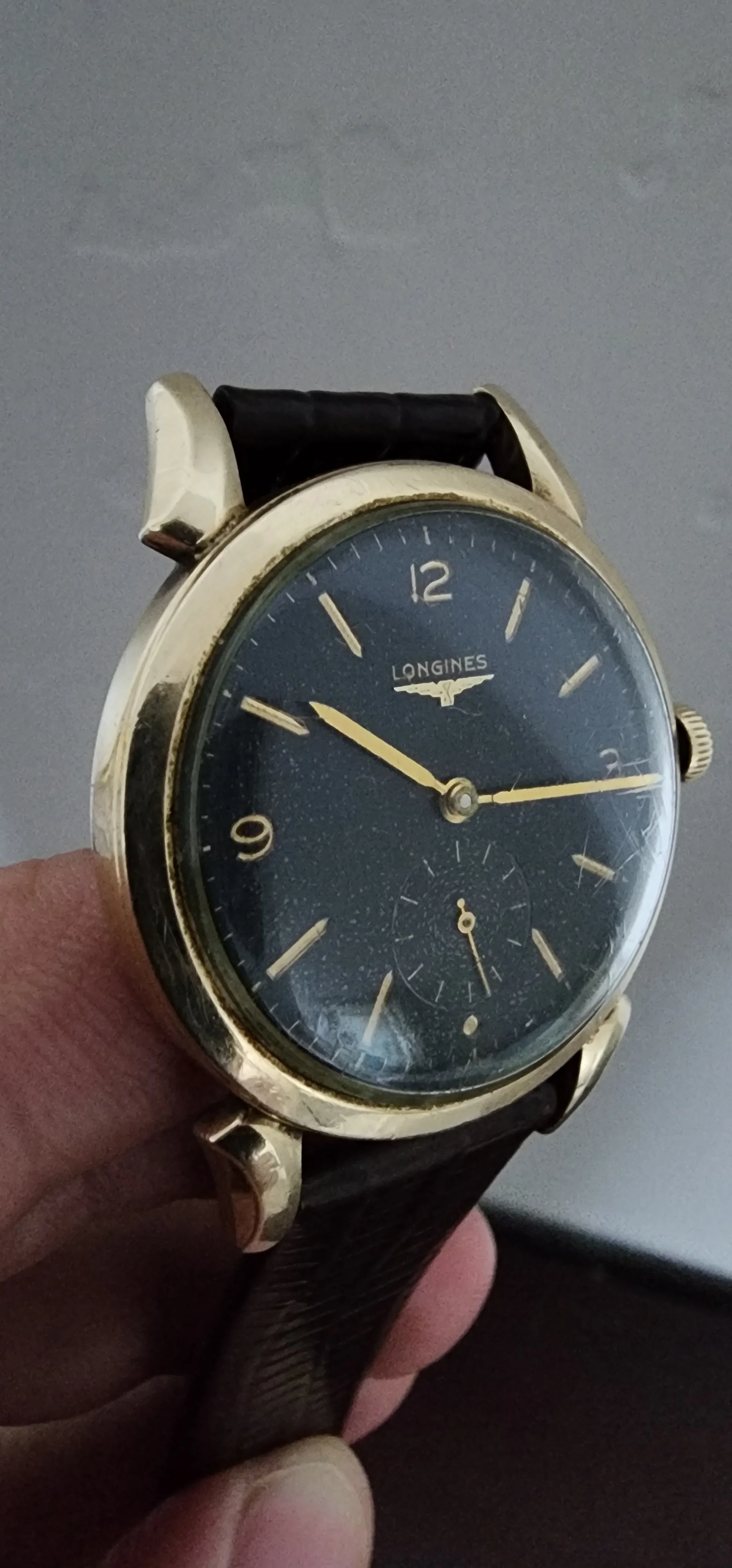

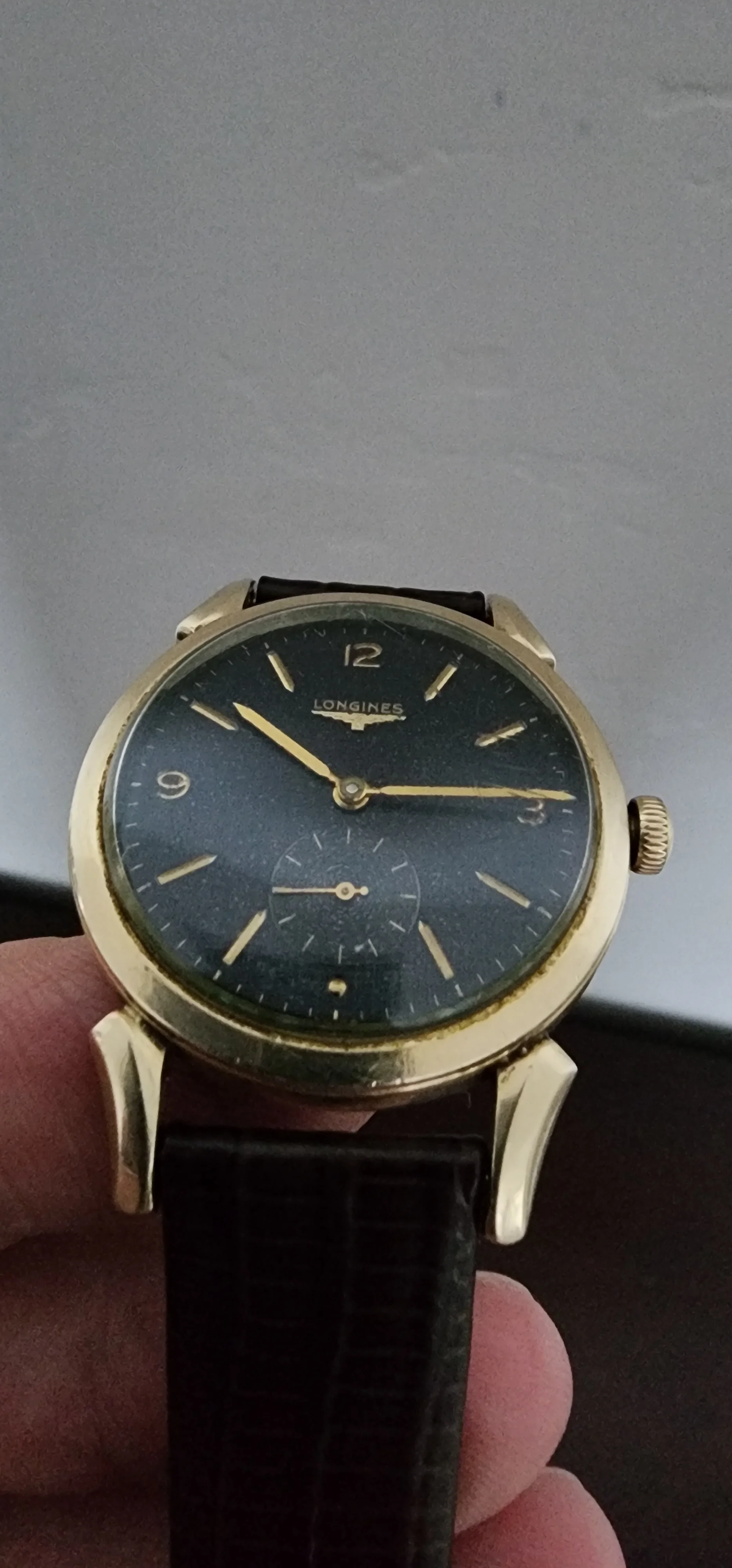

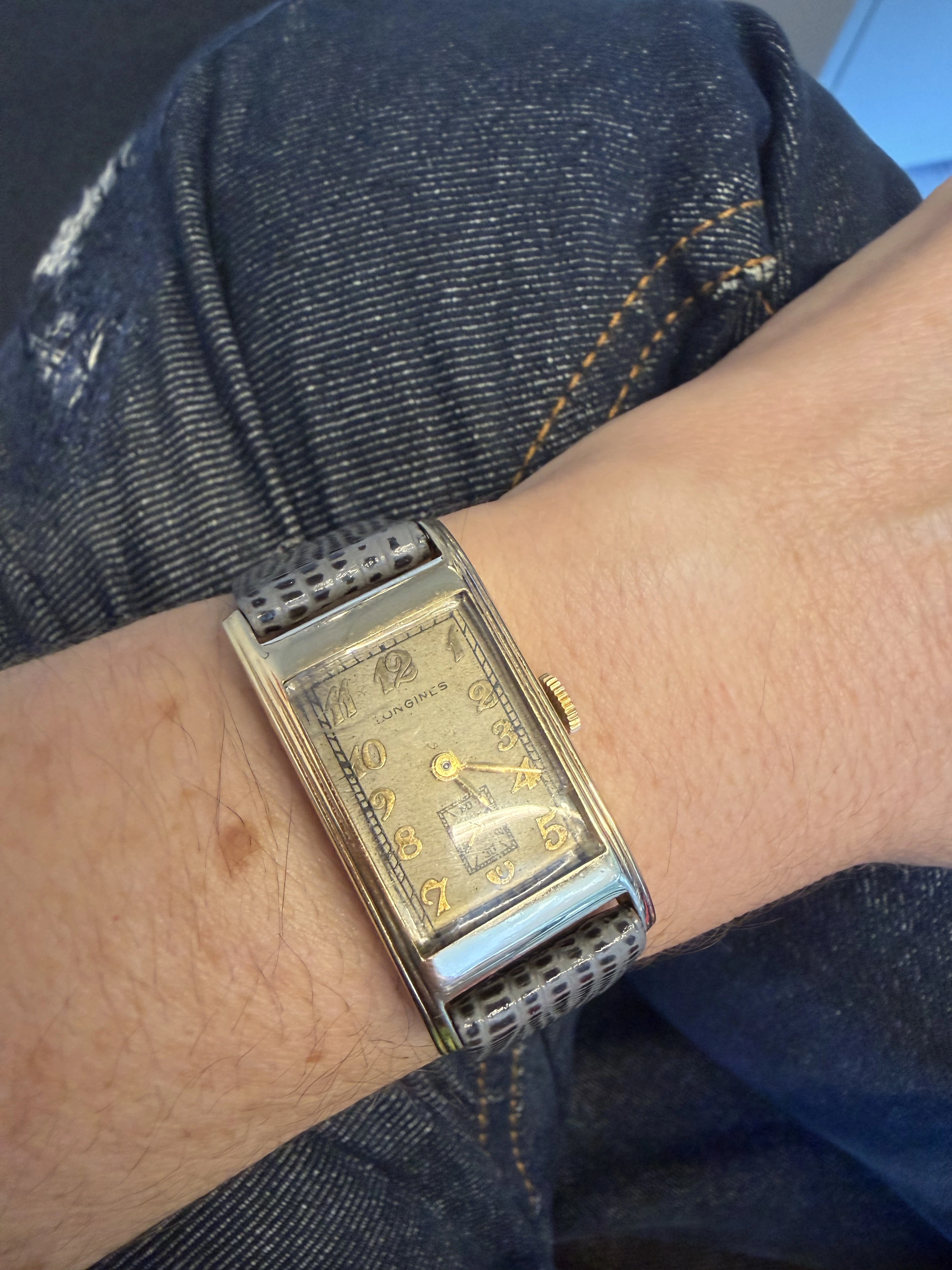

Hello, I am new to this forum. I have a vintage Longines and hope someone can tell me its model/series, year made, and dollar value. I've looked all over the internet, which brought me to this forum.
This watch has a manual wind. It keeps accurate time but needs winding each day. Black dial set in 10k-filled case. Case size is 34mm without crown. Sunken sub-second dial. The unique turned lugs measure 17mm wide.

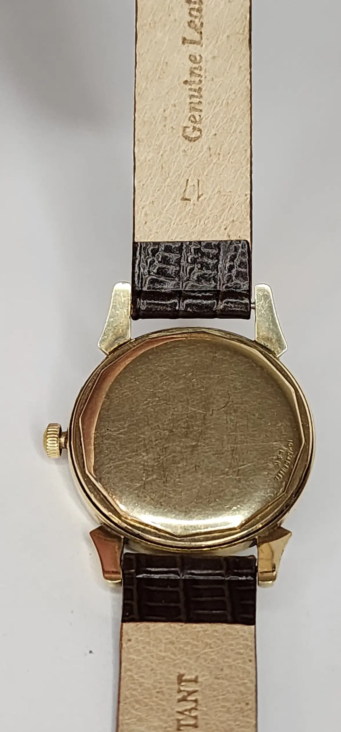

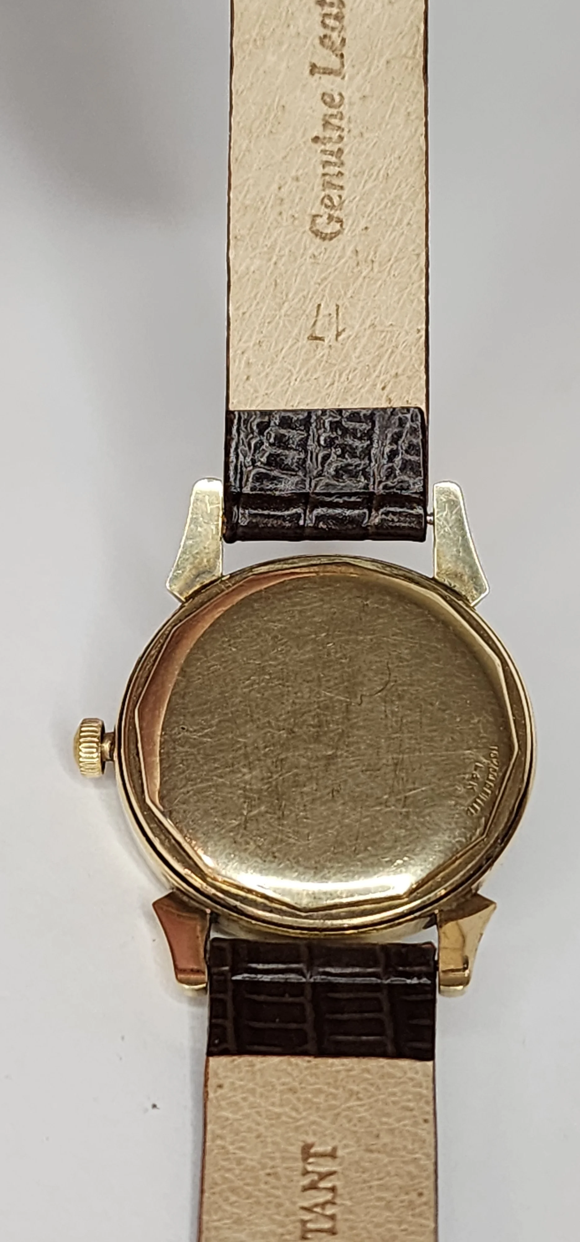

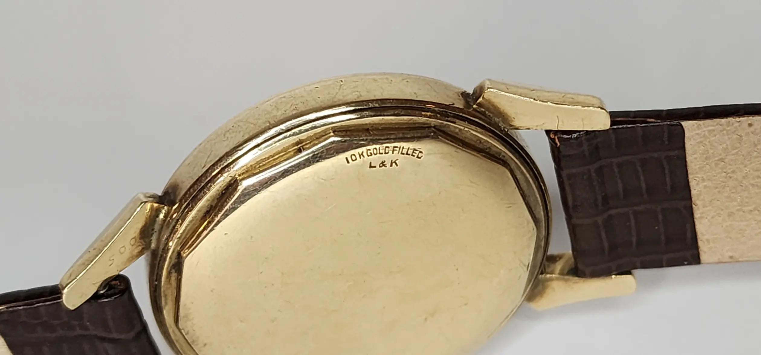

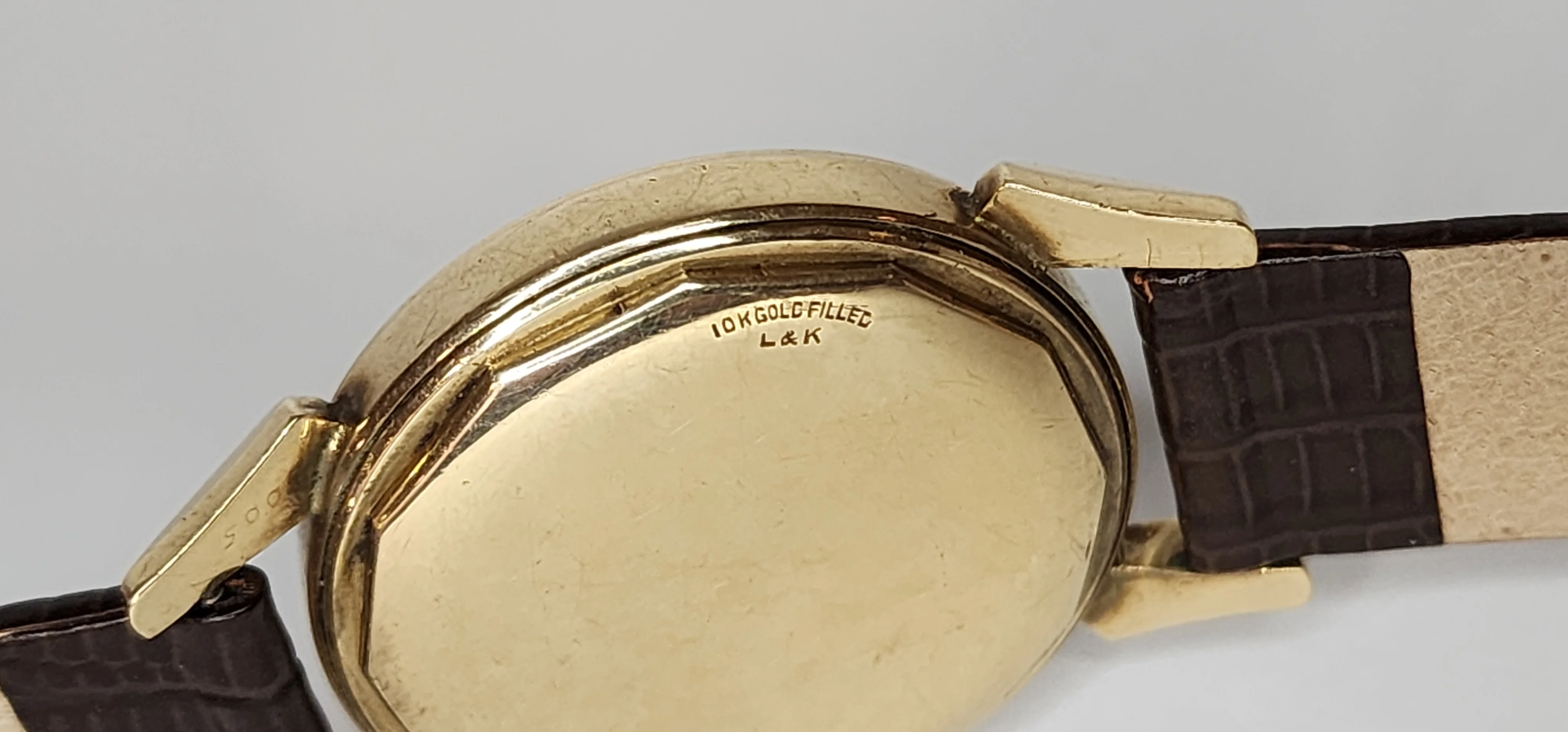

The caseback has 12 sides. I don't know if a friction ball will open it, or if I need a special tool. Hence, I left the caseback alone. The only marking reads, "10K GOLD FILLED L&K."

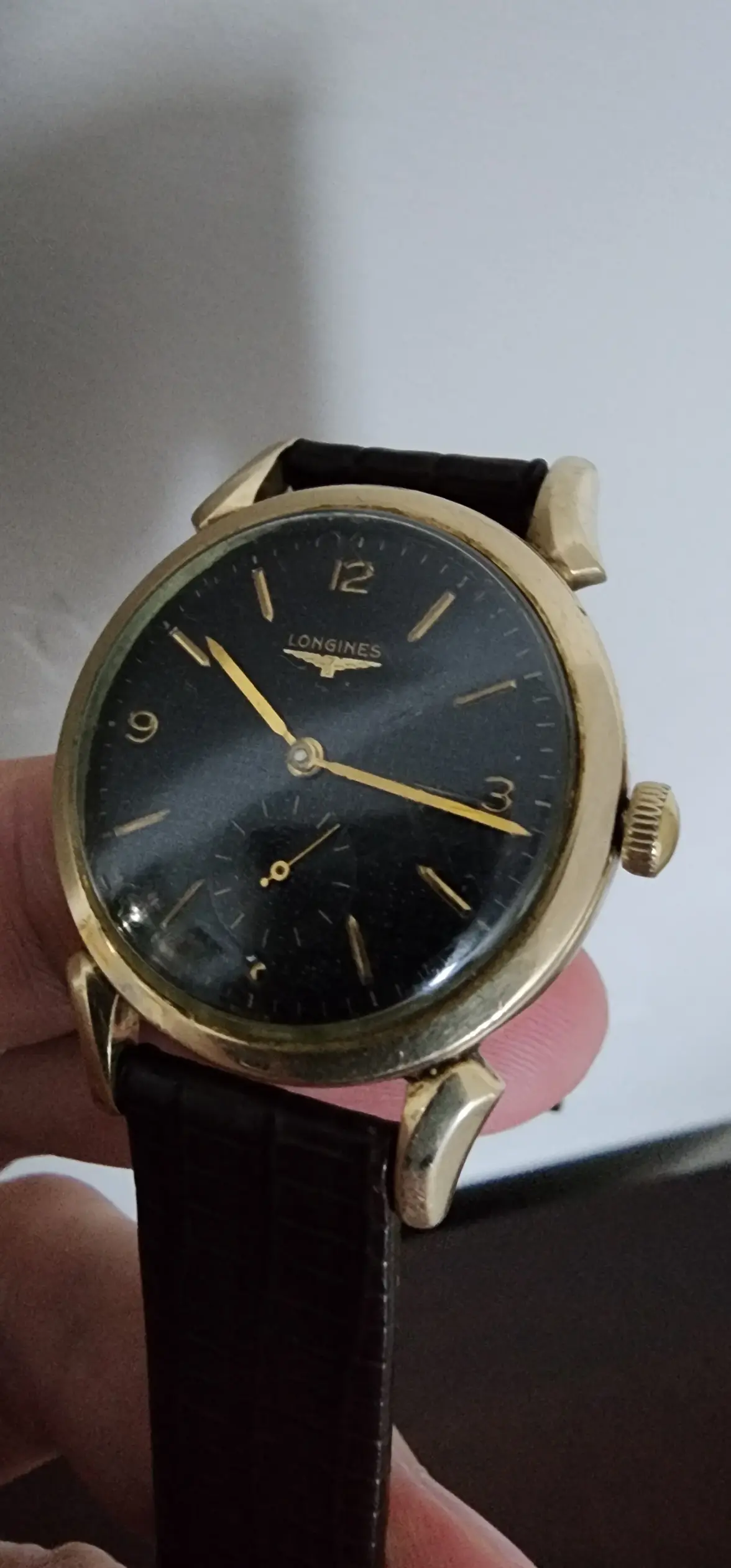

welcome, but.... black dials are dangerous (redial possible). A (small) nice watch-model anyway.
With this blurry picture it s hard to tell....
249
736
I also think it is likely a re-dial, though the photos make it a bit hard to tell.
The minute markers between 10 and 20 (esp. 11 and 16) look off; and the snailing on the sub-second dial looks like it might have been painted over

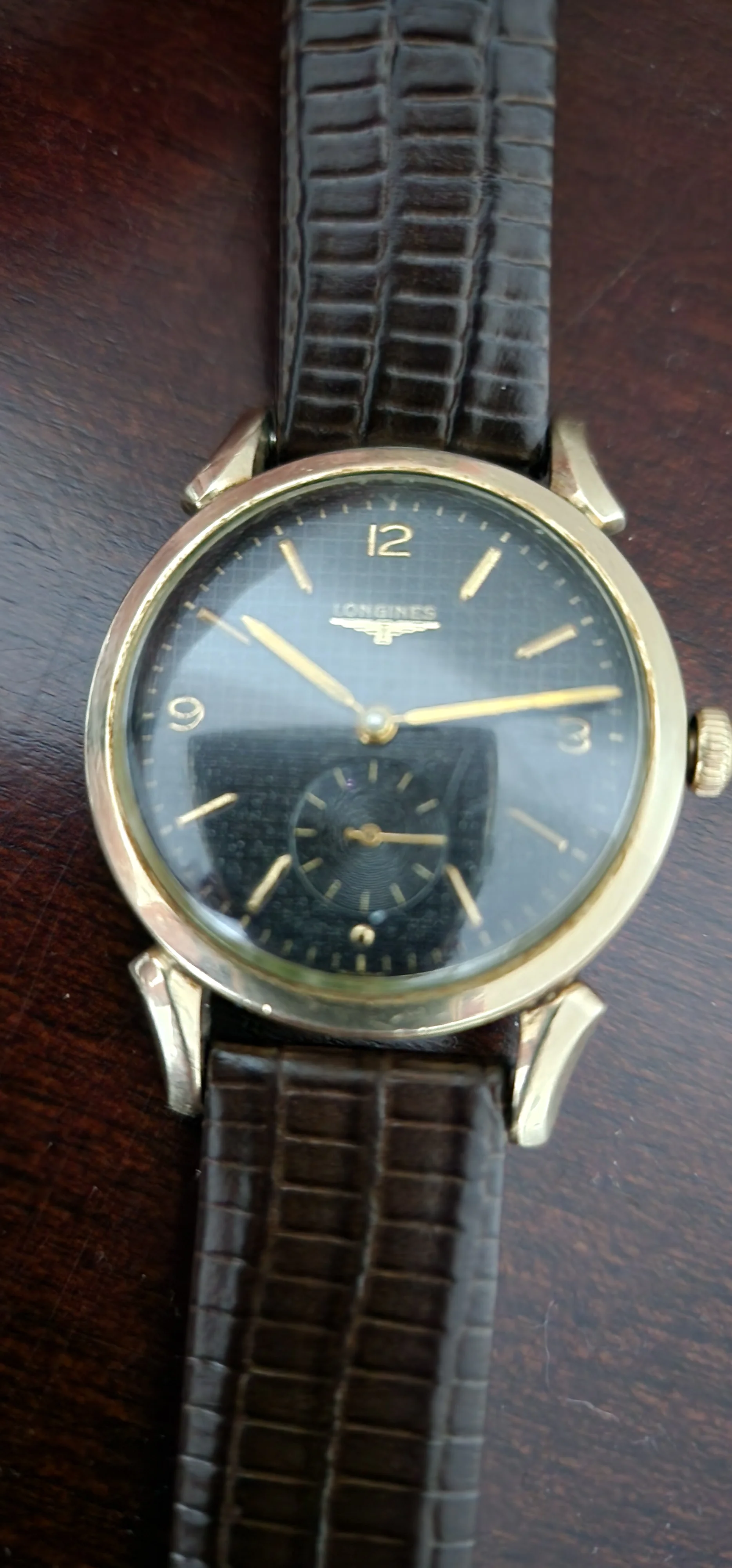

Thanks for the feedback thus far. I don't know anything about Longines.
The watch belonged to my grandfather. It was in a box for 50 years in my parents' home after my grandfather died in the 1970s. I found it while clearing out my parents' things. The leather strap was decayed so little bits of leather clung to the lugs and case. I wiped the case with a polishing cloth and added a new leather band. I haven't done anything else to it.

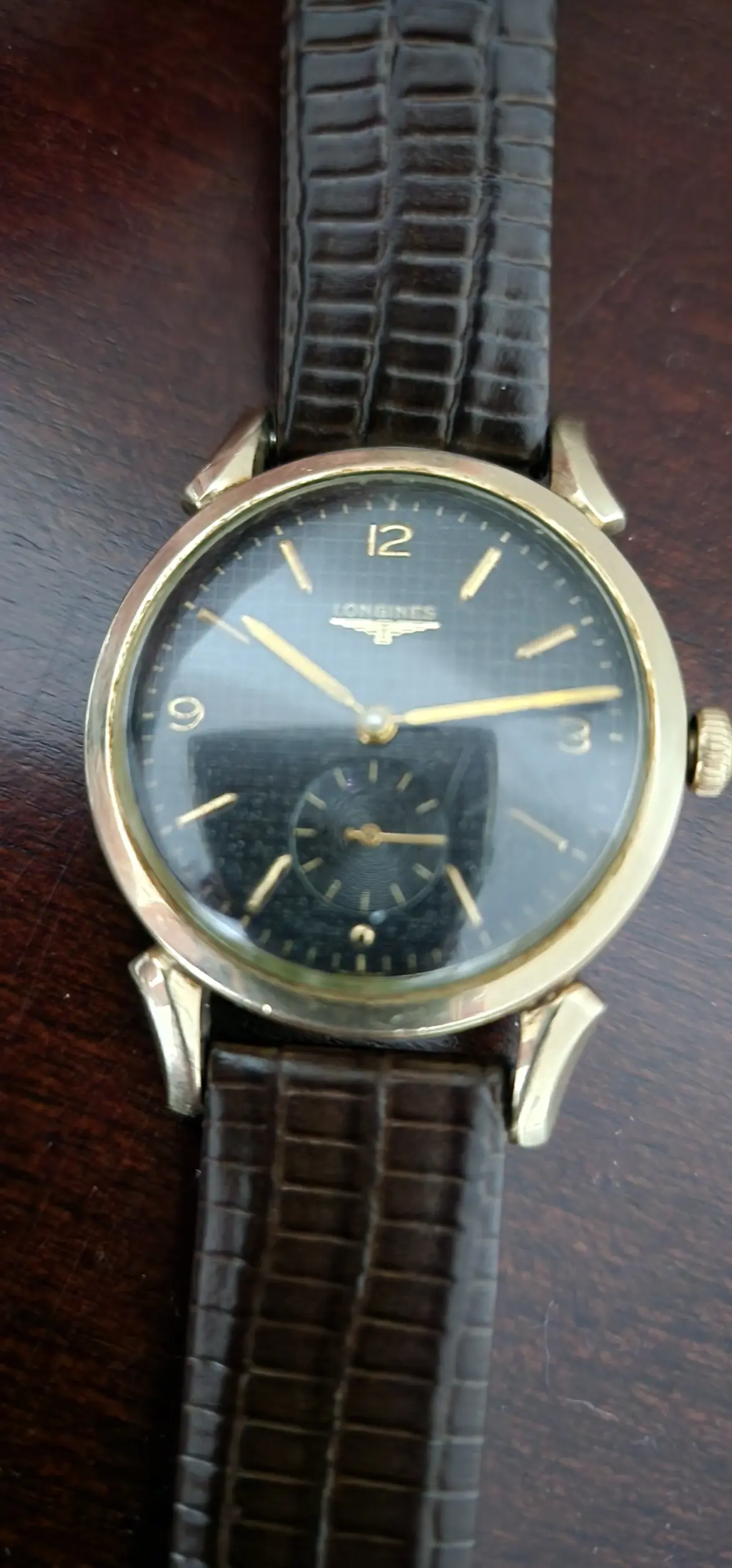

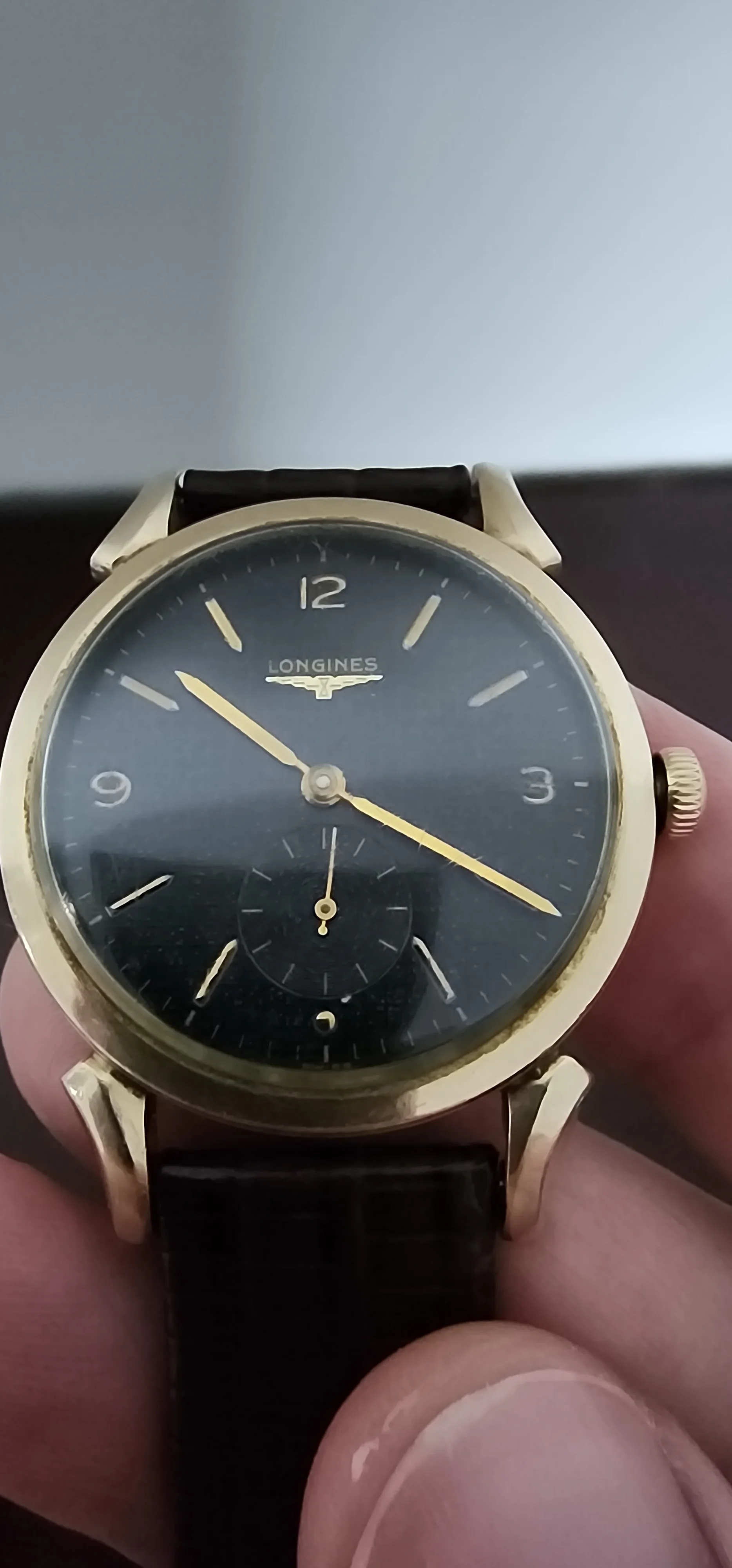

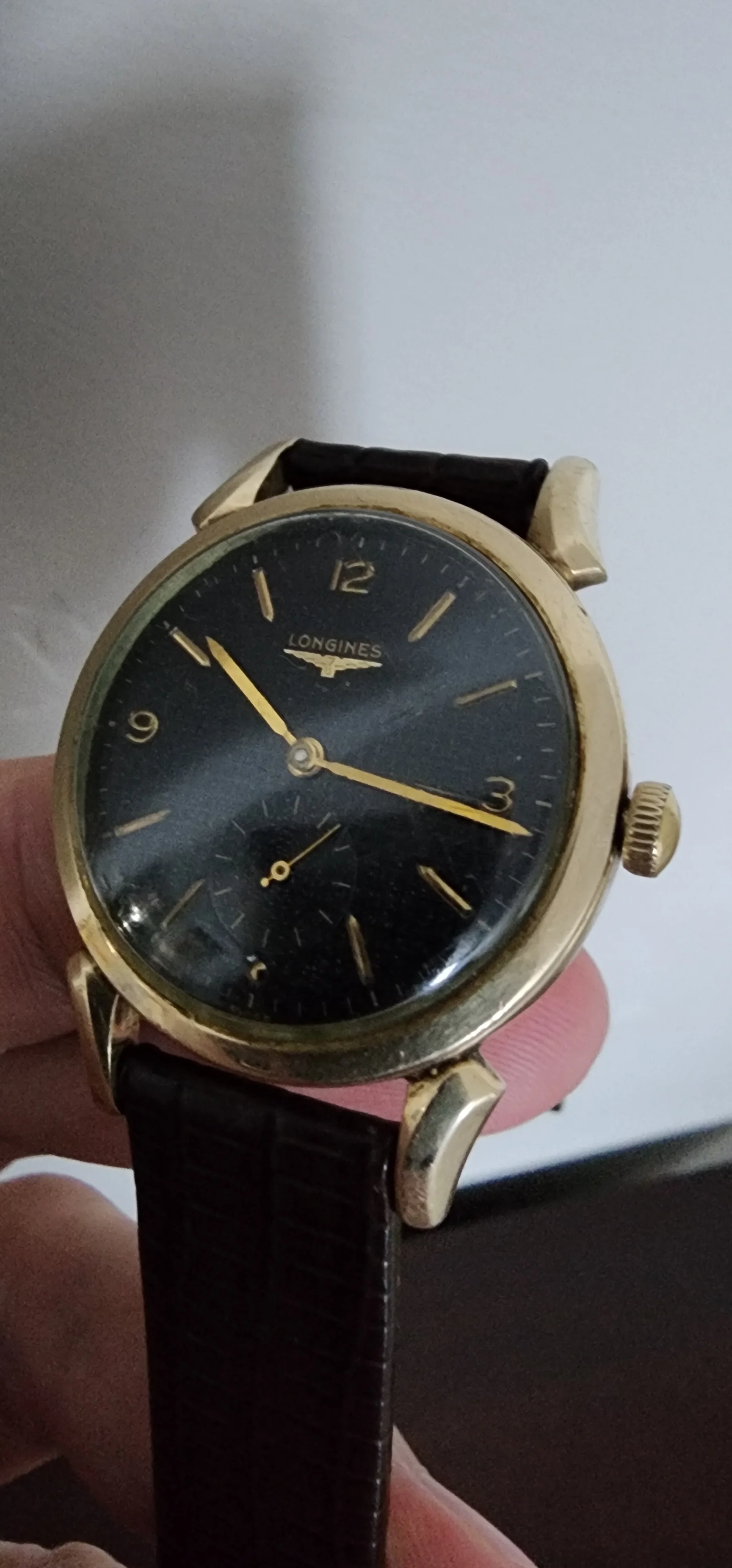

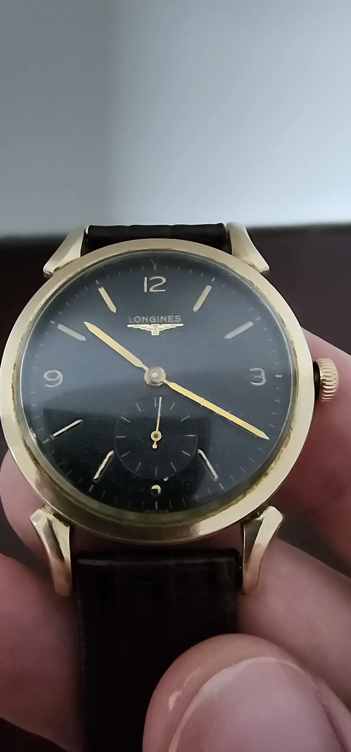

I had to google what it means to redial a watch. The dial has a small grid pattern that is difficult to see in normal light. Is that helpful? Here are some new photos; the first one shows the grid. I'm happy to take more photos if there are characteristics that help identify the model and age. Thanks!

Being a US cased model, it most likely won't have a Swiss made counterpart. To find out more about the watch you need to have it opened to obtain movement details and information from the inside of the caseback.

Thank you! I'll find a professional who can open the watch. I was thinking it is a screwback due to the 12 edges, but now I wonder if it snaps on.
18,776
39,019
It would be a screw back, only the cheaper watches used snap backs that looked like screw backs.

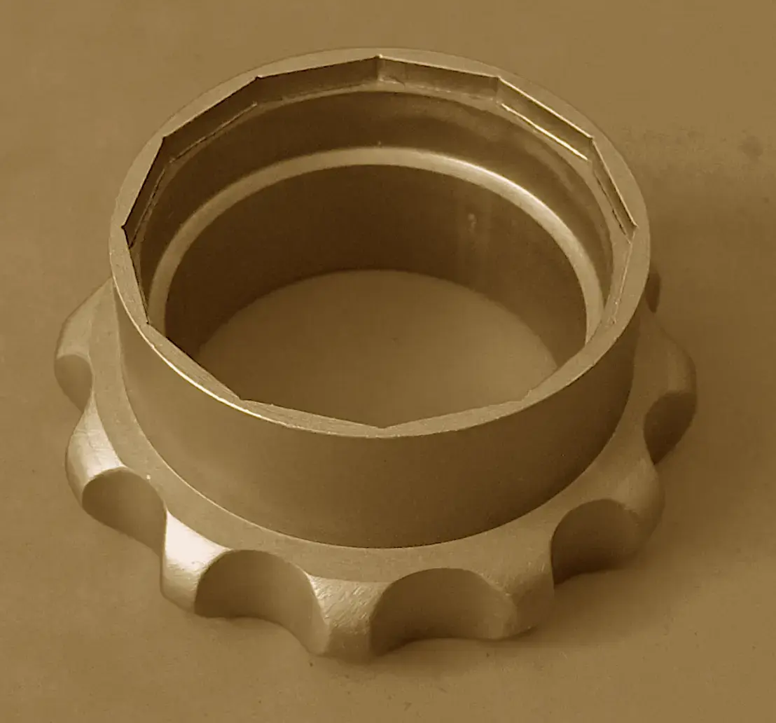

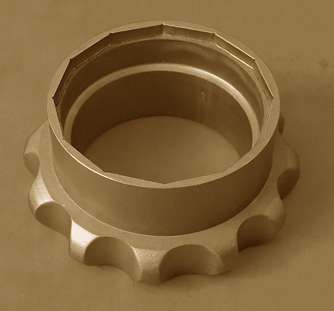

Ideally, you would use a tool like this.
4
Thanks Jim, you are the best!

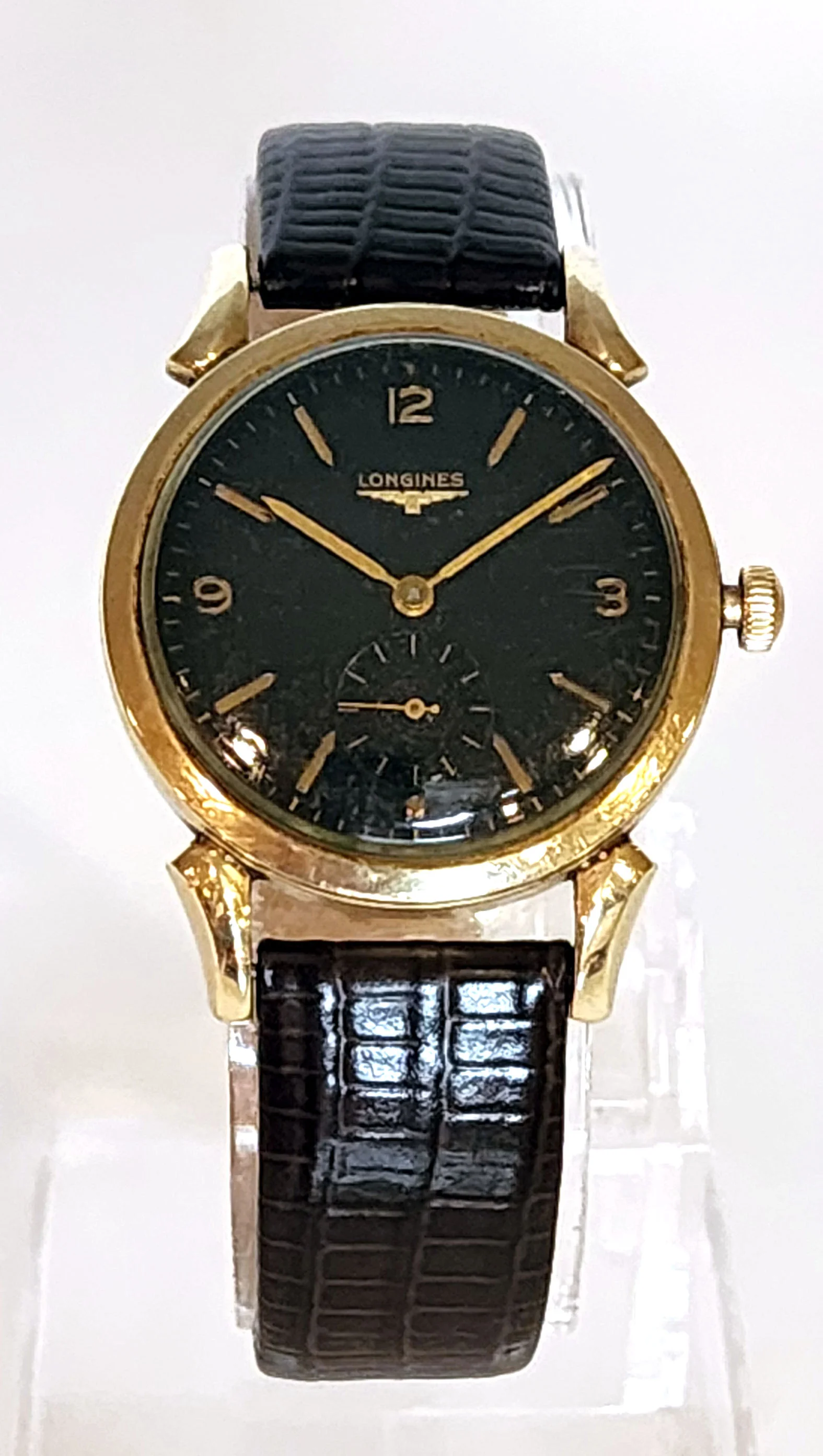

based on the style alone, it is a late 1940s or early 1950s watch. (Ie not art deco which was prevalent in the 1930s and early 40s).
There is probably no model name that can be identified because those are US market watches sold by Wittnauer which was the US distributor- and they marketed independently from Longines.
What you can probably find out if and when the case gets opened is the serial number of the movement, which can indicate the date Longines sold the innards to the US distributor.
The monetary value is relatively low in terms of what collectors value, because the watch is not very large and the case is gold filled.
Proper photos must be in focus - to see if the plating is worn and if the dial has been refinished.
That type of watch usually carries more sentimental value than monetary value.

Here’s a little homework for you. There is a website with dozens of old Longines catalogs from all over the world:
https://www.vintagelongines.com/#history
Focus on the time period mentioned above, from about 1946 to 1956. Stick to English language catalogs, you’re looking for US models only. if you are lucky, you might stumble onto your watch there.
