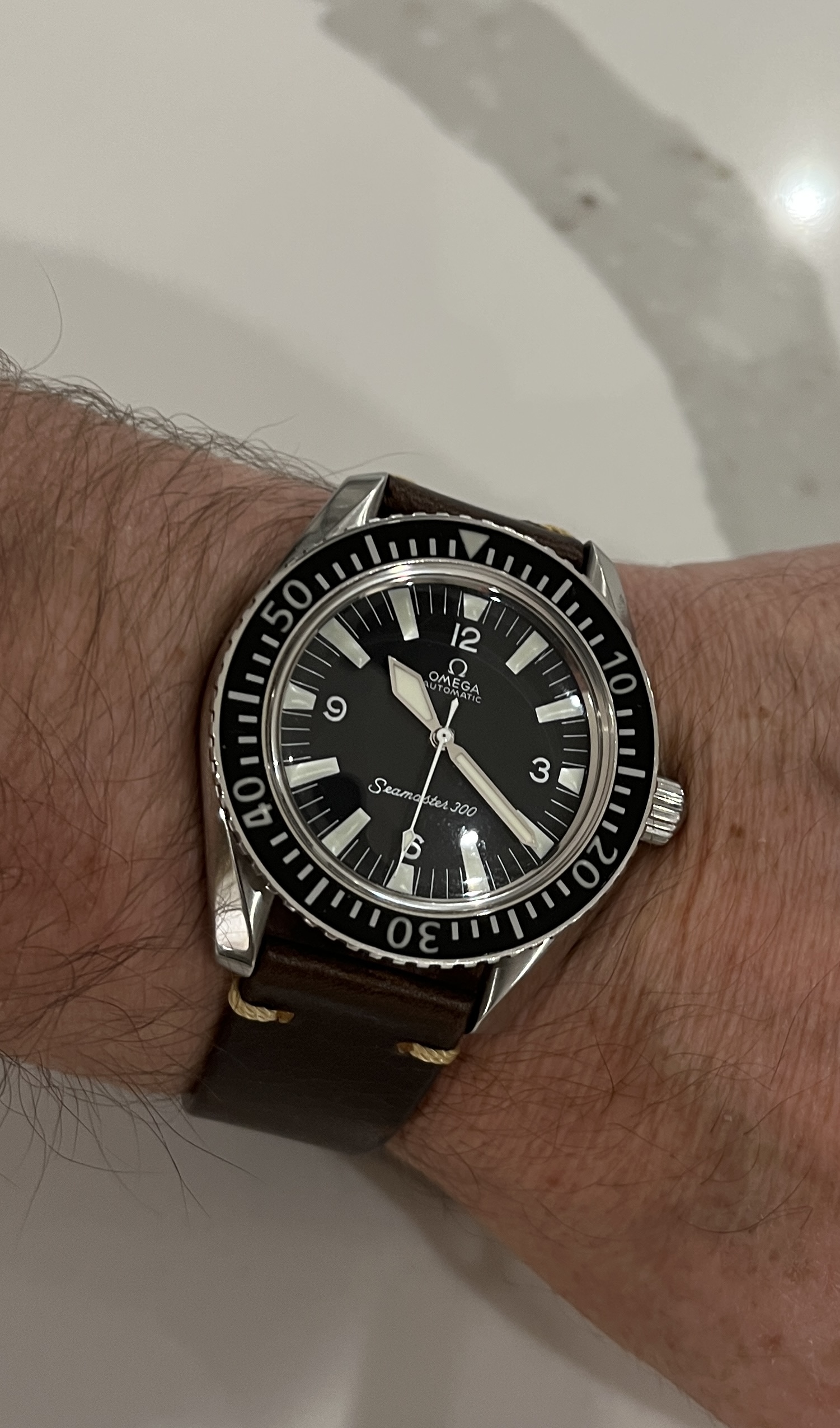

My WatchCo wore an Omega shark mesh but it just wasn't right for me. Nowadays wears the Apollo 11 50th bracelet and looks fabulous and I''m happy it's all Omega even if it is all modern parts, except the movement.

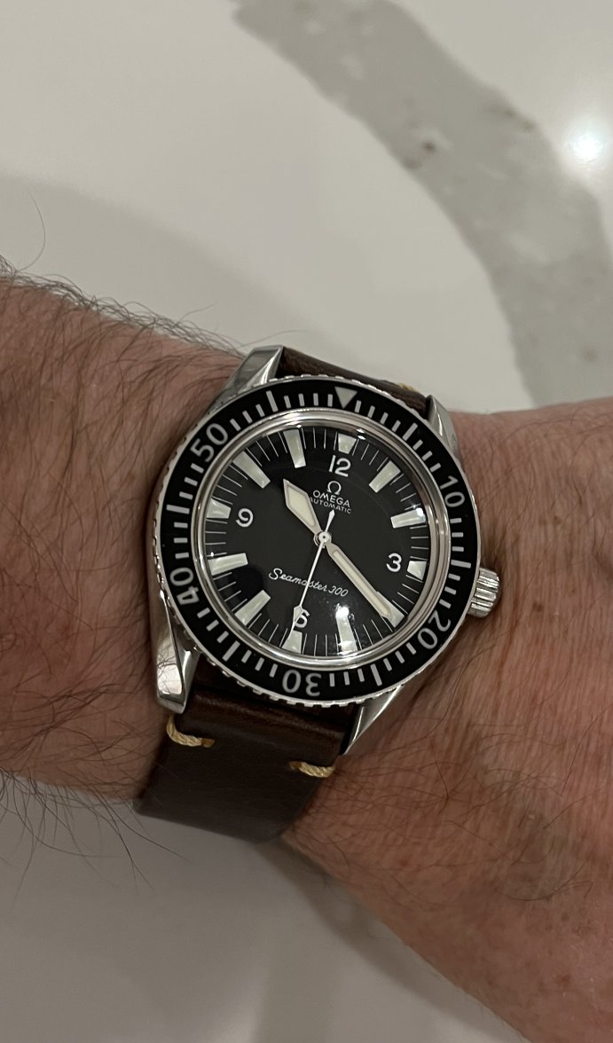

A thread on a similar question, might be worth a read. My 165.0324 likes either simple leather or an Uncle Seiko flat link. Would like an omega shark mesh but it’s finding one.

I'm liking that flat link. Is that the same head link size for the Speedmaster? My wife's Speedmaster has an 1171 bracelet and I can't remove enough links to get a good fit for her slender wrist.
Sorry for the slight thread drift 😁

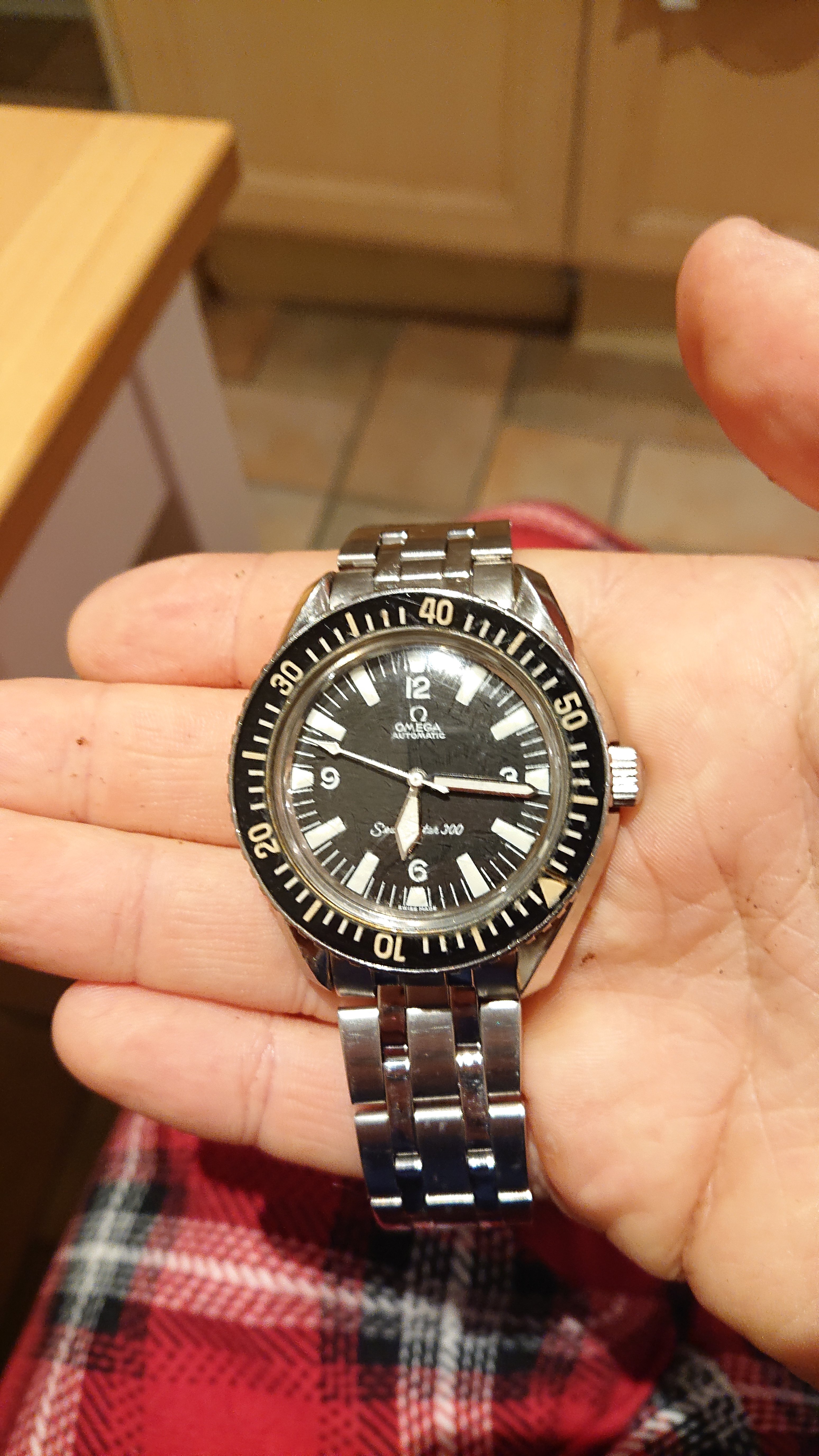

yes it would be great to find an original bracelet. I wonder what happened to the original one (of mine!) but original bracelets I saw are very expensive!

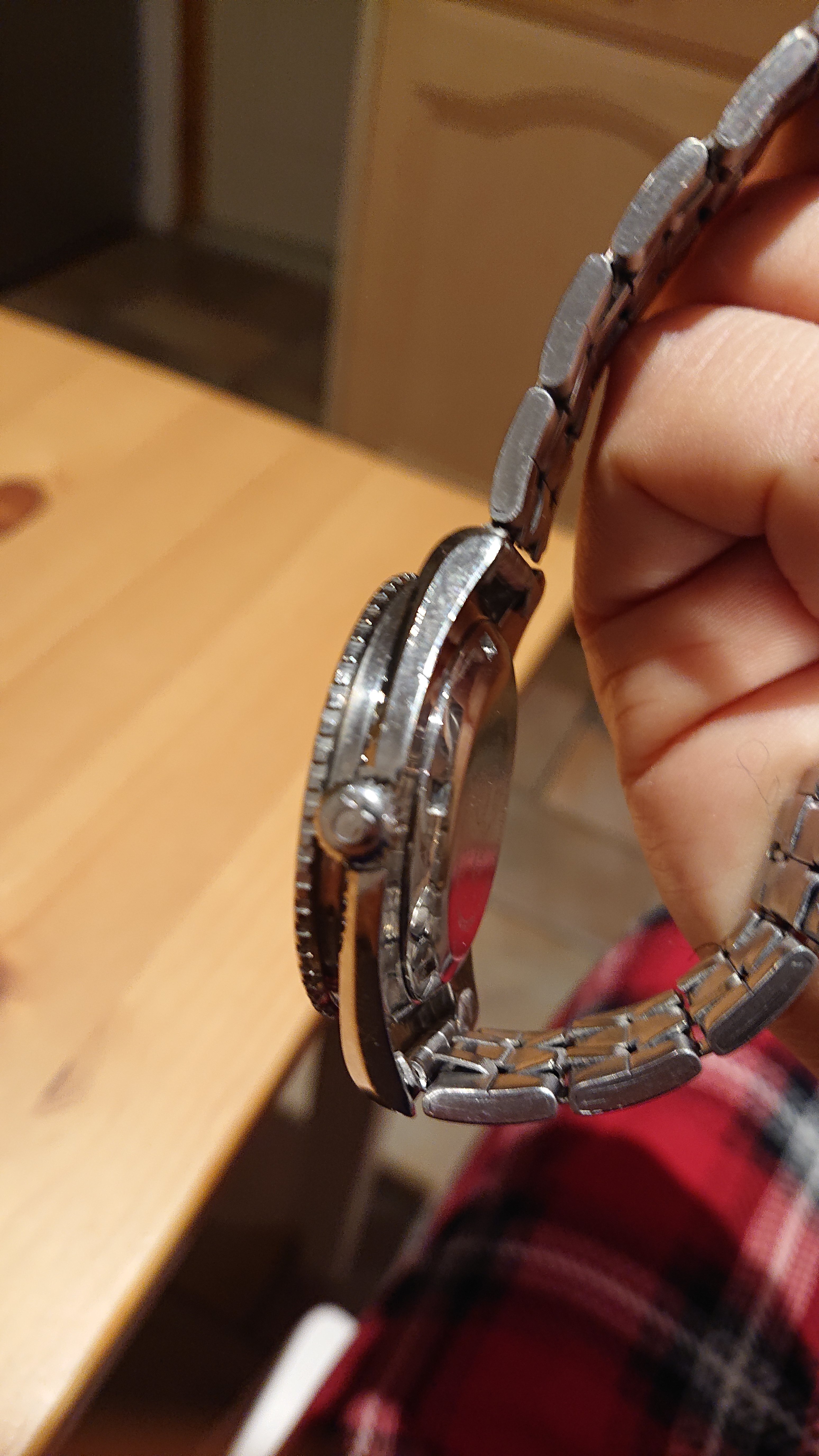

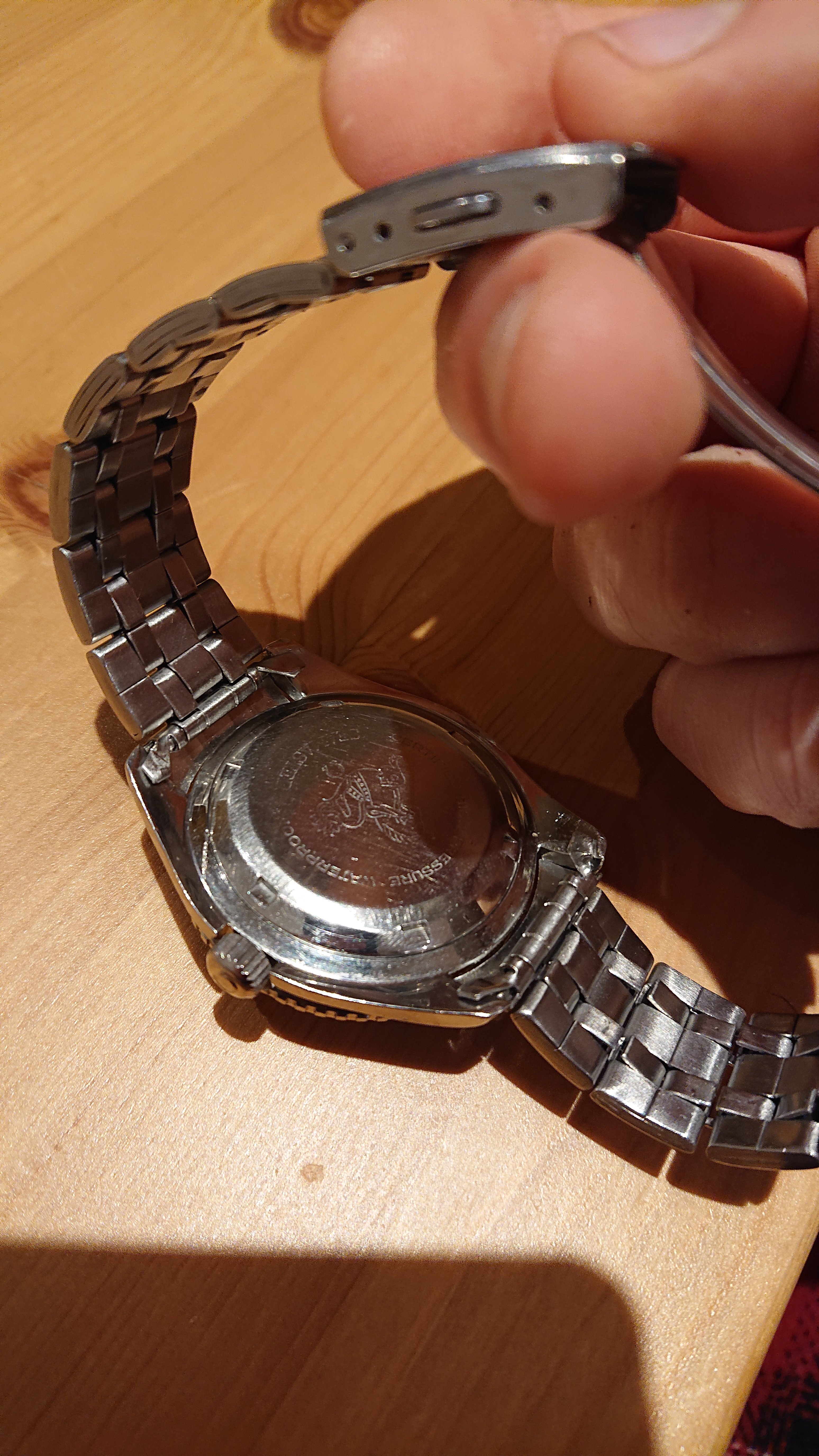

I think most of the things seem to check out when looking at the website but I'll have it serviced and have it looked it to ensure it's original. Good spot on the dial! It is indeed missing the T-T between swiss made
You're right on the crown, it does indeed have an omega logo (difficult to photoghraph). It seems to be protruding but if pulled it comes all the way out. It measures from start to end at around 1.5-1.7cms. I cannot seem to change the time on the watch so it definitely needs fixing. It will stop if not worn and if i move it it starts up again, but I think that's normal. The watch generally seems to have oxidisation or just general grime as I think it was sitting in a draw for ages as my dad didn't use it. And I noted the strap also not being the original either so thanks for confirming that!.
Could it be the crown is protruding because it might need a good clean? See pics and thanks for your help!

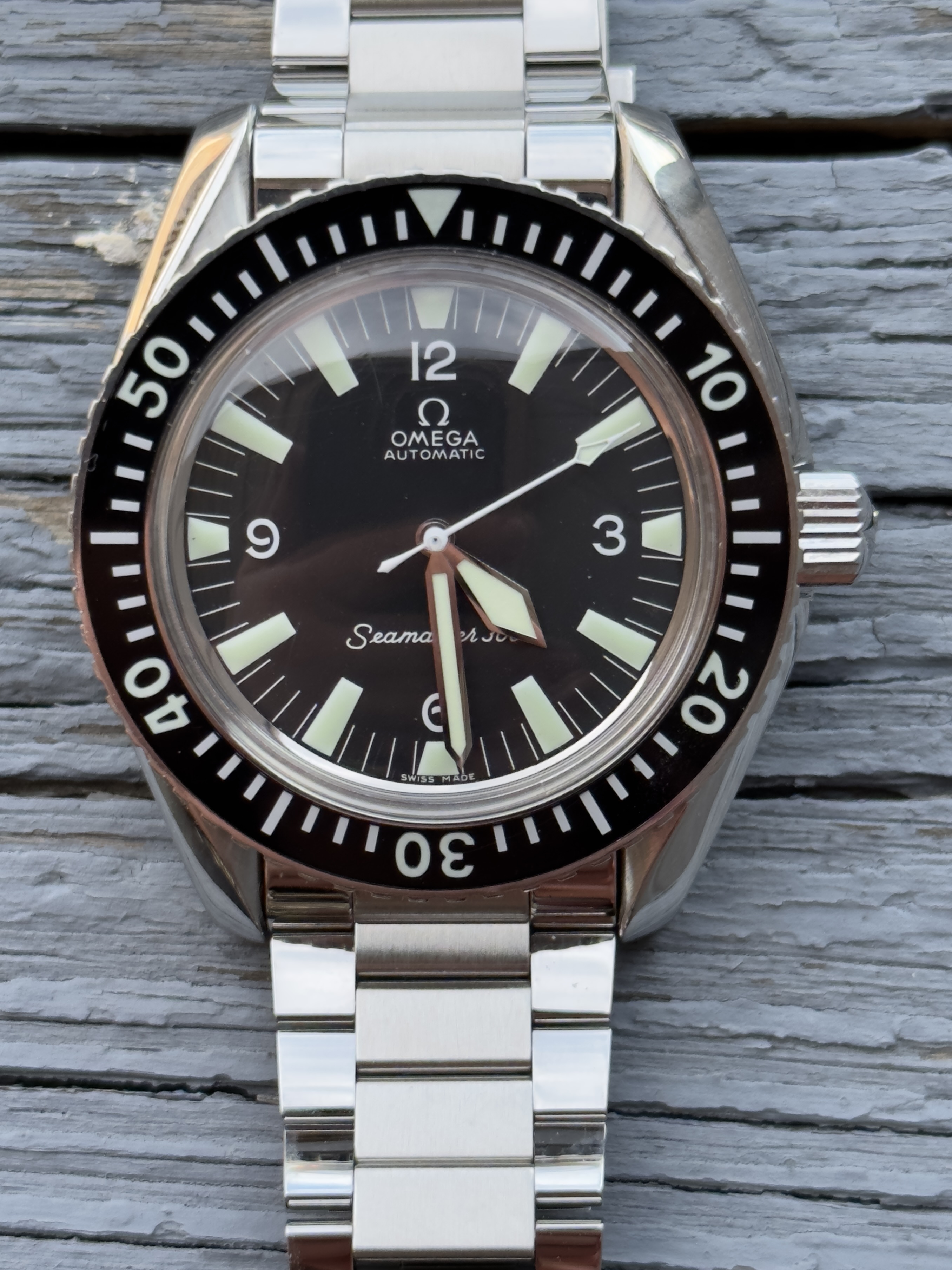

Finally got it back
The watch maker said the movement is all original and keep time beautifully, around 2-3 second variance. Here is the finished product! Crown is sorted and water pressure tested!

@asdrubalex I`d also look for new crown, as the one fitted to the watch is not model correct...
Does the watchmaker gave you the serial number of your movement?
he said it checked out.... they even did water proofing on it.
He said it was a 165.024 / 552 caliber - is that what i need? or is there another number?

The watch may be waterproof, but it doesn`t mean the crow is correct for this model 😀 It just fits the case tube and stem diameter.
Serial number is stamped on a train wheel bridge, 8 digits, I`d bet in your watch starting with 24mil..

Do you know if they tested it, or if they simply replaced/greased the gaskets? I would be a little cautious if you don't.
That looks like a Speedmaster MkII crown.

MkII Speedmaster is cal861 = TAP9 stem= wont fit cal552=TAP10.
But generaly agree, something conteporary correct...
yes, serial number is 25986944!

Sorry, 2598xxxx is not usual range for SM 300... putting the movement to beginning of 1968, should be CB case and B4 dial, yours is B3....seems more and more as a franken watch to me...nothing fits...
Production of the Seamaster 300 ended circa late 1970. I'm not saying your are wrong, just pointing out that a movement serial of 1968 could fall within the 1963-1970 range of the production period...
Are you saying the 25m serials are too late or more specifically that 2596xxxx is outside of the known clusters of sm300 serials?
25m serial movement is within the cluster of known SM300 serials.
