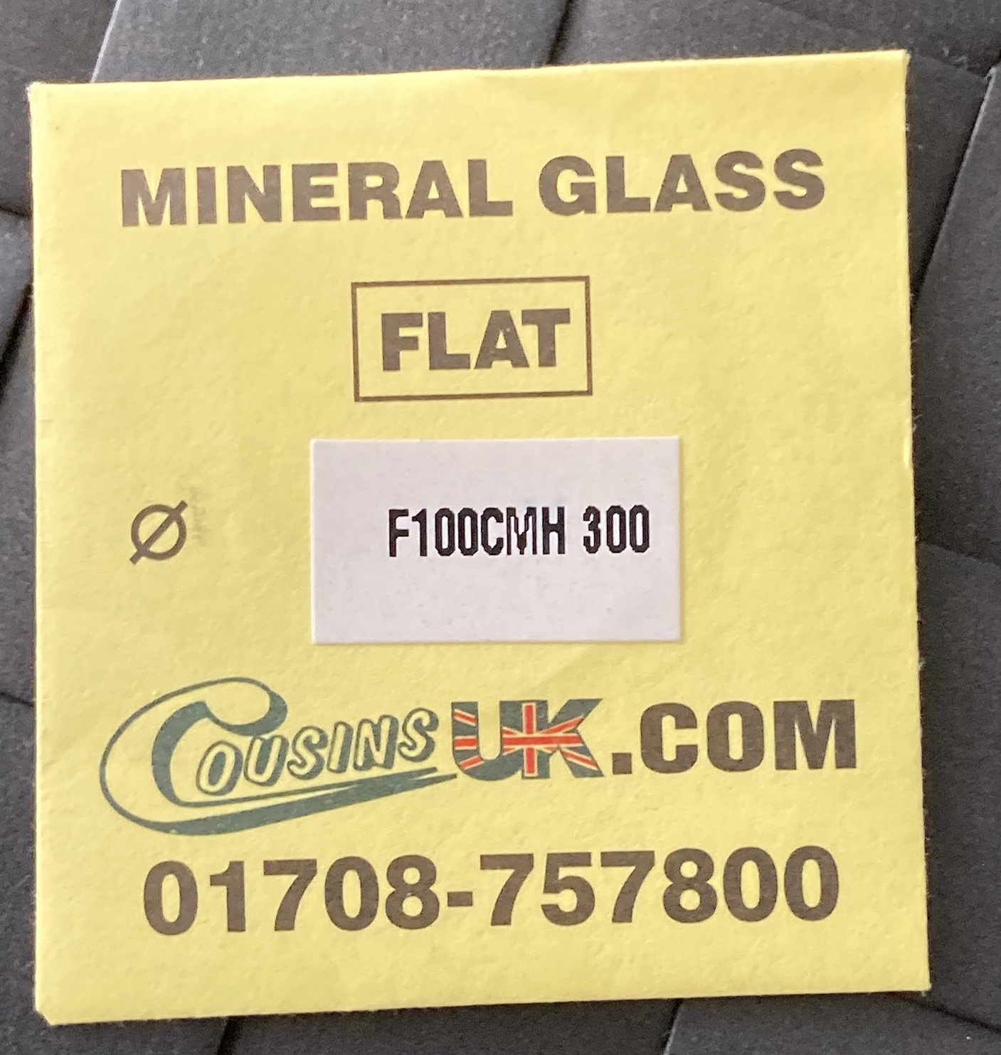

This arrived in the post today …. Someone else using Cousins….
15,993
48,105
A crystal lift will not work with a flat mineral crystal.
