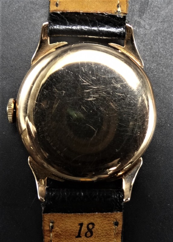

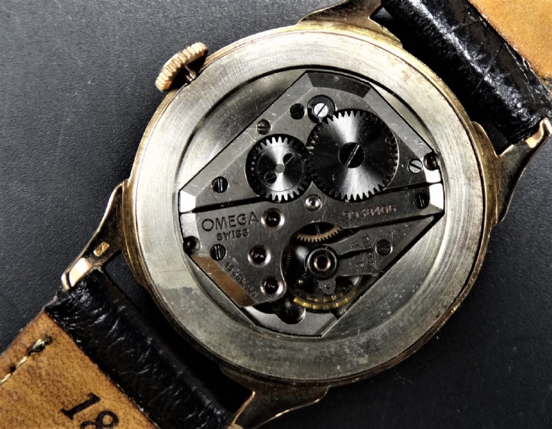

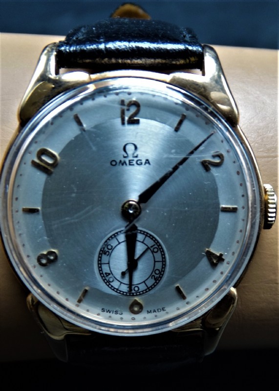

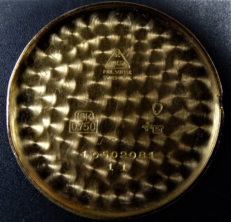

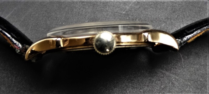

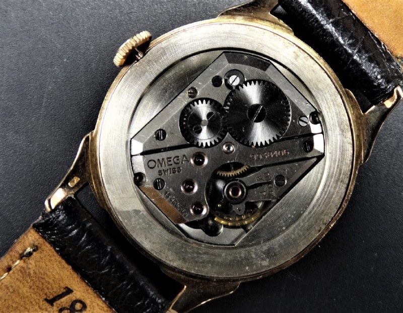

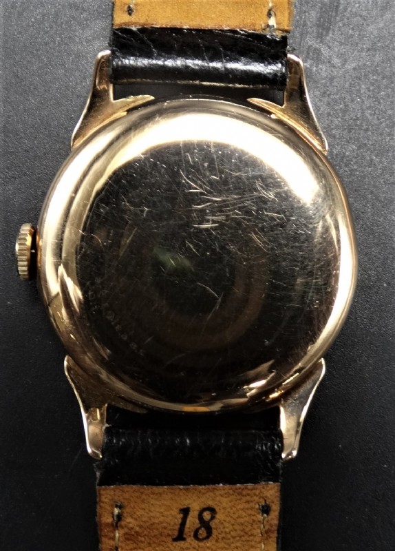

Would any of you kind knowledgable folk have any info on this movement? The Serial number dates it to 1943 I believe. Specifically, calibre, dates in production, models it was used in, etc... Thank you in advance for any information. ACD
9,588
27,706
Looks like a cal 17.8.
You should try google images for that particular cal. and start there. Omegas of this era had reference numbers, but they weren't really used by the public and model names weren't a thing at that time.
25
87
Thank you. I did find it in google images. Listed as R17.8. Took some hunting. I did not realize that there were no model names in use in the 40s. Thats good info. Thanks again.
Omega R17.8 calibre movement
Features
manual wind
sub second
Data
Dm=Do= 17.8 x 22.0mm
H= 3.25mm
15 jewels
f = 21600 A/h
power reserve 45h
Balance staff U1249
Stem W1040
Main spring
Zf673, 1.2 x 8.0 x 0.10 x 230mm
Remarks
1939-1949
bimetalic screw balance
family:
R17.8: sub second
R17.8AM: sub second, antimagnetic
R17.8SC: sweep second
R17.8SC AM: sweep second, antimagnetic
