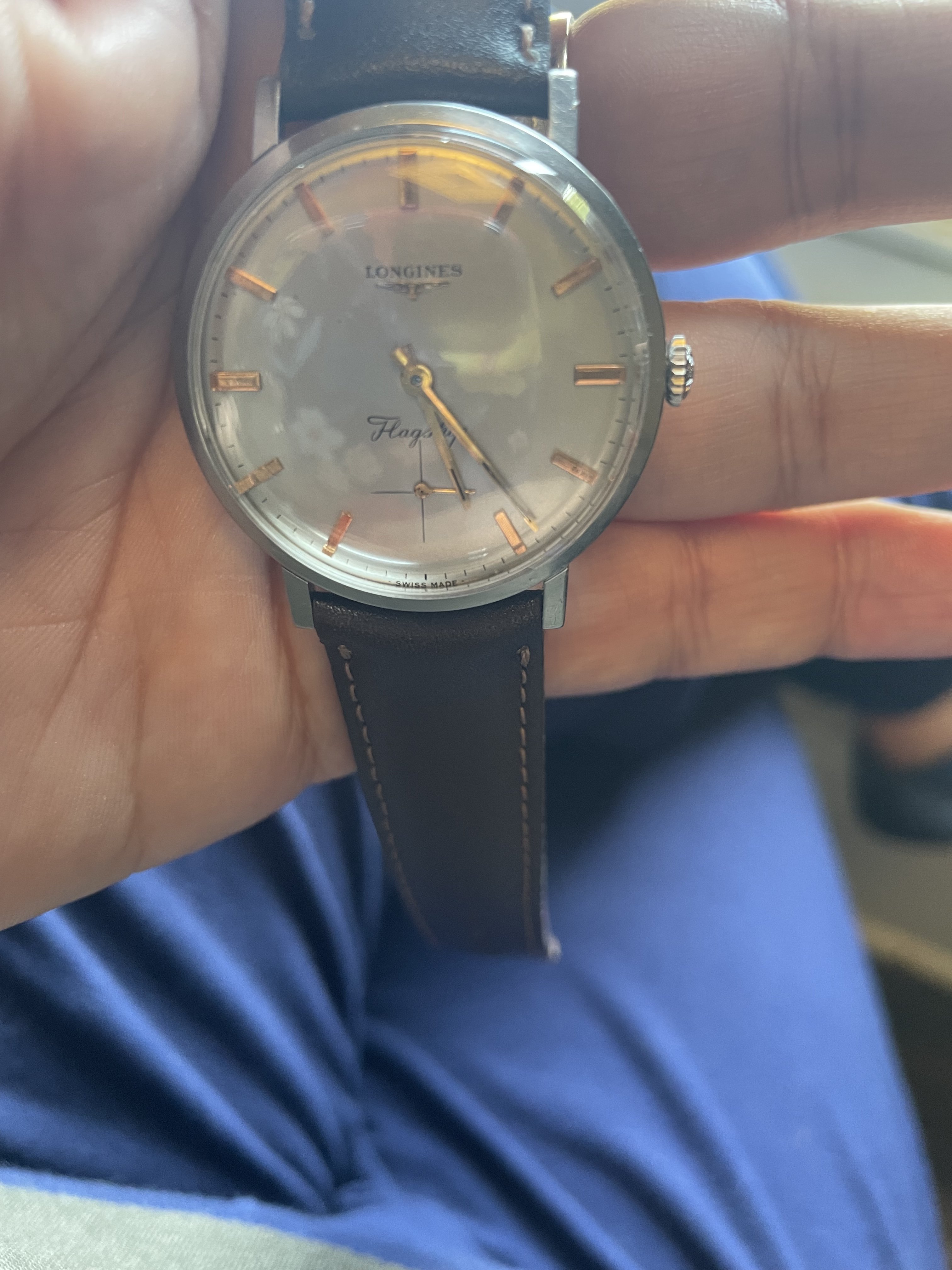

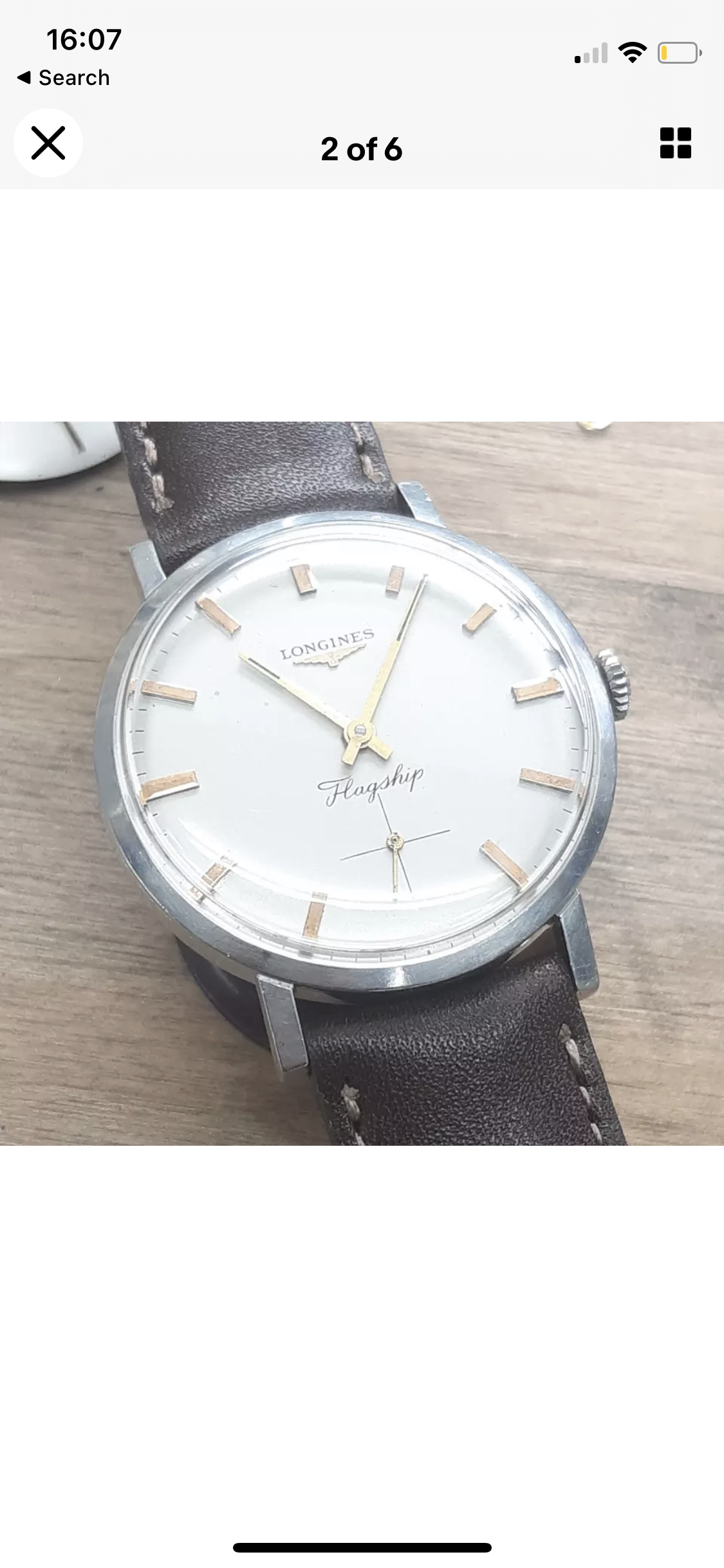

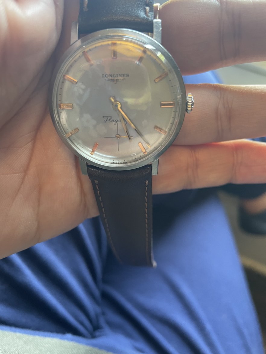

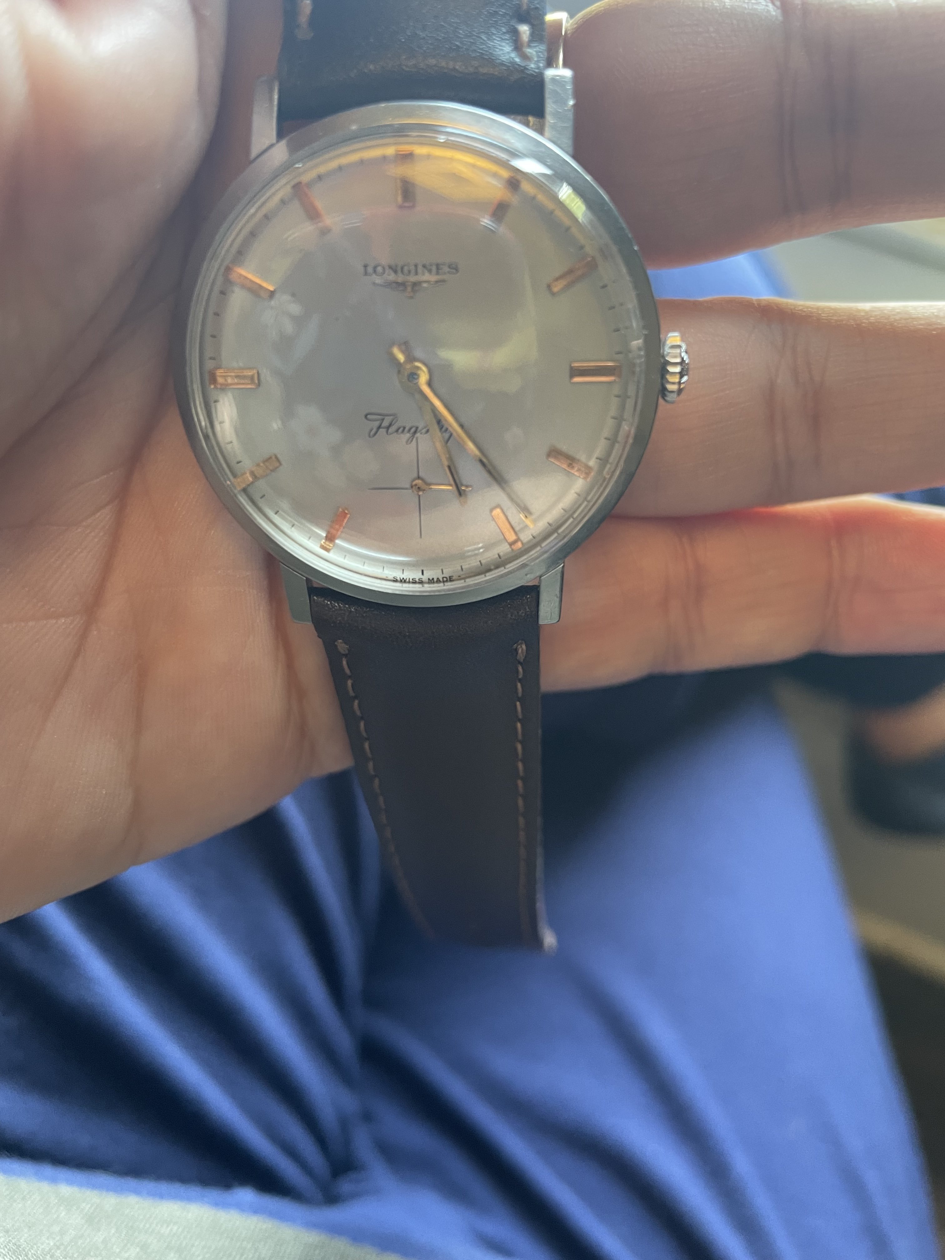

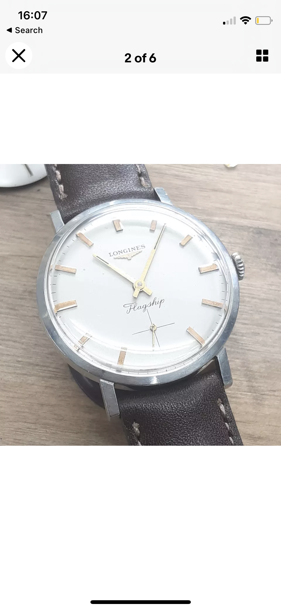

It’s my fault, I didn’t look closely enough at the word “refurbished”. My big issue is the numerals are copper colour and the hands are yellow gold. Is there any chance this is original?
I’ll put it on eBay soon….just wanted views. It’s a Longines 490. Also the face looks grey in real life, on the photo looked white.

Have you compared it to others with the same reference number on the internet?
Difference between hands and markers could be explained by a replacement of hands during a service...
That said, I don't like the Flagship writing ... Looks like a redial to me.

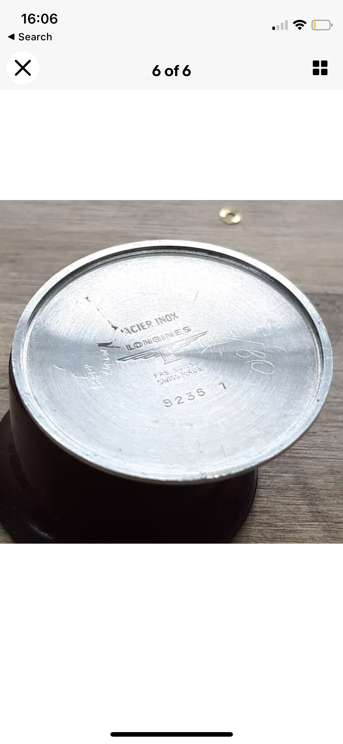

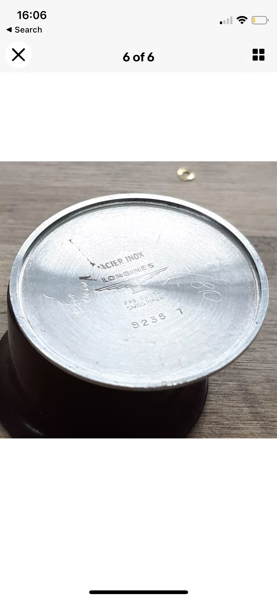

Can’t return it apparently. Bought from Argentina. Yes, I think the hands have been replaced too. Not convinced it’s a redial - my photos don’t show it but there is some patina. But I shall check. Is the number on the back the reference number?

I think you could return it based on the heavy color processing in the dial, which makes it “not as described”.
Just say the pictures were deceptive— which is true.
Even if the listing said “returns refused”, Ebay is famous for siding with buyers who are unhappy— you should file a claim.
PS and yes the reference number should be the one that’s inside the case back, unless of course that part was swapped. and I do, sadly, agree the dial looks refinished.
I think you should try to file a claim immediately with a picture saying you would never have bought it if the picture had not beenanipulated.

I’ve asked again. Having it in front of me am not convinced it’s a redial, but the hands are certainly replacements, and it being grey not white is annoying.

Thanks! I’ve checked the model number and despite scepticism, I think the lettering checks out - it’s just the dial colour and gold hands that don’t. Redial/repaint- maybe, and new hands definitely I think.

I am with @LesXL, the Flagship font looks fishy to me. I recently bought a 1960s Seamaster. I searched out many examples on this forum and elsewhere that I was confident had original dials. Then I zoomed in and clipped out the Seamaster script of each one and put them in a single document with notes including the watch reference number and year if known. This helped me understand the variabilities of the font and helped me learn to spot redails. I feel pretty confident on the coat hook S Seamasters now. I am not an expert on your watch, but I think you could employ the same strategy. I am not confident either way with your watch.
I wish you the best possible outcome. I would listen carefully to @Syrtle's advice. I just noticed she said she thought the dial is refinished. She is a Longines expert, I would trust what she says.

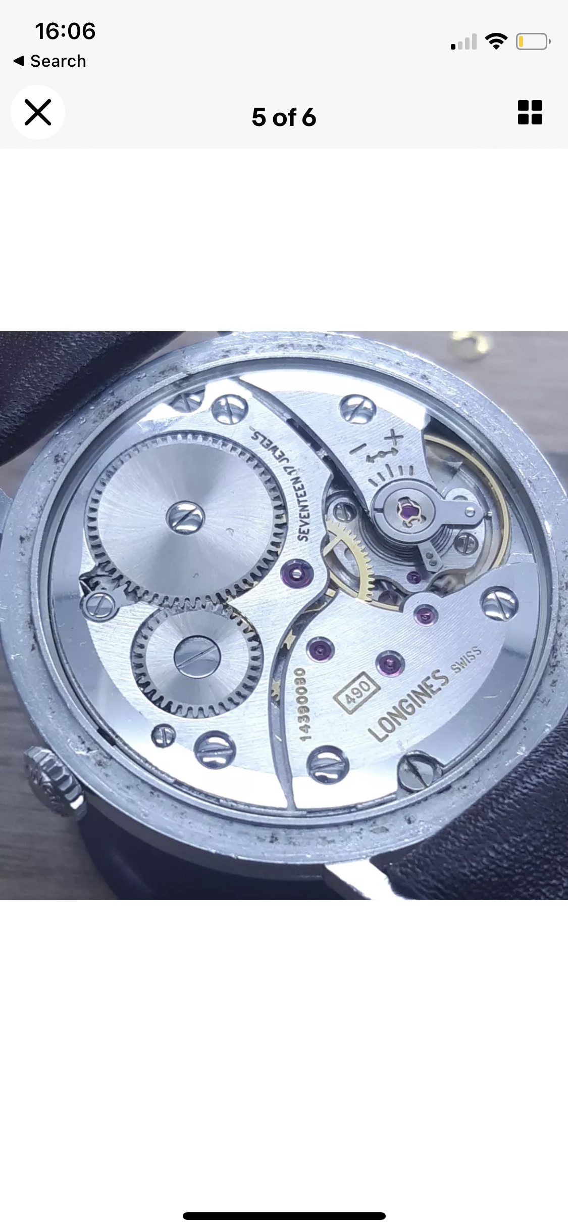

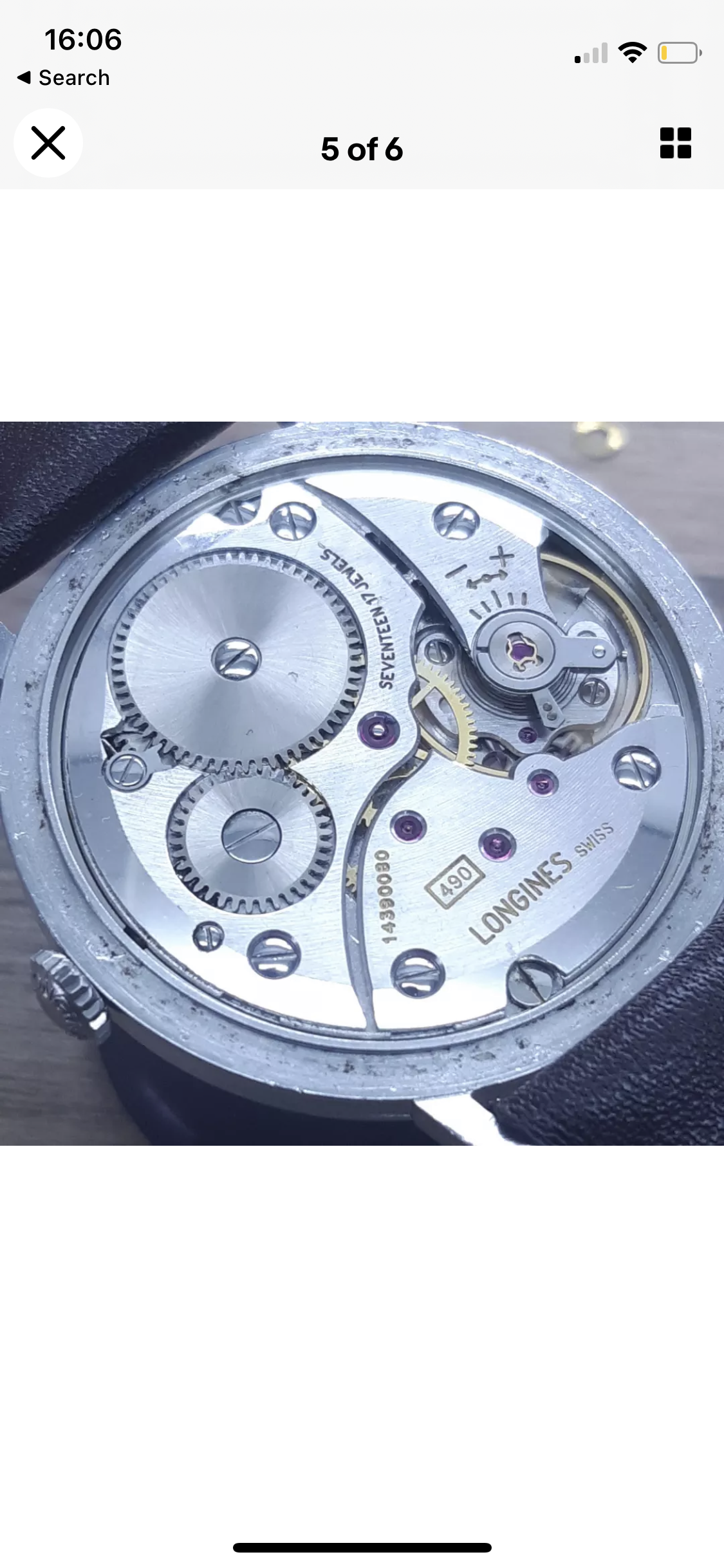

Thank you. The odds are certainly stacked in favour of redial (I don’t think they ever made this grey colour), and the hands are certainly different and have been replaced. I’ve opened the back; it’s an 8286-1
, and it’s got a 490 mechanism ticking away inside, which is something. The vendors are standing firm on the returns issue, I’ve asked. I’m inclined to relist it on ebay noting the flaws and risks, I don’t have the energy for a fight.

Ok so I’ve checked the font out further- and you’re right, the p on the font isn’t right, it doesn’t have the same curl the real ones do. Redial for sure.
Damn. Thanks for the education.
