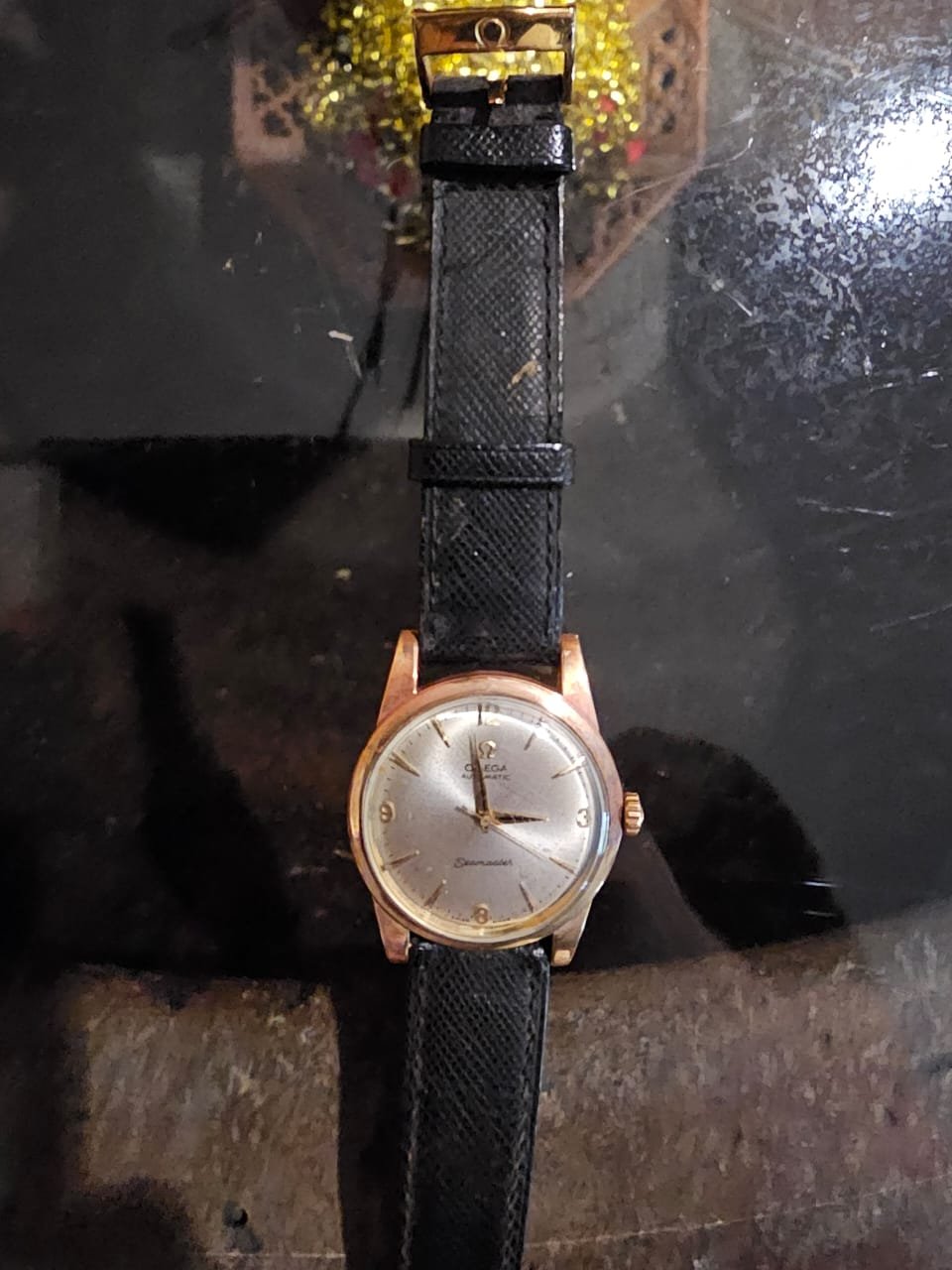

I have a Seamaster that predates 1948?
Hey guys, I've recently received a vintage Omega Automatic Seamaster from my dad who bought this watch from an antique shop in Malaysia 30 years ago. I am trying to learn more about it and I've recently sent it to the Omega service center in Switzerland for inspection/servicing. It still worked after being wound, despite being left in a cabinet without use for 20 years!

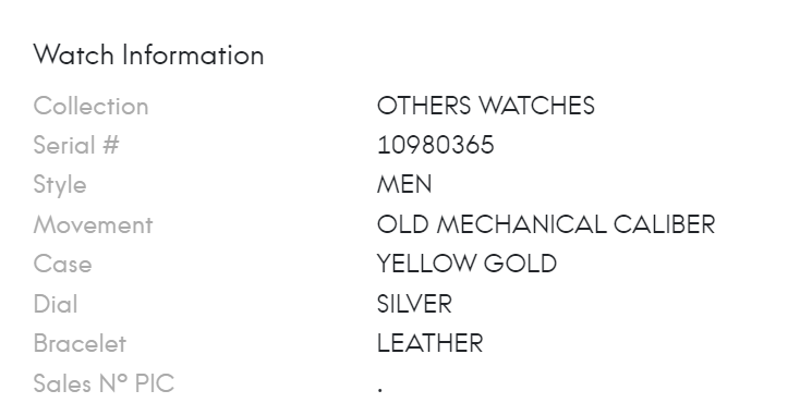

The service center has just received it but it appears they have opened it up because my online tracker has been updated with the serial number - 10980365. According to online serial number checkers, the watch was manufactured between 1944-1946. I've referred to a few, including https://serial-number-decoder.co.uk/omega/omega.htm and https://www.emmywatch.com/db/serial/omega/. However, Omega did not release the Seamaster until 1948. Not too sure what to make of this but I am aware that these sites are just estimates not and not official Omega numbers.
I am just trying to identify its make and whether it is fake or not. And if it is real, how much is it worth?
PS: Sorry if the photo isn't really clear. I just took one shot before I sent it off before deciding to post here.

That dial appears to be much later. So either the serial number is a typo or the dial was replaced/repainted.

You will need to ask the service center a couple of questions:
1. Solid gold Omegas from that era had two serial numbers. They will not be the same. Is the serial number provided from the case, or the movement?
2. What is the case reference of the watch? This may or may not be engraved on the inside of the case back.
The is no question in my mind that regardless of the answers above, your dial was refinished or replaced at some point. That logo font was not used by Omega until the 1960’s.

If the serial number is for the movement, it's almost 11 million which would date the movement to production in 1947 and it's possible that it would have been cased in 1947/48 which would tie in with the release of the Seamaster.
PS: Concur with previous comments re the dial.

Note that in the information sent to you from Omega where it says "Collection" it says OTHER WATCHES, not Seamaster.
It's interesting that they did not give the reference number from inside the case.
