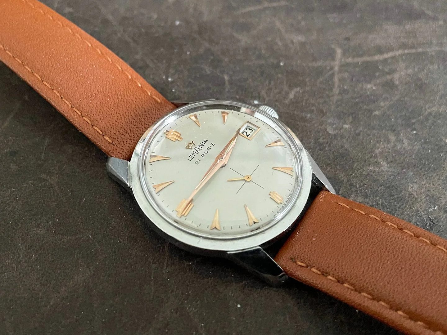

I've been in this game long enough to know better. What's more, my usual problem is often indecisiveness, so I often missed out on deals because I was asking myself too many questions beforehand and others jumped at the opportunity. And while agonizing over a purchase peripherally played a part in that tale, the outcome is that I for once made a purchase that is questionable at best.

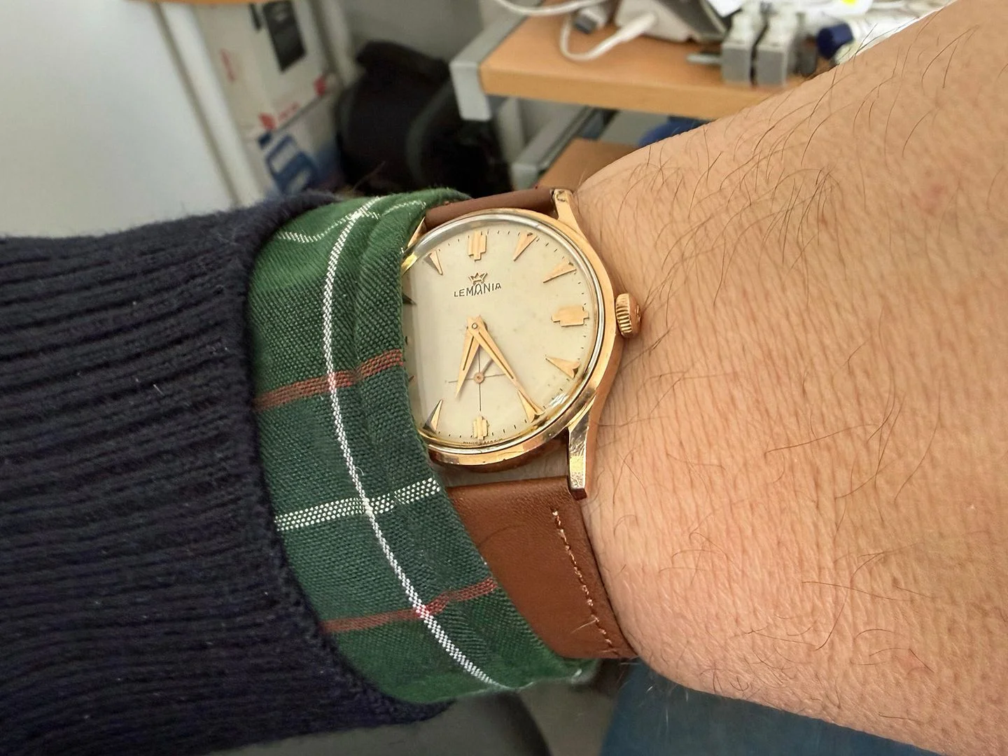

Let's rewind a few months back. I have always loved the sort of Art Deco indices found on the dial of some calibre 3000 Lemania watches, and I had been on the lookout for a good one. A seller in the Netherlands had a nice 280 KO for sale that ticked most boxes, except that the dial had oxidized and turned yellow. The effect is actually not too bad, but unlike some other collectors I'm not into "tropical" dials. Besides, I thought that the price was a bit steep, so my search went on. Then I found a near identical watch sold by a professional seller in Sweden. The dial was clean, and it came in its original box. What's more, it was cheaper than the other one. No brainer, right? Well, not really. I hesitated, and days turned into weeks and then months. It was still there, staring at me, and I still didn't pull the trigger. Until one day, when I said to myself that enough was enough and I needed to act. Well, it turns out that the watch had been sold the day before!
I was very disappointed and I felt stupid for waiting this long. I told myself that I wouldn't make the same mistake again, but I didn't realize that I would let the pendulum go completely the opposite direction. A few weeks ago, I stumbled upon a listing for a Lemania watch with these indices I love so much. What's more, it was a full stainless steel model, which I prefer to a gold-capped one. The listing had a few more minutes to run, the price seemed okay, and my wife was waiting for me downstairs to have dinner. So I placed a bid and signed off. At least, I would have given this one a shot.

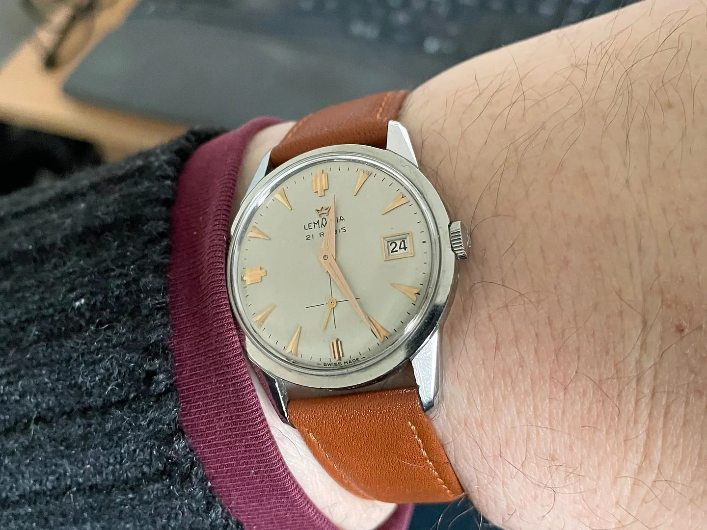

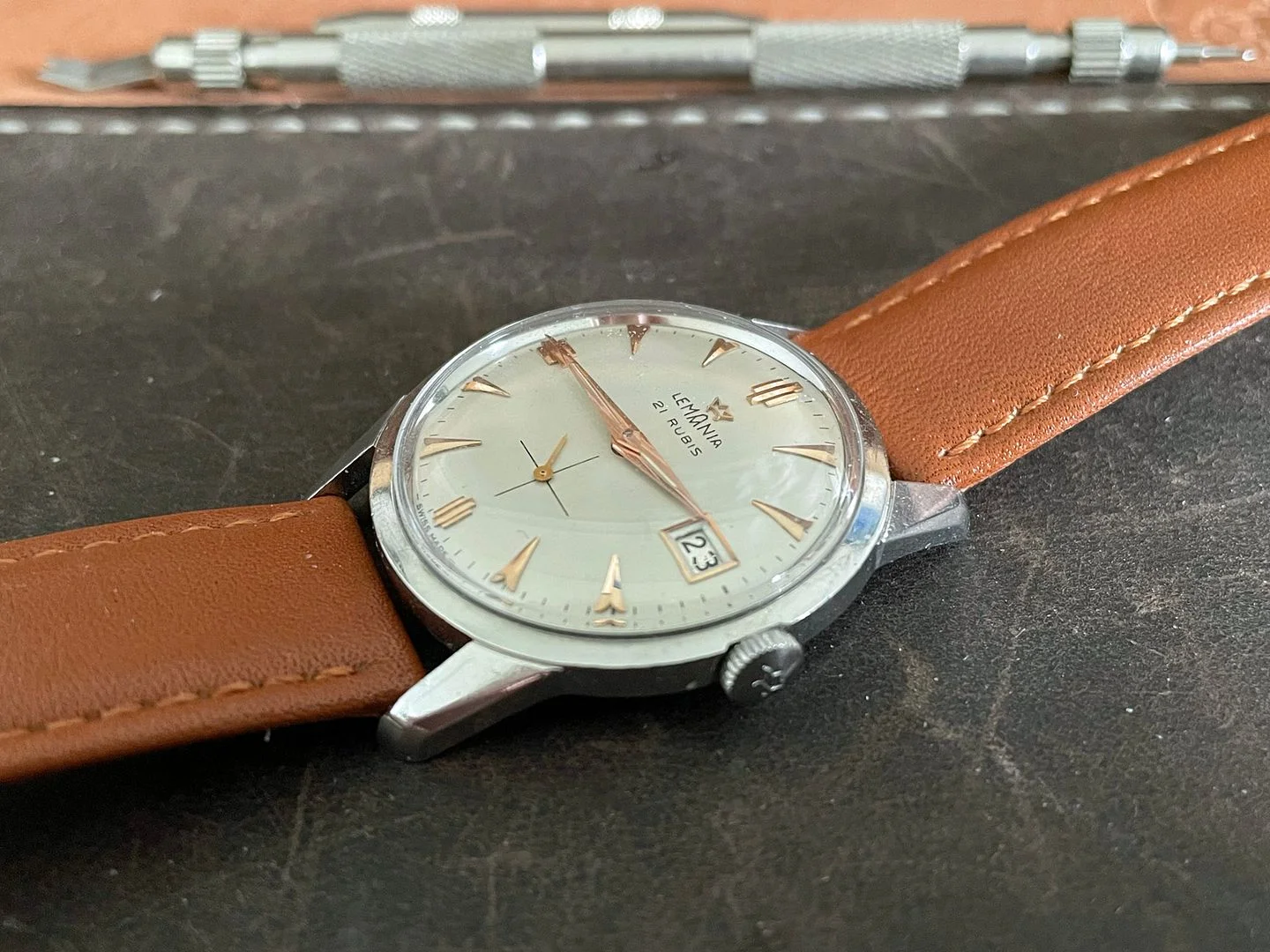

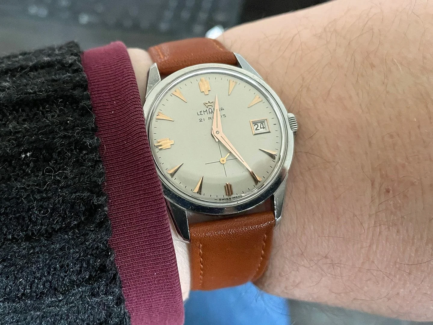

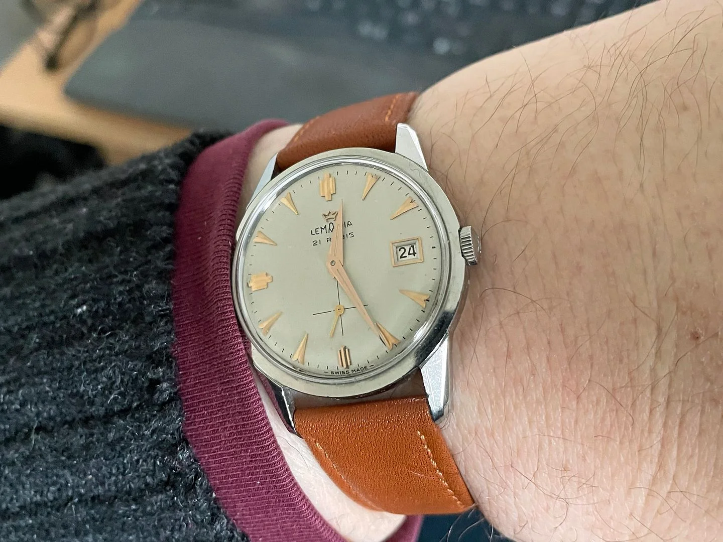

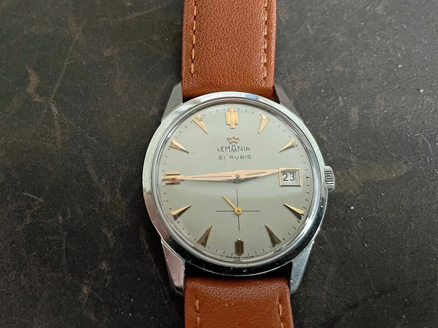

I immediately started having second thoughts about this watch. Some details should have raised red flags, but didn't because I was just in love with how beautiful the watch looked in the pictures. So, immediately after dinner I went back to my computer and found out that I had won the auction. And buyer's remorse was setting in fast. Some of the indices looked slightly misaligned, and there was no lume at their base. The hands looked brand new. What's more, the script on the dial included "21 rubis", which would be right for a calibre 3010, but this particular watch had a date window. I was not aware of a calibre 3015 variant with 21 jewels, and a quick internet search gave me no indication that such a rarity existed. What the hell have I just done?

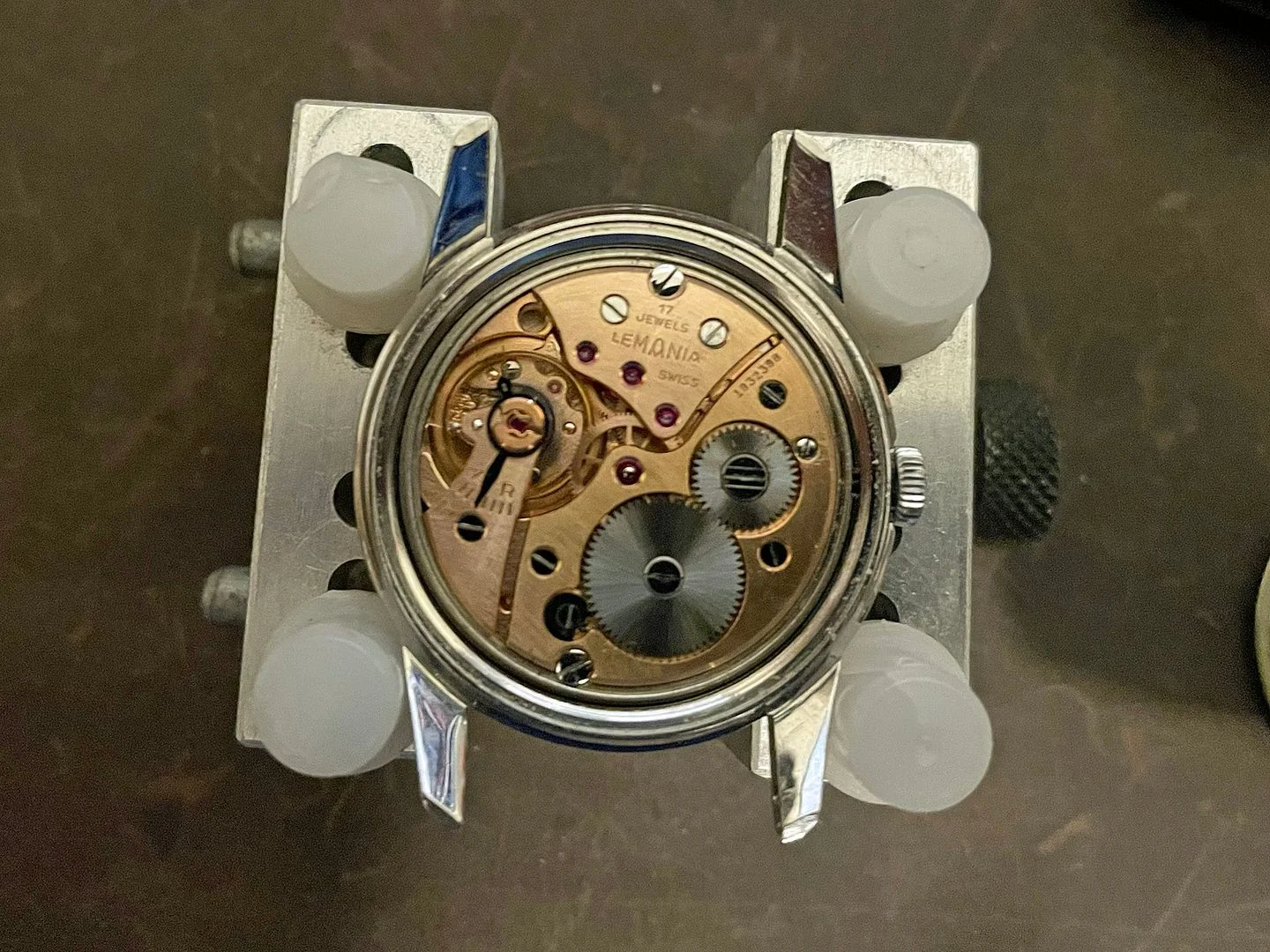

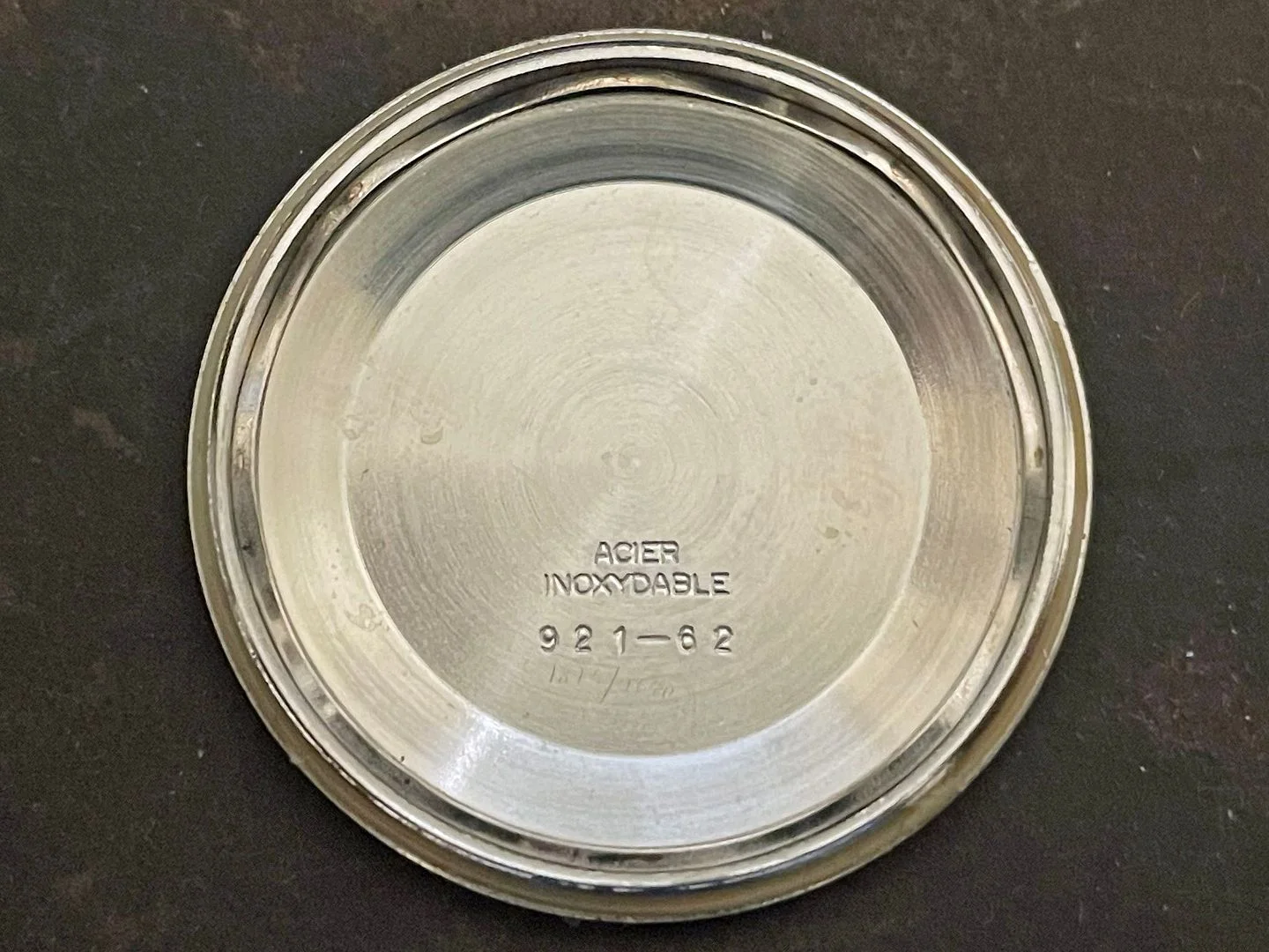

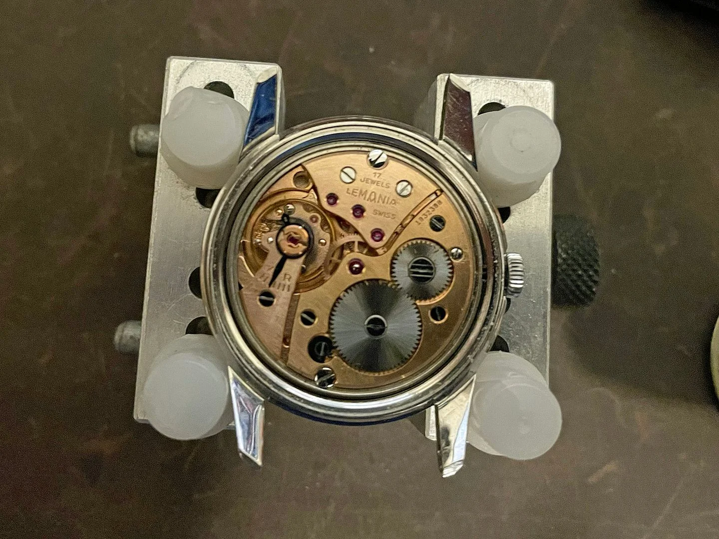

The watch showed up a few days later, and upon opening the caseback I was greeted by a plain vanilla 17 jewels calibre 3015 in a ref. 921-62 case. So my theory is that this watch has received a redial, made by someone who for some mysterious reason took a calibre 3010 as a model. With that in mind, I felt had, even though I can only blame myself for ignoring the signs and acting compulsively. That said, I can't deny that this is still a gorgeous watch, but its overall authenticity is seriously open to question.
I hope I can go past this feeling because it remains a watch I enjoy wearing, and given its questionable pedigree I would not be comfortable putting it back on the market. So, tell me guys what you think. Am I paranoid, or did I make a mistake as I suspect?

Nice watch, I'd certainly wear it, and only 3 people worldwide could tell anything was amiss.
And only one of the three would stop you in the street and scold you.
Enjoy a great looking watch at peace.

Nice indexes! Unfortunately I 'd file this one under redial, the tick marks don't fit too well with those indexes (typical for redials).
Also the dashes around swiss made may be out of place for what I think is a 1950s watch. I'm not a Lemania expert so it's just my opinion...

I like it, even with it probably being a redial. I'd just wear it and enjoy it for what it is.

Yeah, I'm 99% convinced it's a redial. The poorly aligned indices, the dashes around the "Swiss Made" mark, the complete lack of oxydation whatsoever on the hands, and last but not least the out of place "21 rubis" marking for a date dial are all signs that I could, and should, have spotted if I had spend a couple of minutes scrutinizing the seller's pictures before placing my bid. That's why I'm so mad at myself for falling into a such obvious trap. What the hell was I thinking?
On the other hand, I still find the watch gorgeous and get pleasure wearing it. It's still an original calibre 3015 movement, the case is in pretty good shape, it has an original Lemania crown, so I guess it could be much worse. The only point that still bothers me a lot is the fact that the dial advertises a 21 jewels watch on a 17 jewels one. I just can't ignore this glaring discrepancy. It's a bit like slapping a V12 badge on a freshly restored first generation Jaguar E-Type. It's just wrong.

This error can happen... you may come across a good dial from a gold plated (case in bad shape) or full gold (melted case) watch on eBay, keep an eye open.

I recognize this thread is over a year old - I'm just here to commiserate 🙃. I had a very similar experience as the OP a few months ago - something got away and the next thing I know I'm placing an ill-advised bid. In the moment, I convince myself that I'm about to score a deal others have overlooked. Until the watch arrives and it turns out I was the one not looking close enough.
Like others have mentioned, I should just wear it and enjoy it. But sometimes, once you see the issues you can never un-see them...
So what now? For me, I've decided to work with it. Maybe I can make it "right" - or maybe I can have fun with it and mod it into something that I'll actually enjoy and that won't stab my watch-obsessed ego with a hot poker every time I look at it 😅. At the very least, for me, it's a reminder of how my desire can get the best of me, and that's a lesson you can really only learn the hard way....right?
Thanks for sharing, OP, you are not alone!

The watch is a pearler..don't beat yourself up over it....original mint watches from a bygone day are basically phantoms we are chasing...everything wears out, everything eventually wears and needs replacing I've bought more than mg share of watches with inaccurate parts..and not usually to deceive..merely because if was whaf was available tj keep the watch alive..I've just posted an accutron astronaut oddity I've just purchased for £620 which isn't even working with swapped out bits

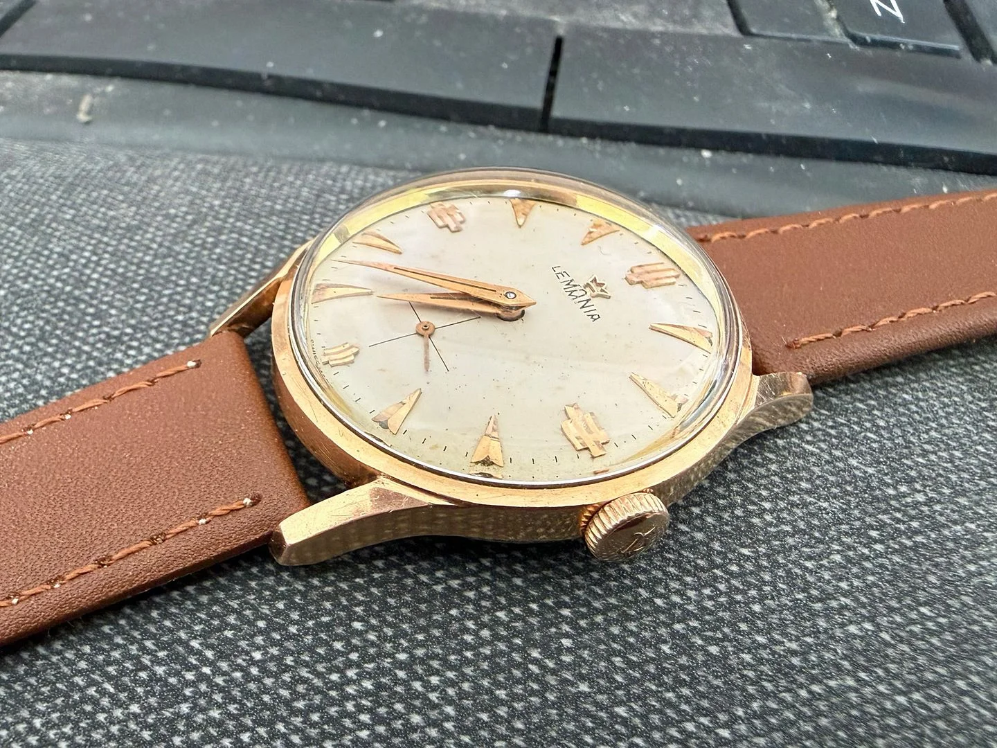

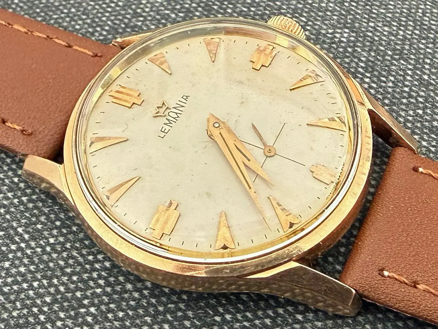

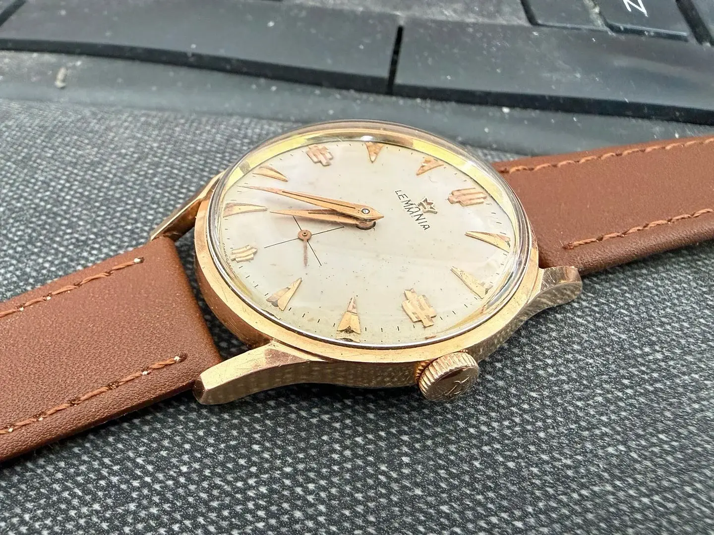

For anyone wondering, I still have this watch and I wear it on a few occasions. I've made my peace with my mistake and I'm keeping an eye out for a replacement calibre 3015 dial. I love these indices, but I have since acquired another watch that better addresses this passion: an all original calibre 3000 gold-capped 918-3 KO.

I wouldn't worry Pascal..ive got a 1956 Seamaster 503 with a 505 base plate..and a newly refurbed Accutron Astronaut with a case with no year stamp, a basic 214 movement that doesn't hack..but yet has the GMT 24hr hand and radium indices with tritium lume on the hands...it couldn't be anymore Frankenwatch if it tried
