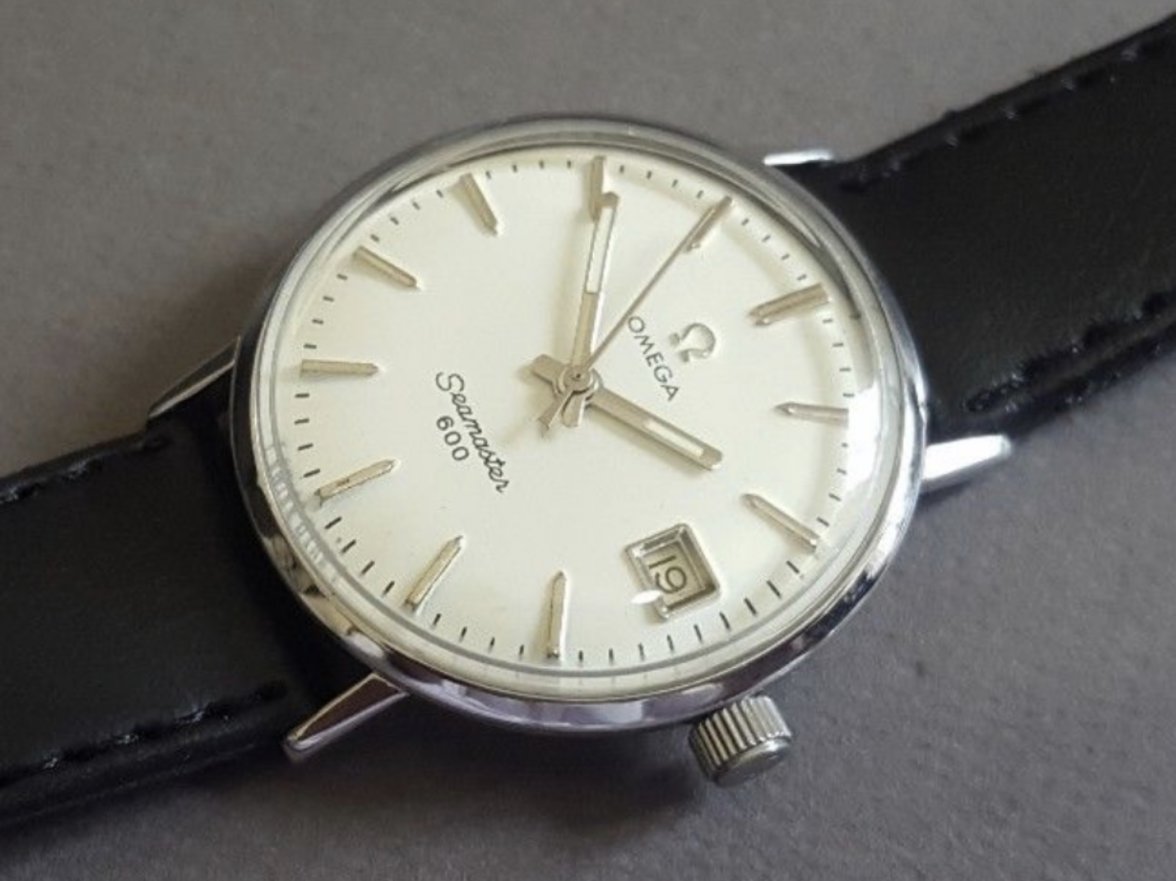

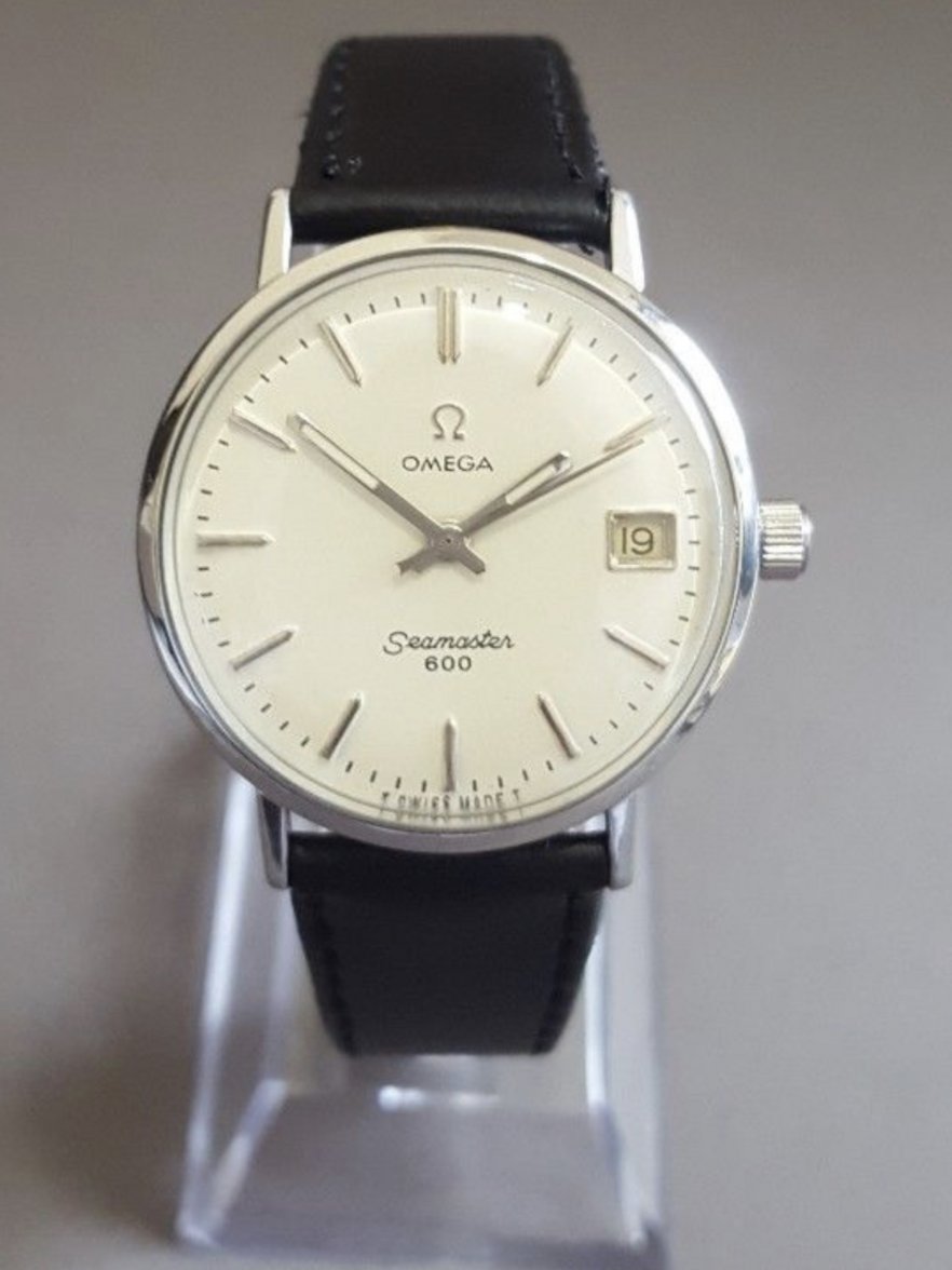

So I bought a Seamaster off eBay (one of the few in my price range). The seller has listed a few issues as listed in the description below, I realise the Watch is running slow but it will be fine for my purposes as it won’t be an everyday Watch. Just wondering if I’m missing anything glaringly wrong with the Watch, as the dial looks a bit pristine for the price, I’m assuming it’s an okish redial. Any advice greatly appreciated!
Seller description:
“Watch is in running condition but warch is loosing time.watch may loose 5 to 8 mints in 24 hours .
therefore selling at low price.. no return.. bargain
please note: winding 1 piece stem and crown fitted. i am unable to show the inside pictures of the watch as these rare model watches are not easy to open and i dont wanted to damage the watch by opening it these model watches open from the top section by removing the crystal”

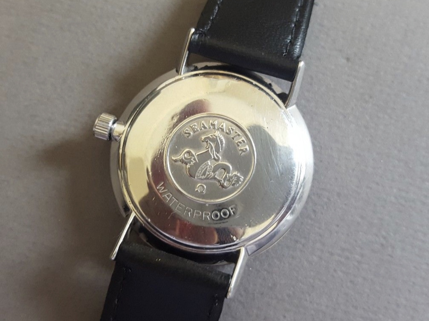

Crown is wrong. I don't know if is just the photo, but from the back the 5 o'clock lug looks bent. I would also say it is a redial.
I would be more concerned with what I cant see. Namely the movement, especially if it is running at -5minutes a day, and it isn't going to be much fun if you ever want to service the watch with a once peice crown and a monocoque case.
I suppose all of the above is moot, depending on how much of a "bargain" it was?

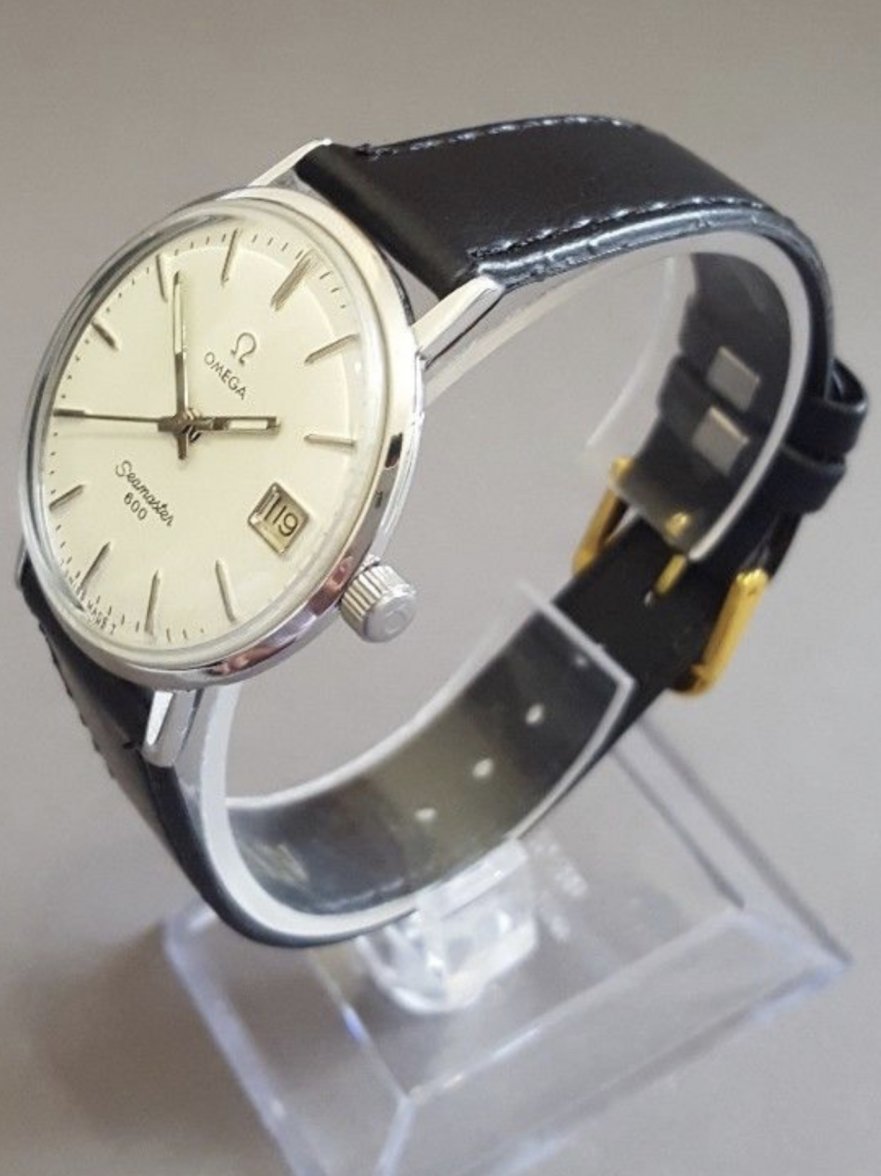

Yup, it has been redialed, the case is "soft" and the hands are wrong.
As above, the crown has been changed.
If you like it, congrats 👍

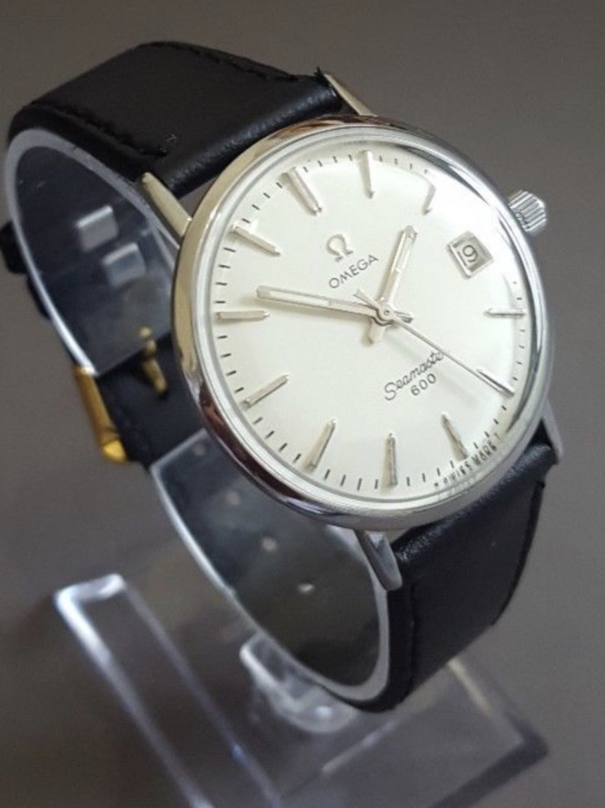

Definitely a redial and not a good one. It's a Seamaster and/or a DeVille, not a 600.
Case is poor, and clearly needs a service if it's losing time like that. Was it eBay 'buy it now'? I'd return it. Cheap is often not good value.

Regardless of the price it wasn't a "catch", way too much wrong with it.

Oh dear, crap should have realised it was a DeVille case! Although if my budget had stretched to a Seamaster DeVille originally I would have picked that. Think I’ll take your advice & try to cancel the purchase, cud b a bit of a frankenwatch. Guess I’m not an expert after looking at the forum for a few hours Thanks a million for the input!

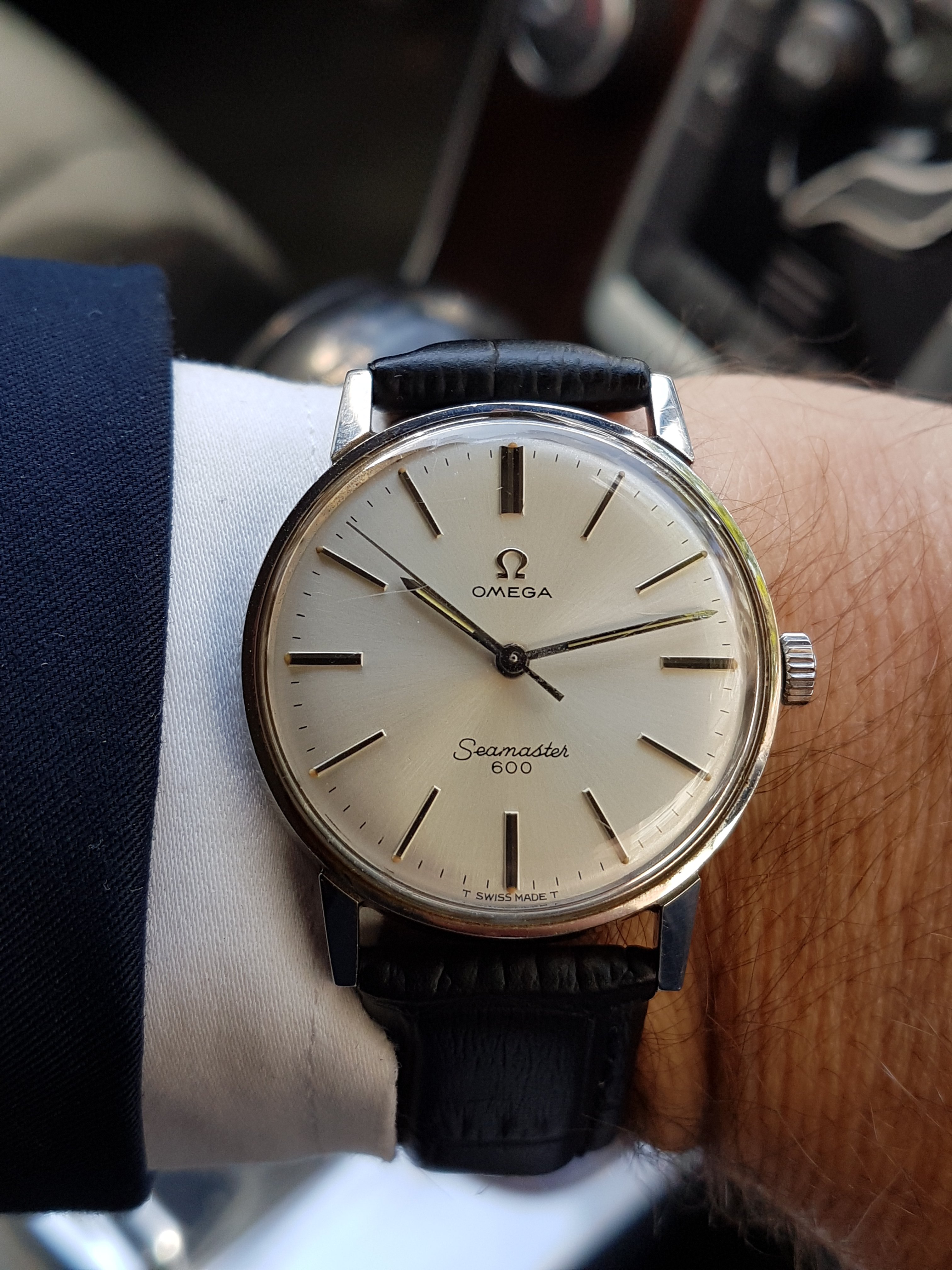

Show off. 😜 (Nice watch, BTW)
