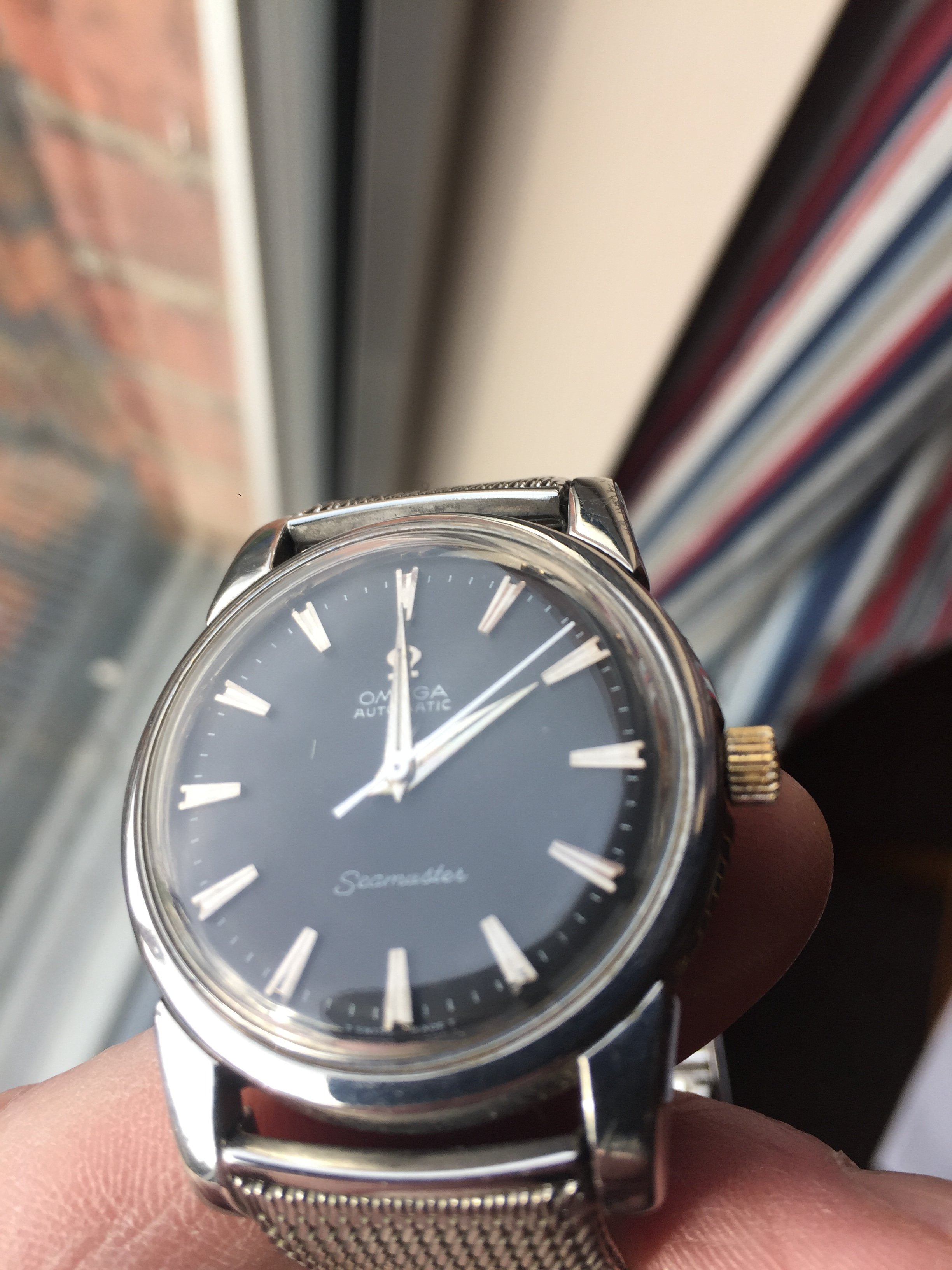

First let me say how great it was to find this forum. It all seems friendly and very knowledgeable and I’ve learnt a great deal already. I’m new here and of course I wish I’d joined before I made my first Omega purchase. I’ve long admired the Seamaster and decided to take the plunge as a birthday present a few weeks ago.
So I bought the pictured watch on eBay after losing out on a couple of auctions for Cosmic 2000s and I suppose I was a bit impulsive.
I would be grateful if anyone could take the time to do a bit of an appraisal of the piece.
As you will quickly, no doubt see the hands differ from each other (the minute hand is the only thing that fluoresces). I also doubt that the crown is original and yes that’s an ugly scratch on the dial between the 9 and 10. Also the glass feels cheap and ‘plasticky’ and there is a bit of a see saw movement to it.
I don’t have the means to open the back so can’t check for a serial number or movement caliber. Any guesses would be welcome. It does keep great time.
I can say I really, really like my first Omega!! One thing that swung it for me was the strap which is wonderful.
Finally, how fixable are any of these issues or any others you find? Also, I am UK based in Northamptonshire and wonder if anyone can recommend a good watchmaker who could carry out sympathetic restoration.
Thanks in advance for any advice and thanks for having me on board.

From a collector's perspective it's a turkey. But if it appeals to you, enjoy it. As you mentioned, the hands are wrong, but the biggest issue is that the dial is repainted and they neglected to replace the lume dots. The clasp looks legit, but I'm not sure about the bracelet itself. Someone else will know better.

First, congrats--that's a great feeling.
Aside from the issues already raised, I'd also note the case has been (imo) really, really hurt by its time with a polishing wheel. Regardless of if this one's a keeper for you or not, I'd urge you to try to get a sharp-cased 1960s Seamaster when you can; they're phenomenal.
Regarding this one's reference: It looks like the body of an earlier, beefy-lugs Seamaster, but the caseback is (I think) wrong somehow. When you get it opened, it'll be fascinating to see.
Regardless: if you like it, none of the rest of this stuff matters a whit, and enjoy.

It has the wrong hands and crown. The dial has been poorly repainted and the lume plots are missing.
You could end up sinking a lot into making the watch right again. My advice would be to keep an eye out on the Private Watch Sales section here and you will see plenty of watches you like in varying price ranges.
As others have said, though, if you like it that is all that really matters.

Hi James,
Yours is, in my view, a pretty watch with a nice shaped case, indices and hands.
It’ll be helpful to you if you can answer the questions posed by @JwRosenthal and, in addition, tell us where you bought it and what the seller told you about the watch when he sold it.
We can then advise you whether or not you can return it or if you’re stuck with it.
If you bring your watch to a forum of knowledgeable collectors you’re almost inevitably going to get detailed answers.
If you’re landed with the watch and can’t return it then you may have to make the best of it and, if that’s the case, it’s not all bad:
First off, you like it- or you wouldn’t have bought it.
Second, 99% of those who see you wearing it will admire it as a nice looking vintage watch made by a prestigious watchmaker.
Third, and knowing it’s not necessarily destined to be kept in the safe and worn only for best, it can be worn as your daily 'beater' (although remember that it won’t be waterproof).
And, if you end up keeping it, get it serviced and get that crown changed 😀:facepalm2:😀.

Thanks for your reply Dan. Do you know what I would google if I wanted to see a good one? I read something about Shacmans & son (?) the strap maker on this forum which suggested they were a quality maker.

Well I’m starting to love it less! I doubt I’d be able to return it. I paid £500. Thank you.

Thanks for your reply. Yes I think a 60s Seamaster is exactly what I want. This purchase is the start of my journey and I’m certainly feeling the learning curve! What do you think of the strap?

Sorry we are tainting your love- it’s an unfortunate effect of asking the question you really don’t want the answer to- but you asked because you knew something wasn’t right.
If the seller sold it as “all original”, then even a month out you may have recourse. If they just sold it as a “vintage Omega”, then it is that- so no deception and buyer beware.
My first vintage Omega was a redial- I didn’t know it until I joined here. I have since sold it at a loss and haven’t made that mistake again.

yes, all this good advice above, OR........................
knowing it’s a redial will eat away at your soul, destroying the very fabric of your existence.
Just depends on what kind of person you are 😉

Hi. It’s a 34mm.

Giving as a fact that you have it and enjoy it, may I suggest that before buying next watch , make sure that you or somebody here has the knowledge to buy a nice example - original, not redialled, correct crown and hands etc

Thanks Spruce. As I said I bought it on eBay a month or so ago the seller doubted the crown was original and mentioned he thought it had been polished. He said to his knowledge it was original. I don’t think he was particularly dishonest I think I was a bit too impulsive! I will indeed get the crown replaced.
