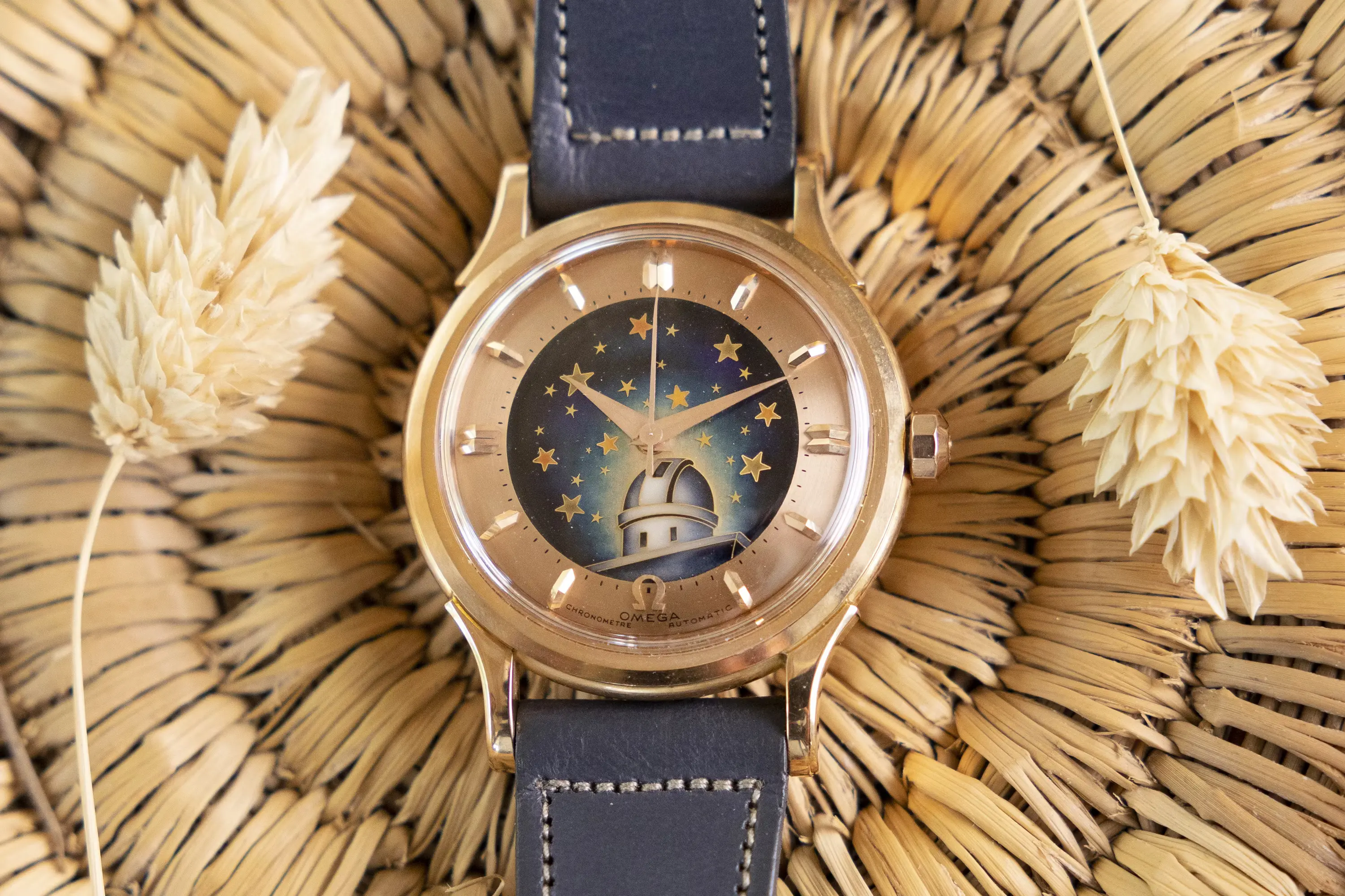

I bought a Constellation (with a cool dial)

Thank you. By the way, does the video I posted work? I tried to show the watch is as much clarity as I can there.

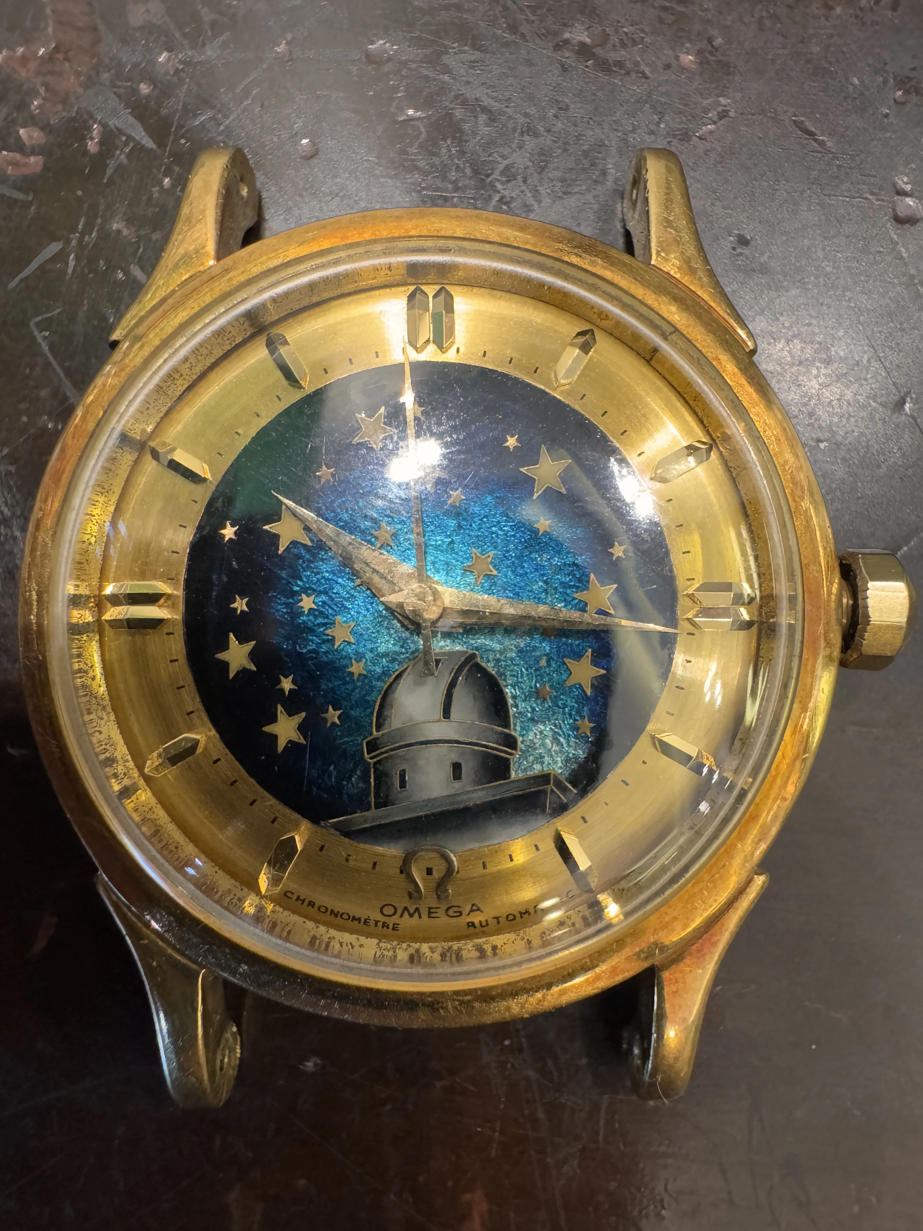

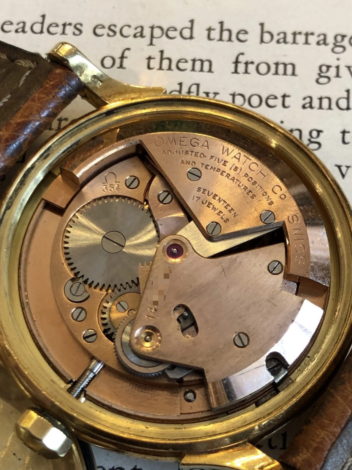

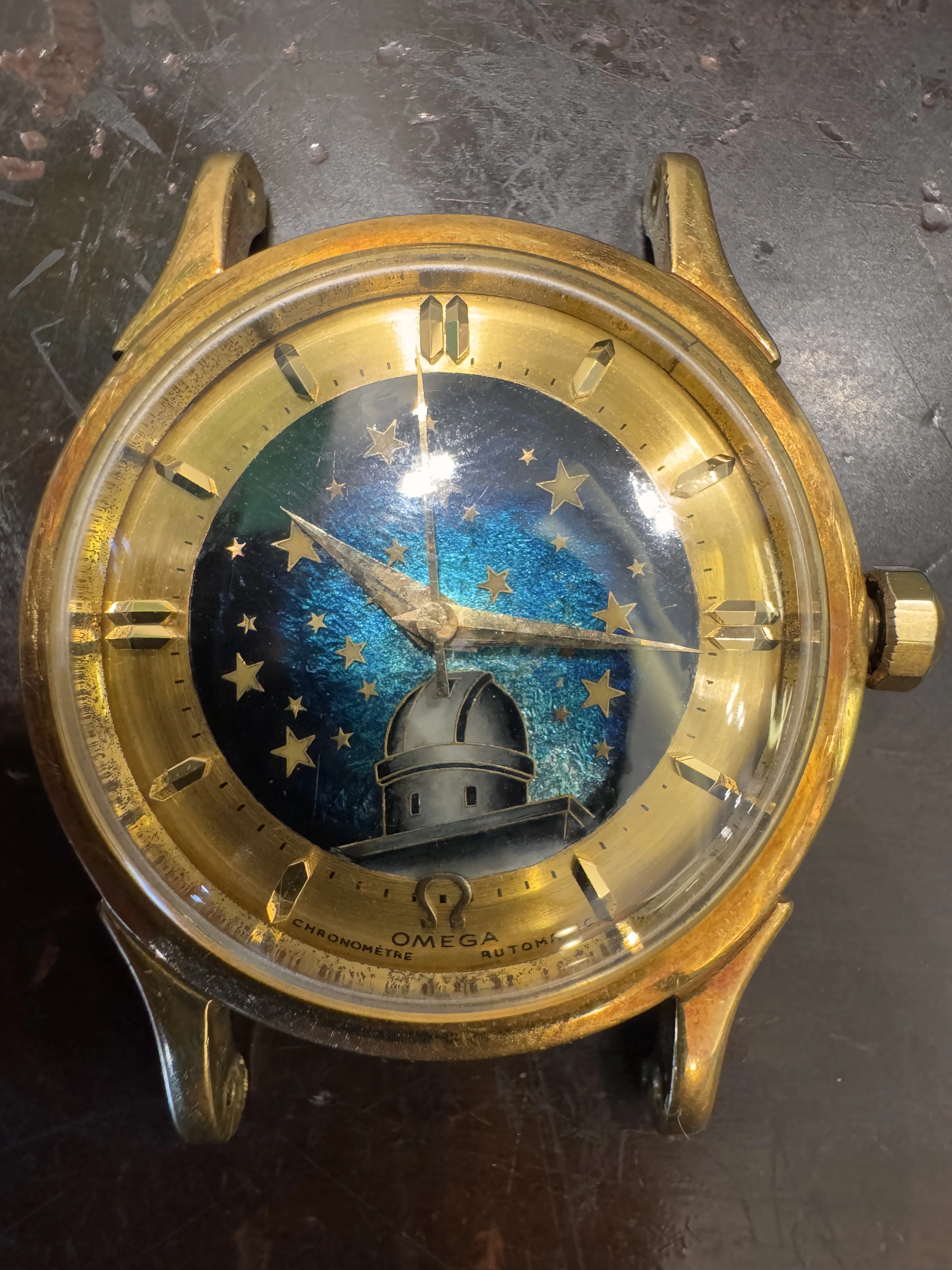

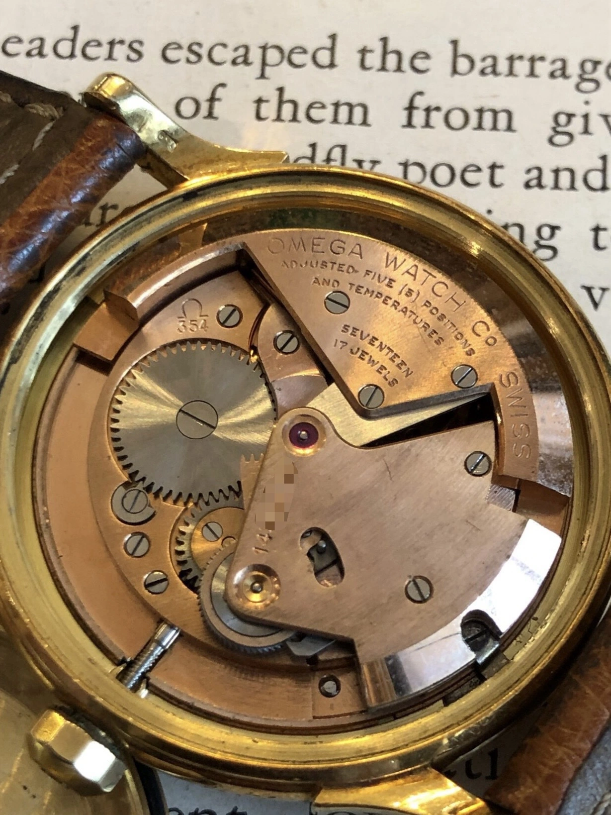

Here are some extra pictures. The link you sent is for a different movement which I believe has different feet. This watch is a cal 354 with the correct case back and serial numbers (in terms of range).
Re dial specifics, I’ve given some thought to this too. The photos from Omegamania and Phillips auctions are static. No videos of this the watch exist (other than a few seconds in the 2nd John Goldberger Hondinkee talking watches video). Secondly, it’s hard to say how or how differently these dials could have aged over the past 70 years, because there are so few around.
Re provenance, I believe im the third owner. The seller purchased it in 2006 from the original owner, who had it since the 50s.

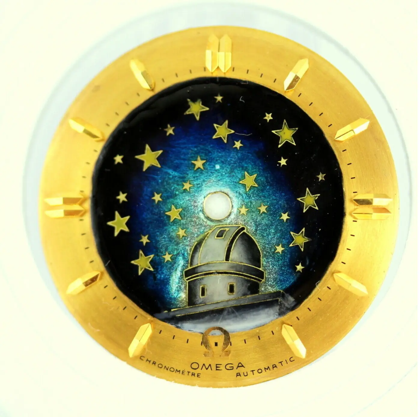

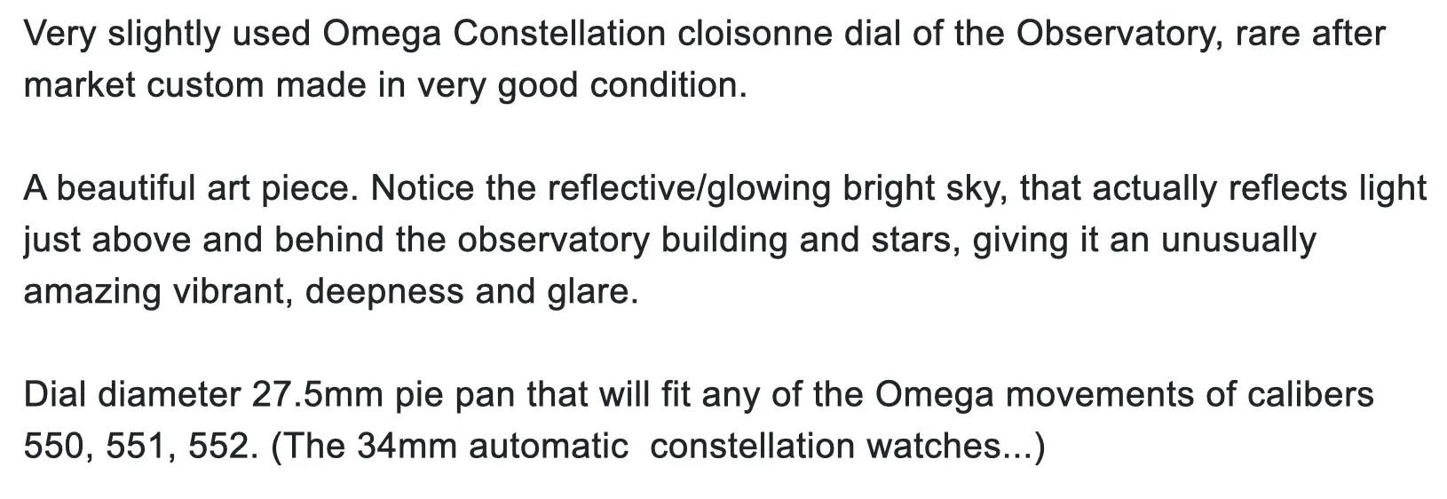

I realise the aftermarket dials were intended for later watches and yours does have some differences ( e.g. the rounded Omega symbol as opposed to a squared cross-section)
However, it wouldn't be beyond the wit of a half-reasonable craftsman to remove the dial feet and swap the Omega symbol to turn a €3,000 watch into a €100,000 watch.

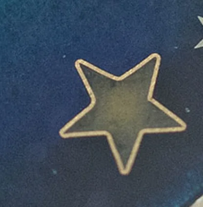

Unless the dial has been touched up, these enamel dials were of the very highest quality and didn't have wavy edges to the enamel central plane - however the aftermarket dials do.
The provenance is something but we do see stories of past owners quite frequently that don't quite pan out - I do hope that yours is the genuine article but until I see another just like it sell at auction for the big-bucks these watches command I would have my suspicions that it has an aftermarket dial.
Once upon a time you could order an EOA and that would clarify the matter - nowadays not so much.

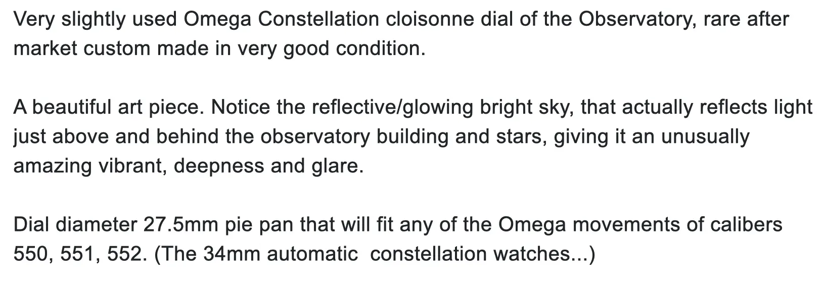

For the record - image of the aftermarket dial and description

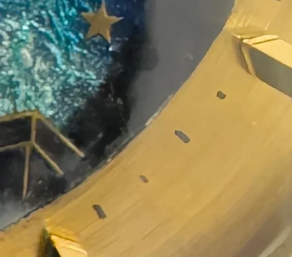

Took another photo just now. Hopefully this clears up the “wavy edge” issue.

Apologies. I forgot to add this photo to the earlier post. I blocked out part of the serial number for security reasons.

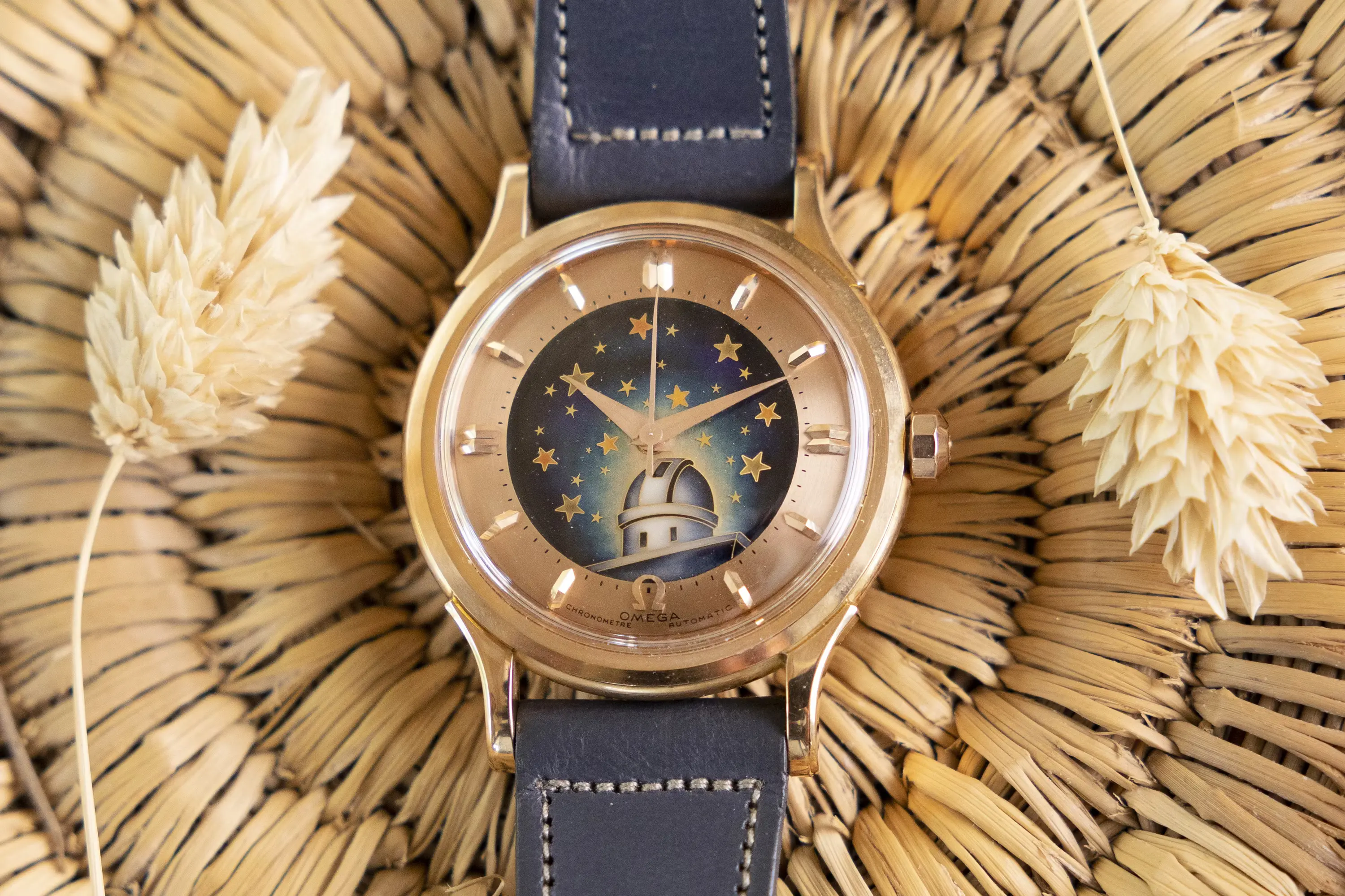

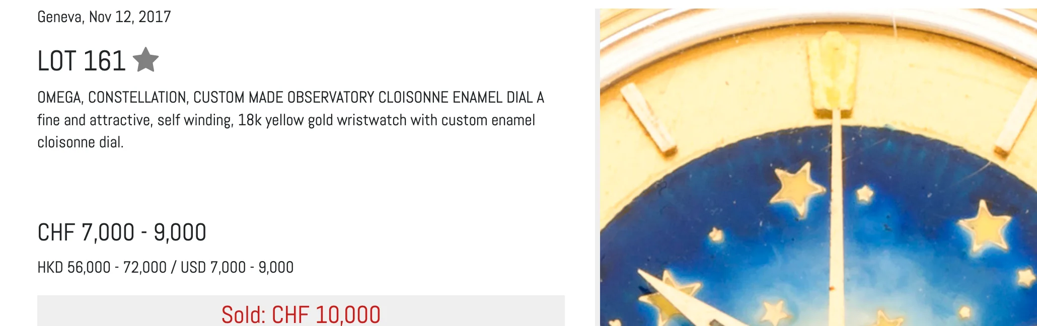

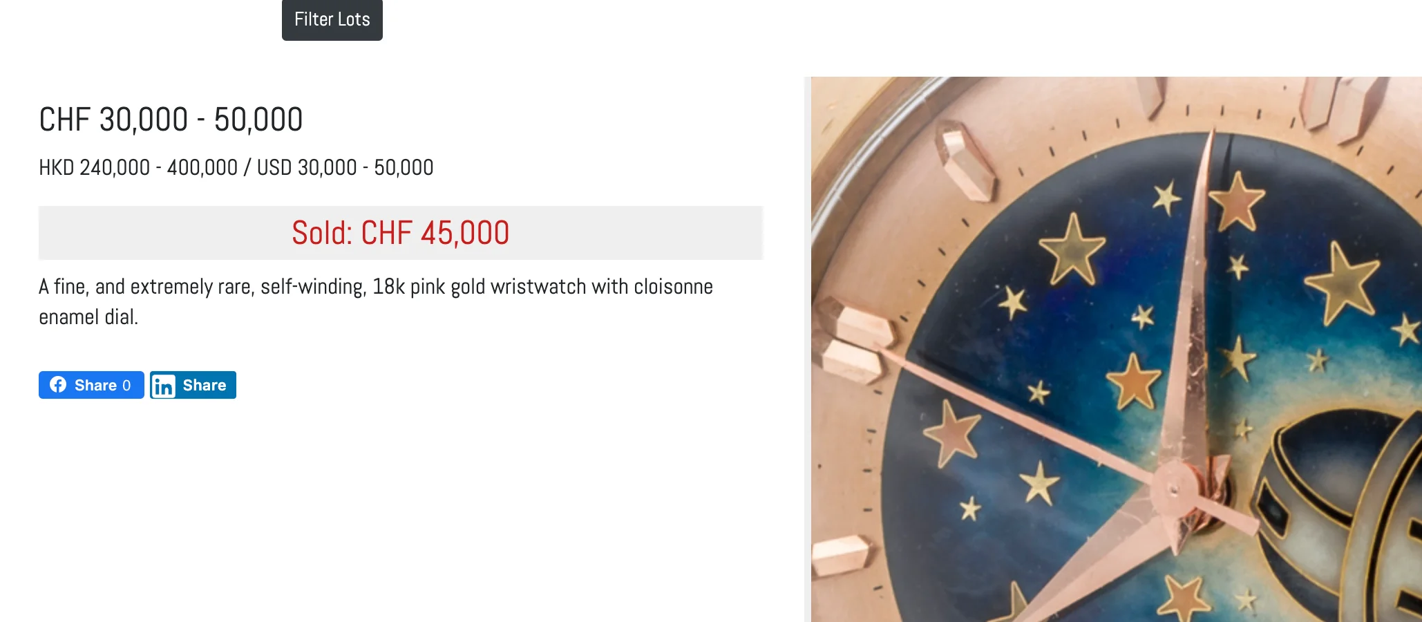

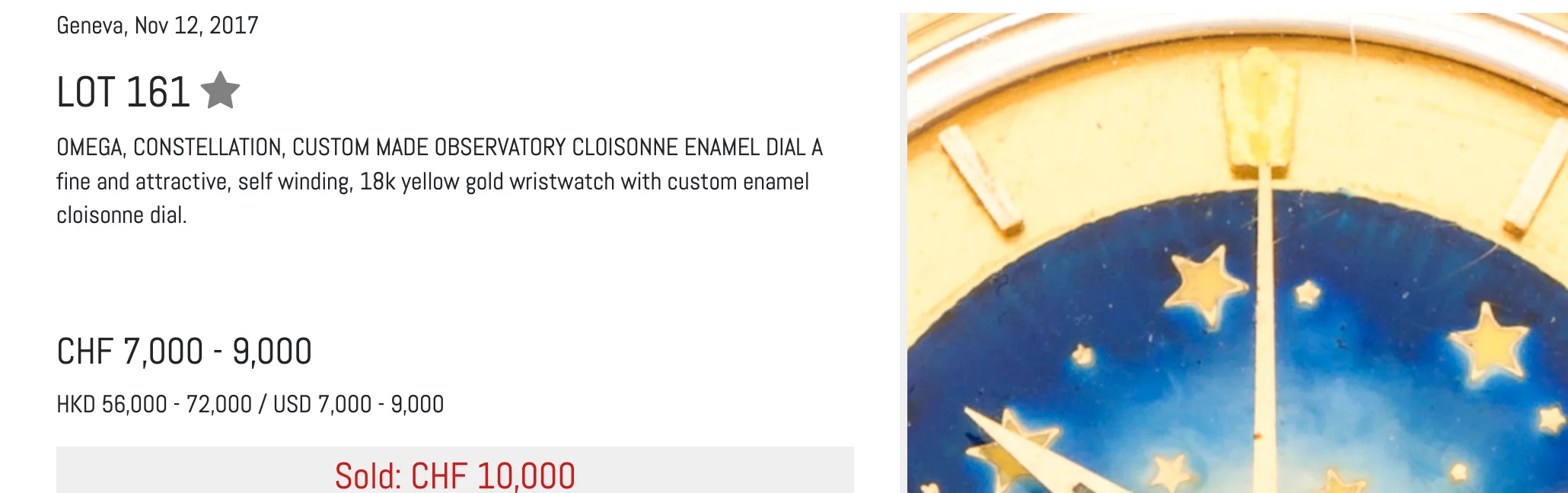

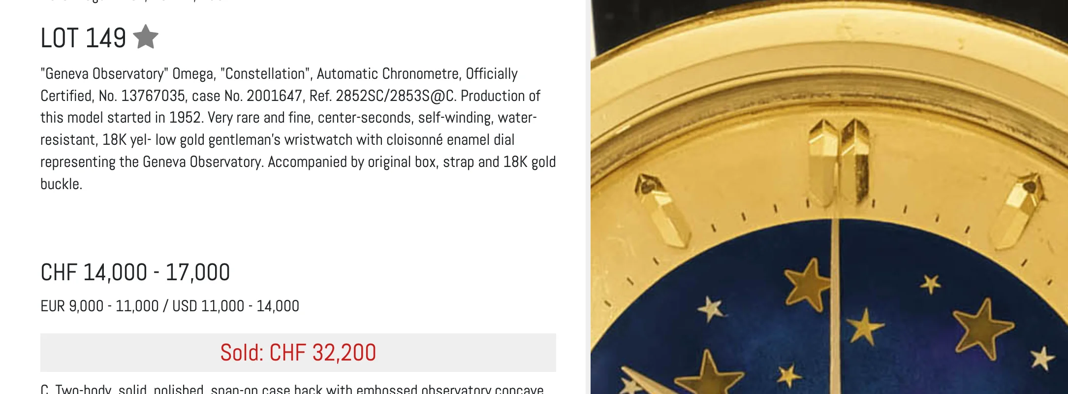

An example from a 2017 Phillips auction: https://www.phillips.com/detail/omega/CH080117/200
each of these has a square-section Omega symbol without the happy feet -which does appear on a 1954 Seamaster enamel dial. (the rest in AJTT appear to be the rounded type with happy feet)
However, the dials are still much 'flatter' than the OPs.

Playing with the dial in different environments (natural, downlight) shows the depth the dial that is hard to capture in a single photo. The video I took is able to better capture this detail. Unfortunately I haven’t seen another similar video to compare with.

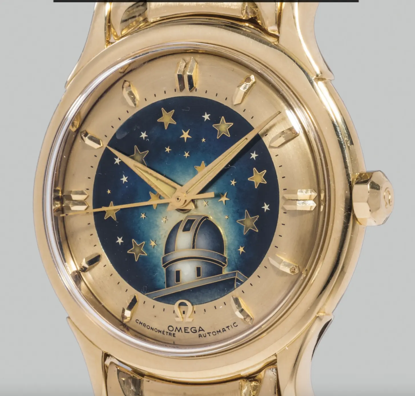

The Phillips watch is interesting as both the hands and markers are lumed (all the others aren’t). The minute hand is also unusually long - so long that it extends way past the minute track, which is a bit odd? The auction doesn’t say whether the hands are original or replacements.
562
2,719

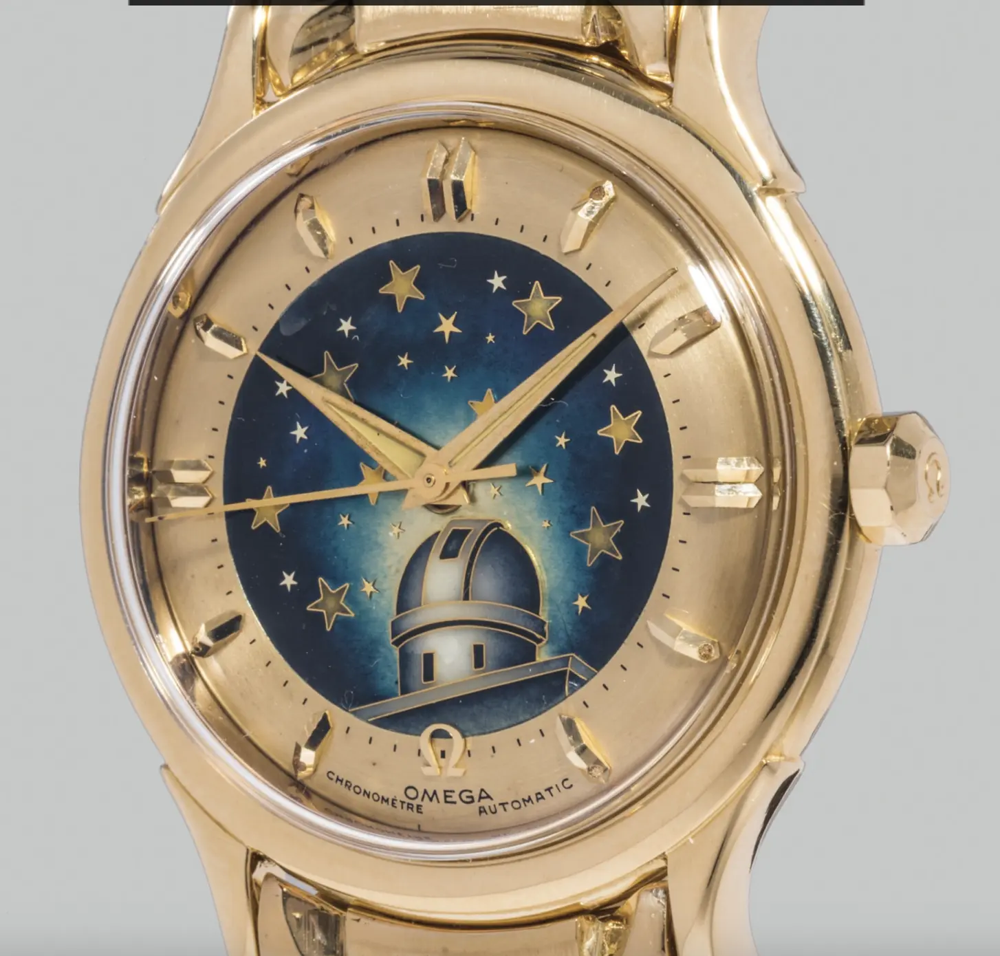

When I look at the example sold by phillips and the one owned by Goldberg, I noticed the letter 'M' in CHRONOMETRE and AUTOMATIC are not perfectly symmetrical, the left half seems to be wider than the right half. I don't know it is due to picture distortion or not.

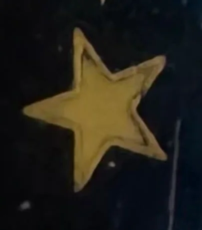

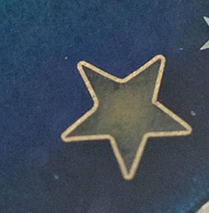

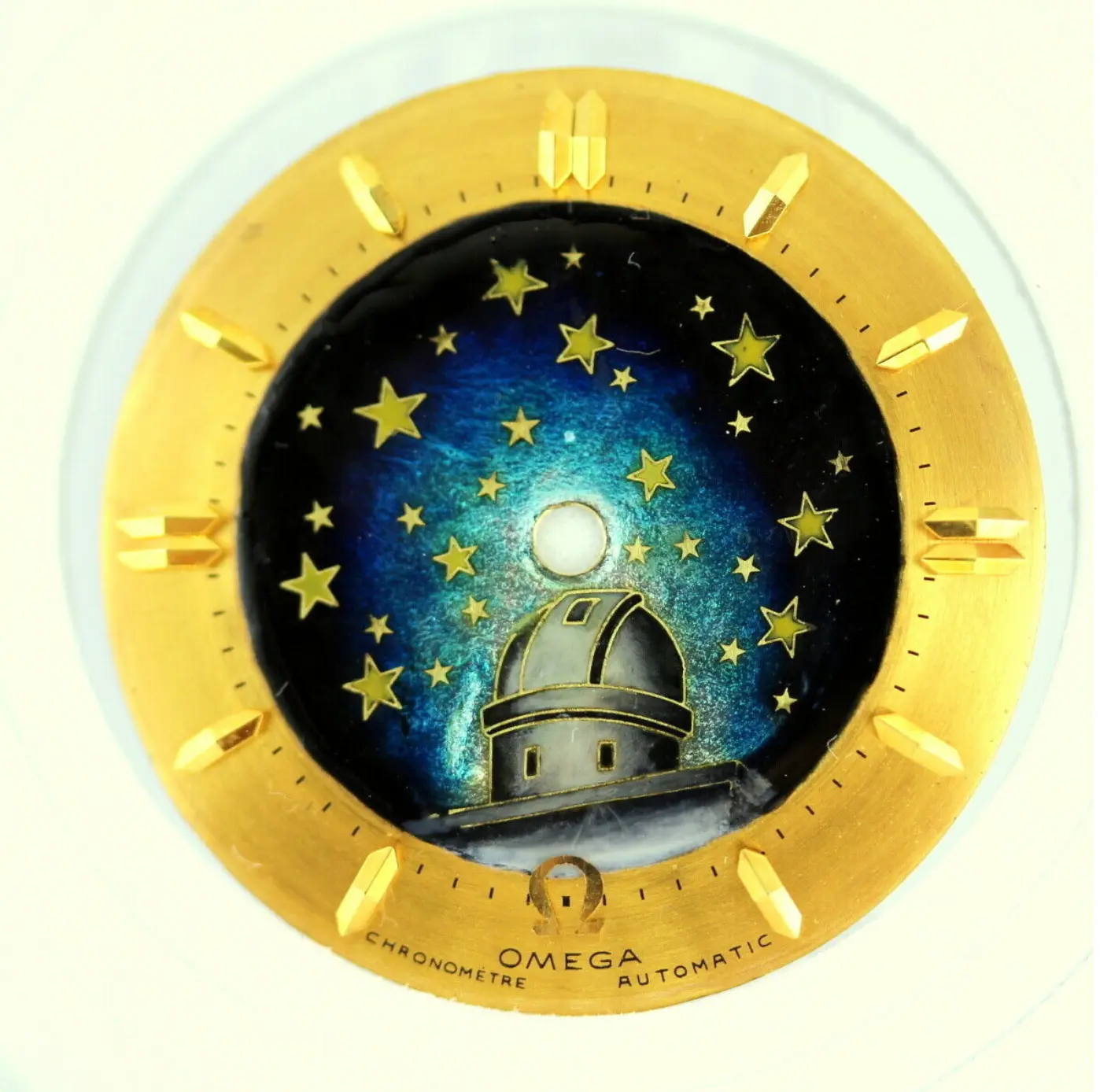

For me the larger enamel filled stars do not look good on the OP watch compared to the others posted - they look crude and the enamel fill appears more monotone than the three dials from the Omega museum, Phillips and Hodinkee which all look nicely formed on the tips and coloured carefully. The OP dials stars look like they came from the same hand as the aftermarket dial above.
OP Dial:
Aftermarket Dial:
Phillips dial:
Hodinkee dial:
Museum dial:
Ok the image quality isn't great on all of these but you can see the trend, not to mention those minute markers and the edge of the enamel...
