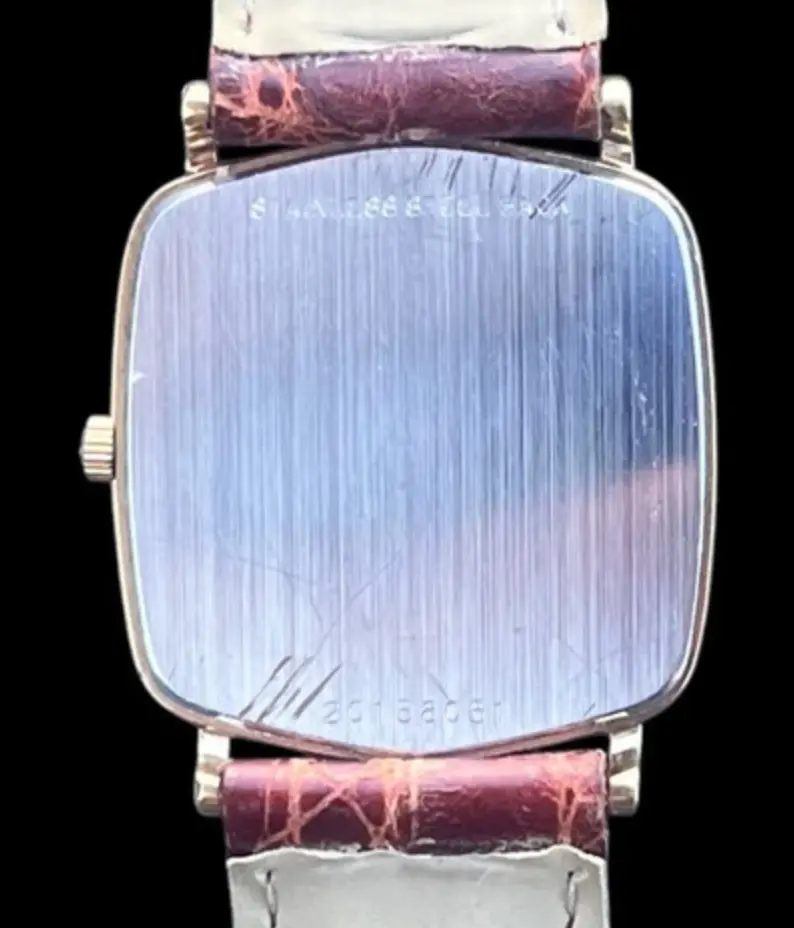

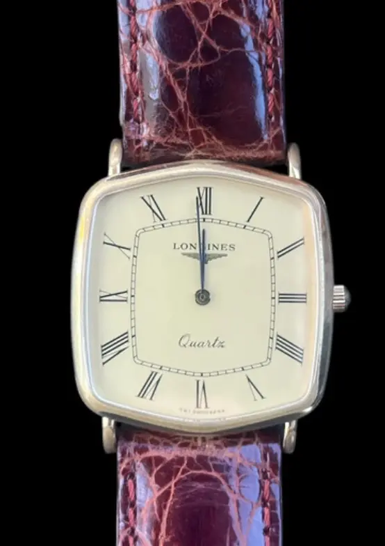

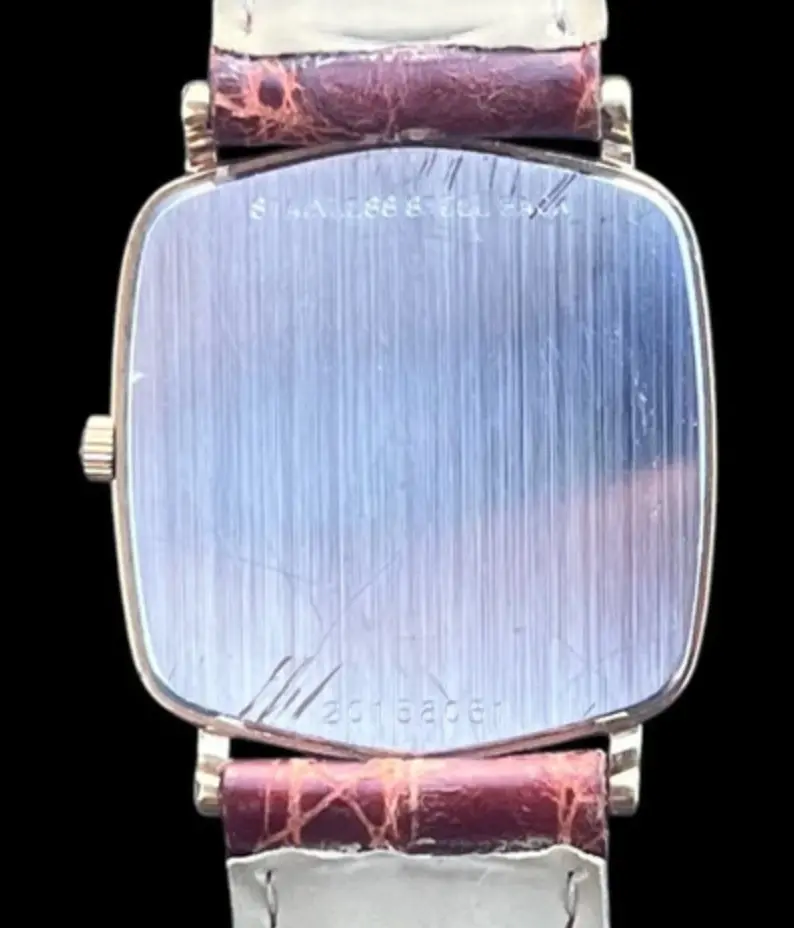

I want to buy my firdt watch and I am on low budget, I saw this watch and fell in love with it !
here are all the information I could get :
-under the hour VI it is written : 761swiss6244
and in the back : Stainless steel back. Below the number 2015206
Thanks for your time !

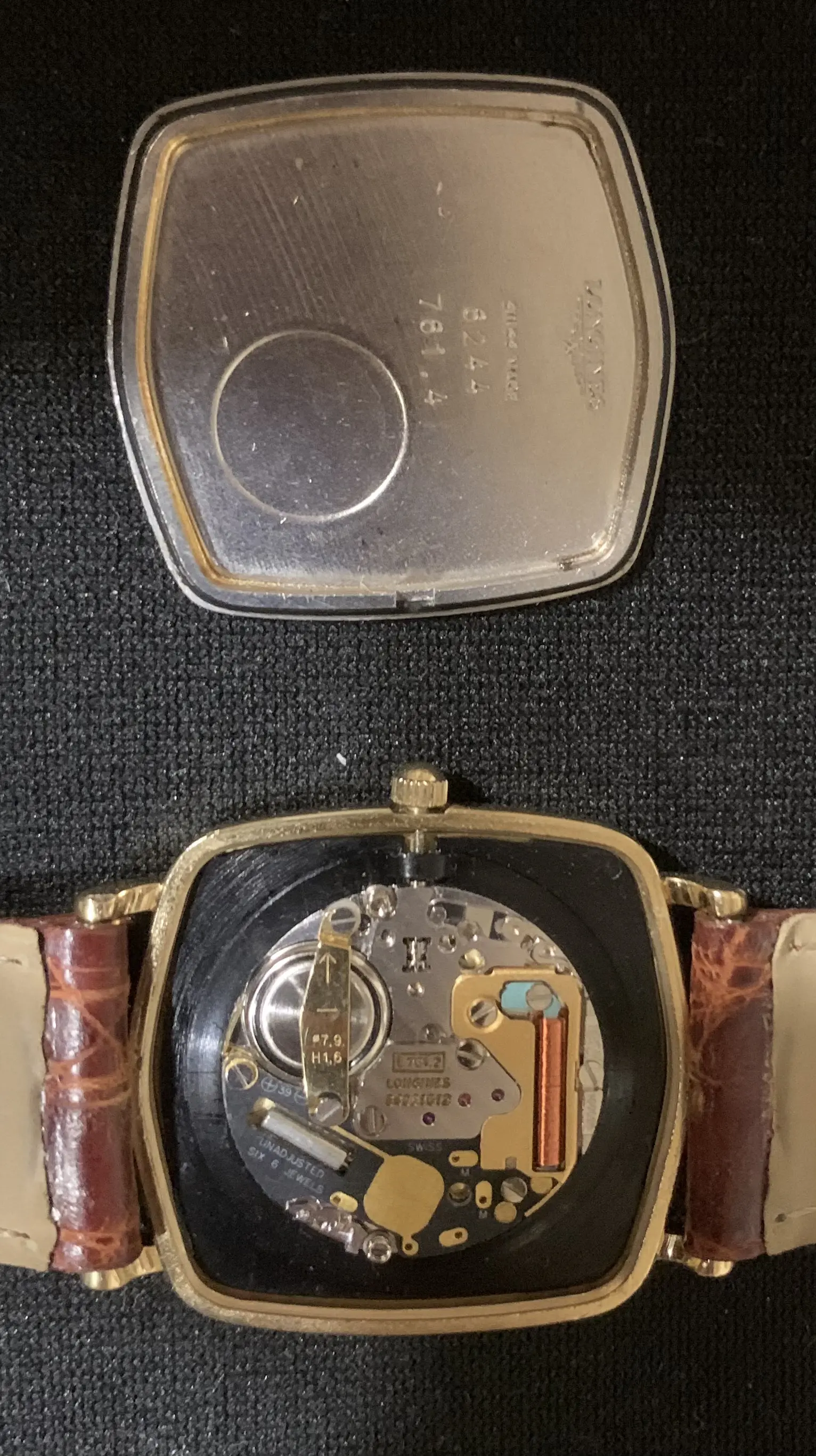

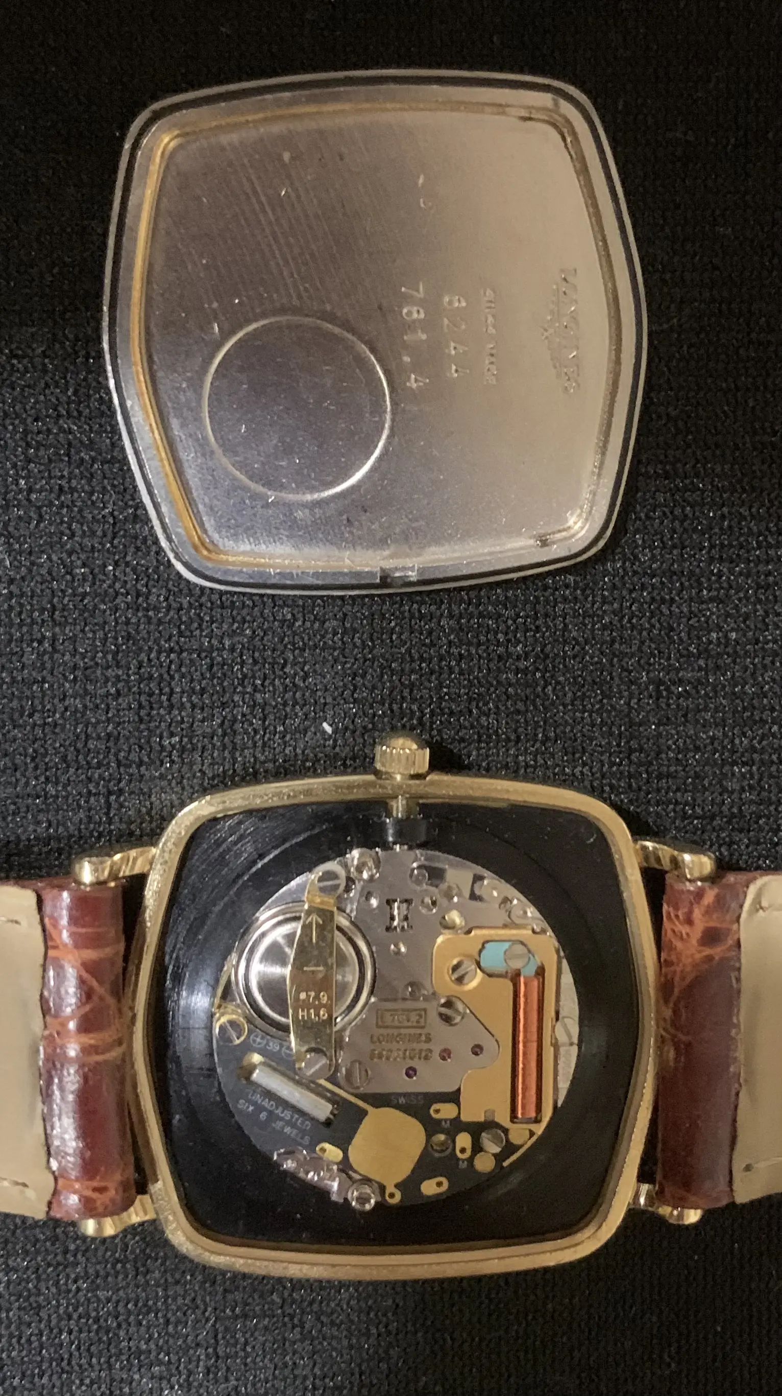

Hi everyone,
here is an update on my situation.
I just recieved my watch. It is really a longines.
On the part with the battery it is written: diameter = 7.9 and H= 1.6 ( I guess it is the height)
Otherwise, it is written:
L761.2
and 54967642.

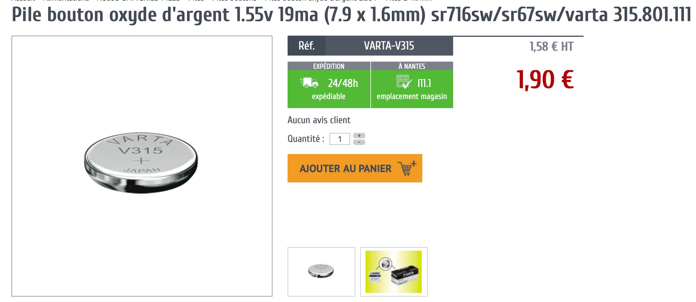

I guess the following battery would fit, what's your opinion ?
824
1,494
Yes, I think that battery will work. The correct batteries for the L761.2 calibre with a 1.6mm height are, according to the Longines Technical Manual: Renata 40, Varta 530, or UCAR 315. I think the battery shown is just a conflation of the last two.
By the way I don't have any tools do you have some recommandation ?
The only tool you need to install the battery is a small, flathead screwdriver. Loosen the screw that the arrow points to, and be sure to install the battery with the negative terminal "up" to match the "-" on the retaining clip.
