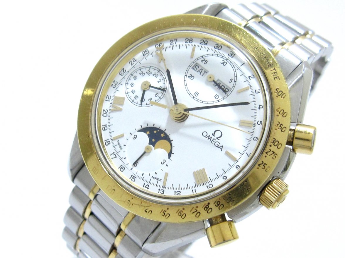

    Hey y'all I recently fell in love with a Omega Triple Date (1750034). However I have some questions about it.
    Pictures:
    1 Does anyone has experience with the movement (1150)?
    2 Is it true this watch was only sold in Italy? If so why?
    3 I know gold is softer than steel and all but the bezel looks really unsharp is this normal for a watch that is from 1995 or did this watch see a lot of wear and tear?
    4 Is there anything else I need to know regarding this watch and/or movement?
    5 Finally I cannot find a whole lot regarding price of this watch. I found 2 on Chrono but they are in far better condition how much does value go down with 'worse' condition? (Seller is asking 1.8k eur)

    2 - Not sure... sounds like something a seller might say to add mystique, but then it is not uncommon for Omega to have made watches for specific markets, or specific retailers. The seller is likely confusing this with the Italian Market Speedmaster professional.
    3 - Gold is softer than steel, as you say, but this looks to have been well worn, rather than been a watch for special occasions. The side shot shows quite a lot of scuffing on the crystal, which tells you about the way this watch has been worn
    4 - It's worth talking to an Omega trained/authorised watchmaker to understand the service implications and cost before you buy the watch. Depending on where you are in the world, the folks here should be able to recommend you a watchmaker or two.
    5 - Can't really help you on price as these aren't something that I've seen for sale all that much... it might be worth talking to the people selling the better ones, to see how close they'd come to the price this seller is asking.
    General rule of thumb is to try and buy the best available version of a model that you can afford.
    As a side note, looking at the inside of the lugs, this watch was on a bracelet - you can see the indentations that it left behind - and the buckle supplied with it now is not the type that would have been supplied with this watch if it were on a strap.

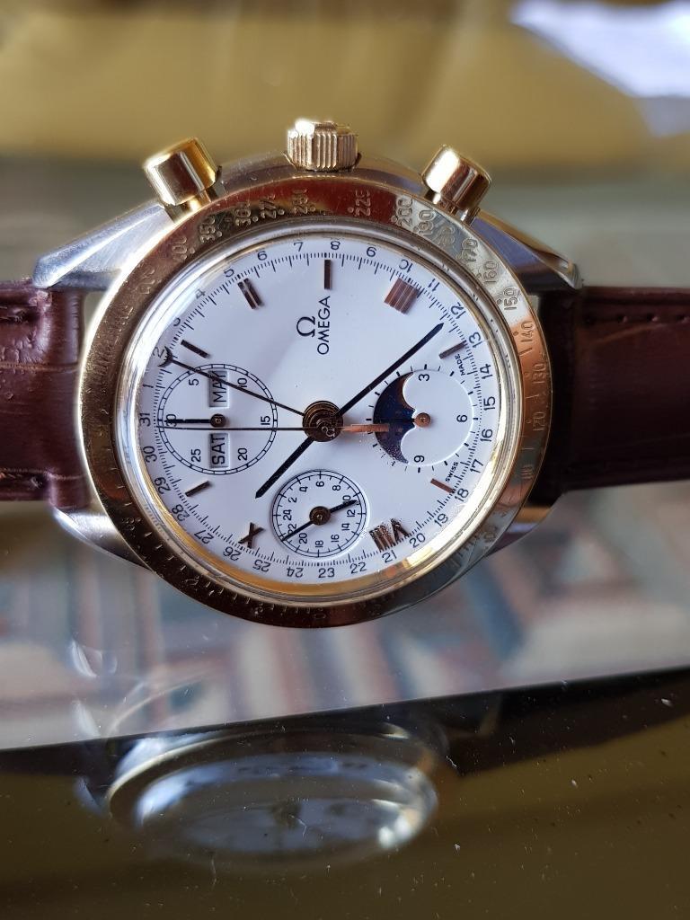

    And I think the full reference is DA 375.0034/PIC 3330.20 - so it should look like this:

    Thanks a lot for the replies! Good to know about the bracelet aswell. @tyrantlizardrex I believe there are two versions one with black in the numerals on the bezel and one without. But I'll try to redo my research with the refnr u gave me.

    I think they all started out with the black in the numerals - more worn examples tend to not have it, or partially have it.
    Like this (on the extreme end but illustrates the point):
    Stock images of the watch as new always have it. :thumbsup:

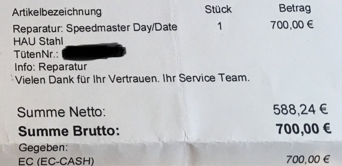

    Round about 2011 I started to get issues with the register at 6 o’clock incorrectly resetting; so it was packed off to Omega. The repair cost
    and it came back with the following bag of bits
    Unfortunately in 2013 the month indicator started to stick in the halfway position, so it went back to Omega under warranty and came back in what felt like a 100% new watch. I actually started to wonder if they had swapped the entire movement but numbers all match so I guess not.
