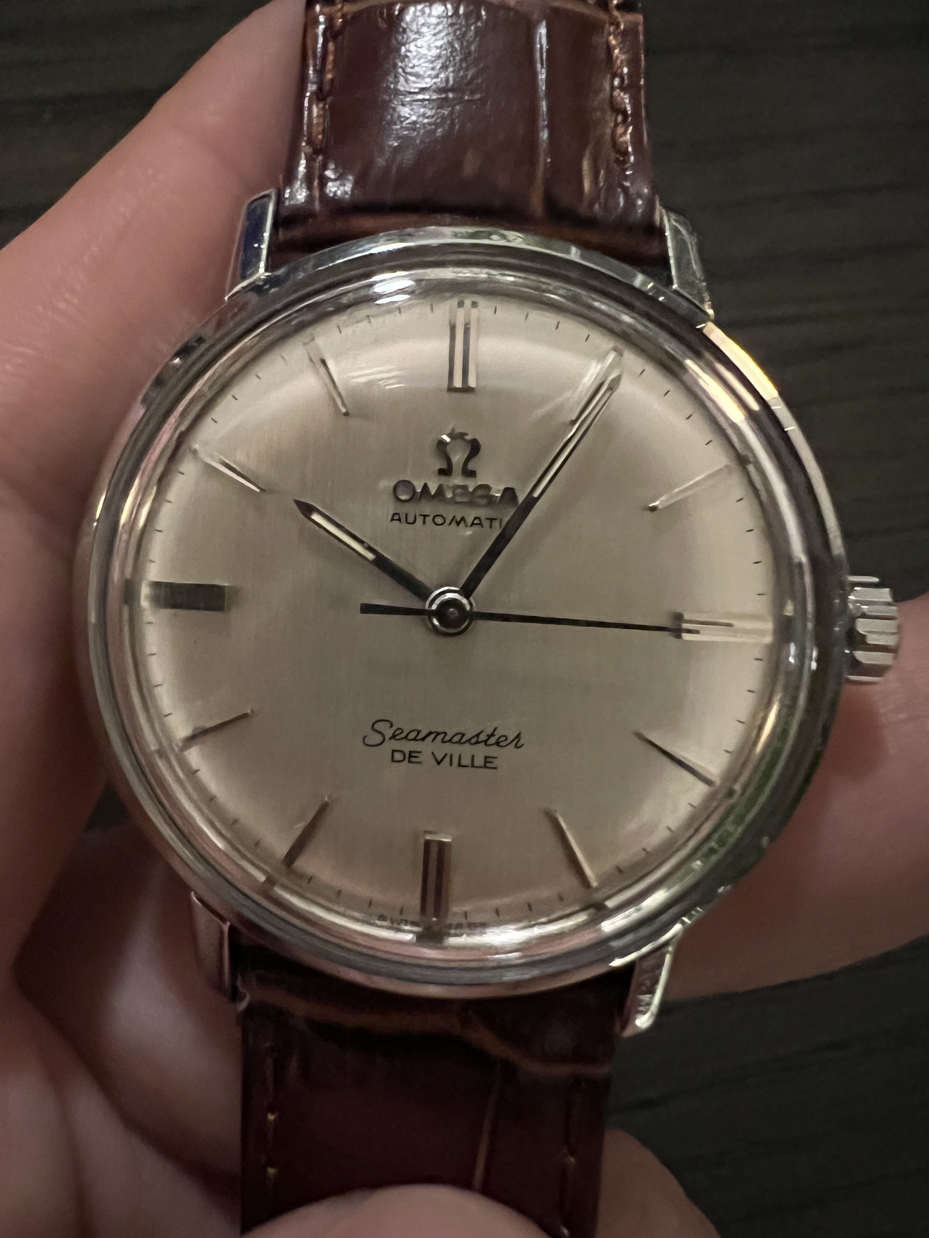

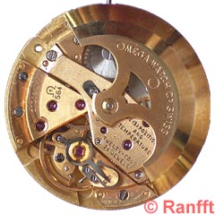

How would one go about carefully opening this?
32
32
If there is a tool to purchase, please let me know! If you have any tips or videos that may assist, I would greatly appreciate that.
Thank you!

No tool available to open the case back. This watch is a front loader. I suggest you don’t mess with it. Simple to get into if you know what you are doing. But could damage what is probably a nice watch, if you don’t.

If I was feeling adventurous with dedicated time and caution… how would I go about carefully and respectfully opening this up?

Invest in a bunch of tools like a crystal lift, case knife, pair of stout tweezers, find out what you need to do once the crystal is off. Be prepared to replace the crystal if you get it off. What are you planning to do IF you get the movement out of the case?

Take pretty pictures of the movement so I never have to open it again and can just admire the old movement on pictures and videos when I want to.

Ask your watchmaker to take pictures when you have it serviced. Opening a watch unnecessarily, especially these cases, isn't really recommended unless you absolutely have to. As I just bought a front-loader myself, my watchmaker warned me about this very thing.
I sure as hell won't do it.

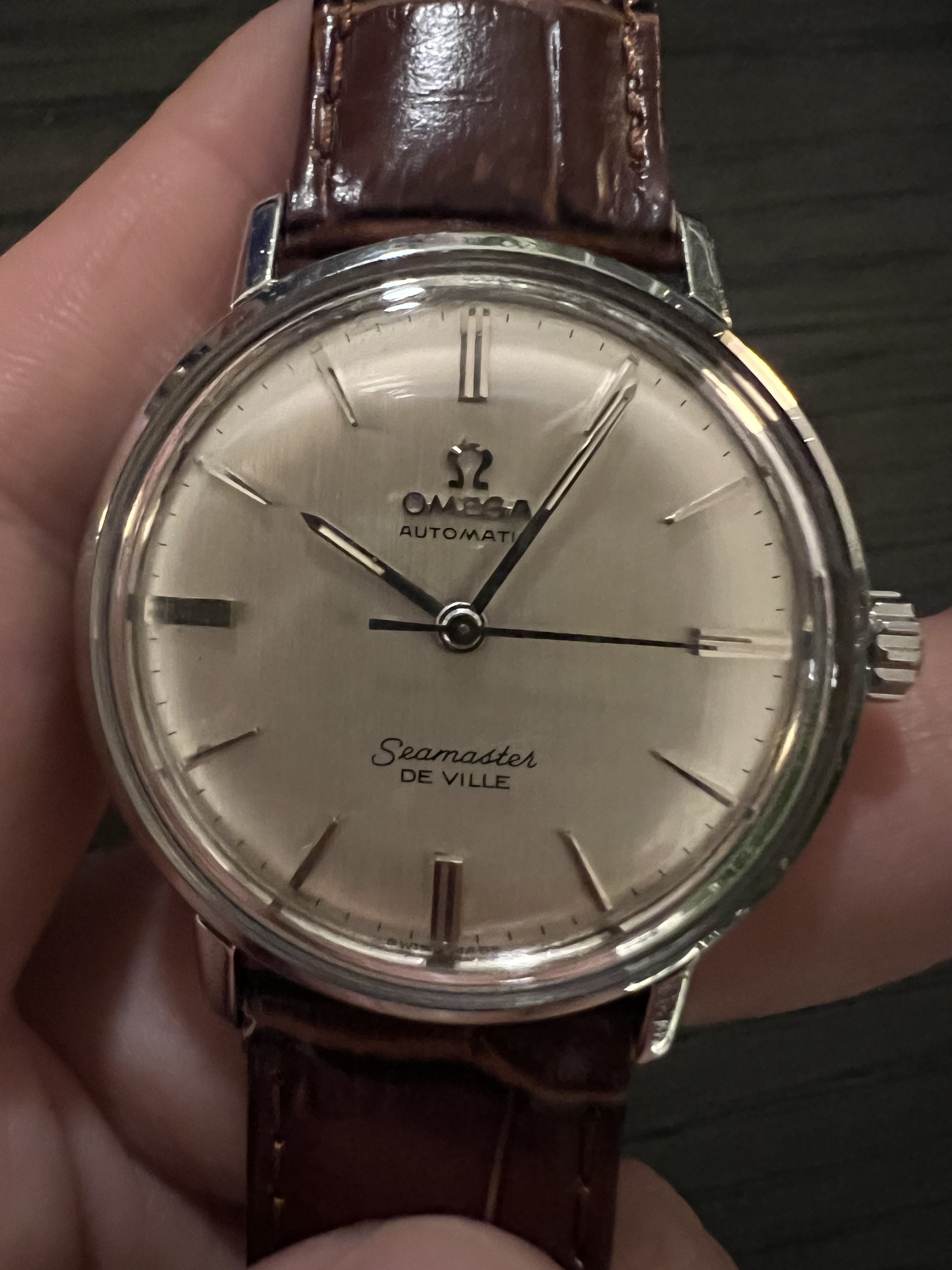

Watchmakers knife to remove the bezel.
Tool to remove the two piece crown.
Bezel press to replace the bezel.
Small screwdriver to twist the locking mechanism of the case that holds the dial in place.
Possibly a new bezel (unobtainable) and crystal if they’re damaged.

While you are setting up your shop, get yourself a case press so you can get the crystal and bezel back on. And while you are at it, get yourself a replacement crown and stud for the split stem, after you lose the original.
