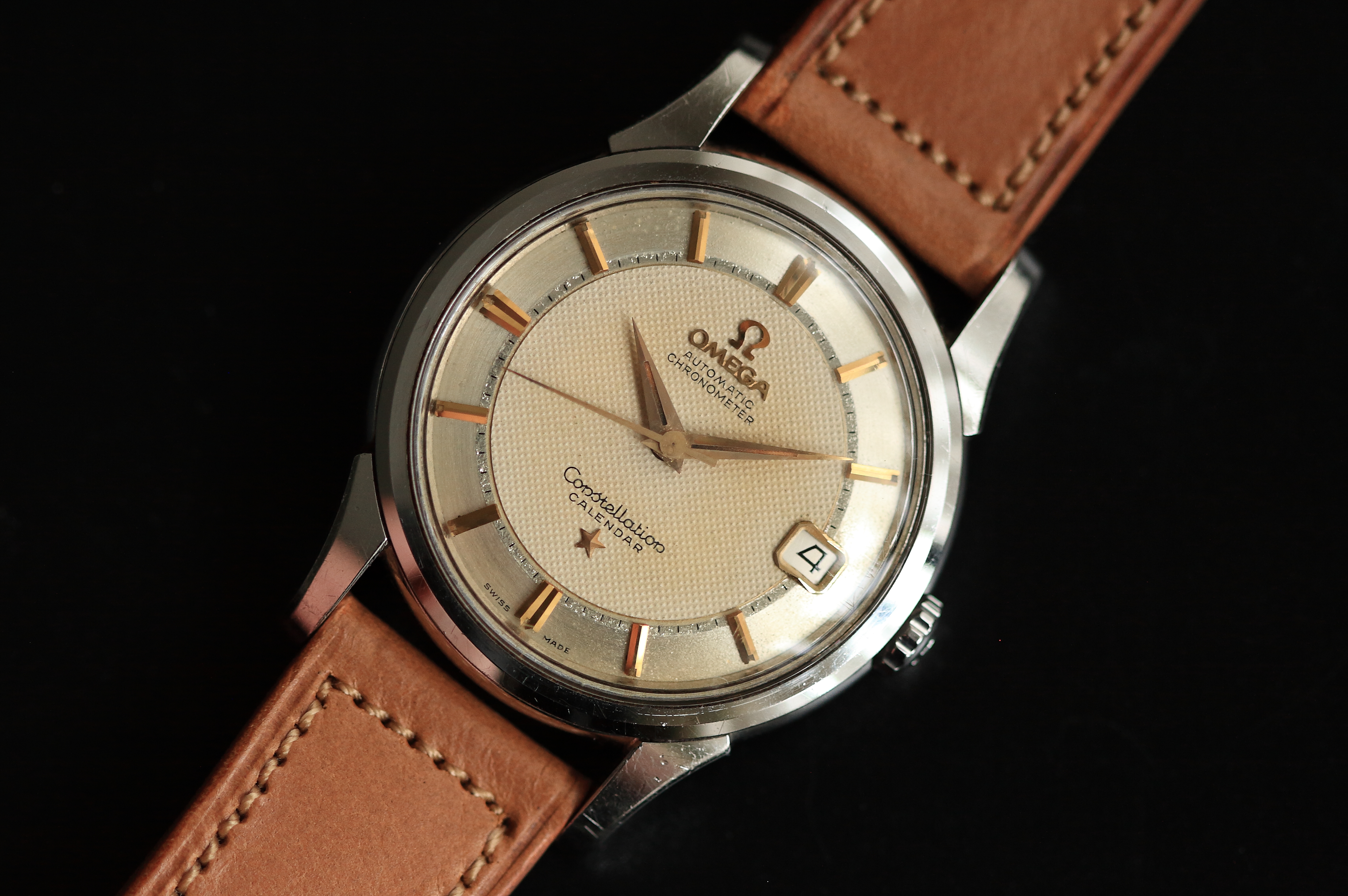

Hi Jeff,
The roadmap in this article really helped me, and especially the use of a piece of black foam-core board in order to manage reflections.
See: https://www.hodinkee.com/articles/h...s-of-your-watches-without-buying-a-new-camera
Example:
Best, Matth
