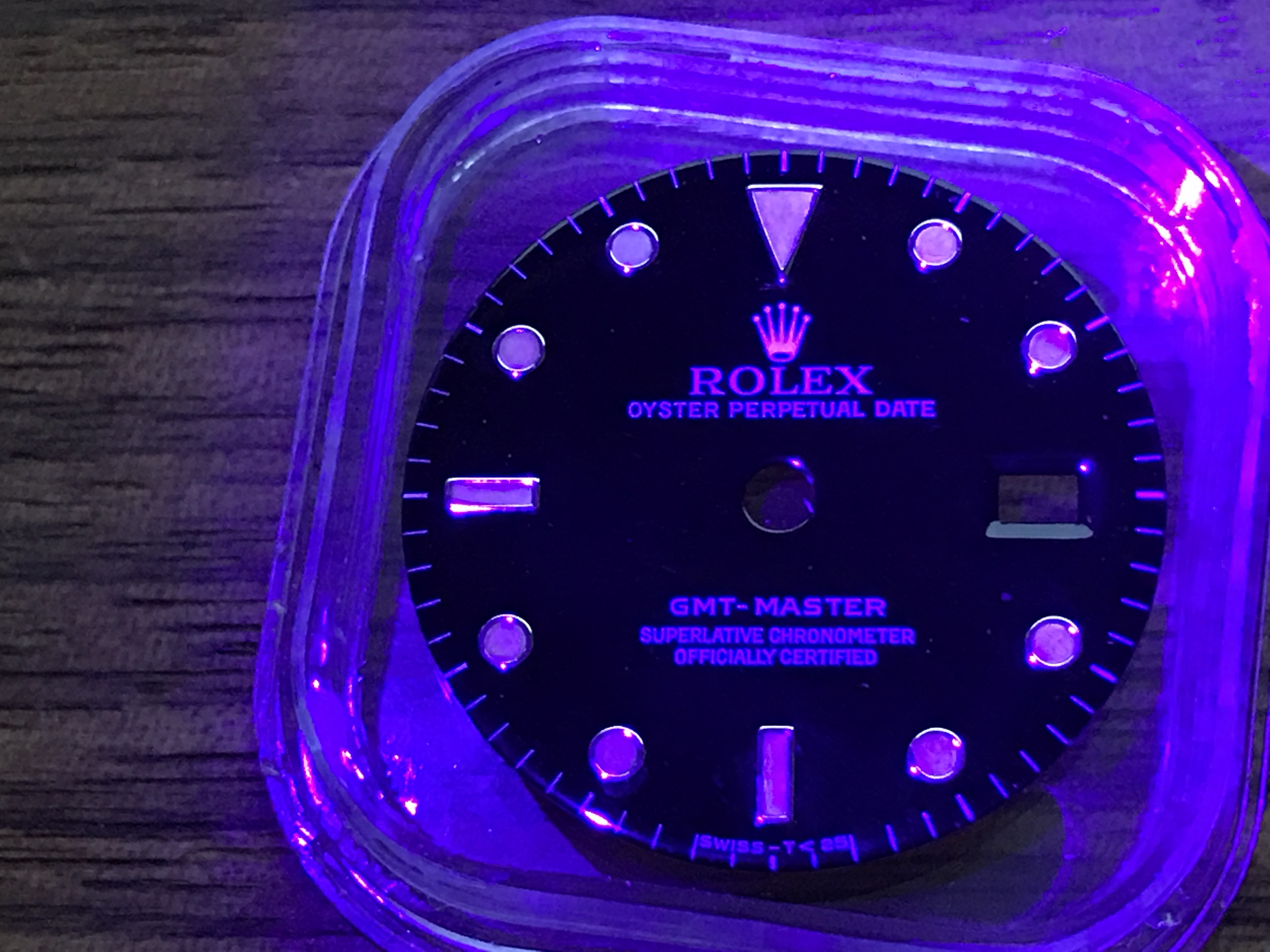

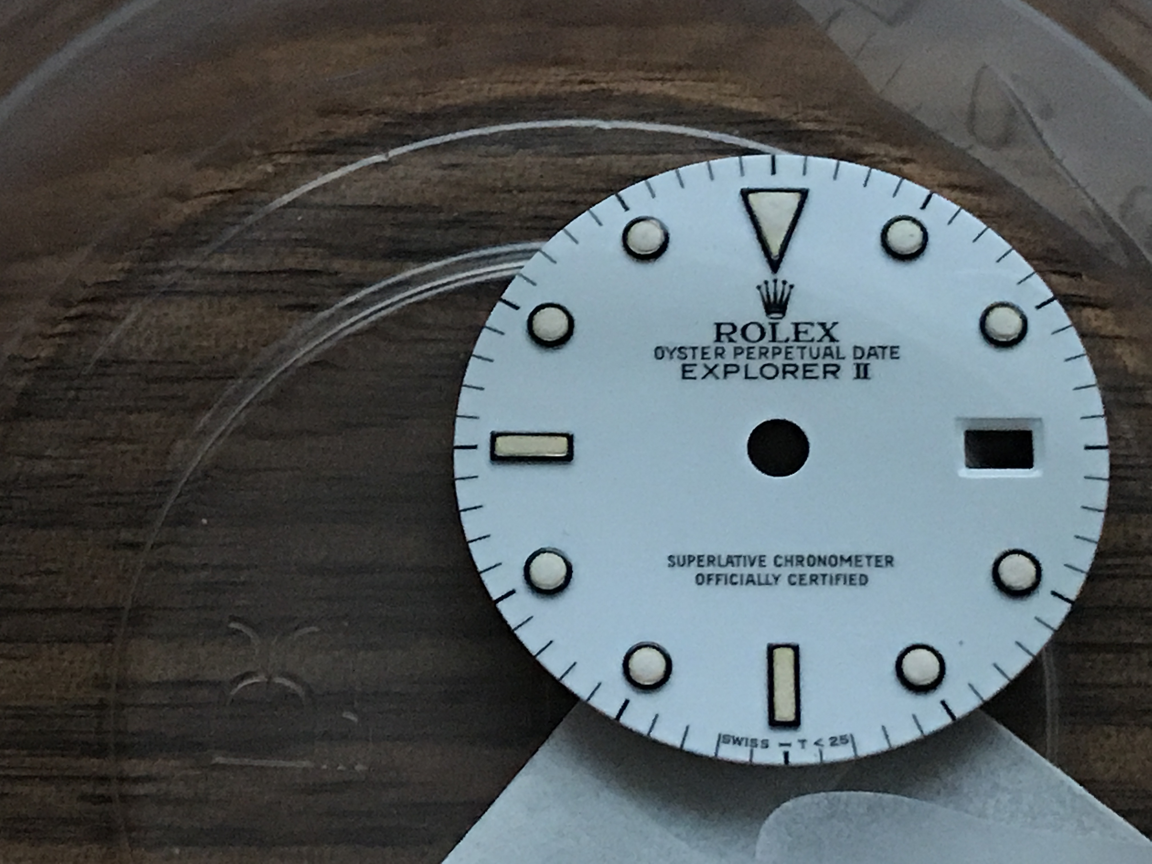

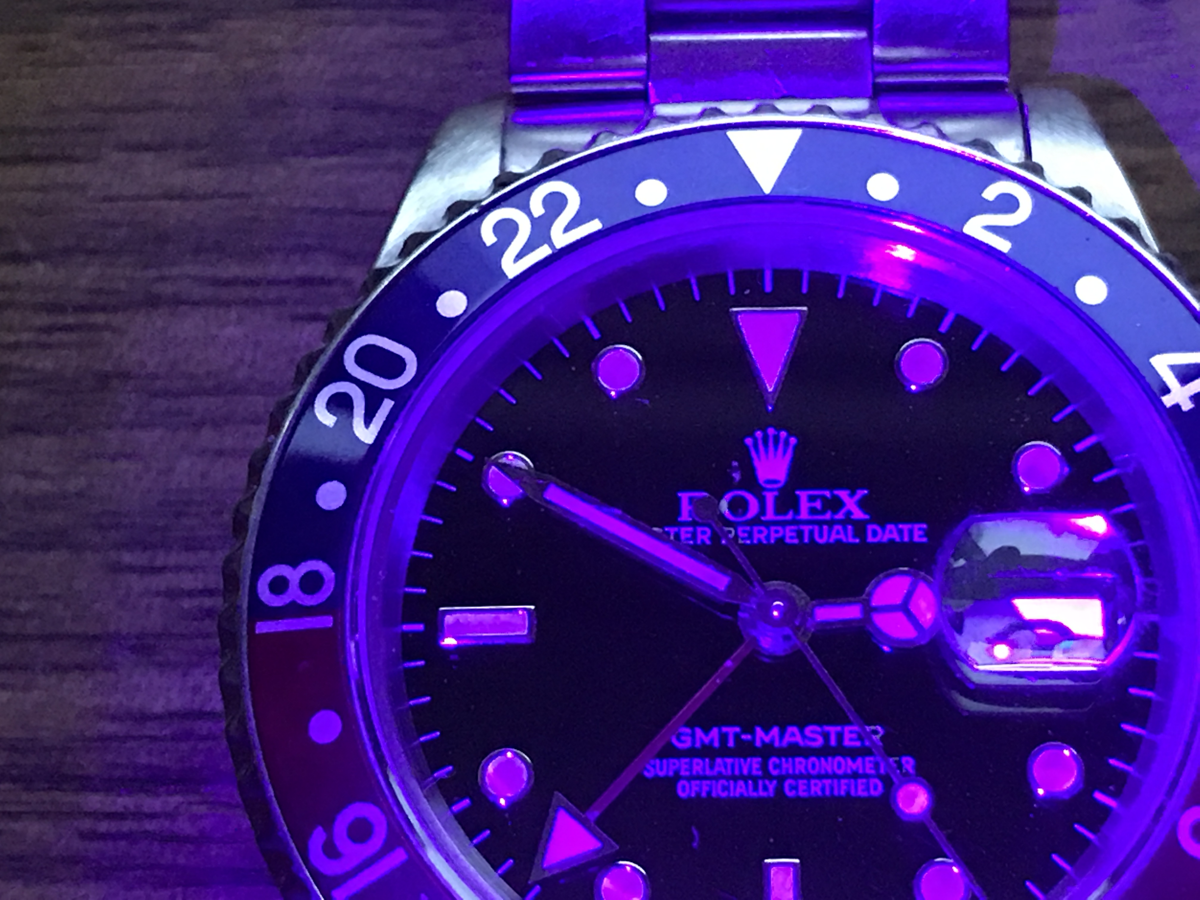

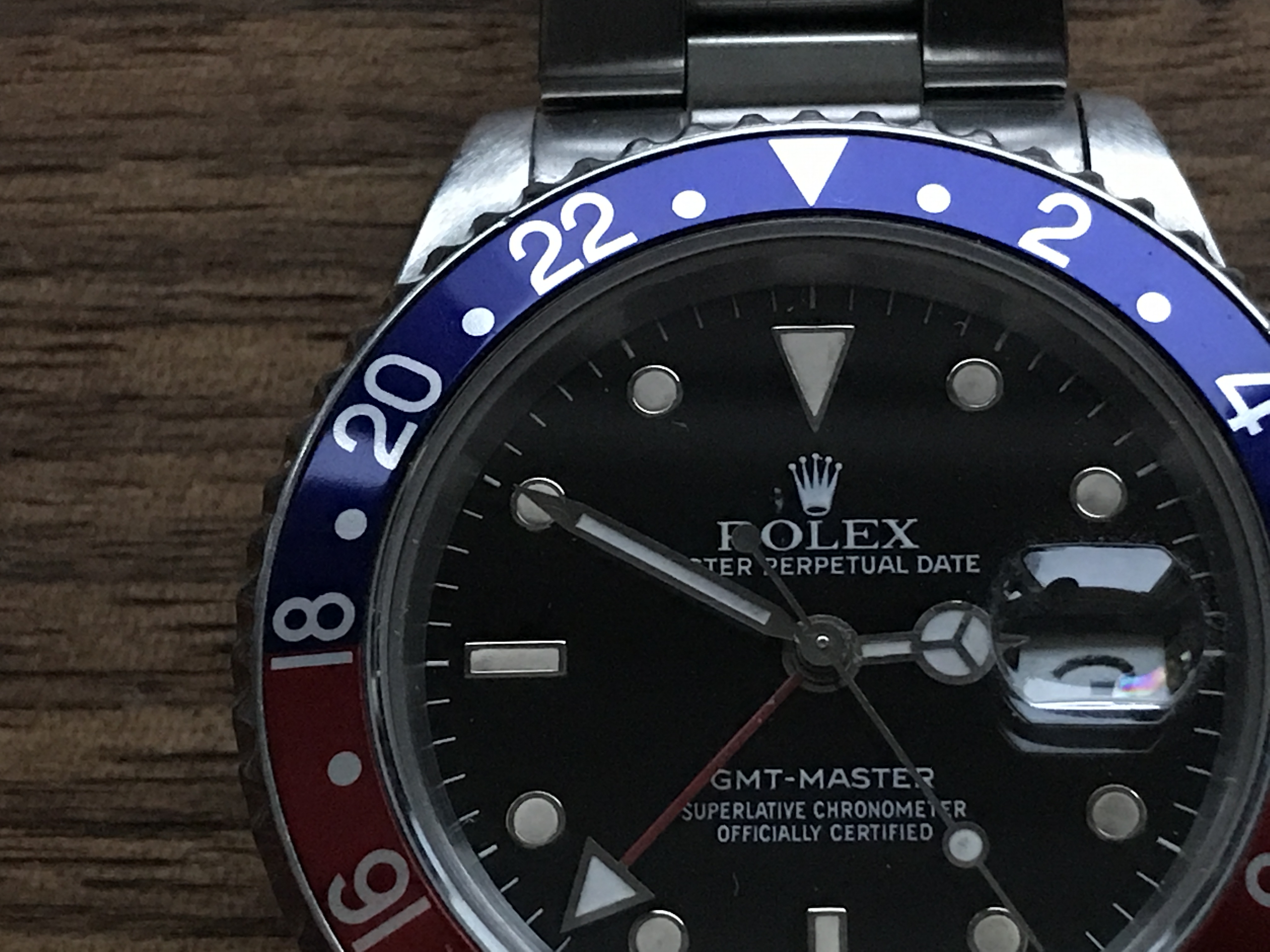

1) Rolex GMT Master 16700 from 1989

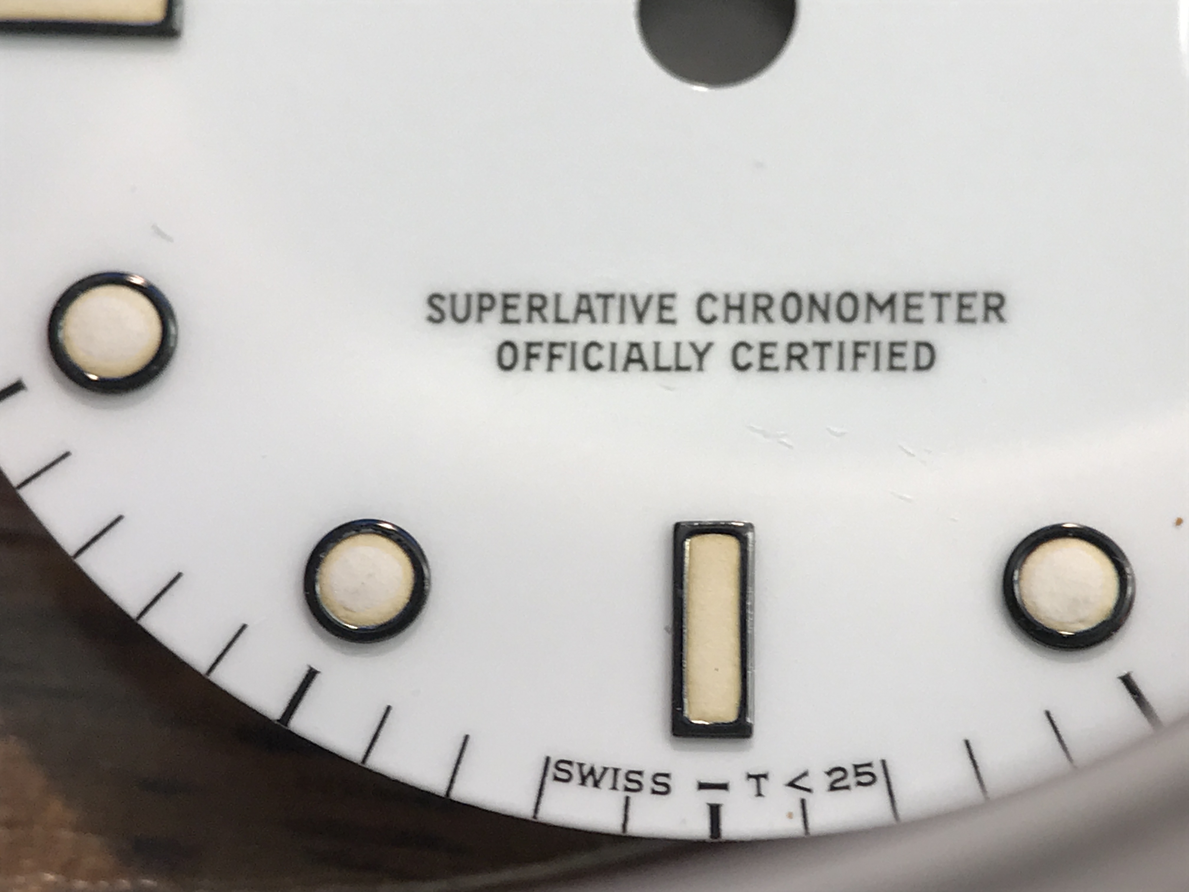

2) Rolex GMT Master spare tritium dial

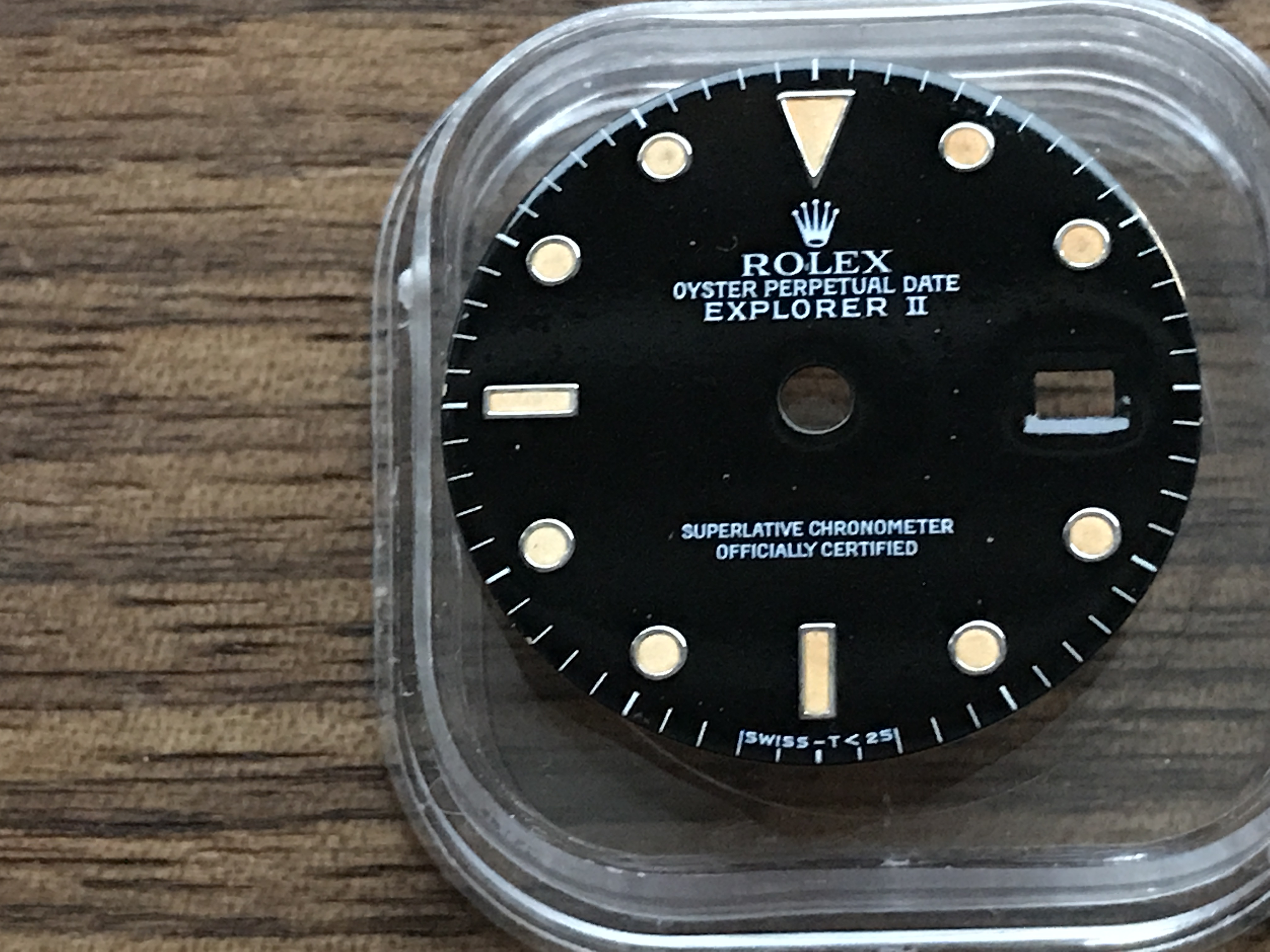

3) Rolex 16570 black spare dial
4) Rolex 16570 white dial spare dial

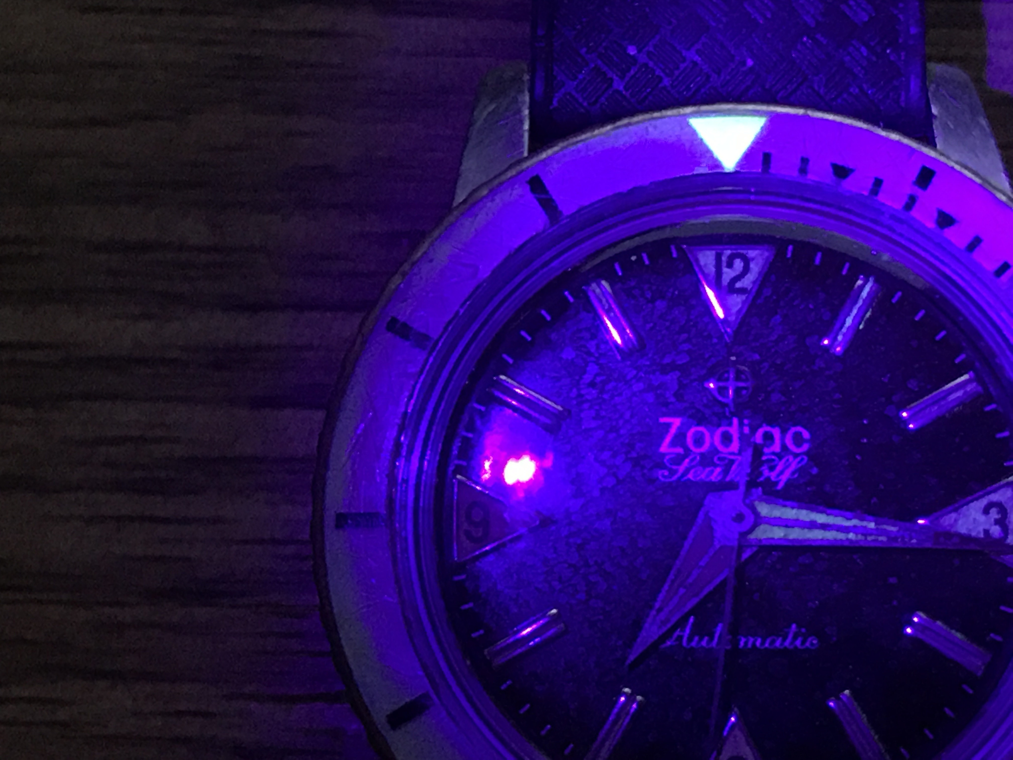

5) Zodiac Sea Wolf

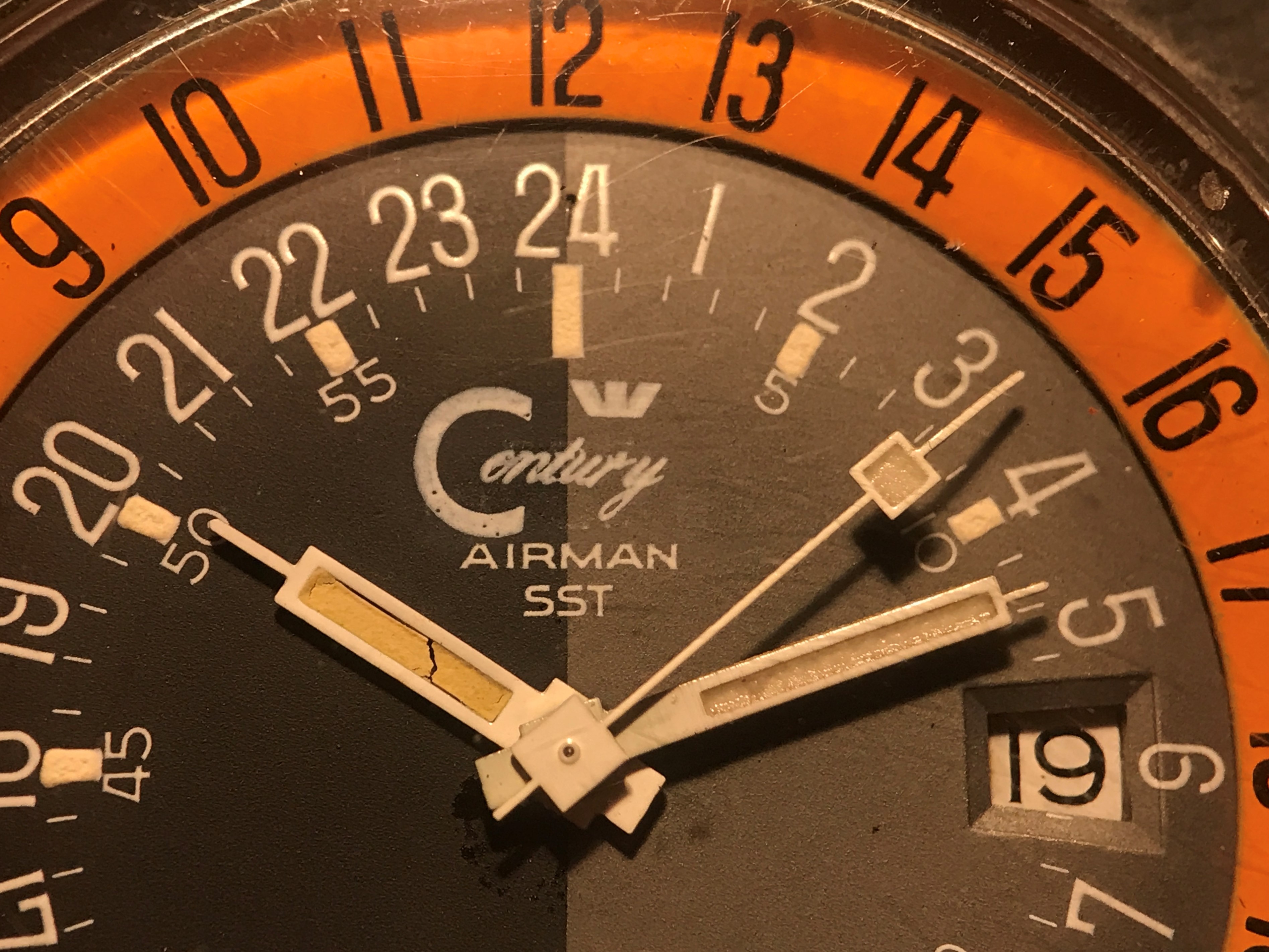

6) Glycine Airman SST 1970’s

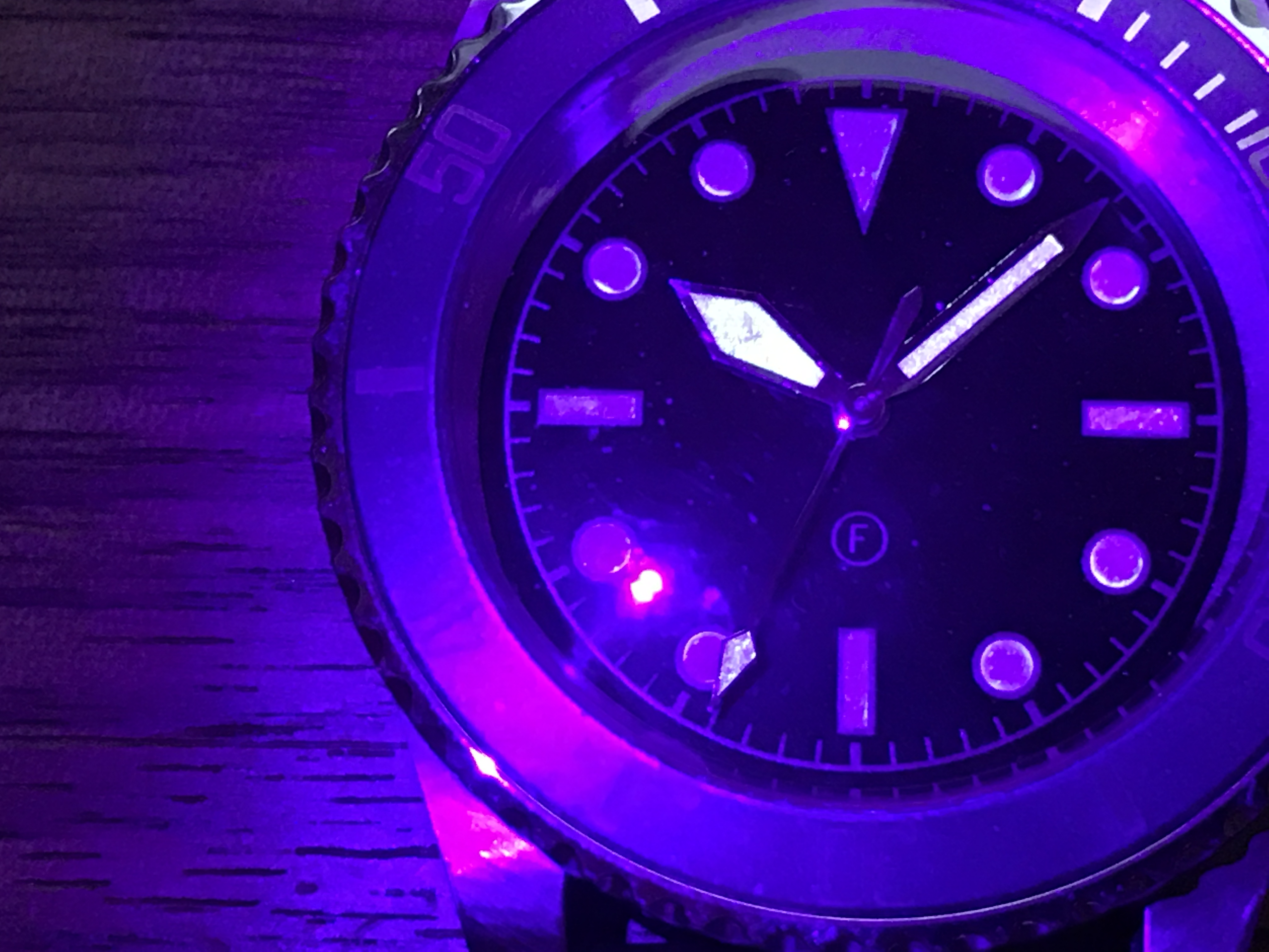

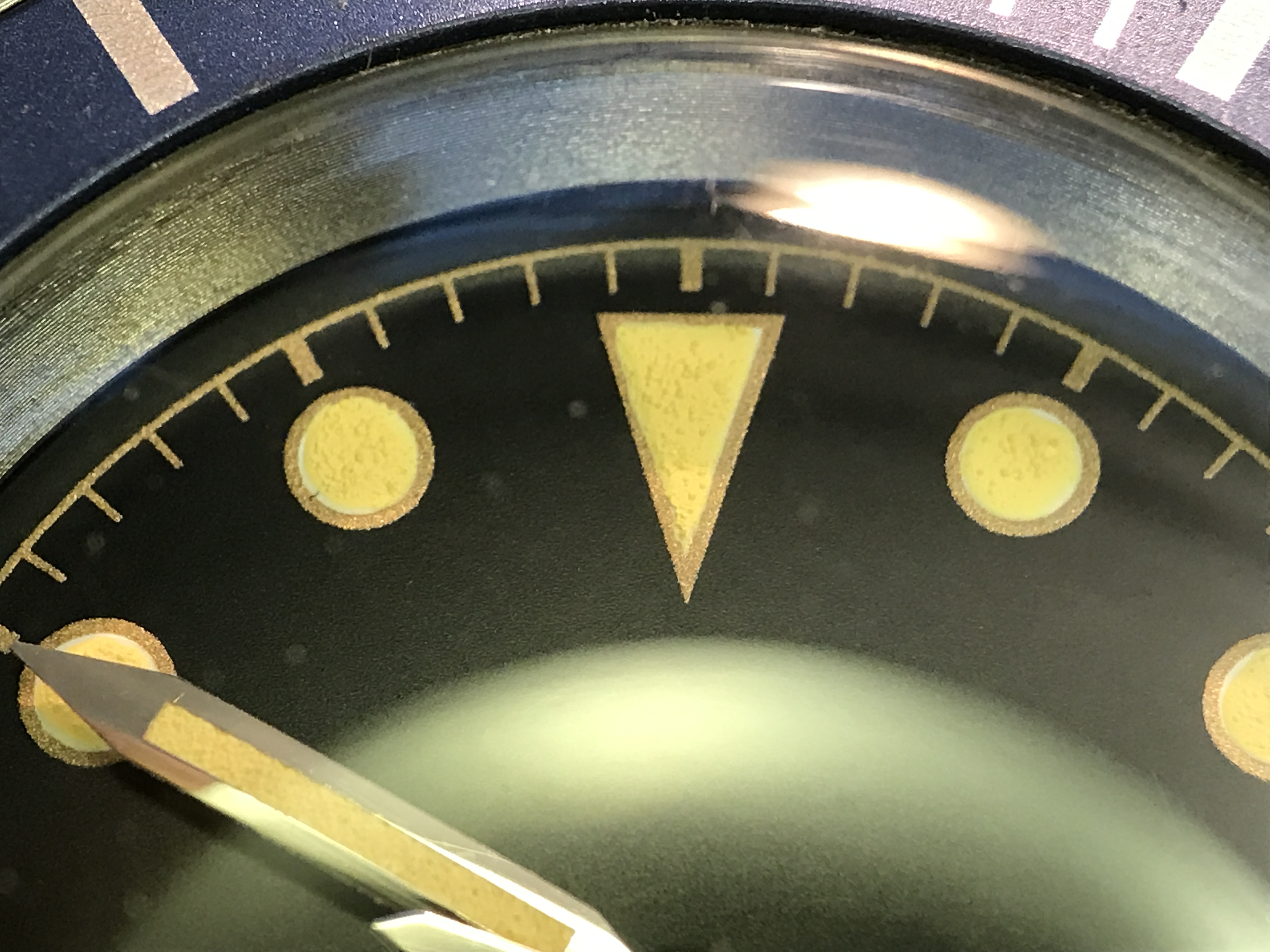

7) Freese Series 1 - as comparison of what can be done with modern reluming.
I sourced the spare dial No. 2, 3 and 4 from a reputable seller in good standing on VRF, so I have every reason to believe they are legit. I purchased them with the intention to fit it to a 1990s Explorer II Ref. 16570 , as many of those have service dial. But for various reasons, I haven’t pulled the trigger on a Explorer II, so as of now I only have the dials.
I focus on the lume dots / triangles rather than on the hands in my comparison. Here are my observations: (pictures are in sequence)

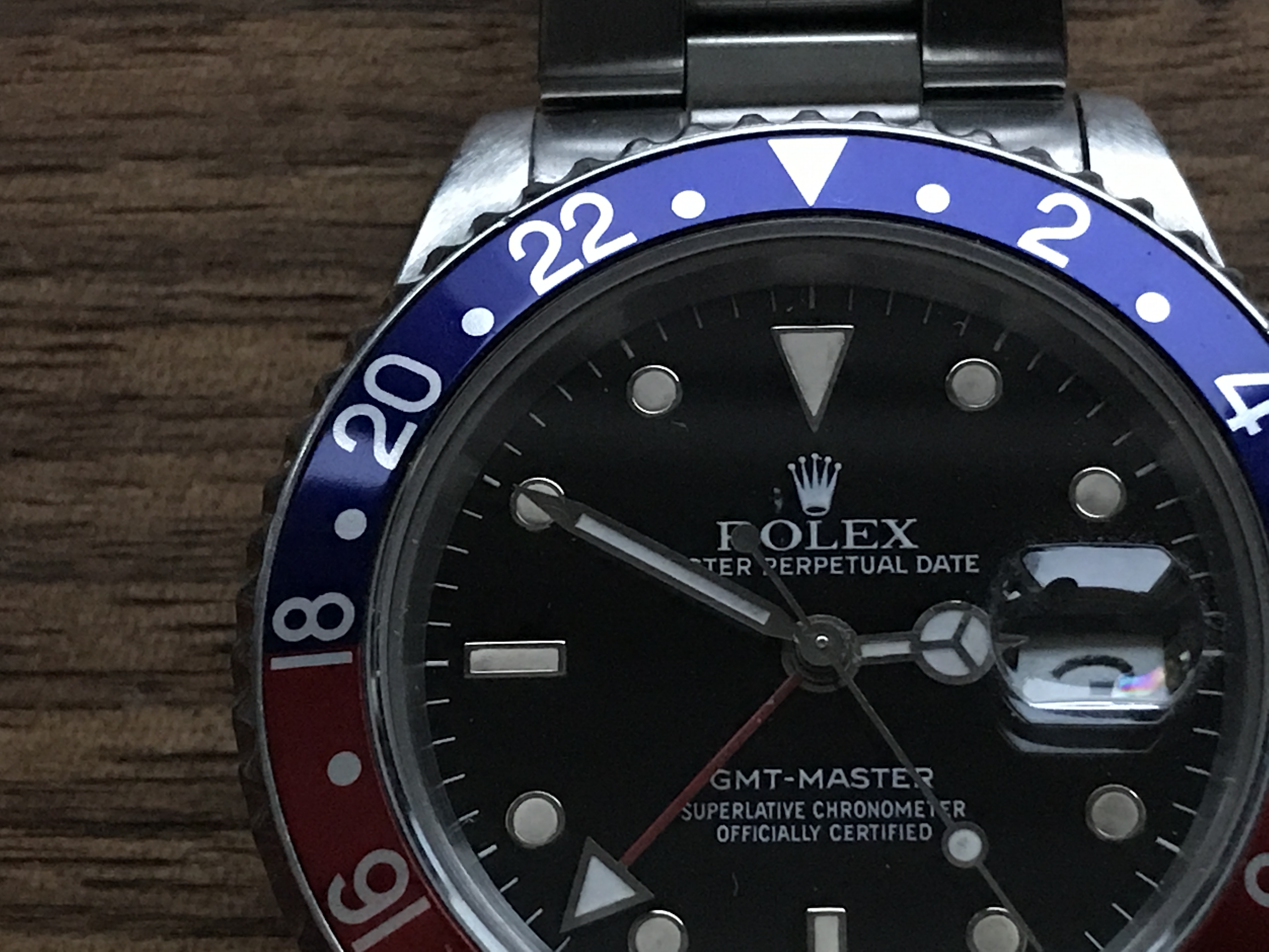

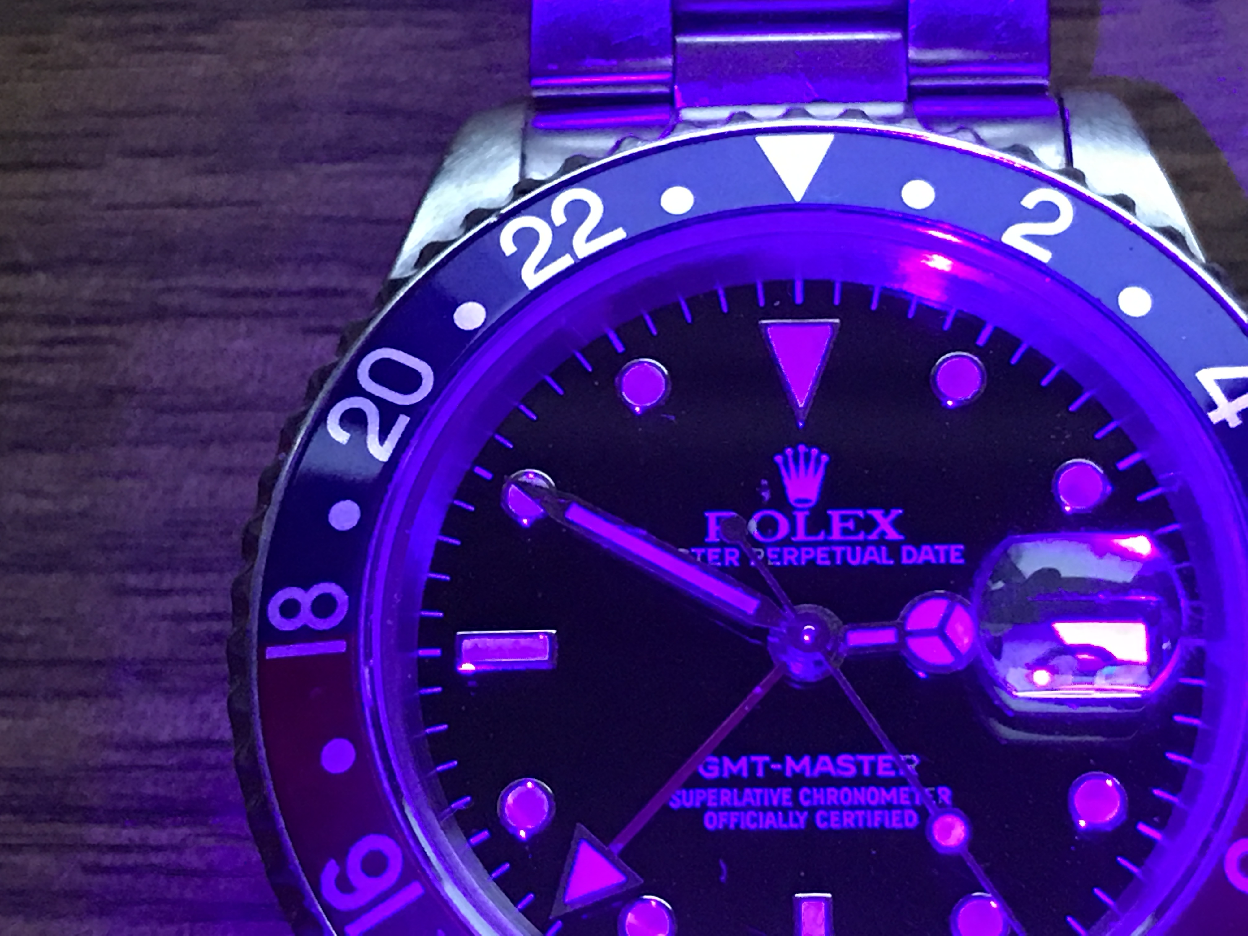

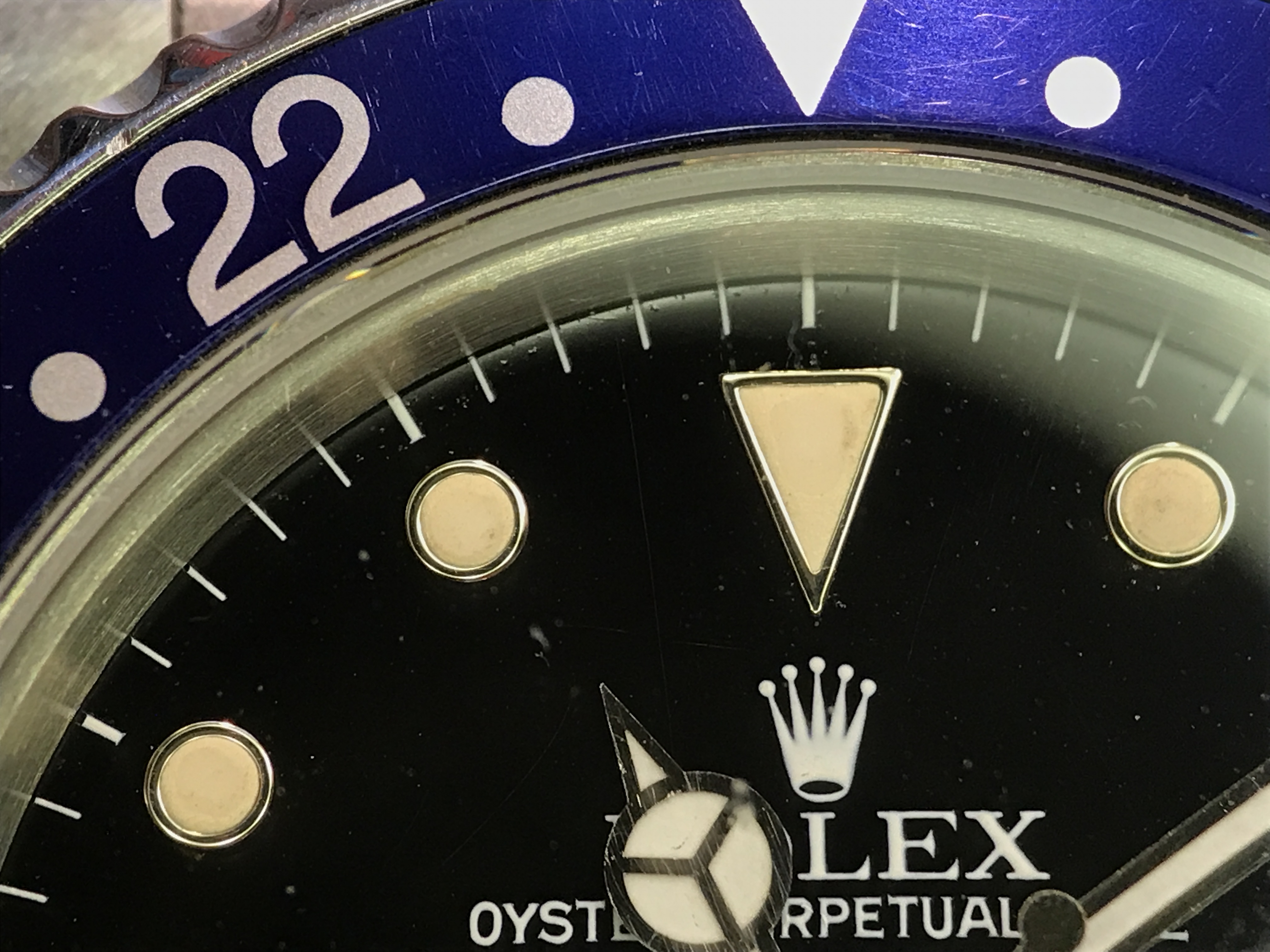

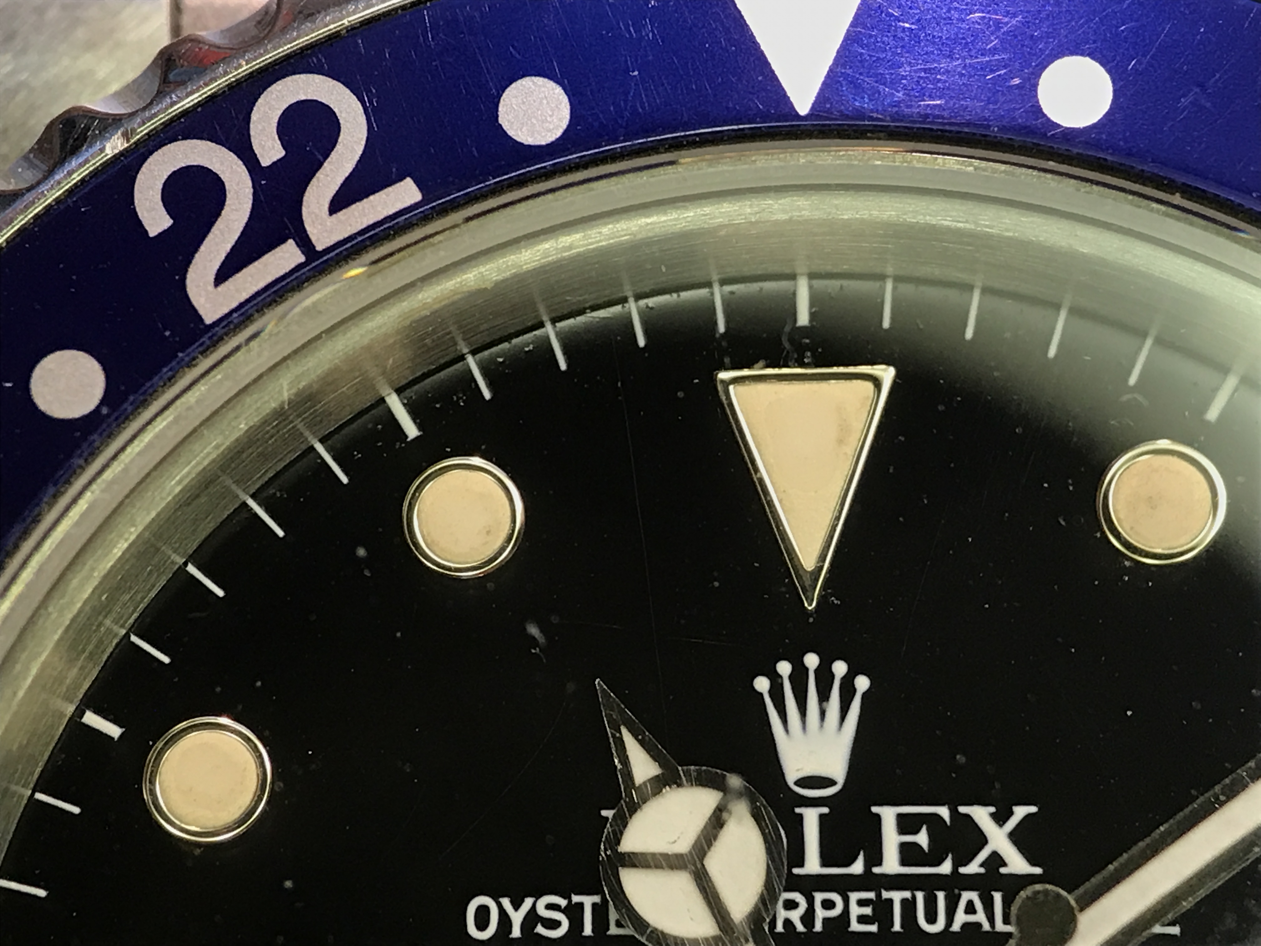

In natural light, the lume dots show light beige patina. Under UV light, the lume does not glow, nor reflect the light. You could probably say that the tritium gleams, but I find it not very obvious.
That’s at least what I see, maybe you have another impression.

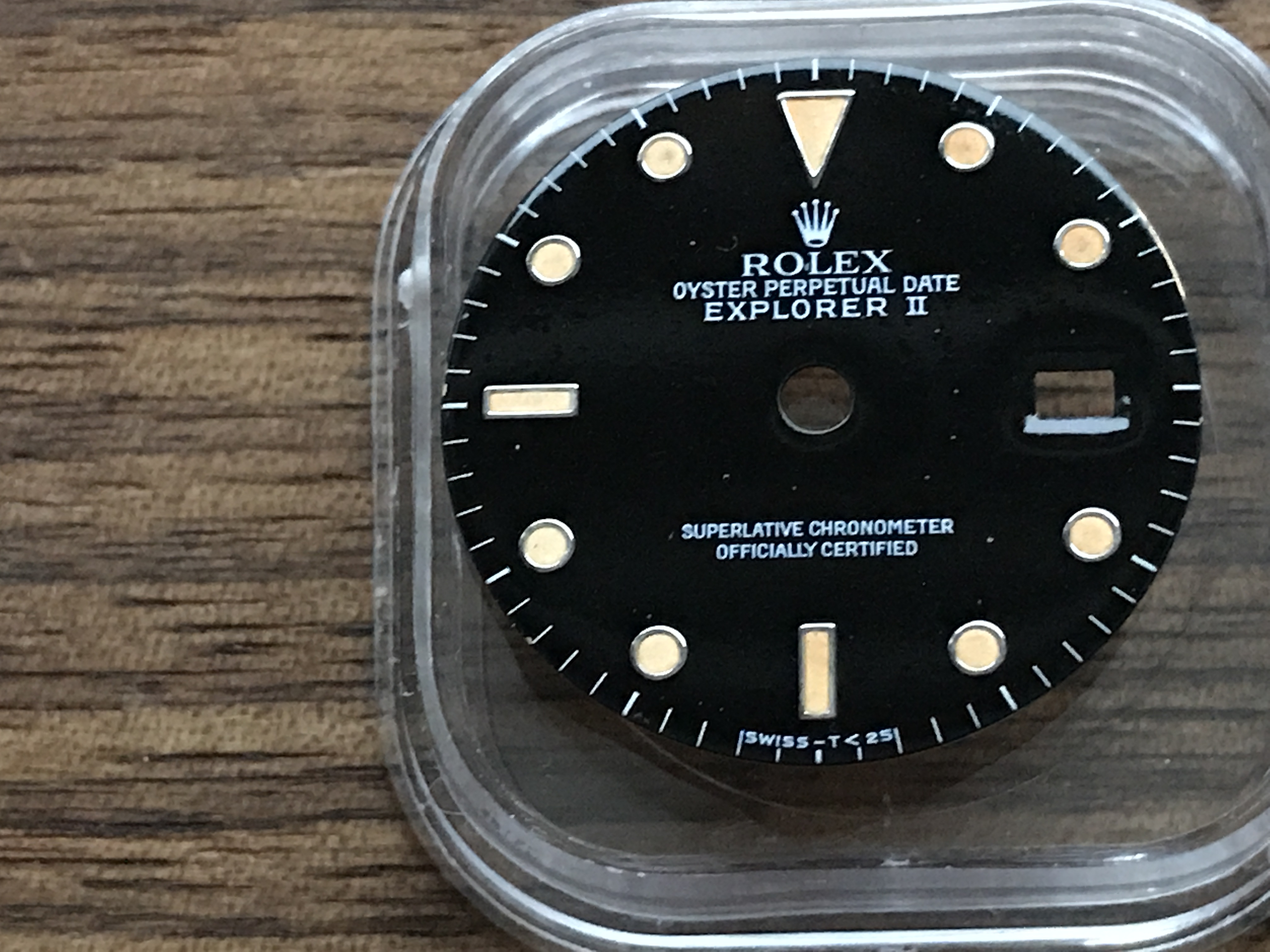

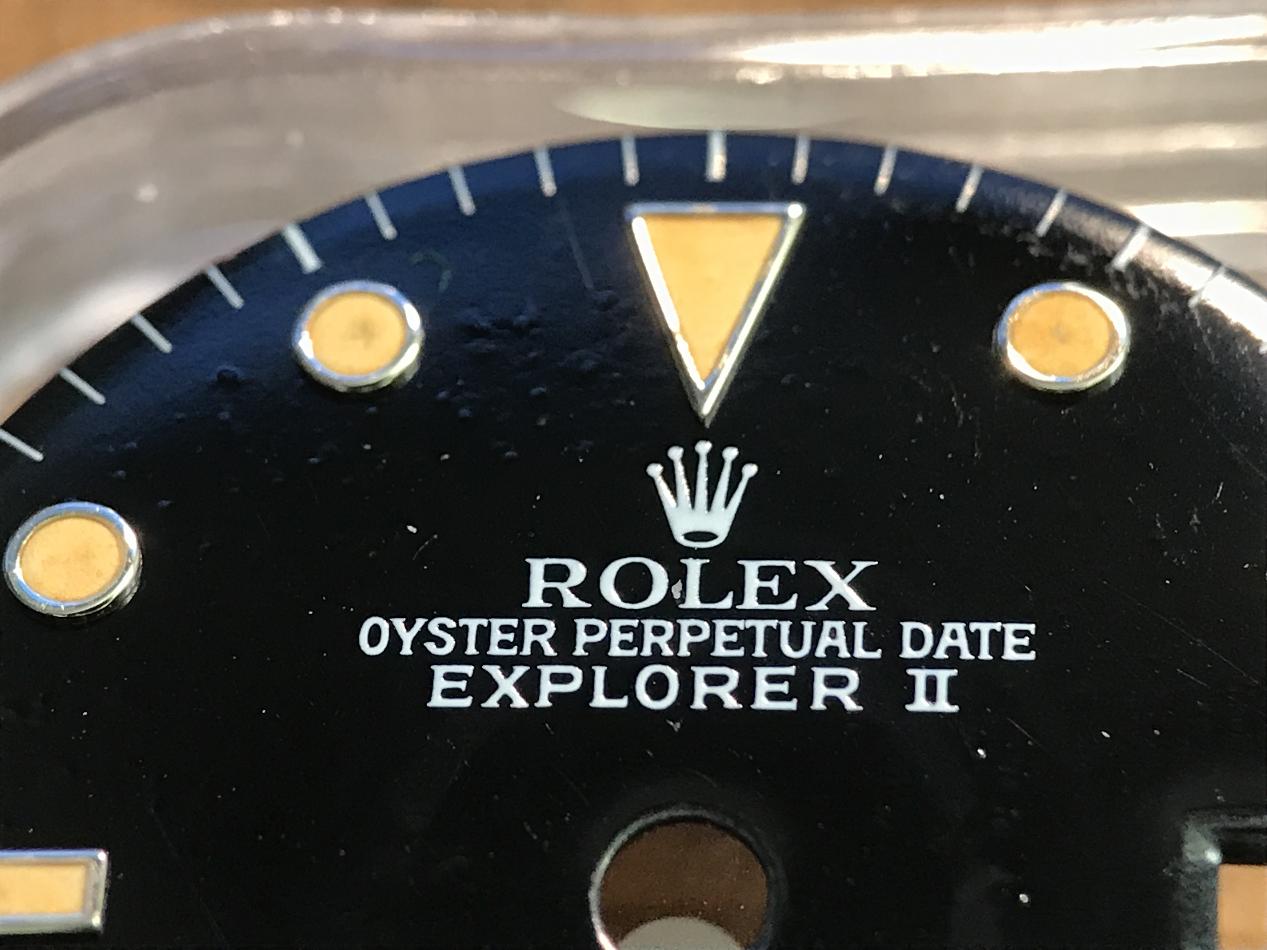

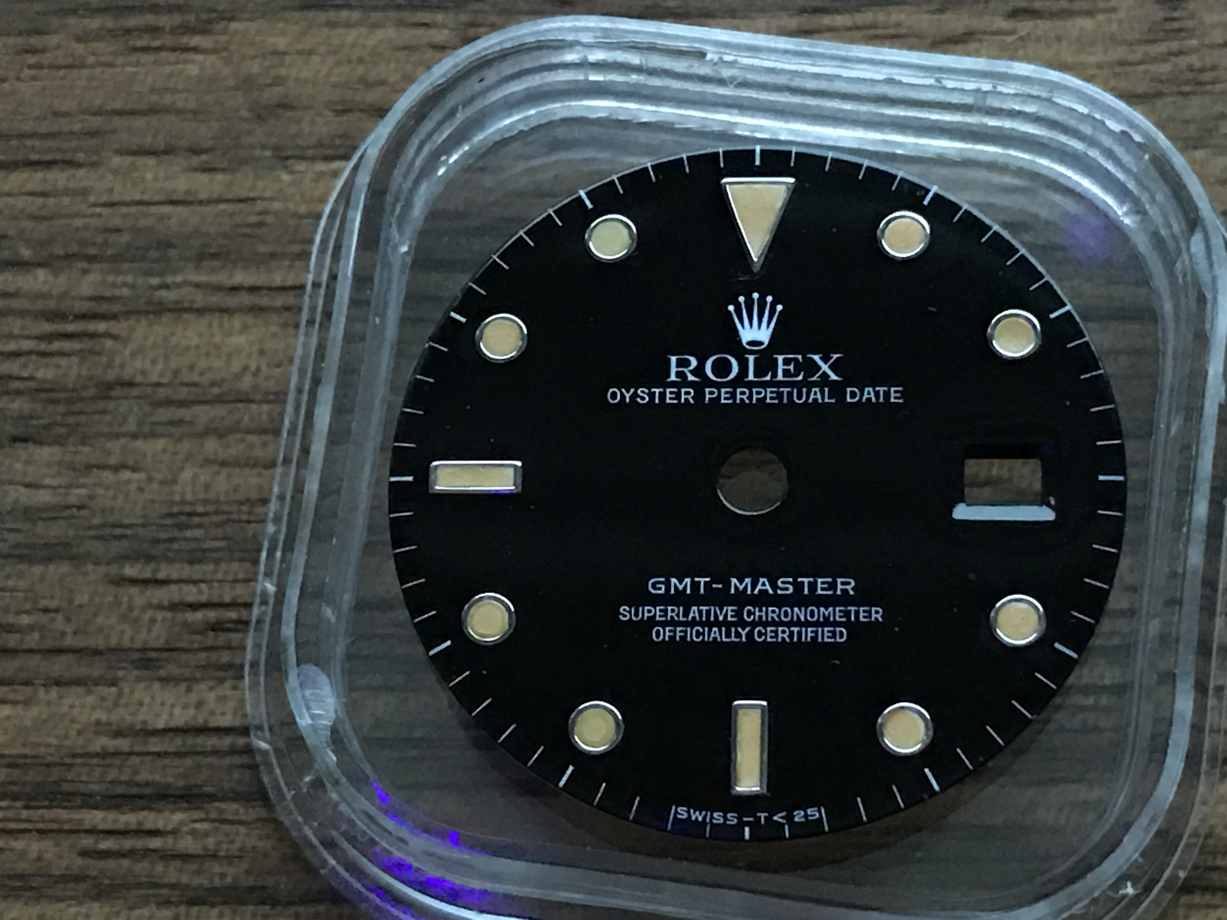

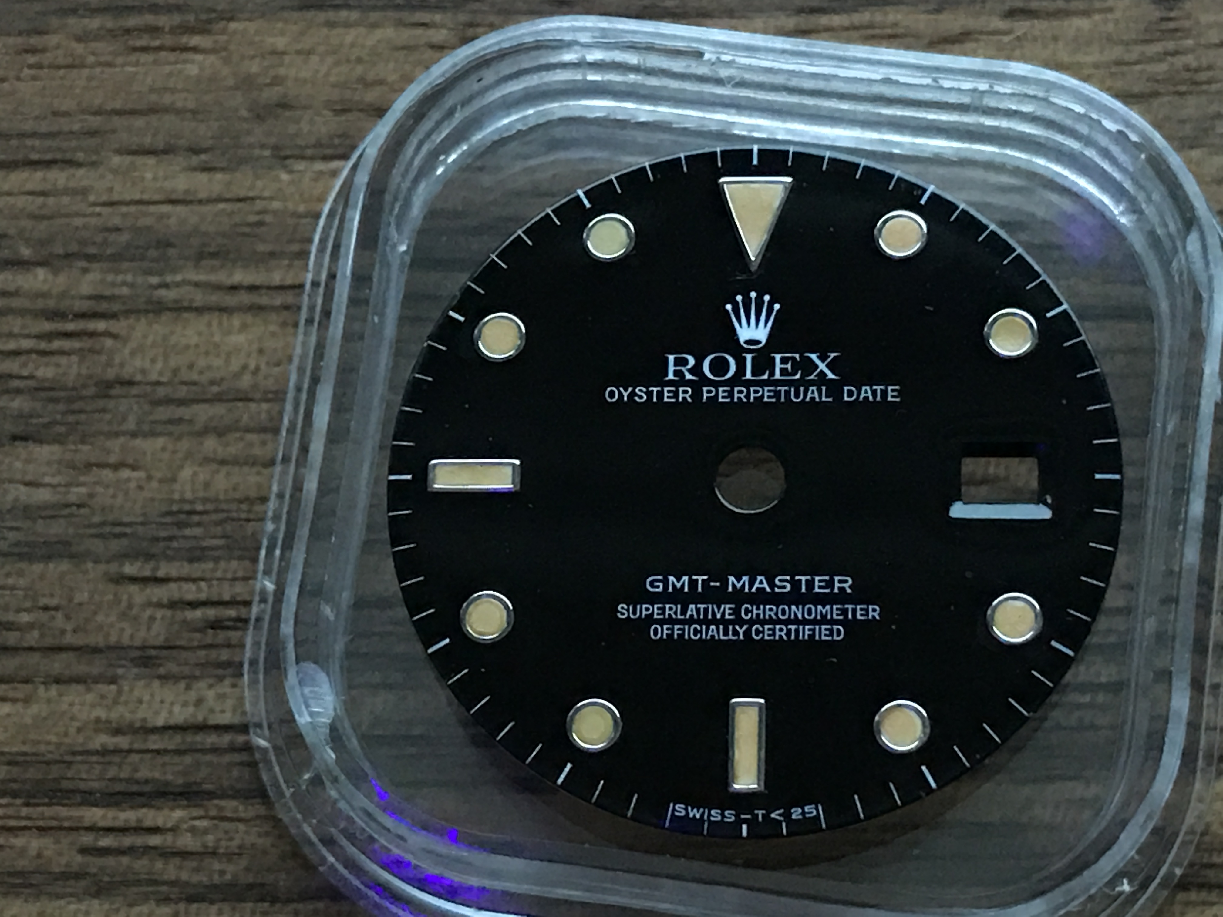

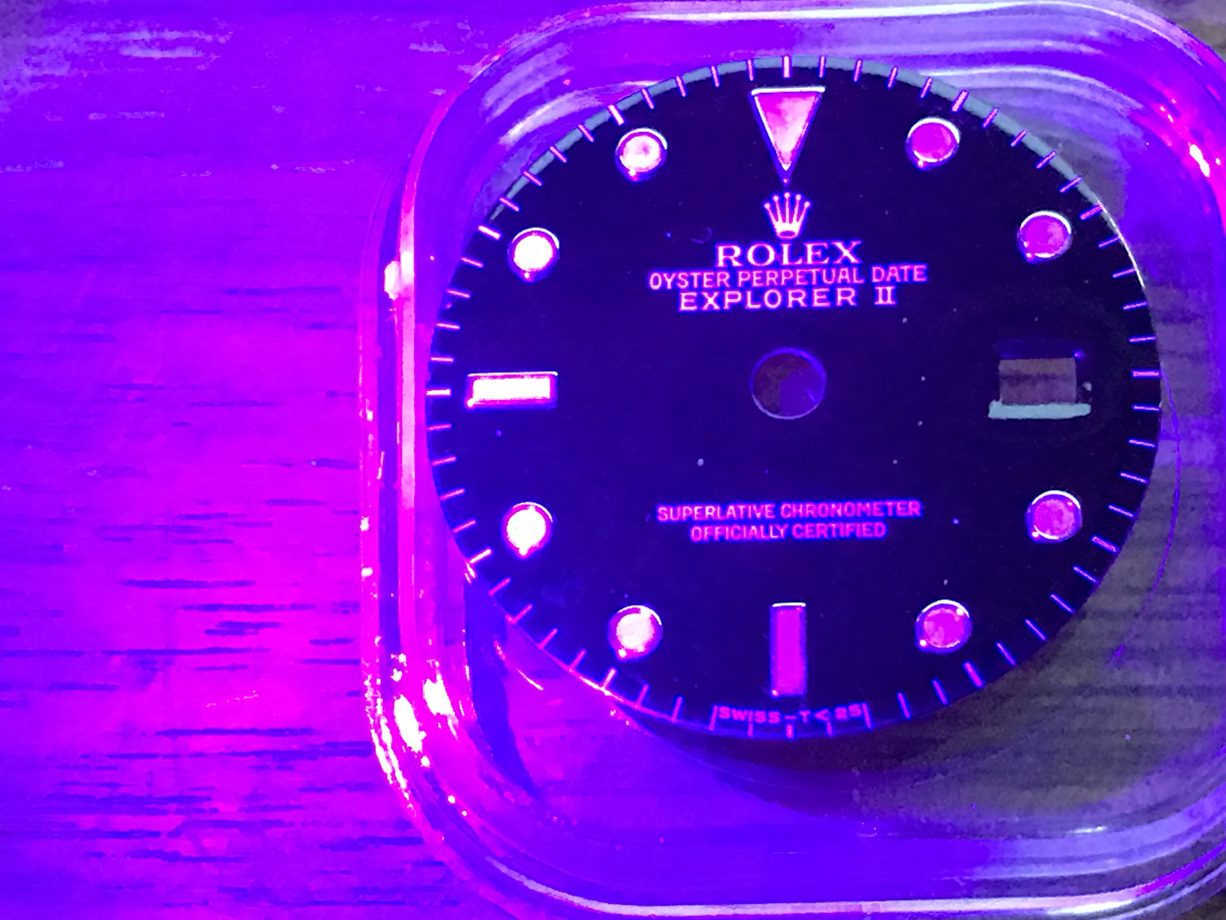

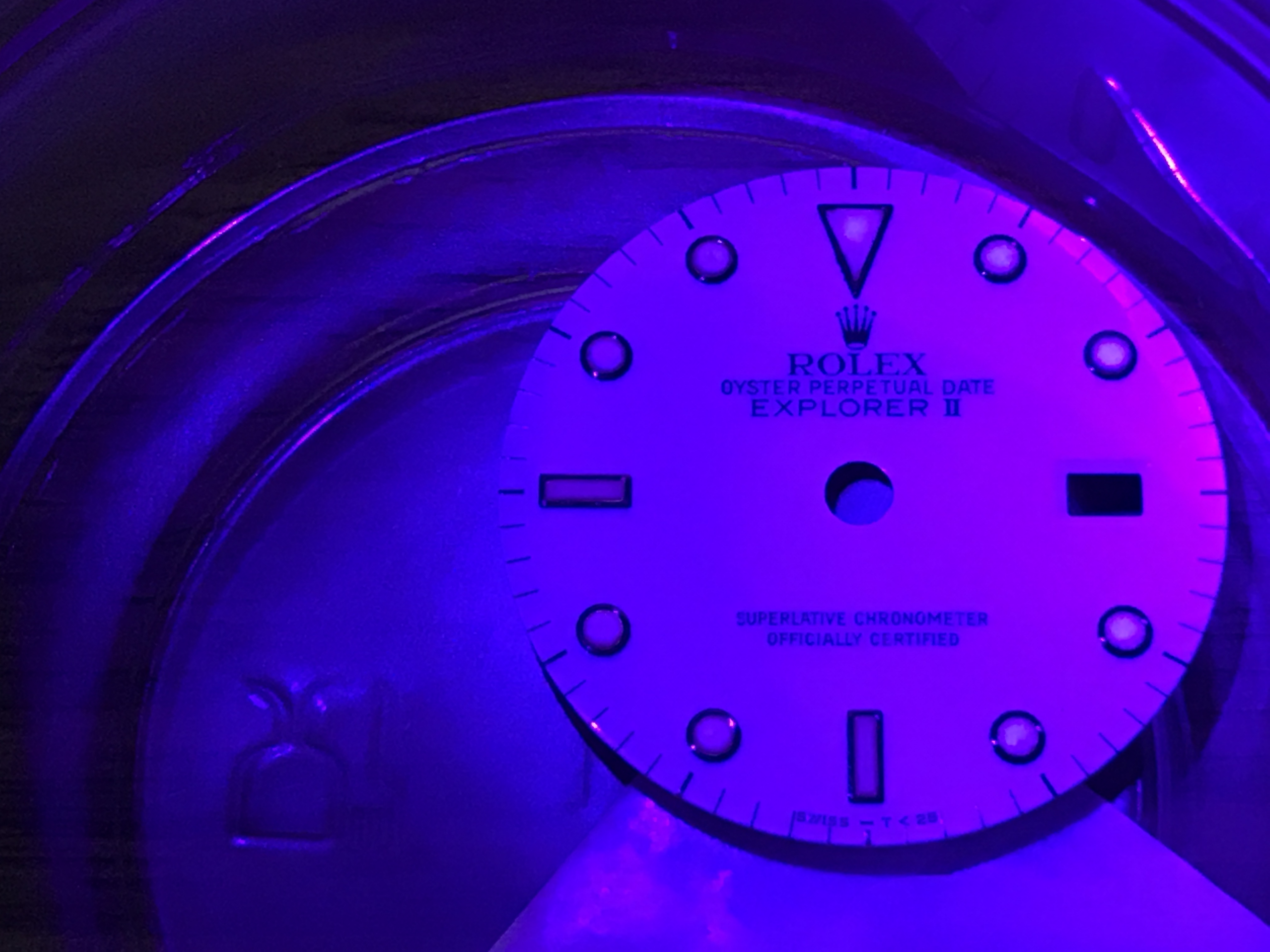

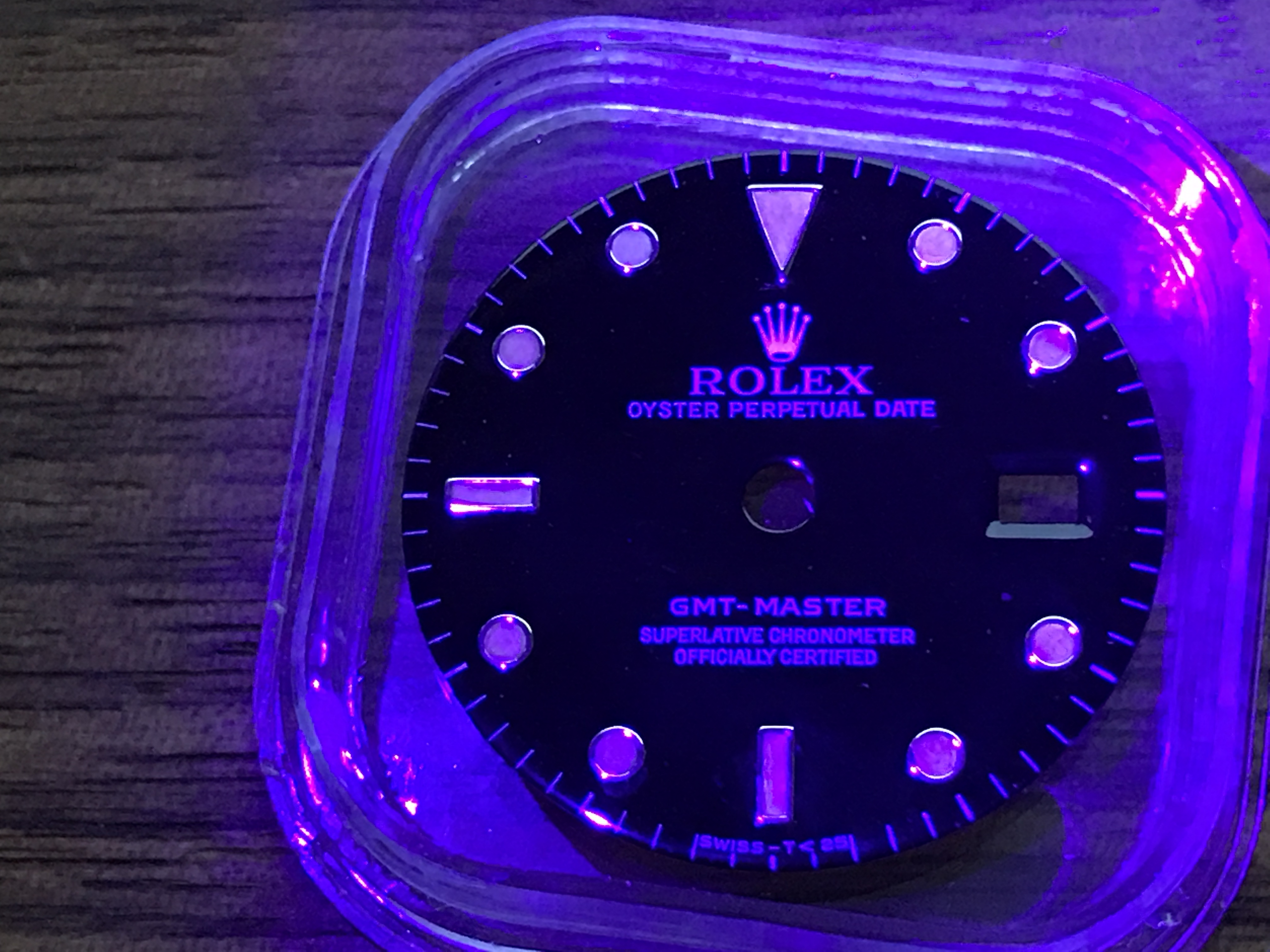

In natural light, the lume dots and triangle shows a shiny custard patina. Under UV light, the lume does not glow, nor reflect the light. Essentially the same as sample No 1.

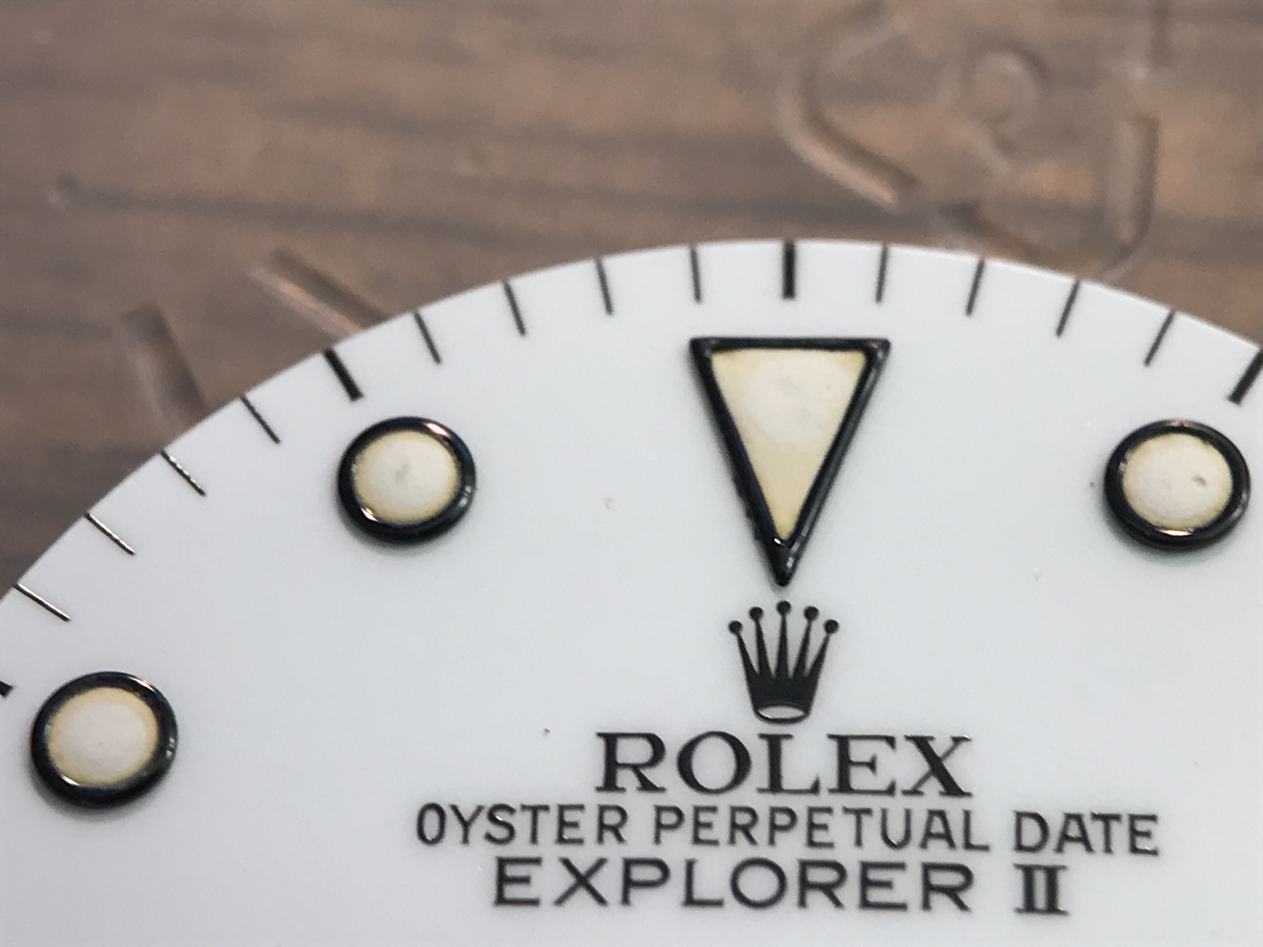

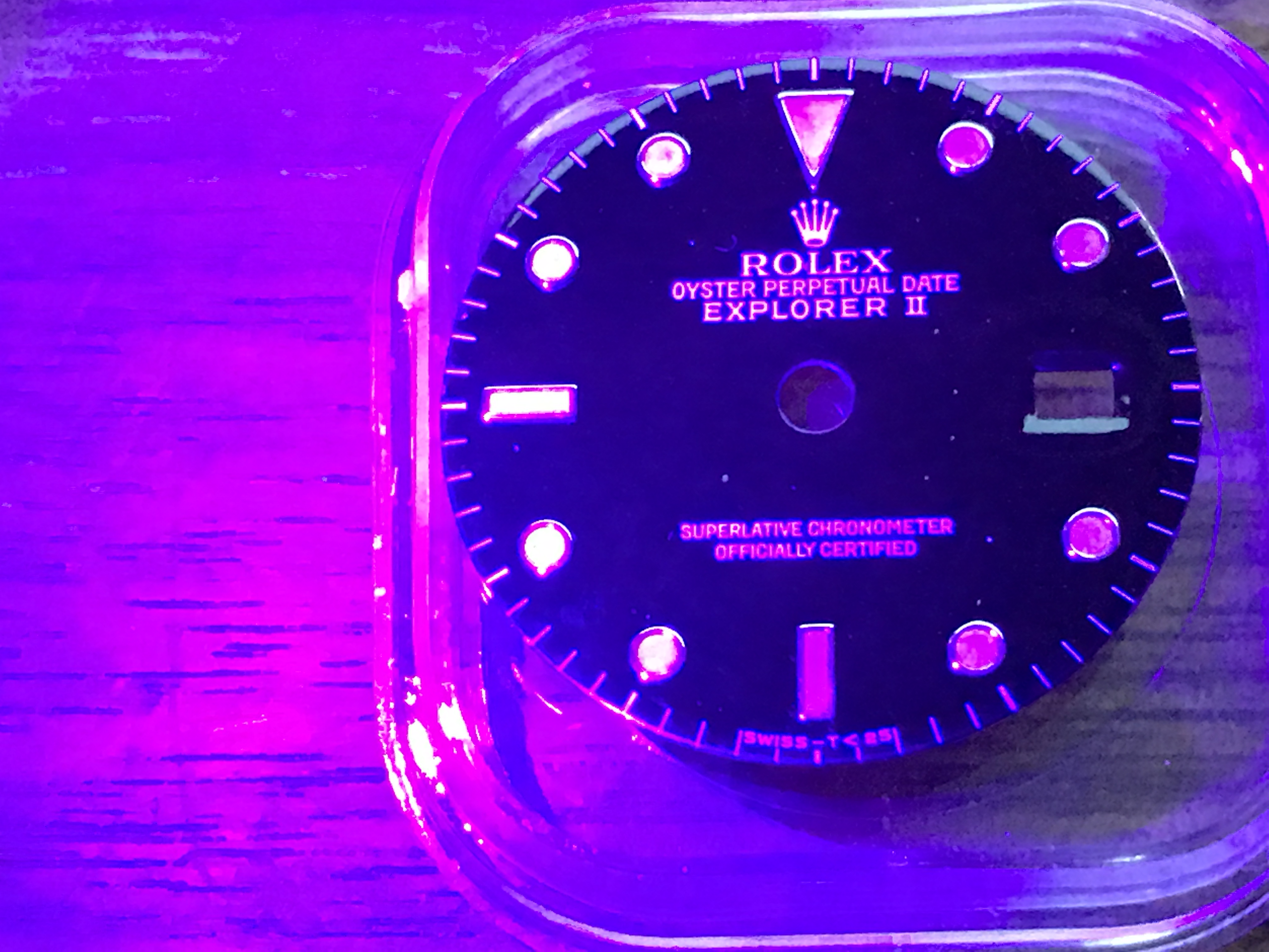

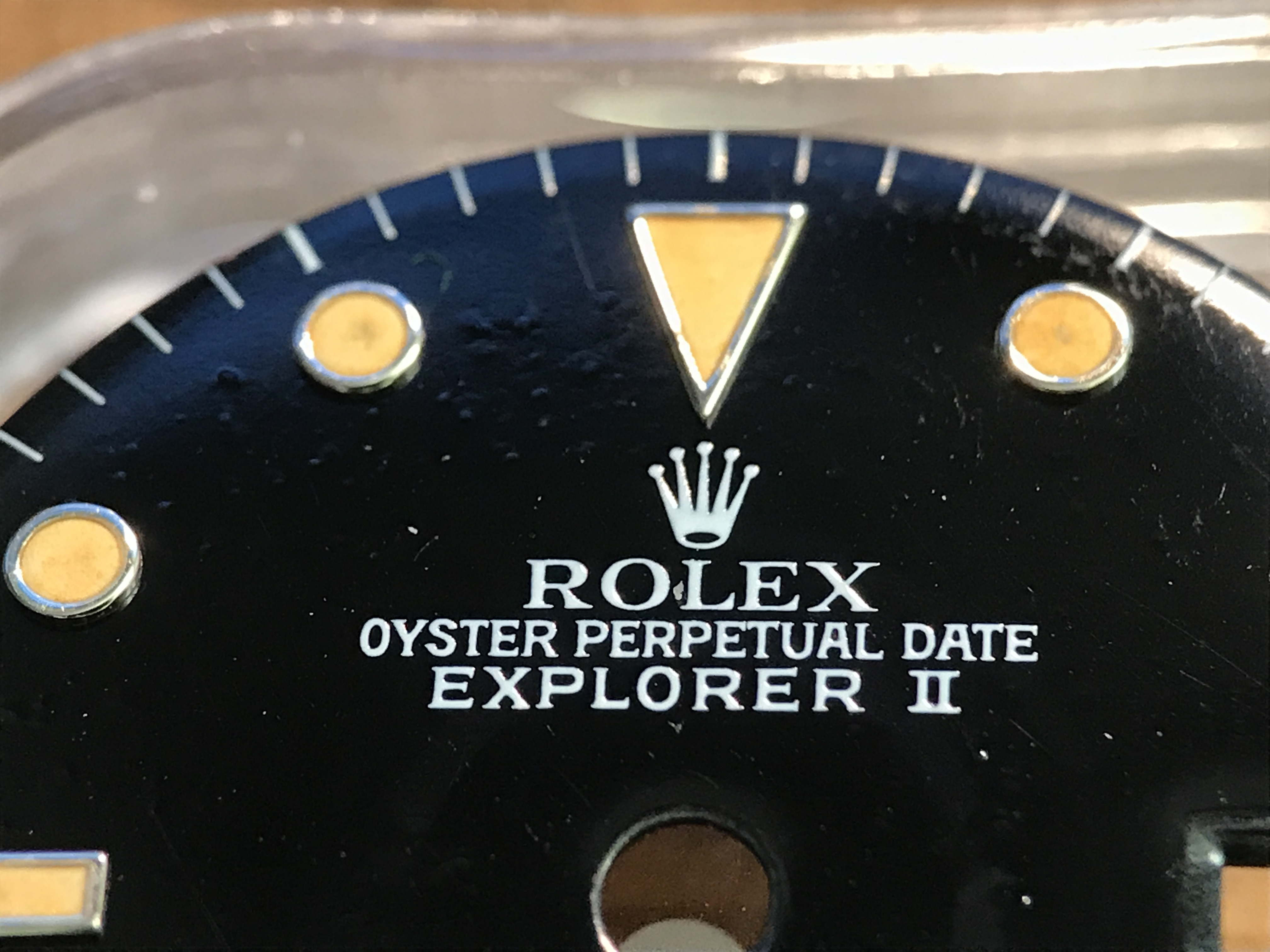

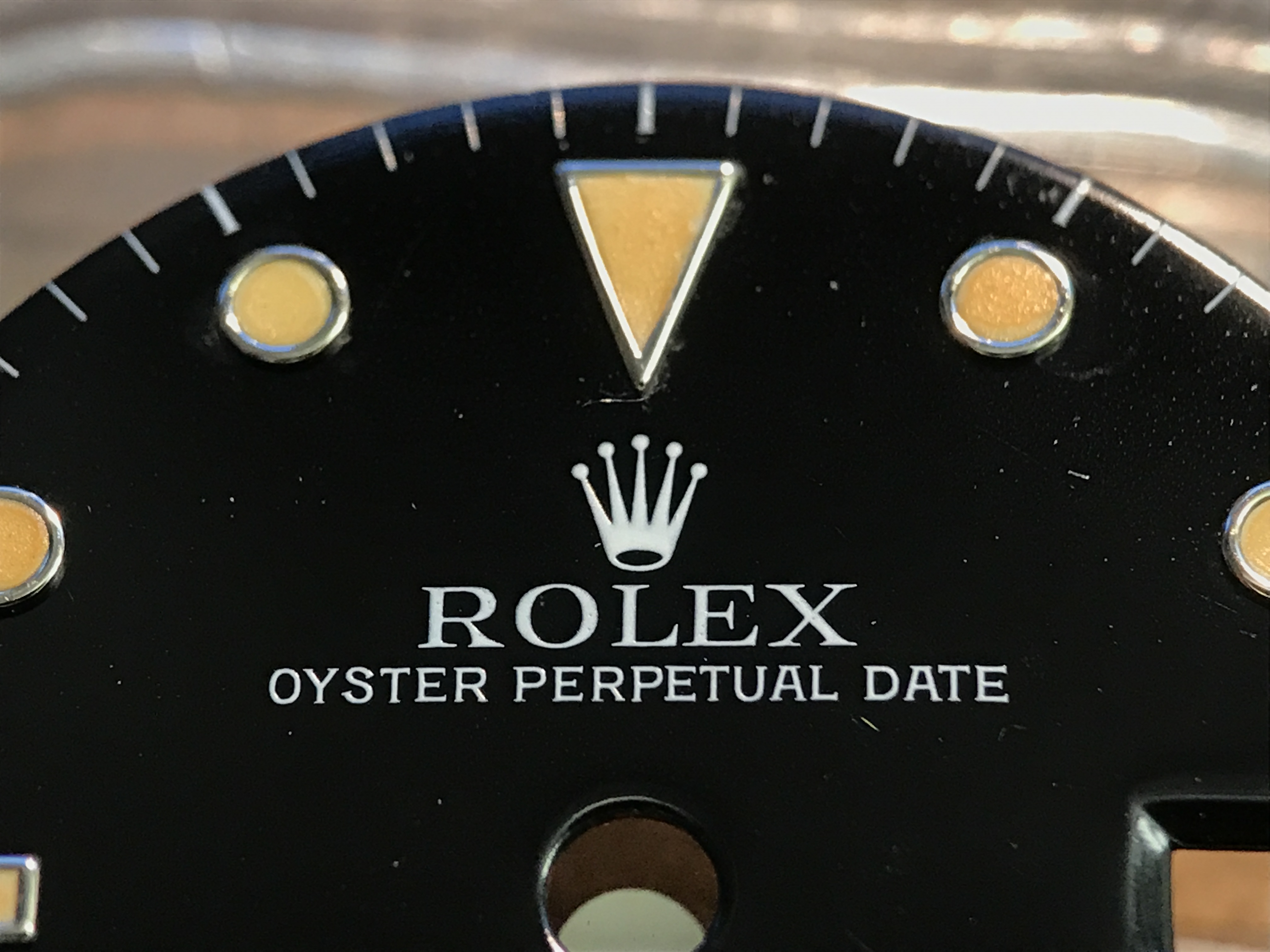

In natural light, the lume dots and triangle shows as shiny, almost orange patina. Under UV light, the lume shows pretty much the same results as example 1 and 2.

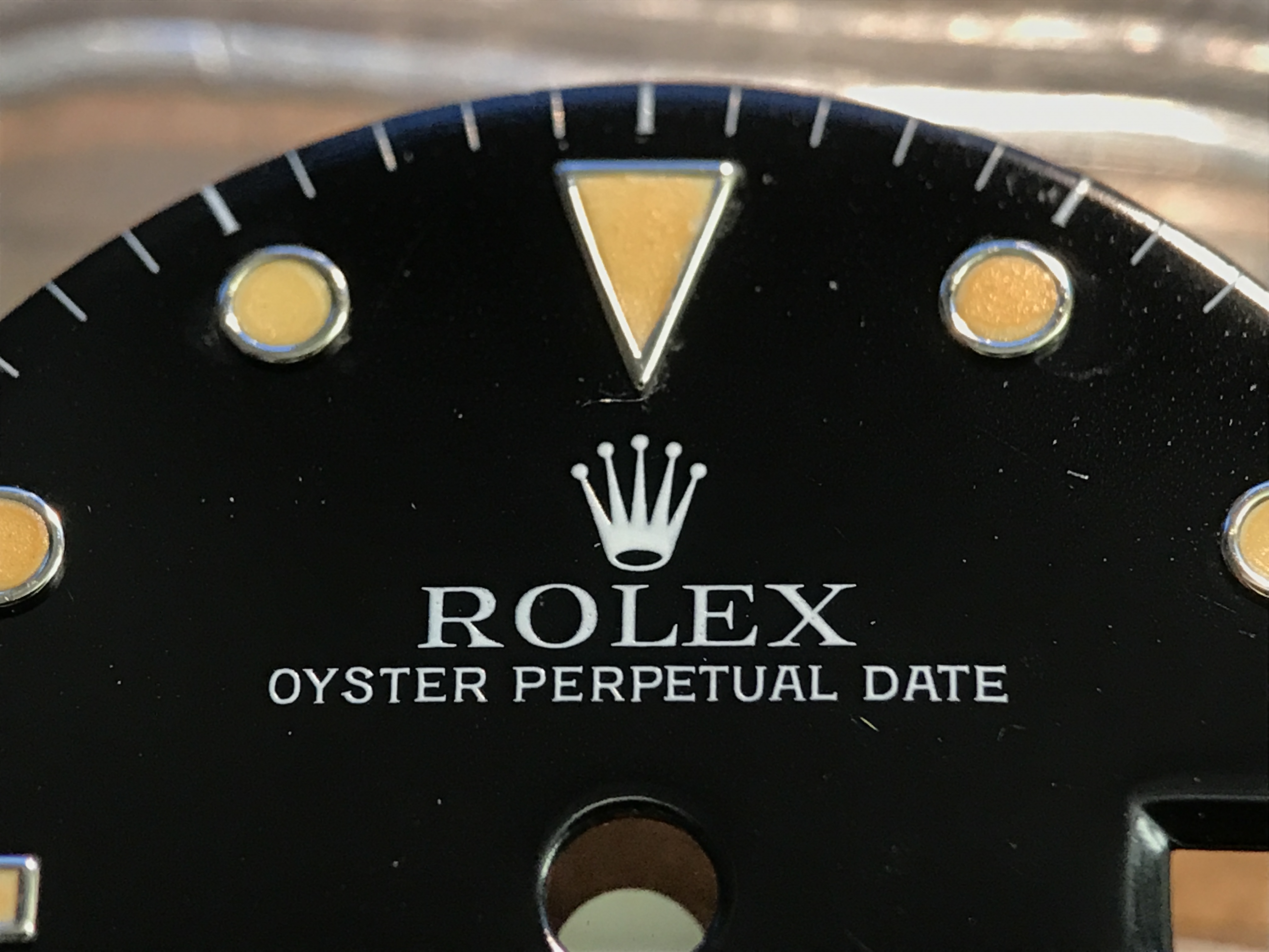

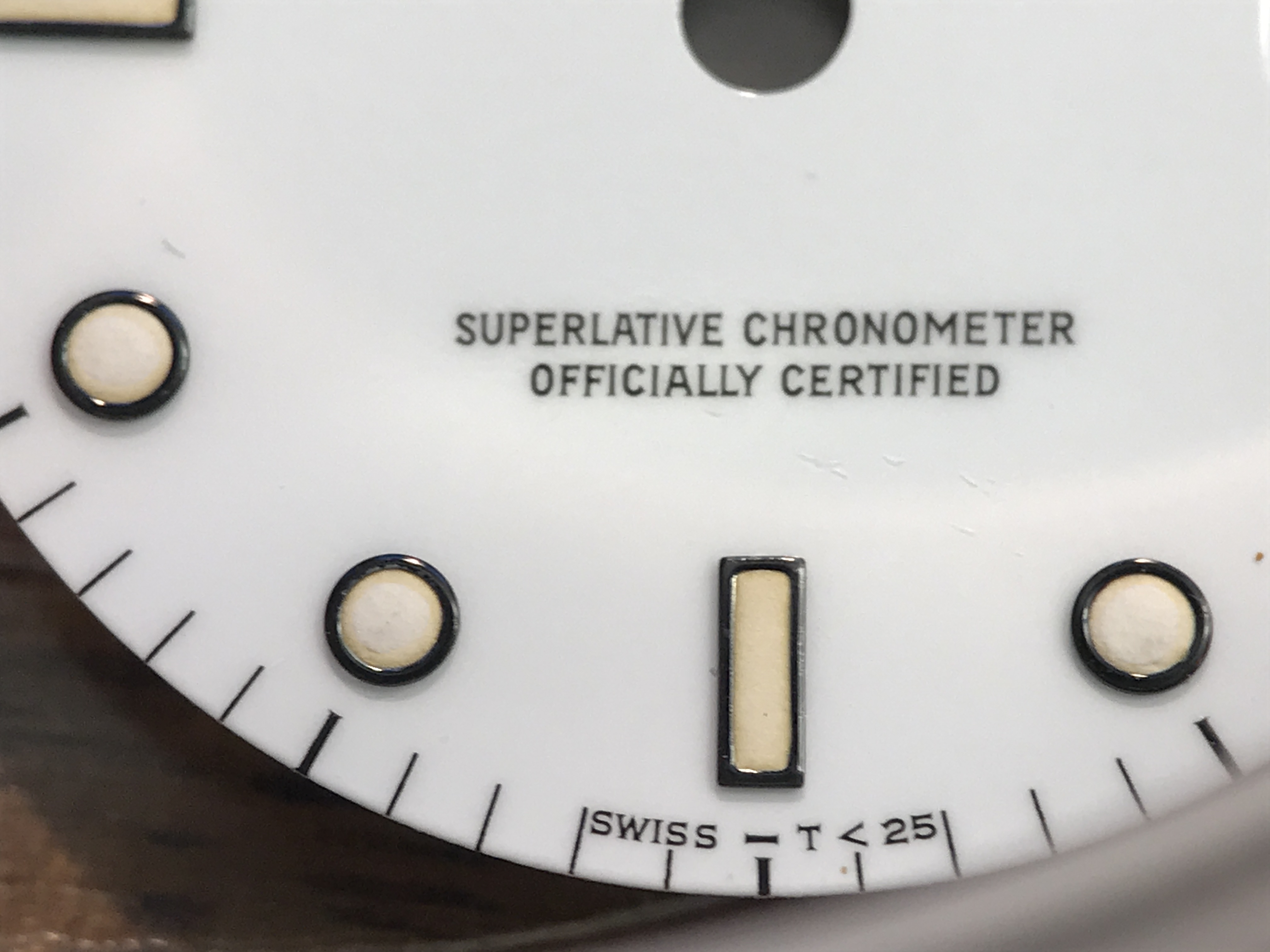

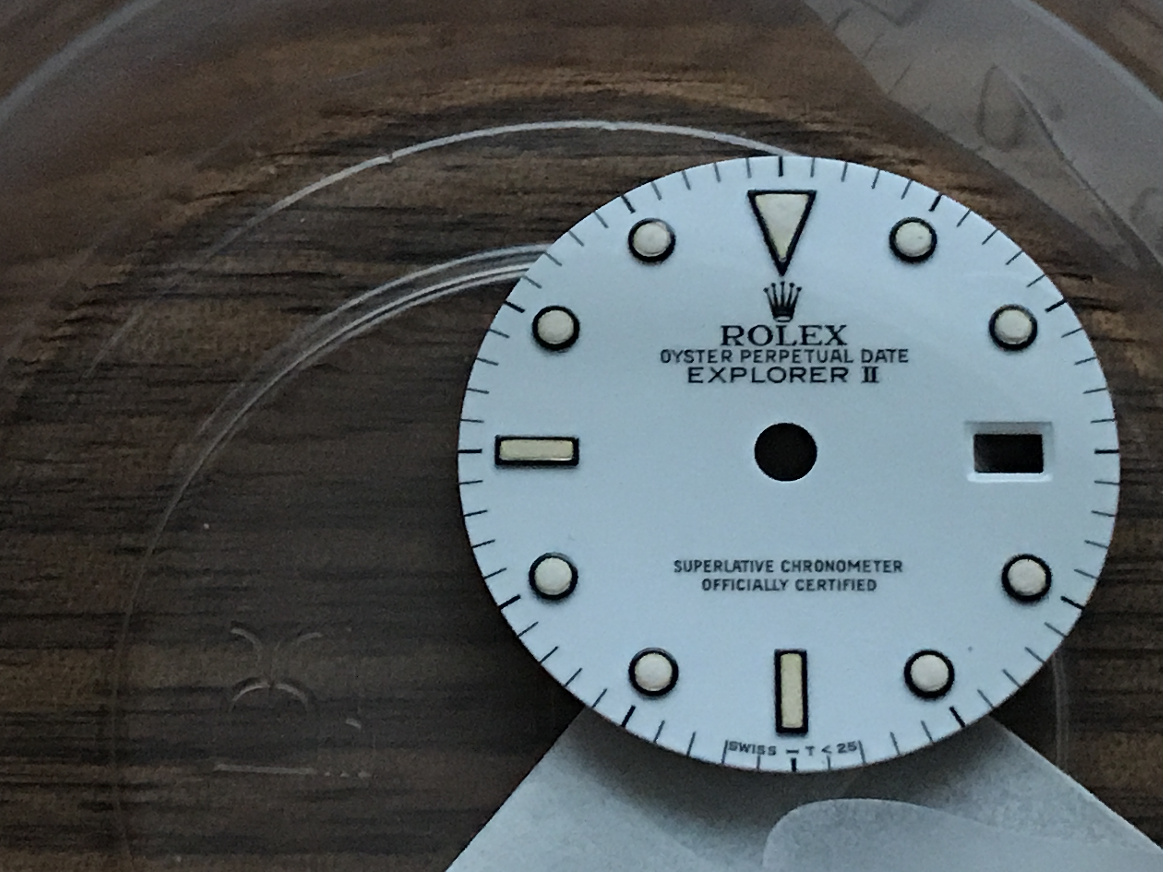

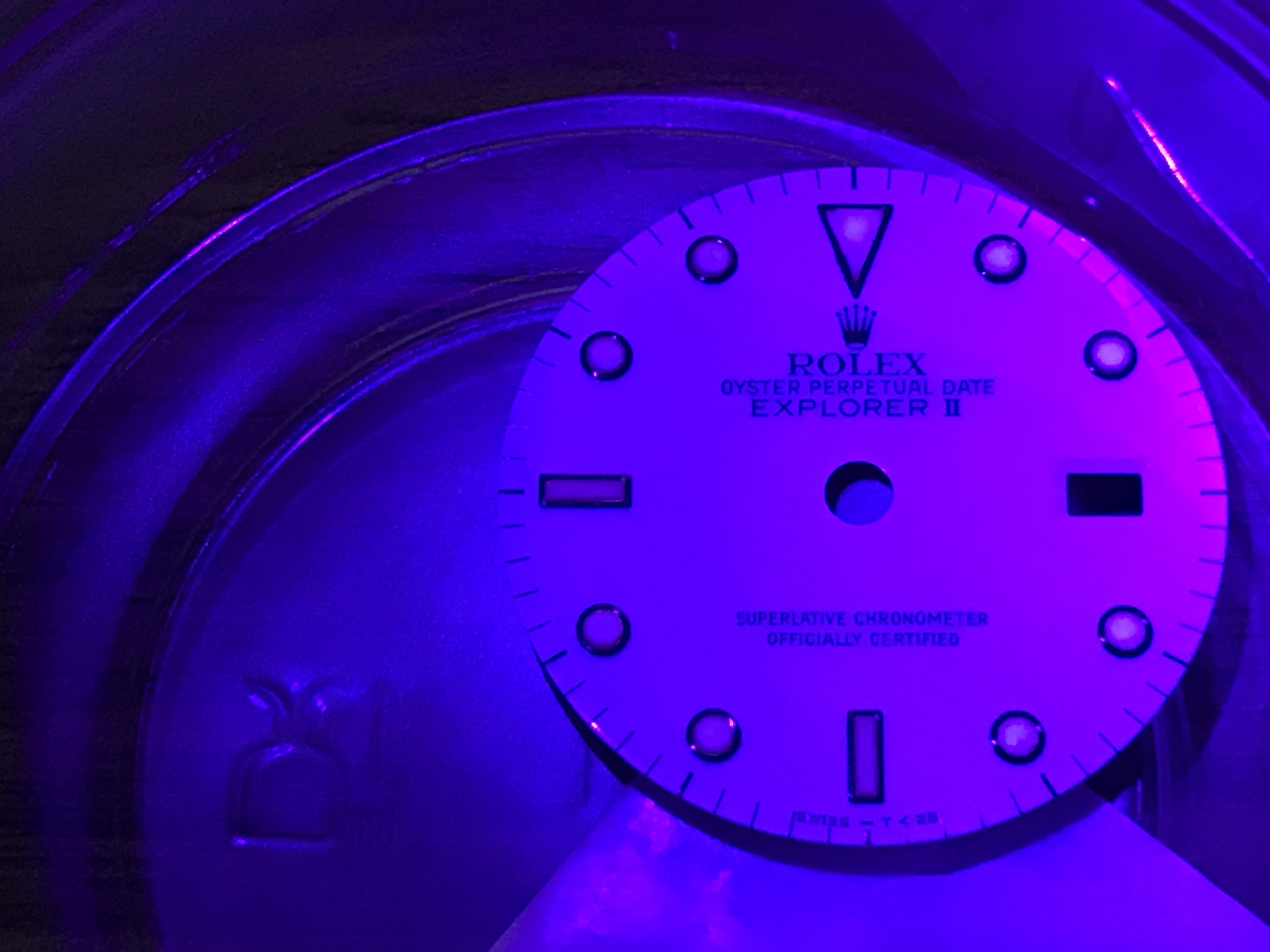

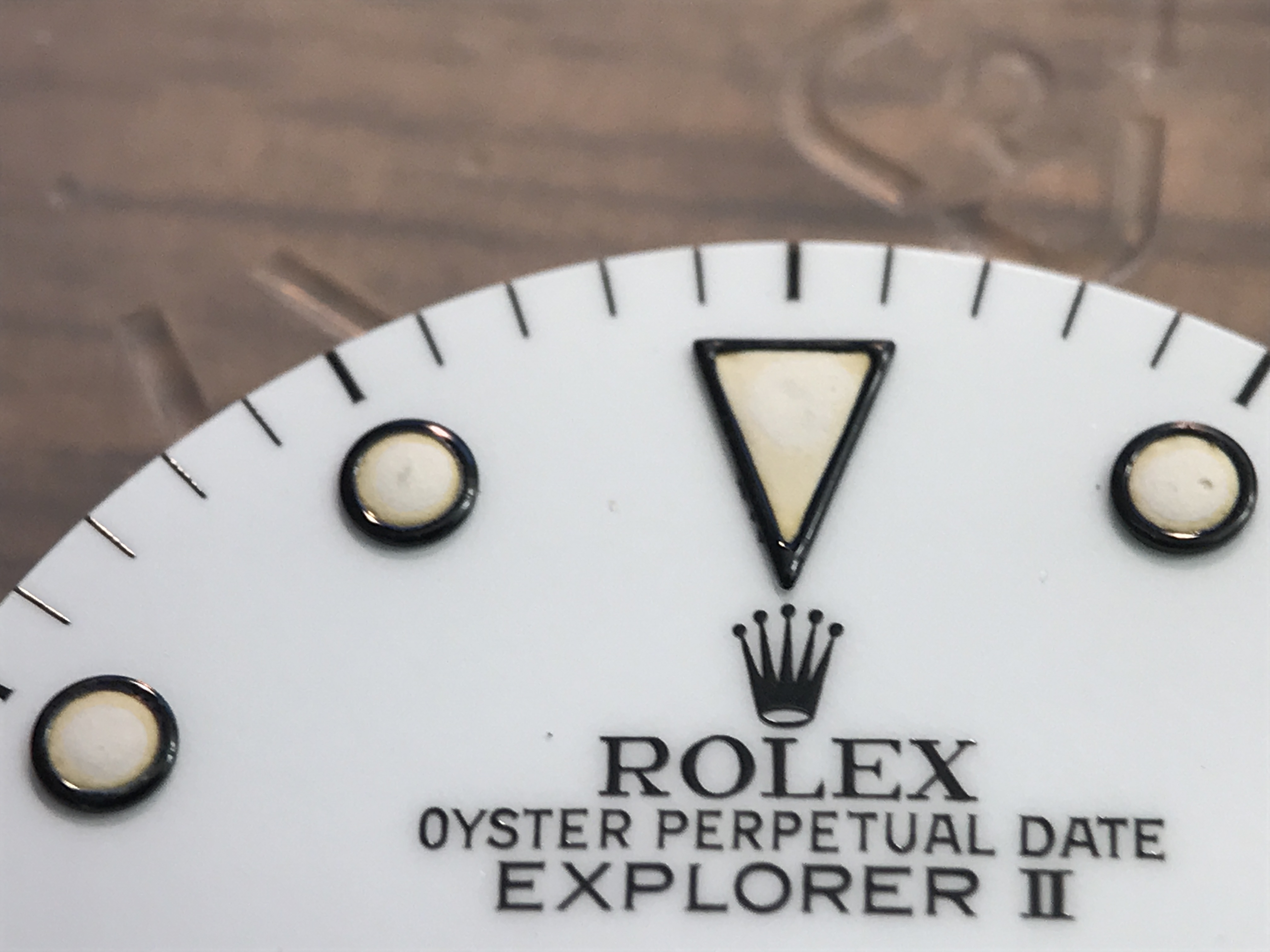

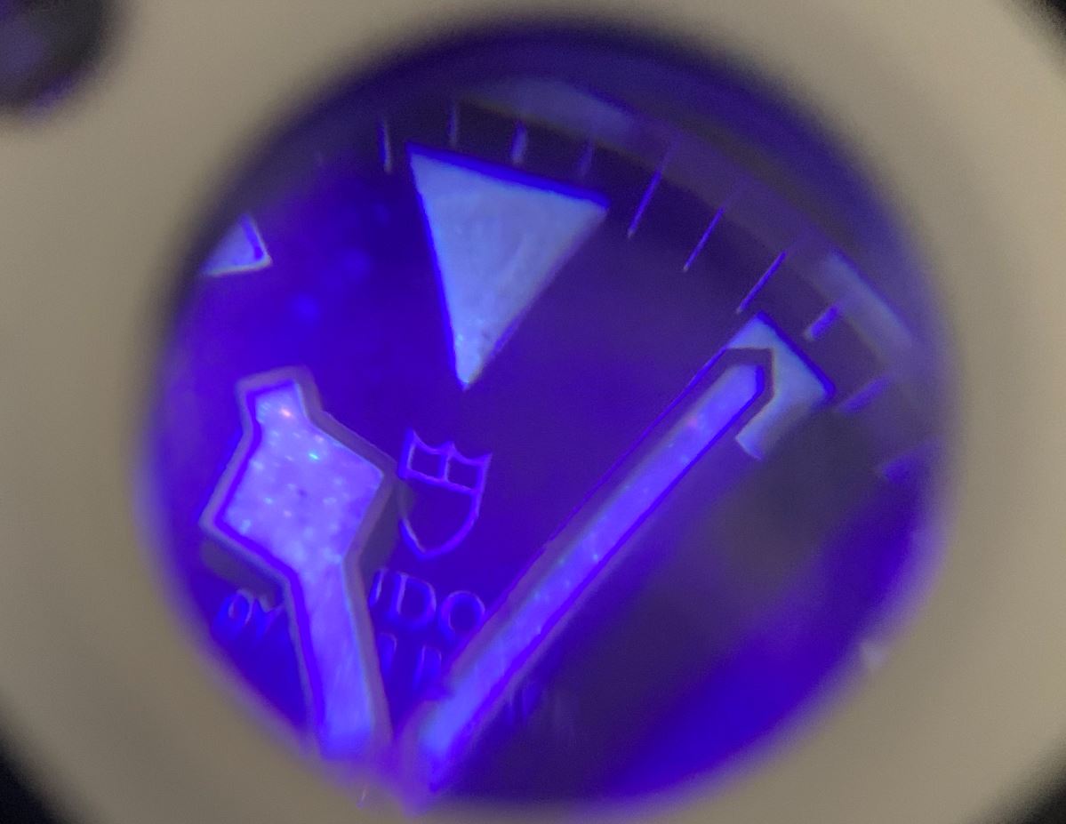

In natural light, the lume dots and triangle shows as a light beige, matt patina. Under UV light, I observed a slightly different reaction as the inner parts of the lume dots/triangle see to reflect the light.

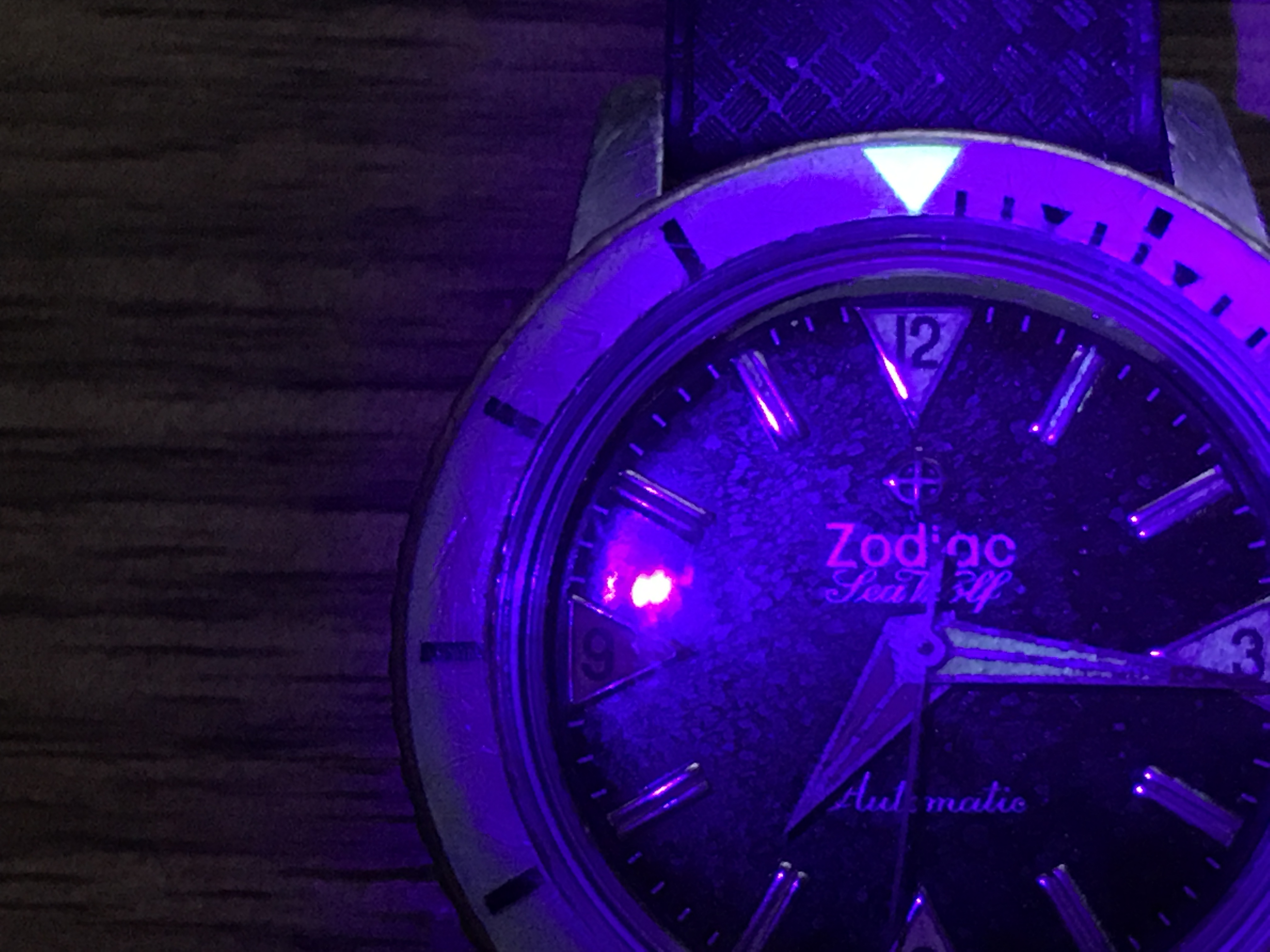

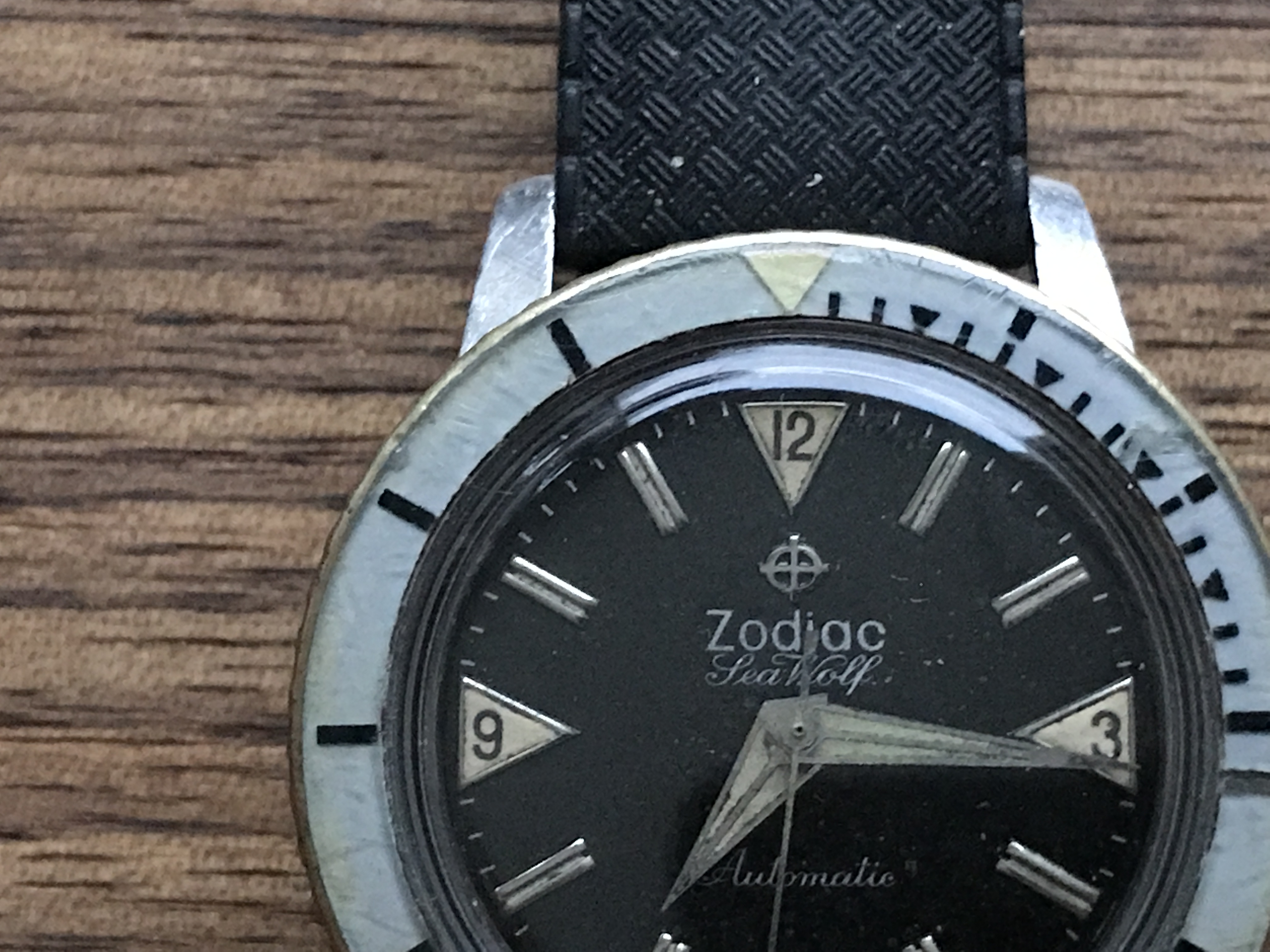

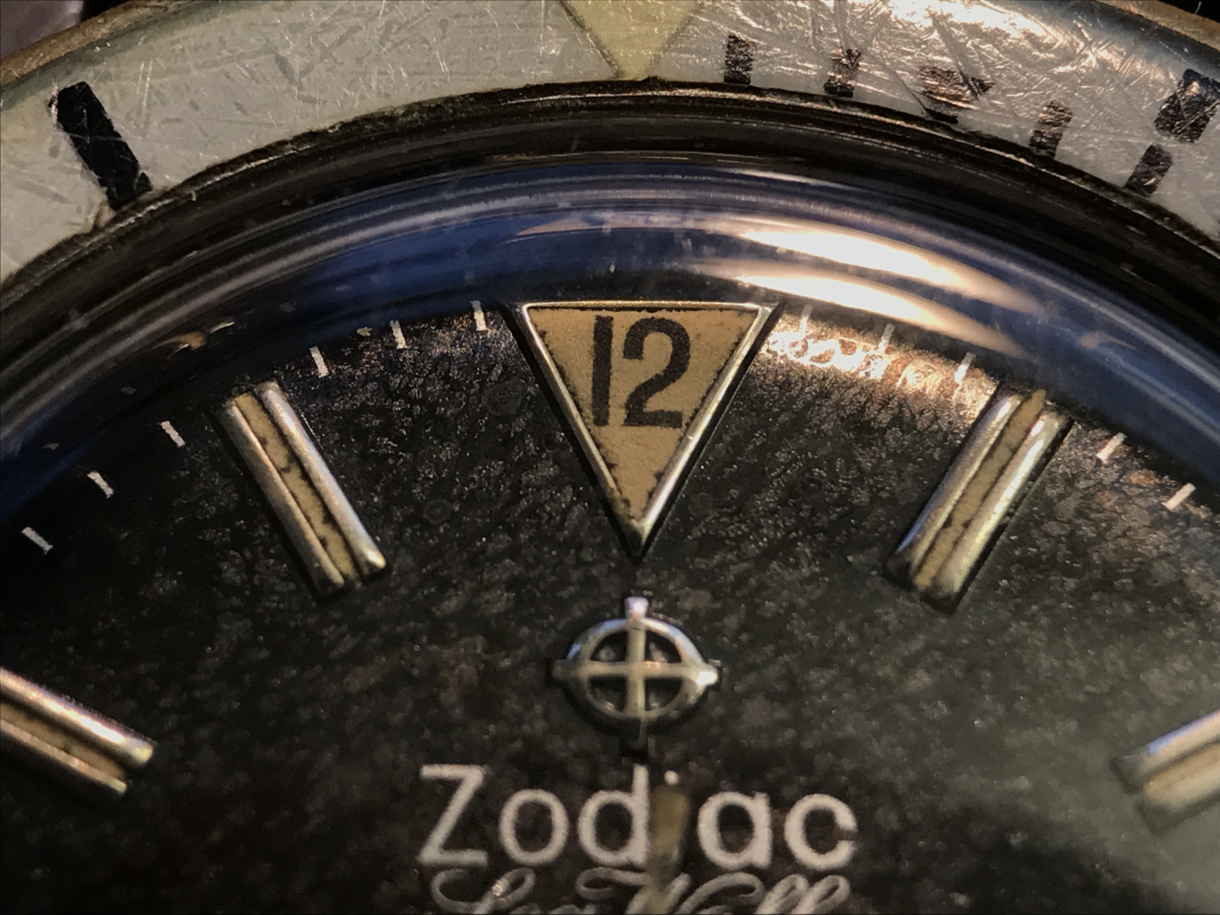

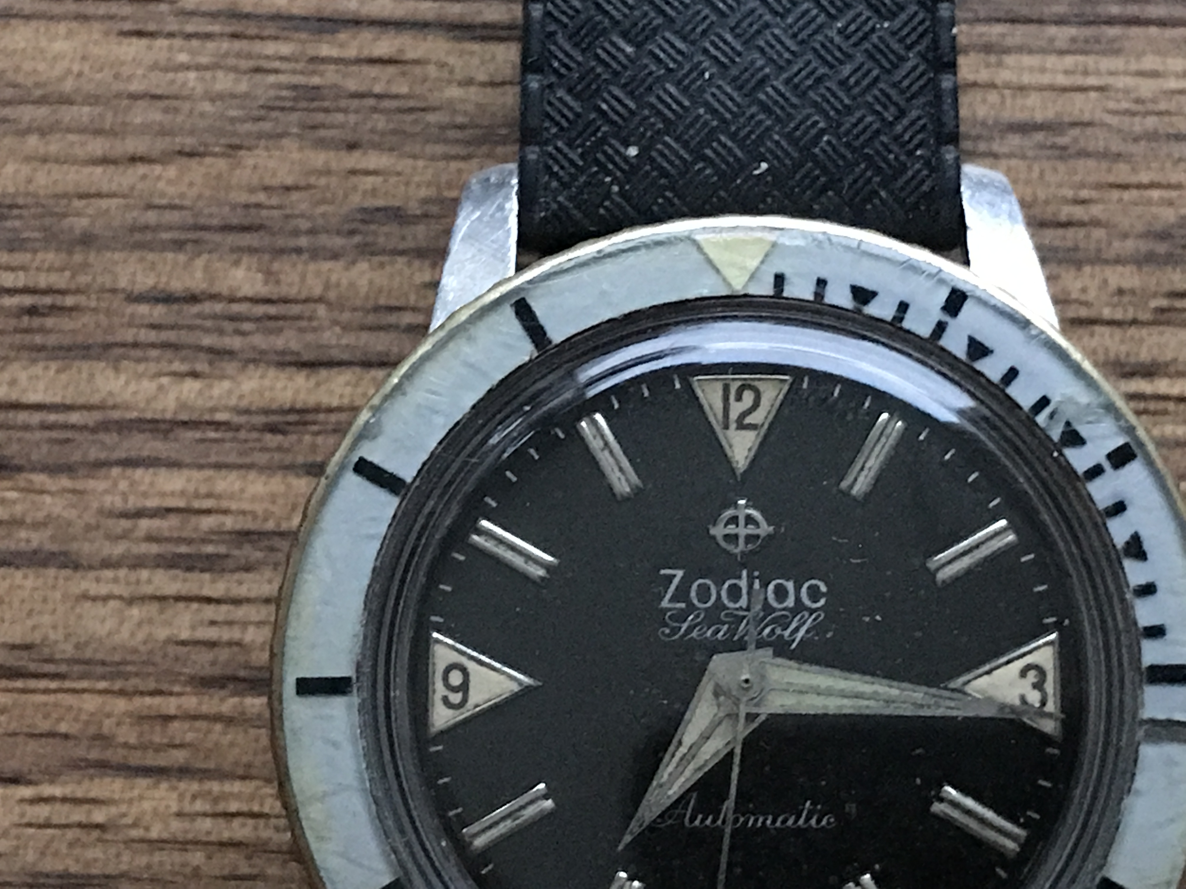

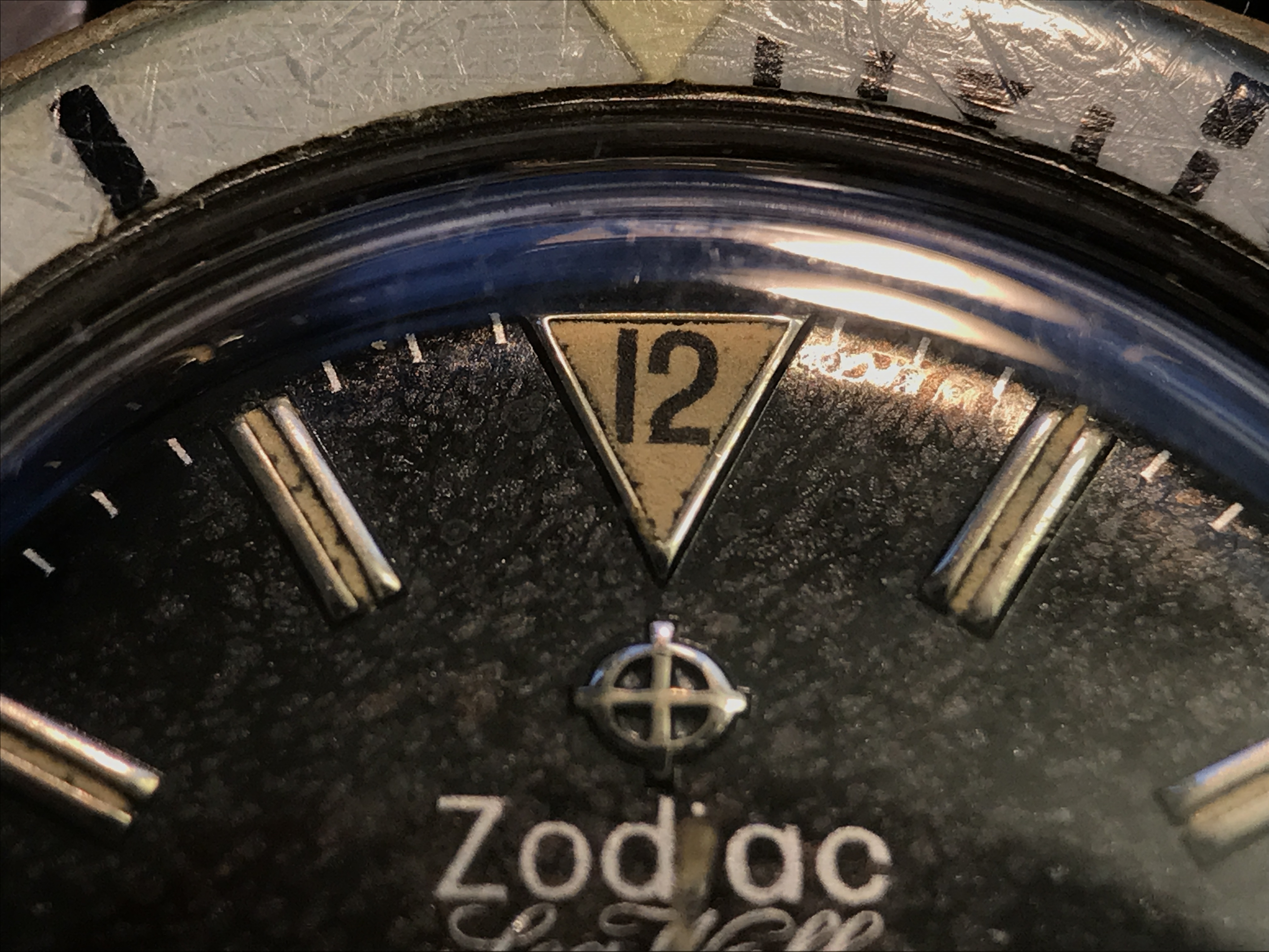

5) Zodiac Sea Wolf
I chose the Zodiac Sea Wolf for comparison since it is one of my vintage watches which do not glow or reflect under UV light. The lume triangles show heavy patina under natural light, but as I mentioned I didn’t notice any reflection or glow. (The lume triangle on bezel however glows quite strong)

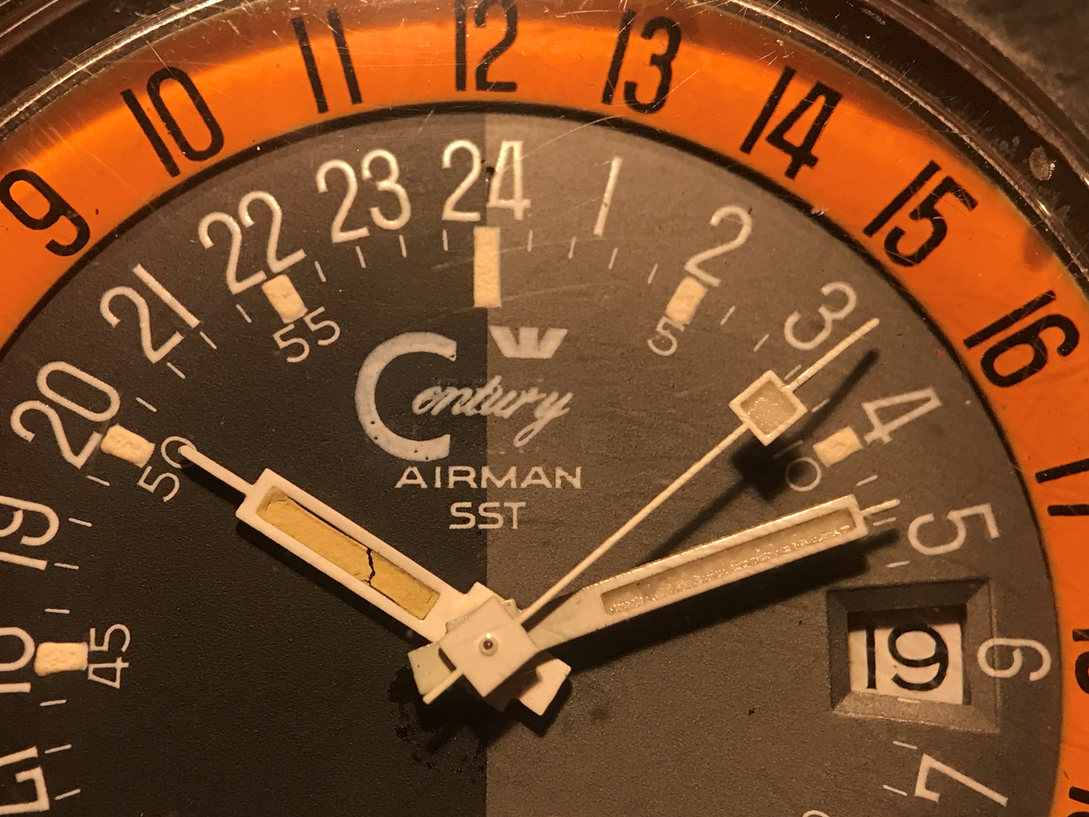

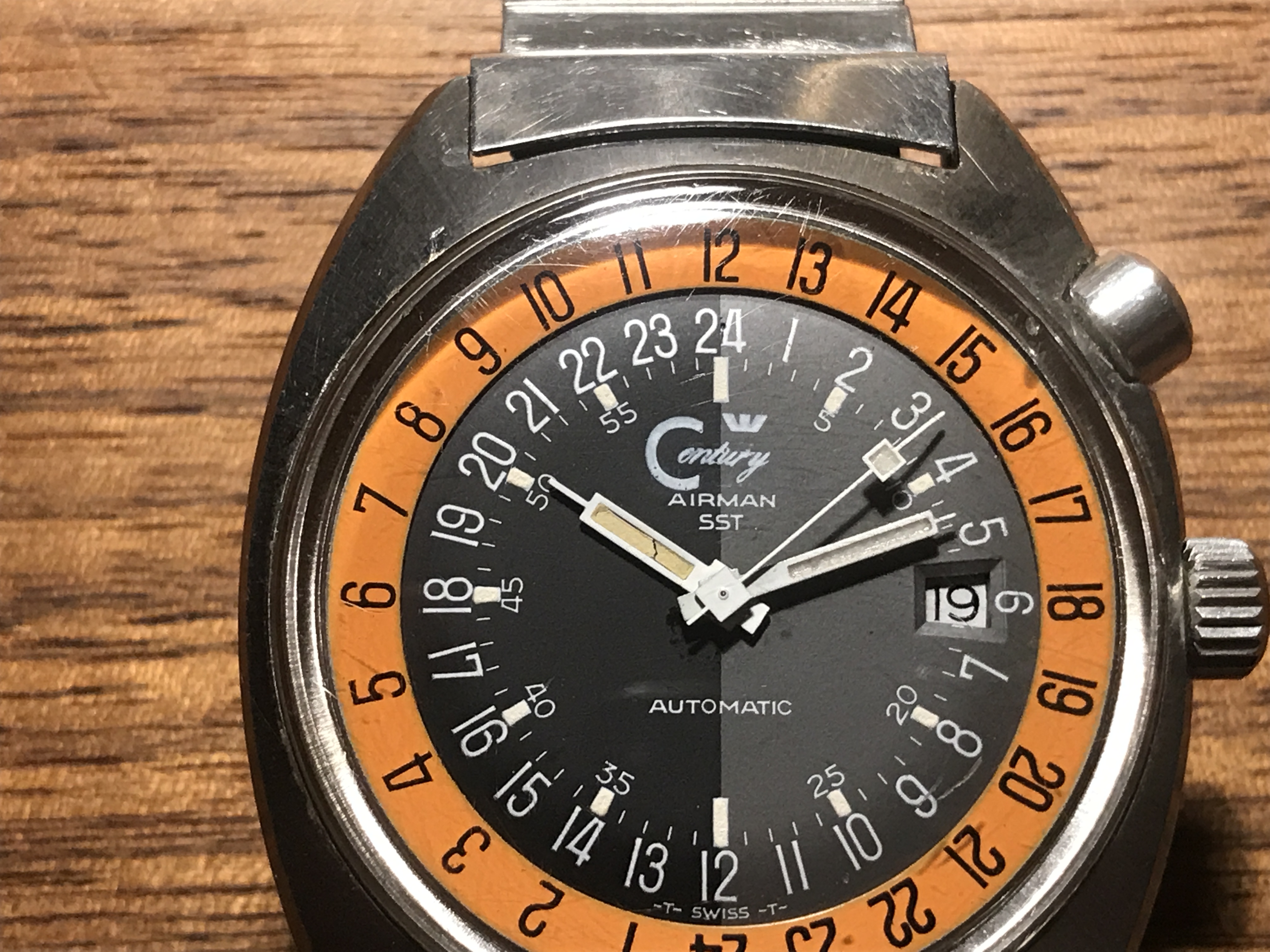

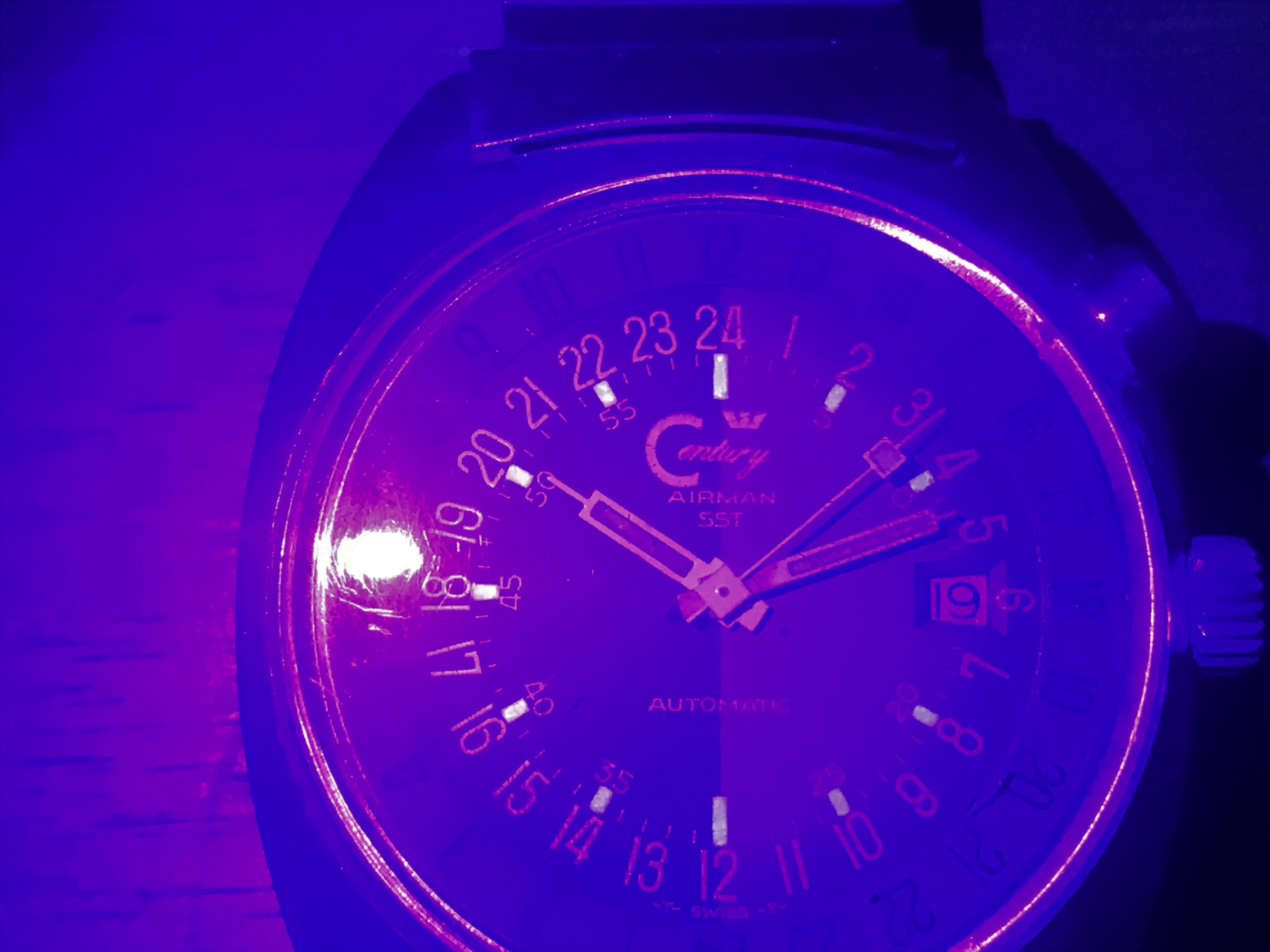

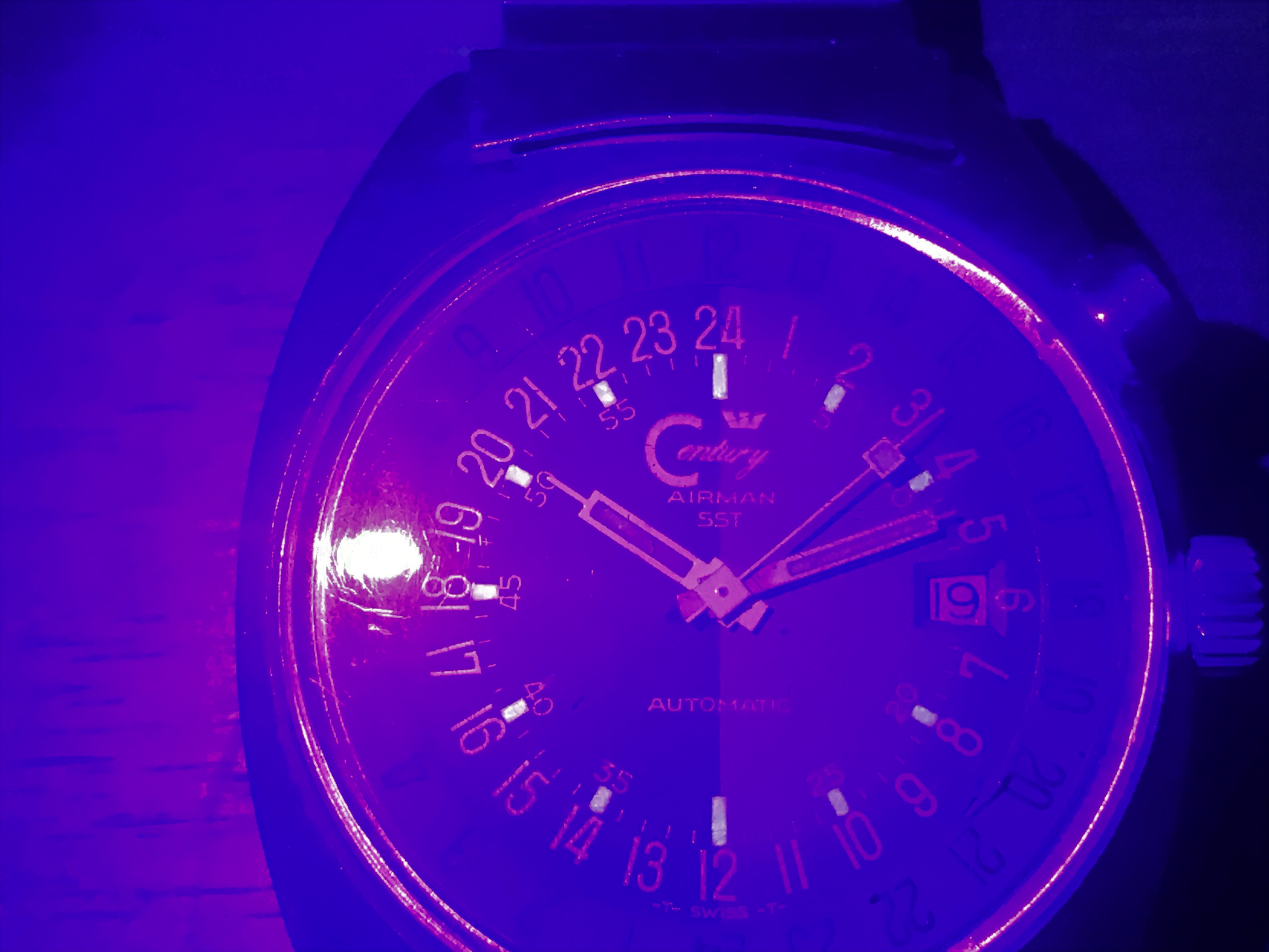

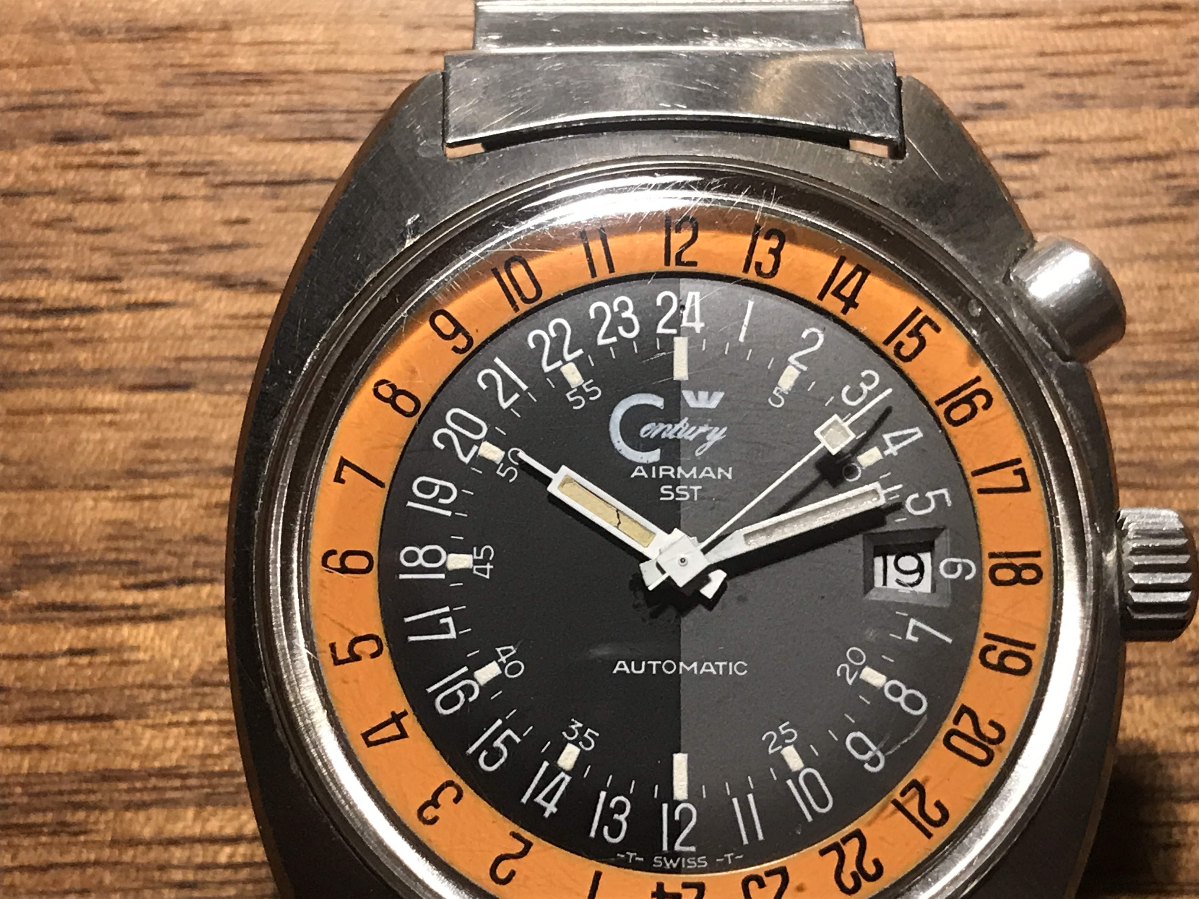

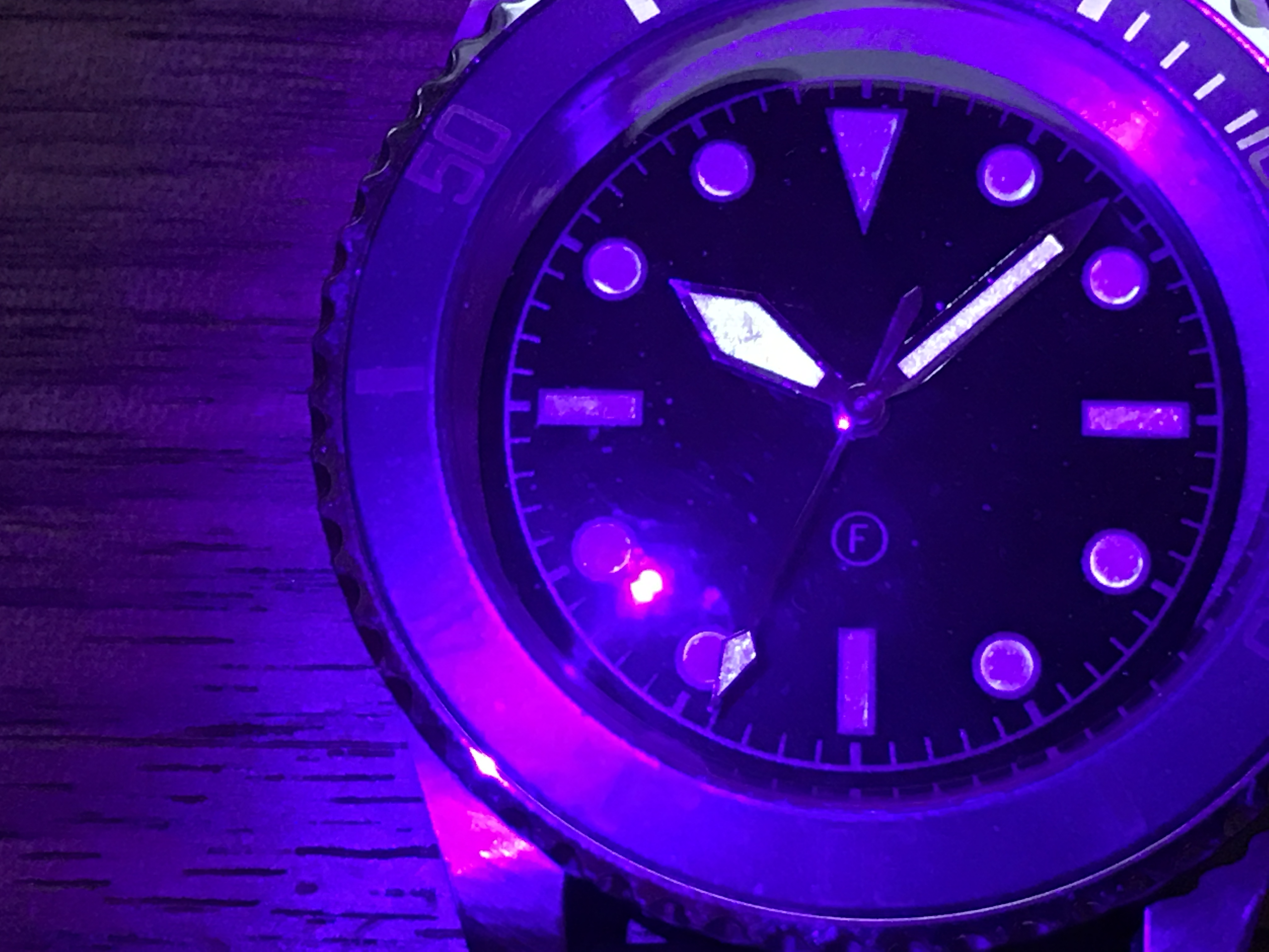

Finally there is this interesting case of a 1970s Glycine Airman SST. Upon close inspection of the hands, the minute and second hand seem to be an old relume job, while the hour hand appears to be the original, albeit cracked lume. But none of the hands reflects or glow under UV light. The lume markers do slightly glow however. It could of course be that for the reluming of the minute and seconds, a nonglowing sort of paint was used.

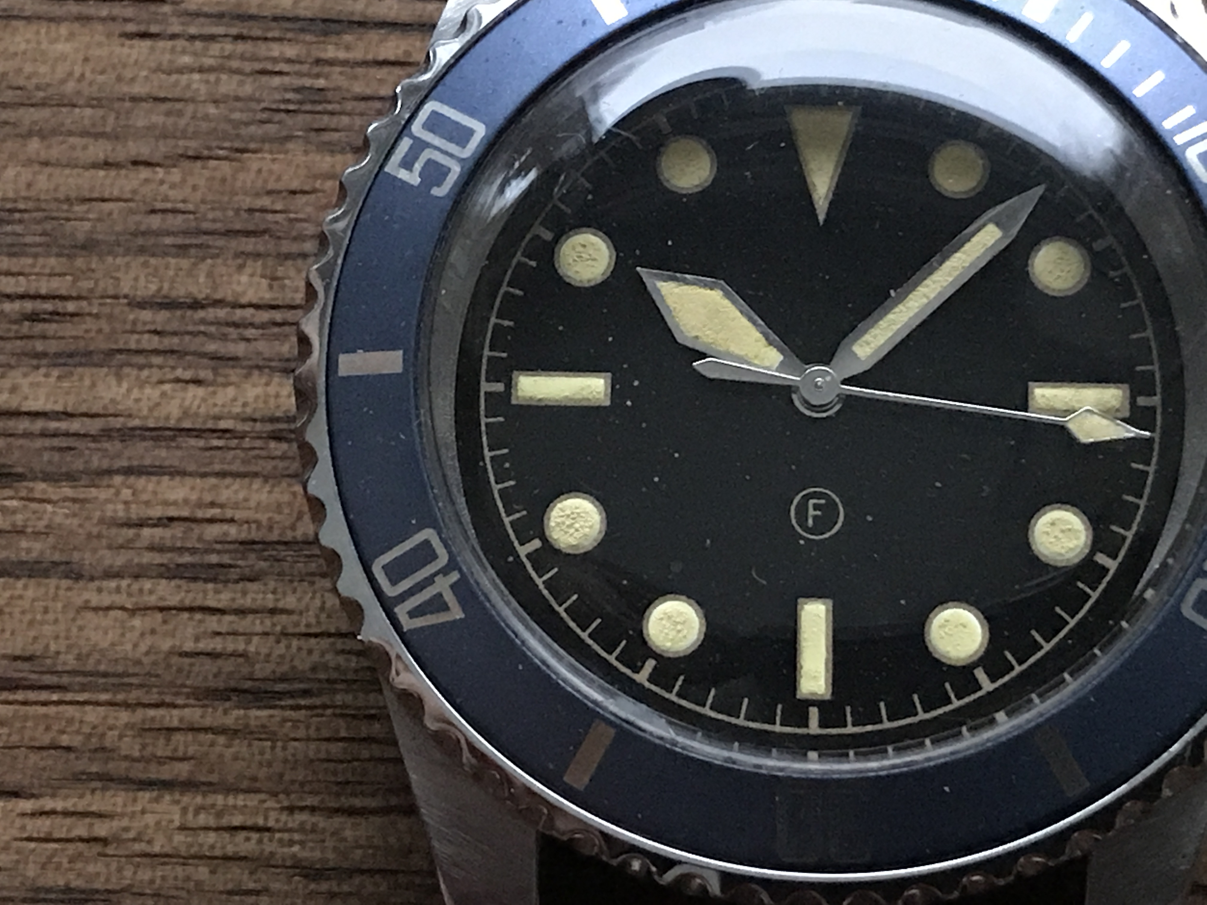

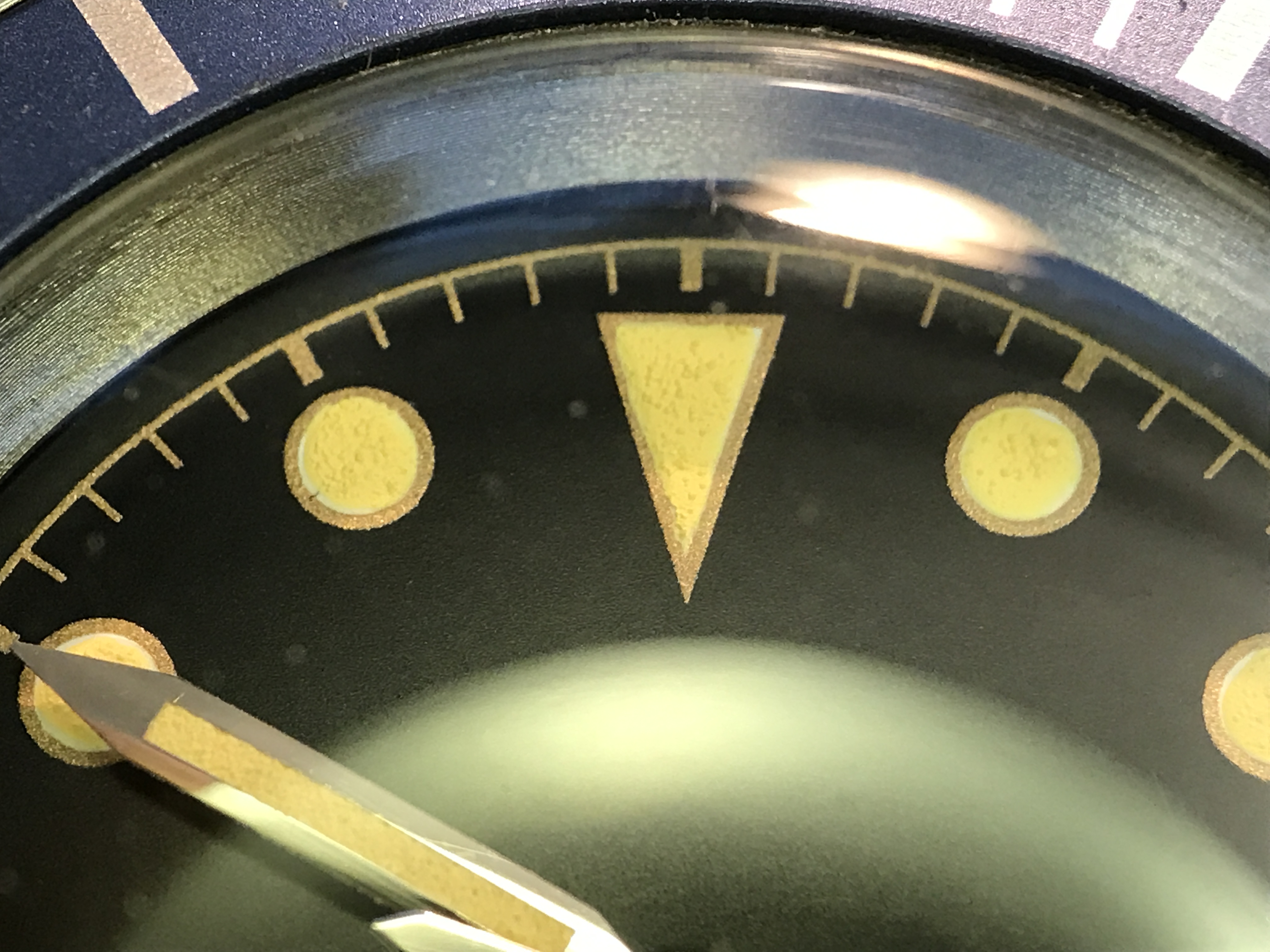

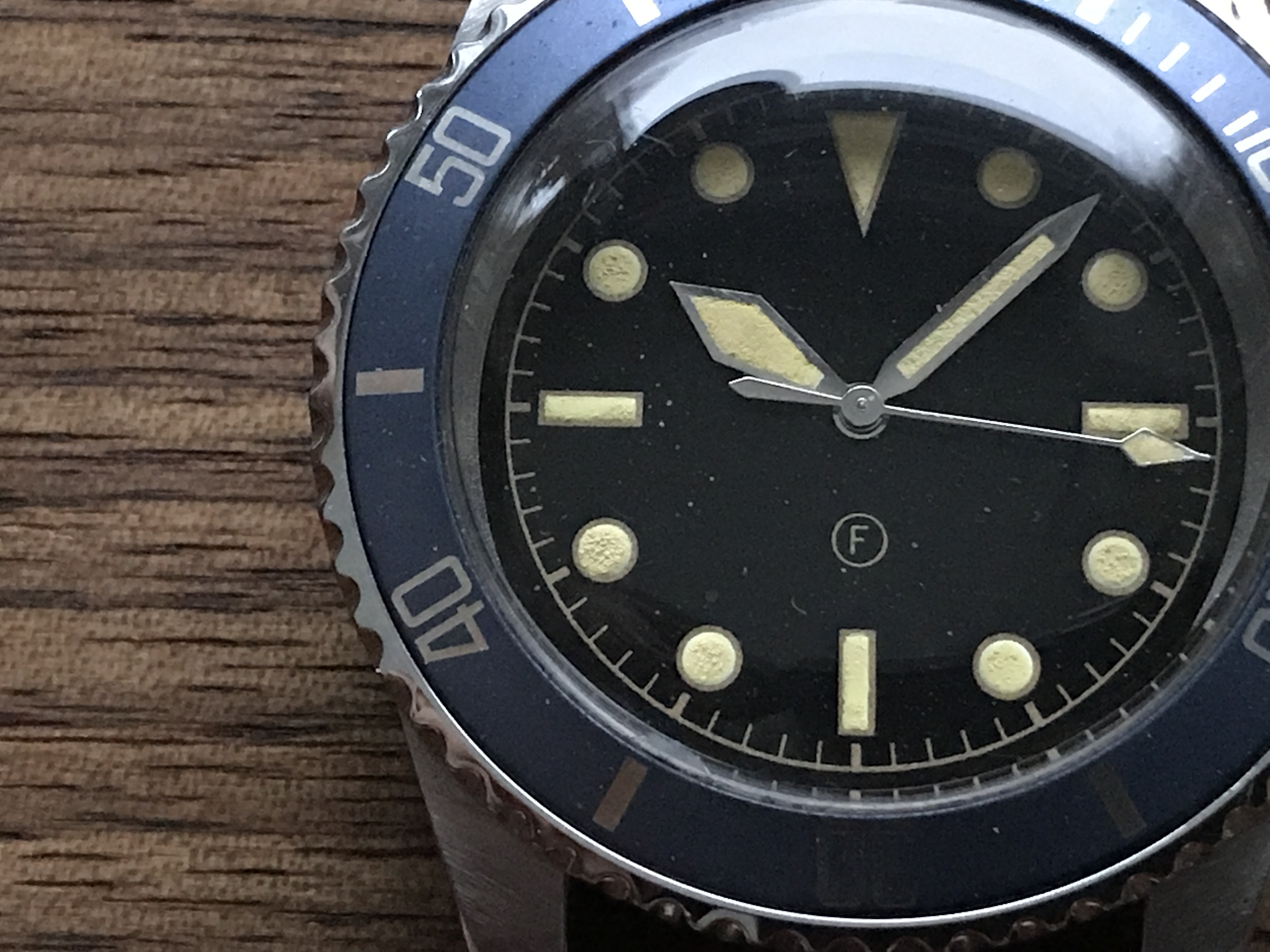

7) Freese Series 1
The lume has a nice patina but looks quite different from the other dials in daylight when inspected by loupe. When activated with UV light, the lume glows lightly.
Inspection under UV light is one of my standard inspection methods for vintage watches. But with the different behaviour of the dials inspected I am not sure how to make sense of it.
So what is your interpretation of the observations above? Or did I miss an important aspect?
I am looking forward to learning about your take on this subject.

There are two reasons lume won't lume. No more radiation, or the paint oxydizes. Tritium has a half-life of 25 years; couple that with oxydation, and you get nothing. That your UV source doesn't excite it bears this out.
The half-life of radium might as well be forever; almost always lack of lume is because of paint oxydation.
My personal experience with tritium gas tubes, about ten years is all you'll get between OMG IT'S A FLASHLIGHT to I can't see it glow any more.
My night vision is reaaaaaally good so I can see radium lume most of the time after dark adaptation. Depending on the paint, the results can be anywhere from "there's lume?" to I can read my 1910 alarm clock no sweat.
Glad you had fun with the black light but all of the results are idiosyncratic to the watches and doesn't really tell you much of a general nature.
24,810
55,147
The excitation or lack of excitation of these dials by UV is not related to tritium; it's the response of the particular phosphor formulation to UV or visible light excitation.
Tritium was the power source originally intended to excite the phosphor. Tritiated polymer binder was formulated with phosphor particles (e.g. zinc sulfide) and other minor ingredients (e.g. pigment) to make the luminescent paint. When these watches were new, the plots were luminescent all the time, even in the total absence of UV or visible light excitation since the phosphor was excited by the radioactive decay of tritium. However, since tritium has decayed almost completely after several decades, the phosphor will no longer emit in the absence of external excitation by UV or visible light.
Thus, any emission you see upon UV/vis excitation of these dials comes from the phosphor directly, nothing to do with tritium. Some phosphor formulations have degraded chemically and no longer respond to UV excitation. Other formulations still respond to direct excitation but die off after a few seconds. Yet other formulations die off partially after a few seconds, and then have a residual emission for several minutes. Different manufacturers used different phosphor compounds and formulations, and even changed them over the years. Rolex, in particular, changed their formulation significantly over time, from the 60s to the 70s to the 80s. Thus, knowledgeable collectors are well aware of how Rolex phosphors made in different eras should respond to UV light, but they're not always eager to post this detailed information on public forums, for obvious reasons.
In the absence of this detailed knowledge, the most you can do is look for consistency between all of the lume on the dial and hands. Often you will see that one hand, or one marker responds differently, which gives away a relume. If the entire watch and hands have been relumed using paint that incorporates material recovered from old watches, then it will be quite difficult for you to detect the relume unless you have done tests on many similar watches.

Just to elaborate a bit on Dan's good explanation, if UV excites the lume and it persists an hour later, that is almost for sure a relume using Luminova or its Japanese equivalent, whose name I don't recall.

Why is the freese101 watch not lighting up... I could have sworn they used vintage colored luminova...
946
2,081
Also don’t forget that not every uv lamp uses same intensity and wave length.
Yes the freese one is disturbingly dead but i don’t know what basis is used as lume.
It actually lights up, but not so strong. you can see that from picture i posted, the hands glow quite bright, but the lume dots less.
199
827
i might buy another UV lamp, as they are inexpensive, and look at the results again

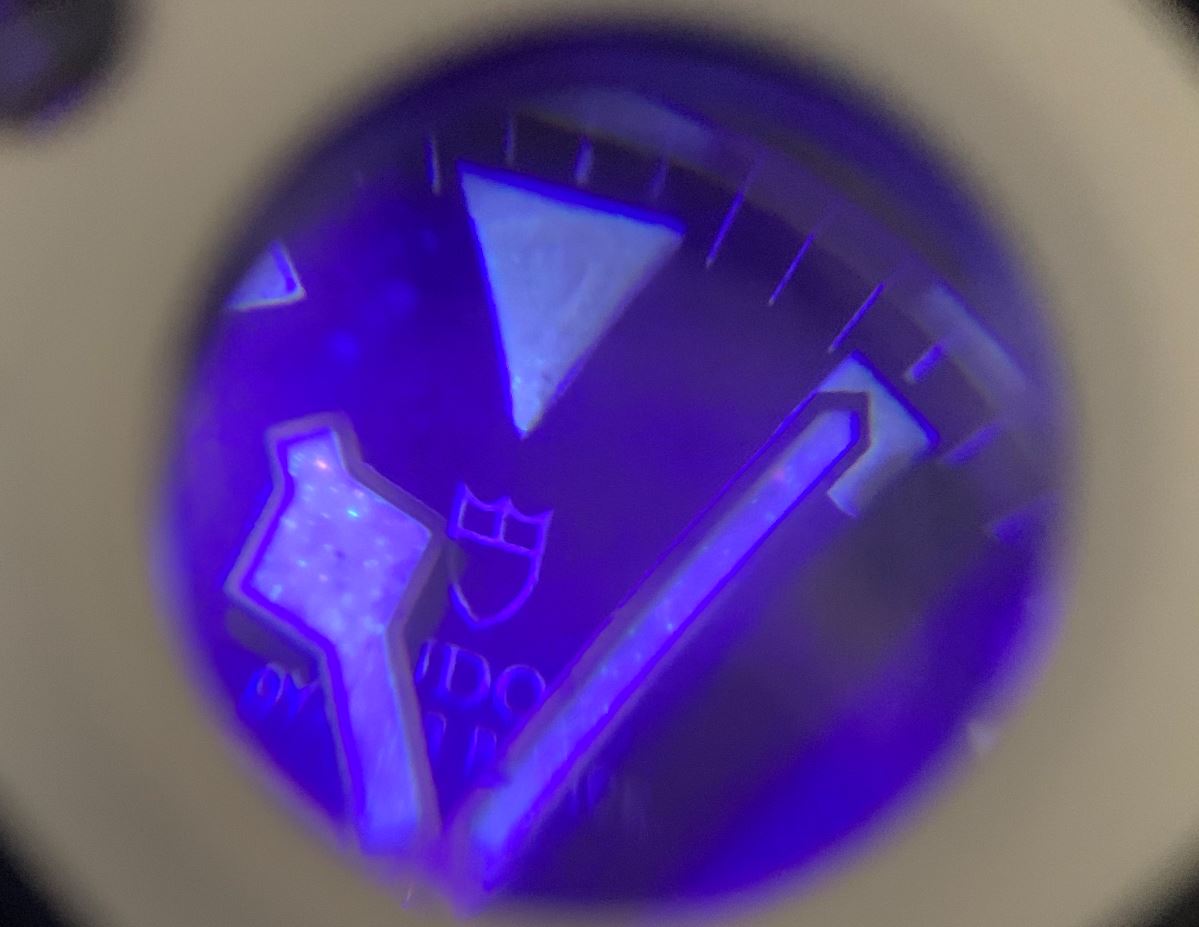

OP - you need to MAGNIFY and UV.
I can't speak for vintage Rolex, but as long as the remaining paint/phosphor/tritium compound is still in good overall condition (I.e. Not degraded to green mush due to moisture ingress) vintage Omega tritium dials from the 60's/early 70's always exhibit glow when excited by an external source such as a flashlight in my experience.
This may be feint but in original Omega dials from this period it's always there.
I believe Rolex / Tudor / Omega used the same Lume compounds at some times, particularly the 66-69 period Rolex / Tudor / Omega lume looks very similar under UV and BIG magnification, they are also more likely to develop the same fungus in that same time frame. Remember back then outside dial manufacturers made the dials to the watch manufacturer's spec and likely sourced the lume compoiunds that were swiftly changing between 60 thru early 70s.
