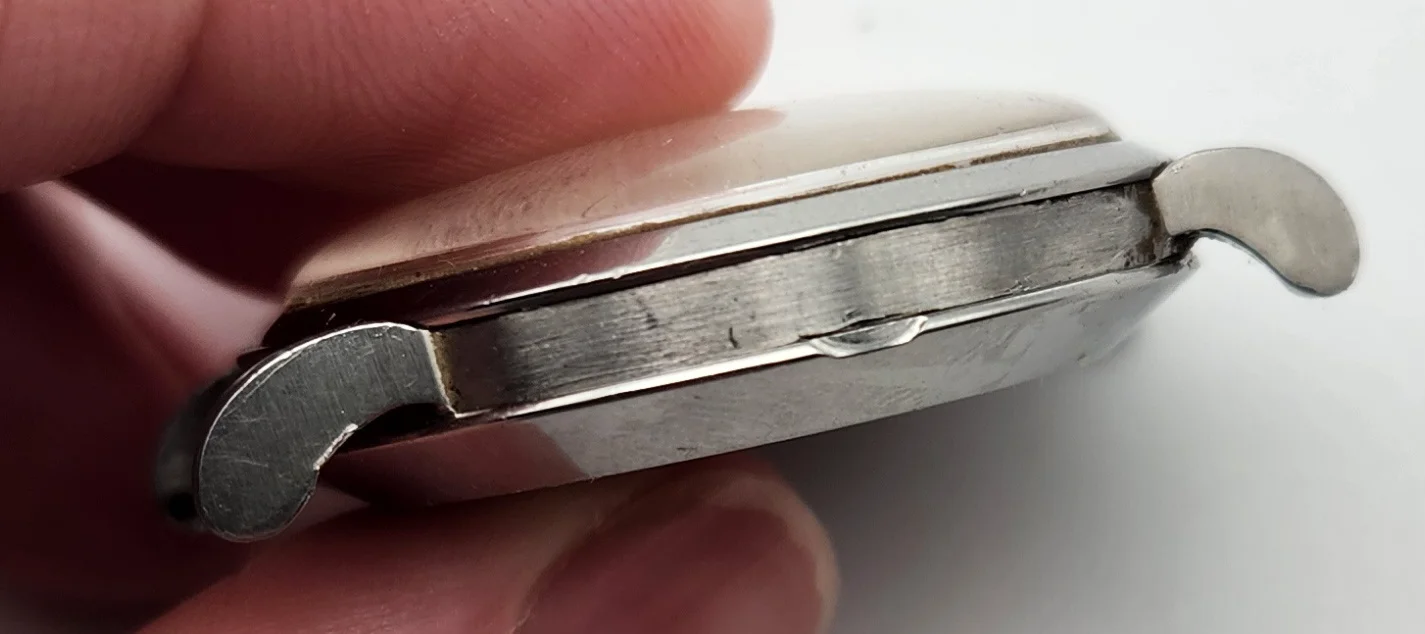

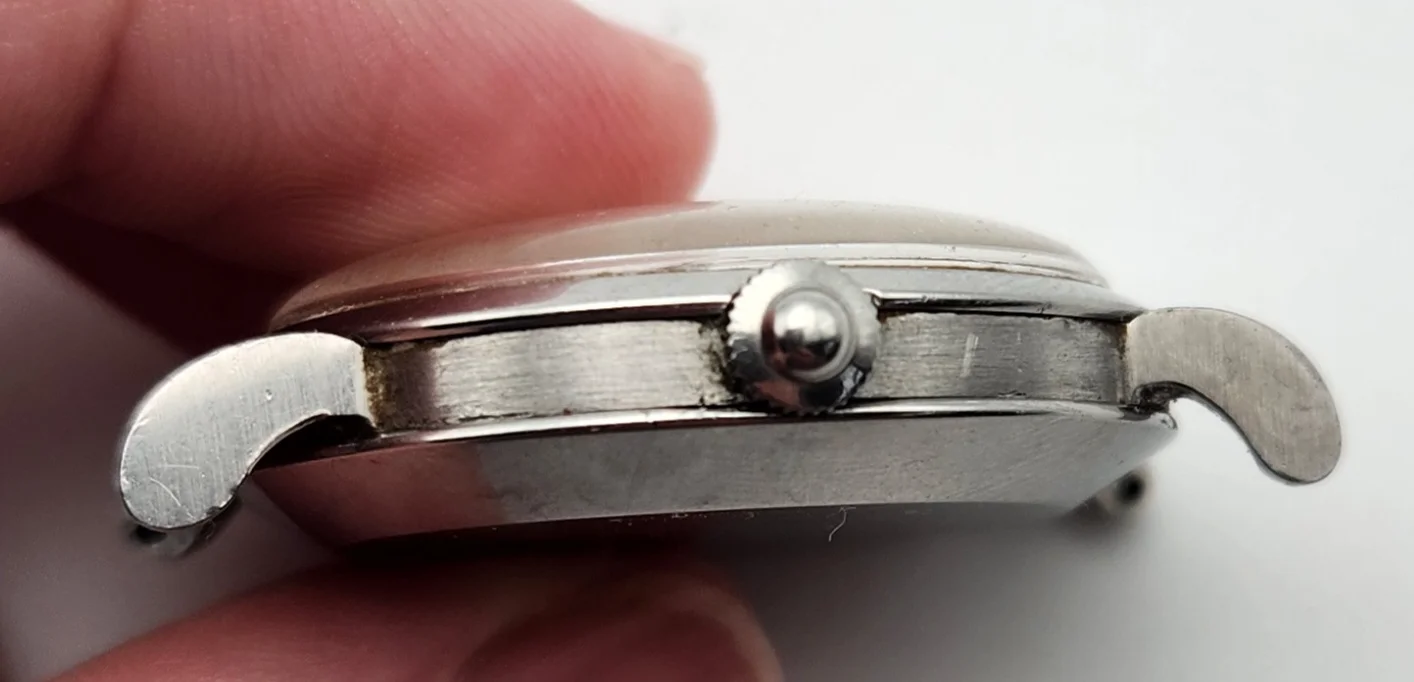

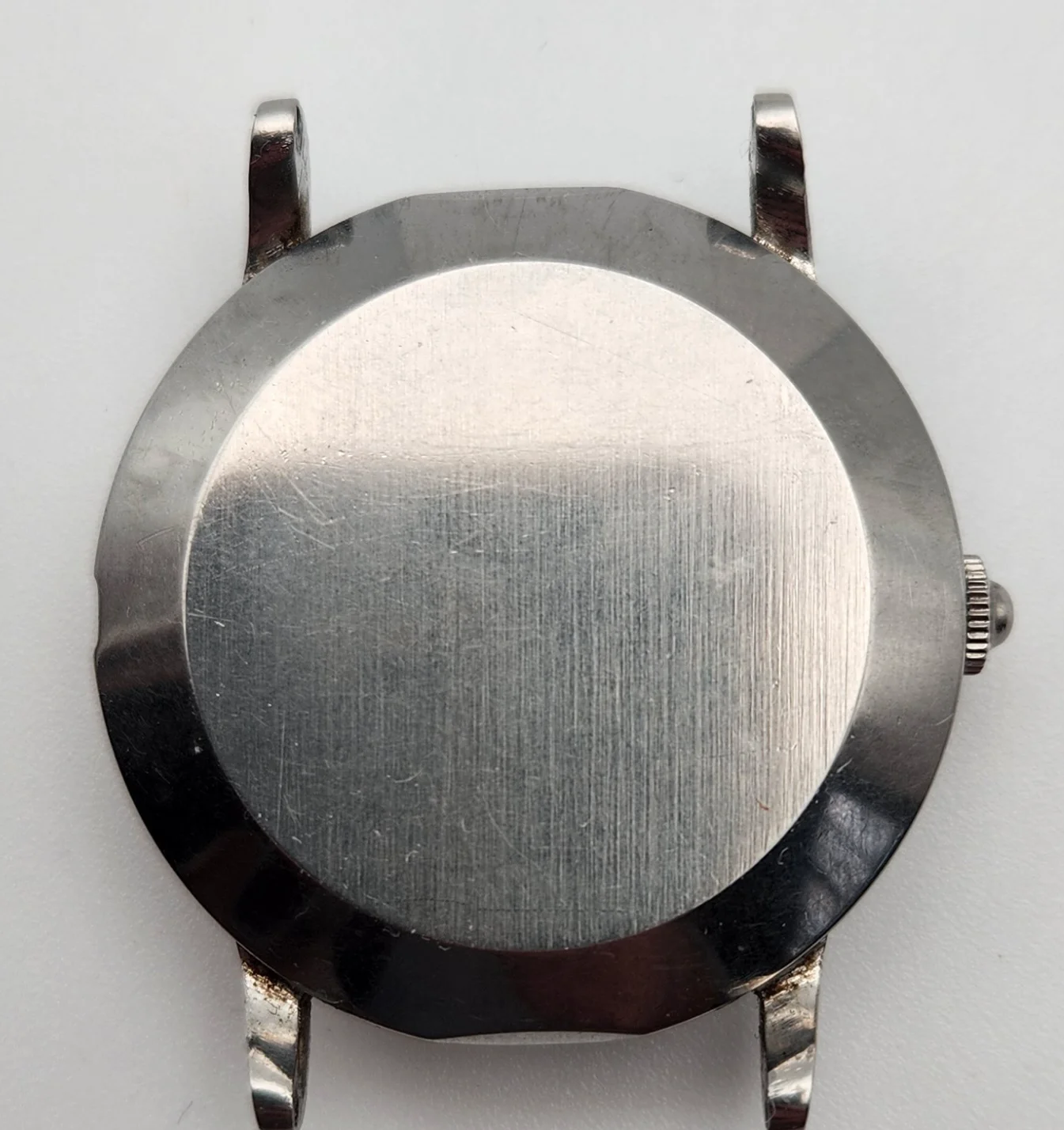

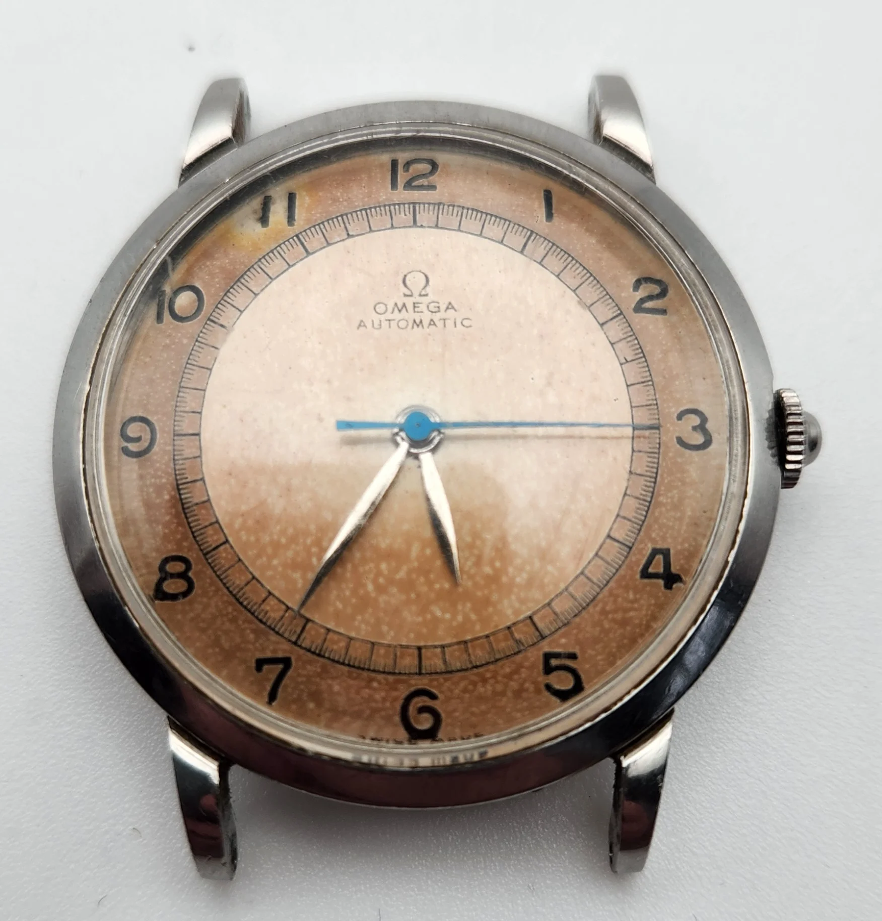

Recently picked this up and it's all original in great condition. It is a bumper and measures 32.5mm. However I can't get the back off. Whoever put the cashback on did so backwards so the notch for a tool is behind the crown and leaves no space for a tool to slide into to open it. I fear I may scratch the case as I have already left a small nick behind the crown trying to open it! Any thoughts?
30,308
78,239
It's a press on case back. To remove it, you need to insert a blade into the gap between the case frame and the case back, and use that blade as a wedge to lift off the case - do not pry - that is a sure fire way to scratch up the case back. If you are in doubt, take it to a good watchmaker who can open it for you.
Note that your 3rd and 4th photos show that the case back is currently installed incorrectly, and when it is pressed back on, should be rotated 180 degrees from it's current position. That cut out that is visible in the 3rd photos is actually clearance for the crown, so should be on the opposite side of the case.

The problem is that I can't find a good spot to wedge a tool into to pop the back off because the caseback is installed improperly... I'll have to give it to my watchmaker

I got a $30 Swiss Army knife and blunted the blade down so I don’t cut myself. This I use for casebacks like this and removing strap spring bars. Works very well. It has a thinner edge than a caseback tool.

Start with a razor blade to get a small gap before using a caseback opener.
If you can access one, scalpel is an even better option. As sharp as a razor blade, but more heft.

Gap for back is currently to the left of the crown. Bezel is to the right

I have a collection of old master and visa cards which I have sharpened one end and use that end to wedge between case back and case.
I then get the case and hold it in a thick cloth, enough to get a good grip and to protect my hands from the sharp part of the card in a firm position.
I then get a small jewelers hammer and give it a firm tap on the flat edge of the card to get enough inertia between case back and case.
I find this works 9 out of 10 times as the card may not always work due to getting blunt. You can try to sharpen card edge if you are short of cards. I have never scratched a case using this method.
One of the very reasons I keep away from snap on case backs as you always run risk of scratches no matter how careful you are with ordinary case opening blades. I call them air cooled cases. If you have old credit cards lying around the house and you are confident, give it a try!!!
