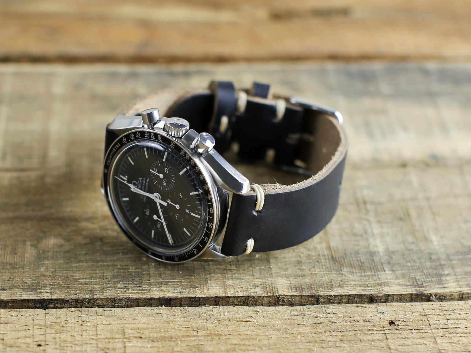

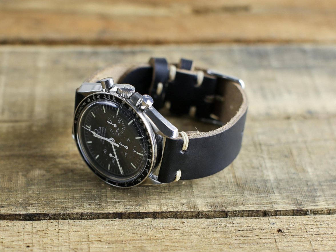

I only have the original bracelet and a leather rally strap as of now for my Speedmaster, but may pick this one up next:

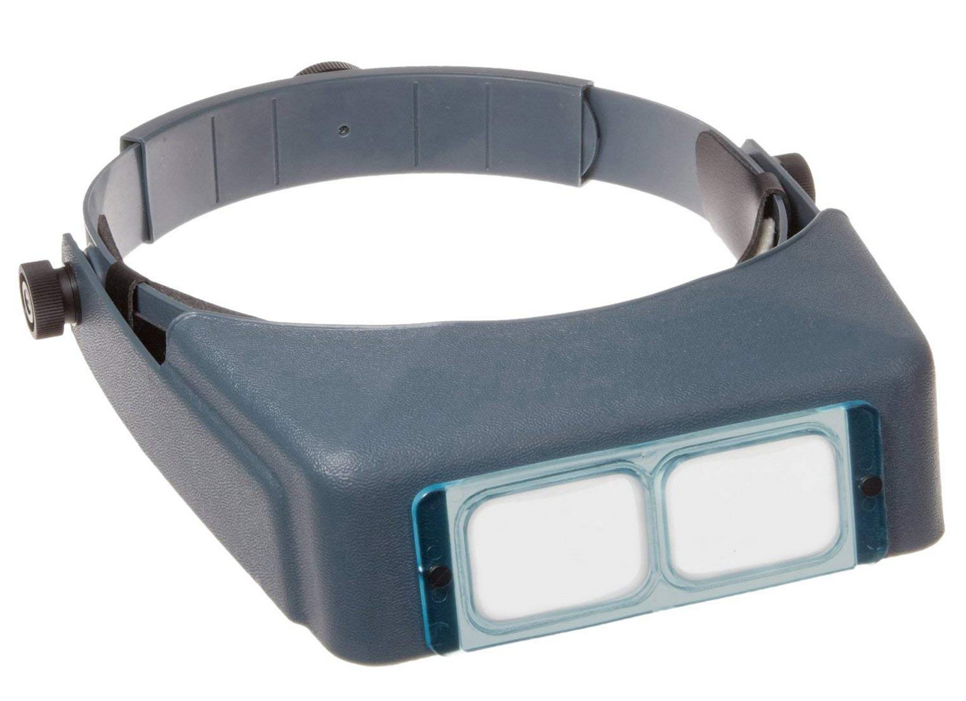

No substitute for a good tool, a magnifying visor, and above all ... practice, practice, practice.

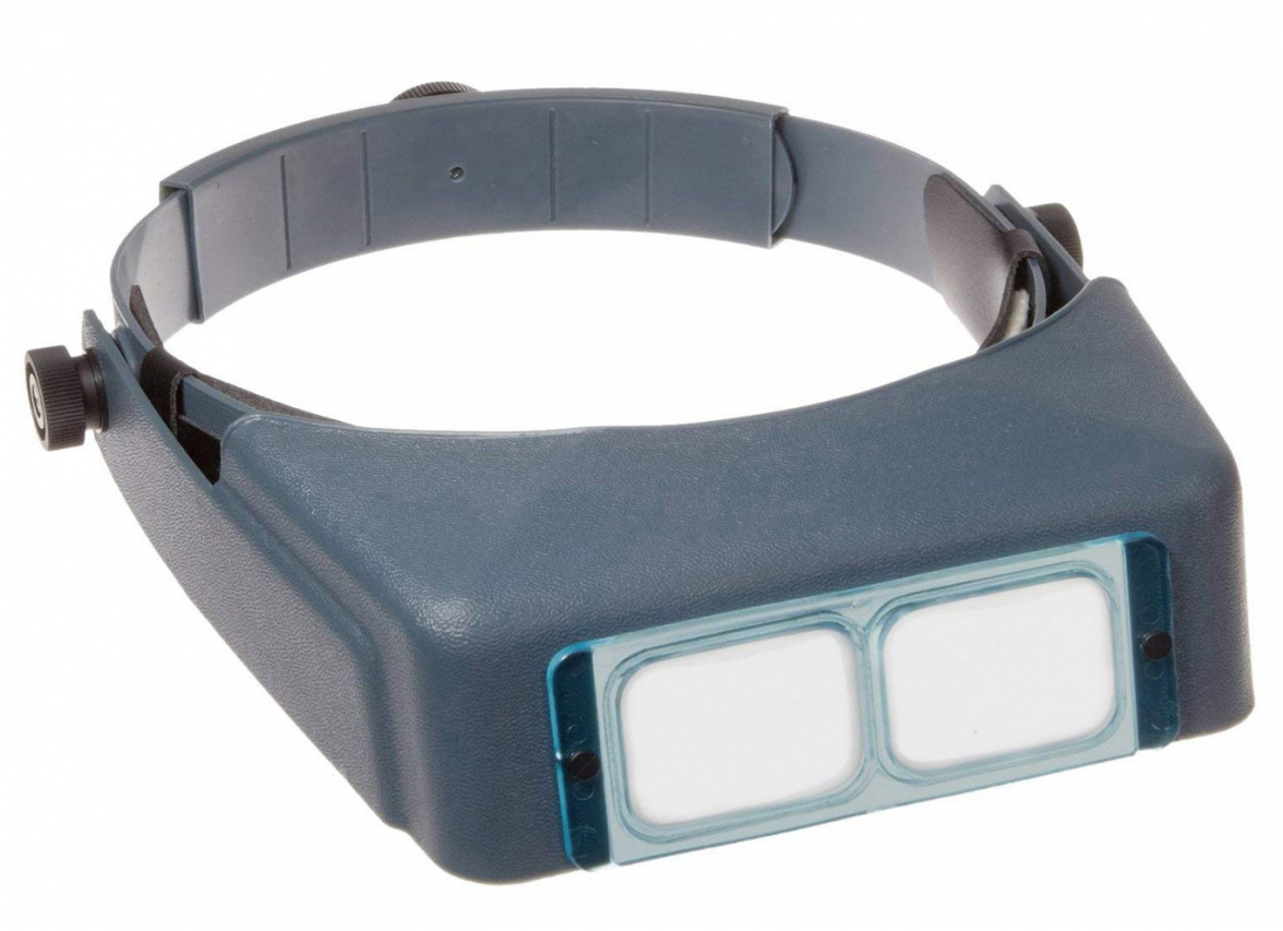

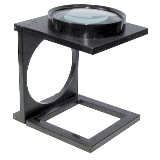

Ohhh the magnifier is the key
Got one of these cheap magnifiers to start. So far so good
