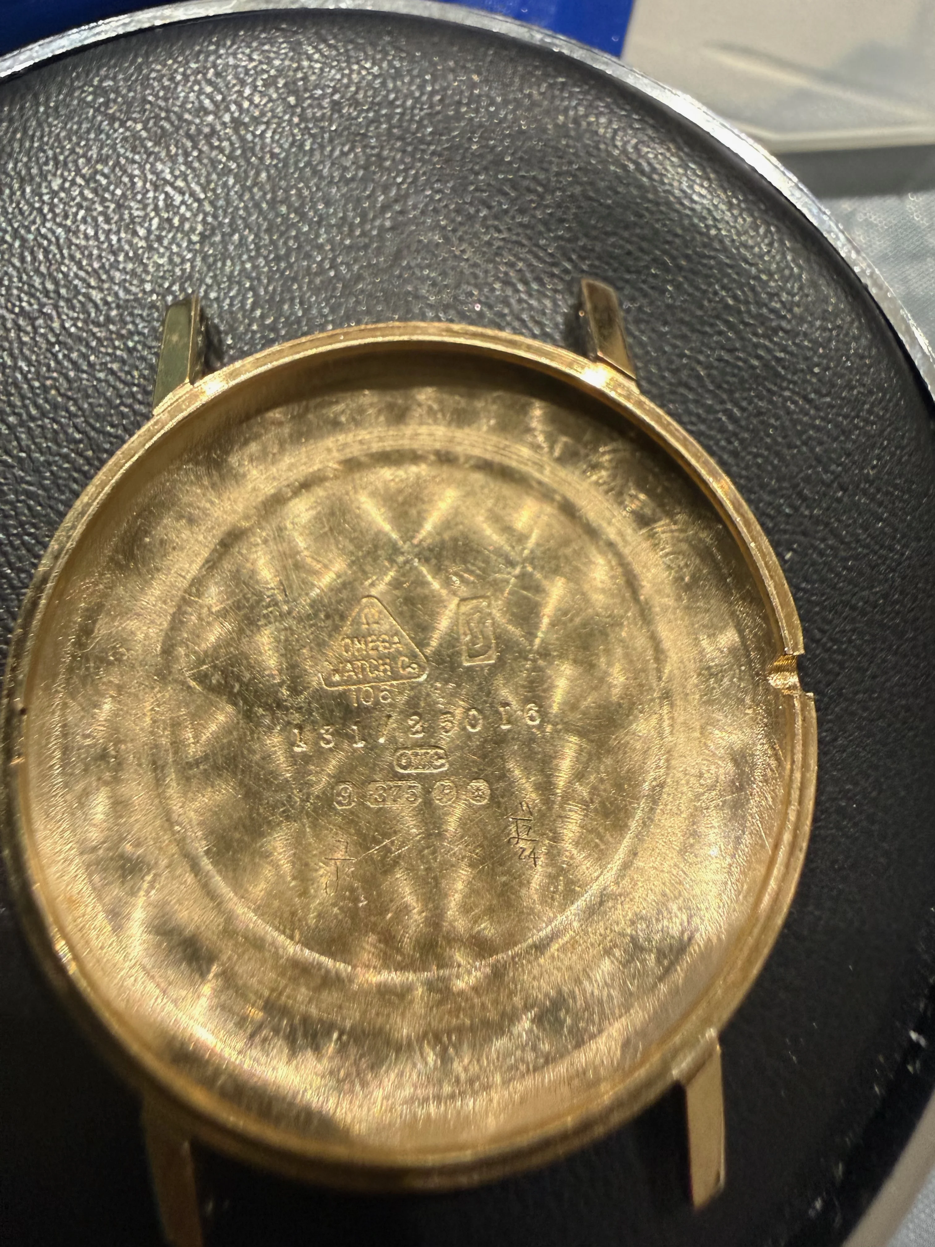

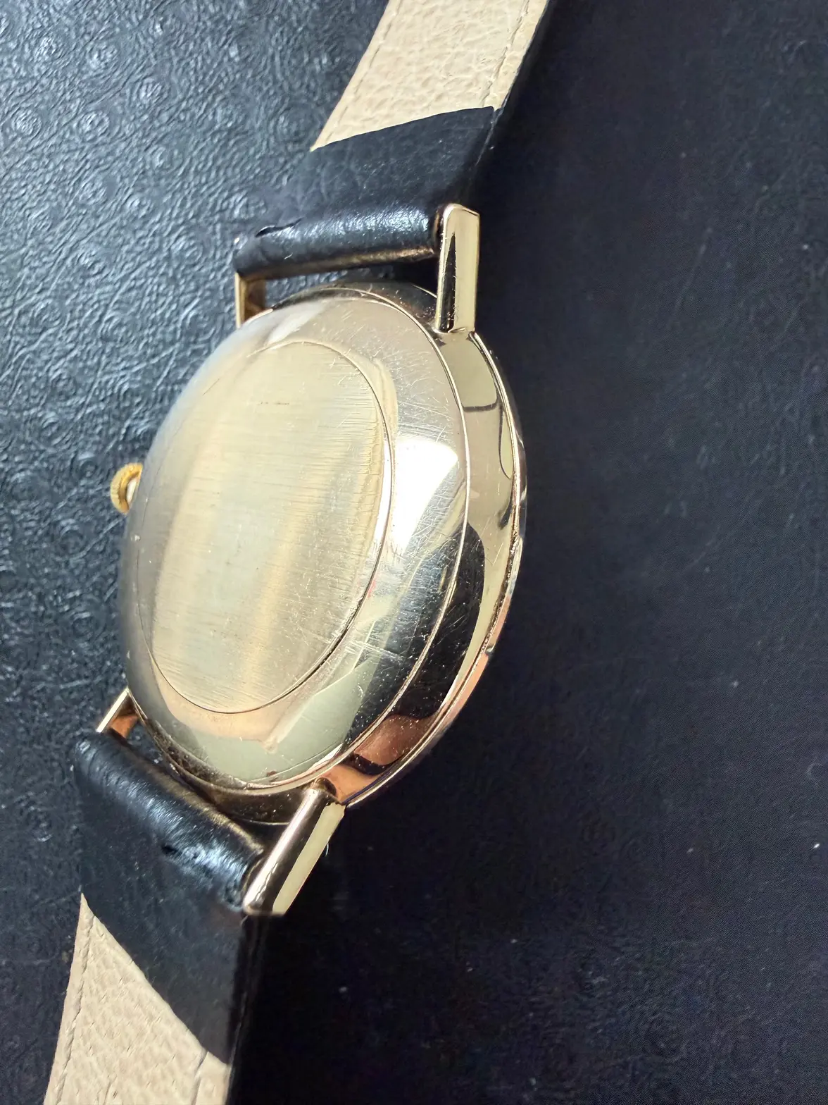

Hi all,
Acquired this vintage 9ct Geneve at auction. Based on image search I think it is a ref 131.5016. Am I right in thinking its a bezel and crystal off job to get at the movement? Any watchouts?
Crystal also has some scuffs so any help finding the correct replacement also appreciated.

Nice watch. There should be a slight .05cm gap in the circumference where the caseback joins the case. You can insert, carefully, a fine blade and twist.
Otherwise, take it to a watchmaker or jeweller and make sure you photograph the caseback and the movement, movement number and serial number.

This appears to be a one-piece case, so don't try to remove a case-back. Unless you really want to replace the crystal, there's no need. It can easily be polished.

Looks like there might be a notch between the bezel and the case in the second photo, where you can insert a case knife. I agree this looks like a front loader.
If you鈥檝e never done this before, I wouldn鈥檛 try with a gold watch as gold is softer and easier to scratch/dent.

Looks like it could be a UK case and these are front loaders.
In fact regardless as to where it was made it鈥檚 a front loader.

While the case shape makes me think it is a front-loader, I think it is ALSO a back removed case. See how the 'flat' changes on the 2nd ring (and the shape is different). I think this is a case back to remove clamps, then push out the front style watch.
So just taking off bezel/crystal won't let you get the movement out.

the movement comes out the front , Bezel is attached to the crystal and comes off as one,
Tool goes in opposite side to crown where it looks like it鈥檚 been removed before with the damage.
Once removed and the dial exposed
it'll be one of two.
They鈥檒l be a big circlip looking thing which turns a few centimetres up or down can鈥檛 remember which way that unlocks the movement and then the movement is rotated a small amount I believe this will have a split stem which will have to be removed FIRST
Or secondly
The movement is pressed in kinda and there is very little room to remove without damaging anything
I鈥檝e removed a few of these fiddly but be patient or get a professional watchmaker maker to do it
I have seen another thread which I helped a guy remove his, he used a very thin blade and worked around (evenly ) between the case and movement and it eventually popped out the stem and crown stays attached
I鈥檒l try and find the thread
