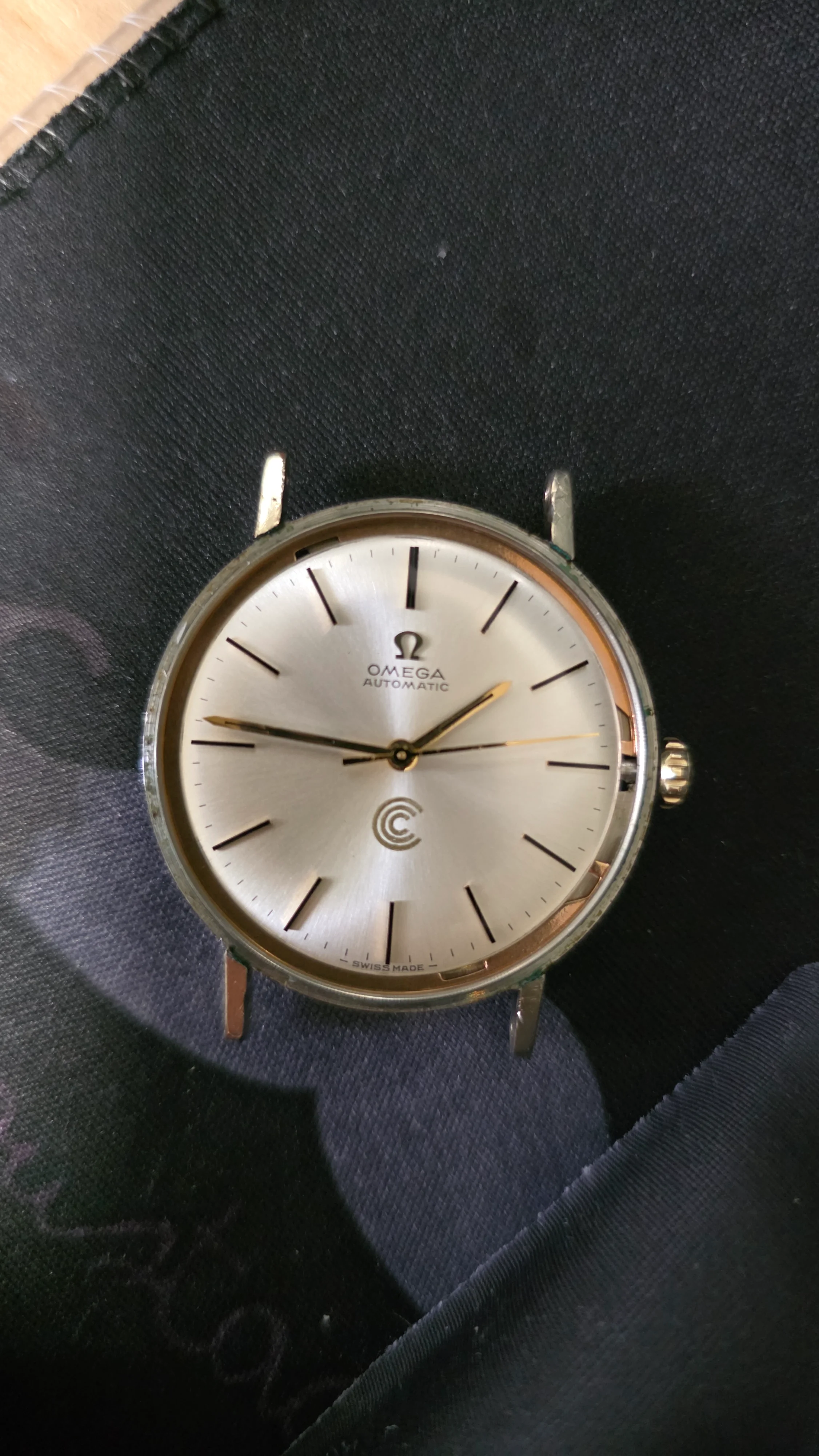

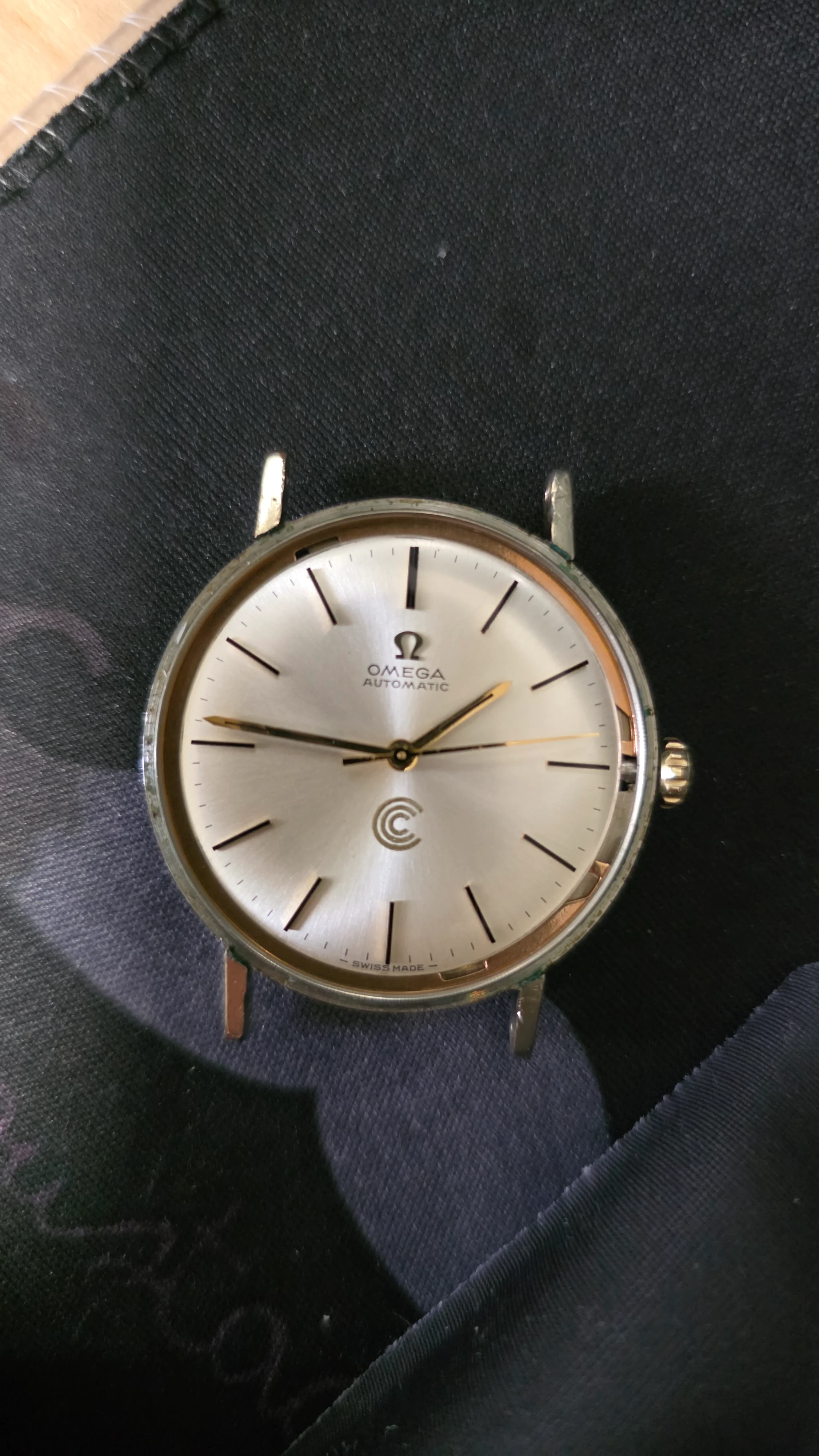

Sorry to thread jack and bring this old post but I have something similar. I picked this up a while ago and would like to see the movement inside. It has the almost the same configuration that it can only be open front the glass, but I have no idea after what to do. Any insight would be greatly appreciated.

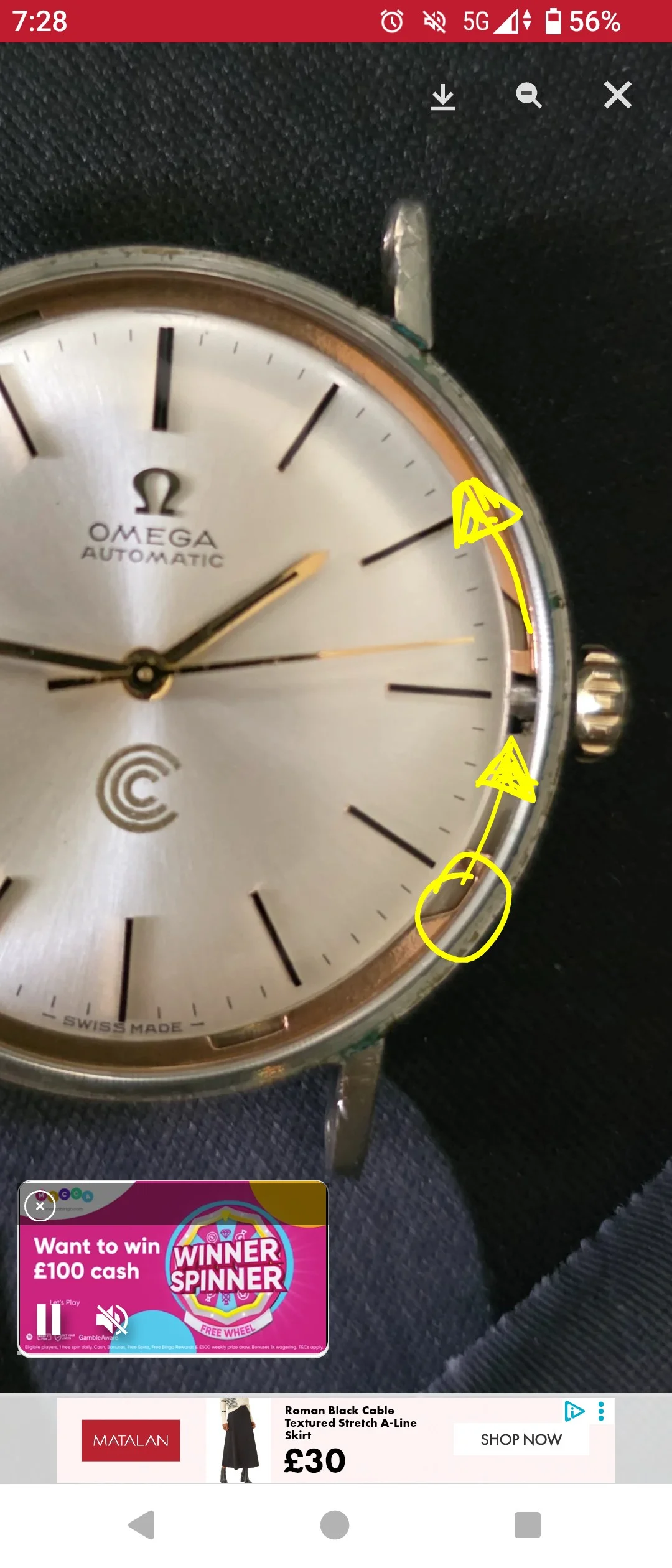

Similar, this has a split stem which the crown pulls off the the stem gently pull the crown out all the way and then pull some more and it'll come apart ( hold onto the movement and don't throw it across the room like I have done lol ) after the crown is off that brass part will rotate slide it up like the picture and the movement rotates I quarter turn I believe and it'll just fall out

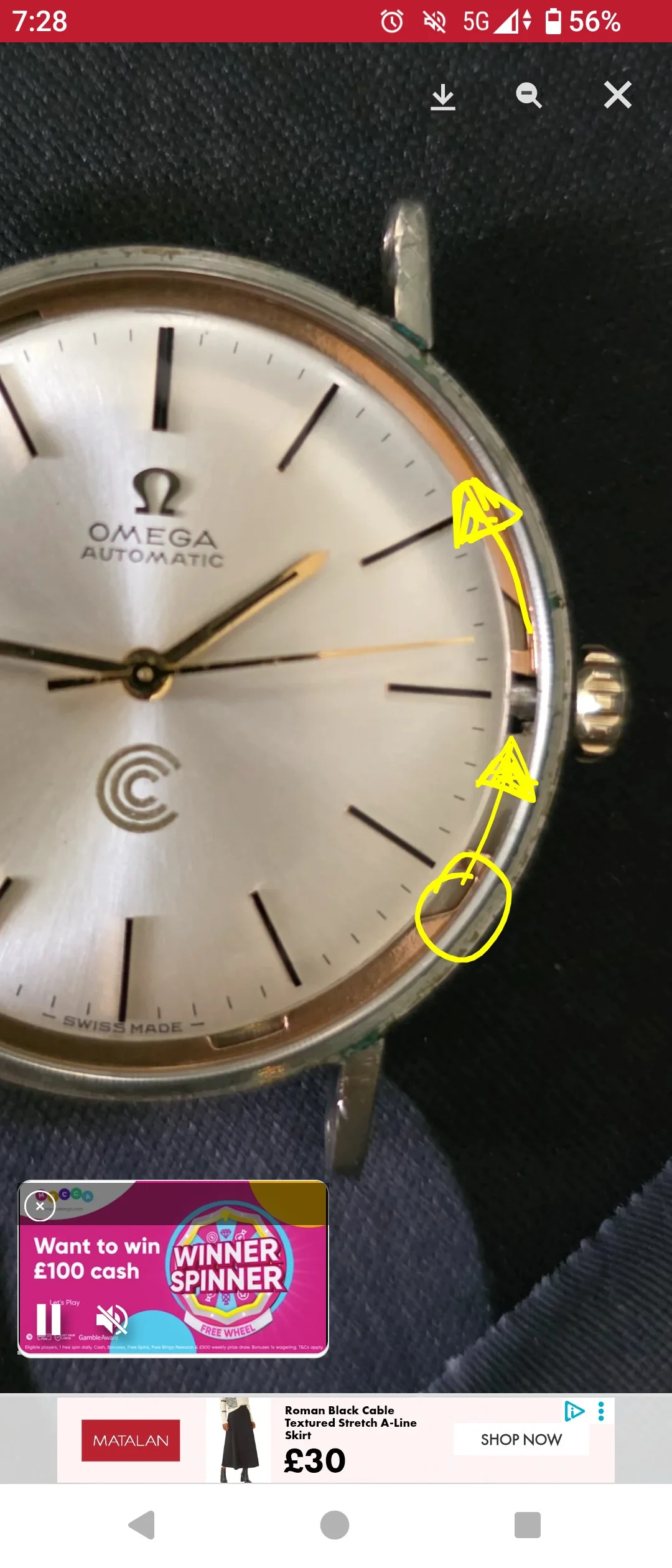

do i pull the stem after i rotate the brass part counter clockwise? i tried pulling the crown after rotating the brass as indicated in the photo but the crown didnt move at all.
It shouldn’t matter, but if the movement shifts so that the stem is not centered in the case tube it might bind.
