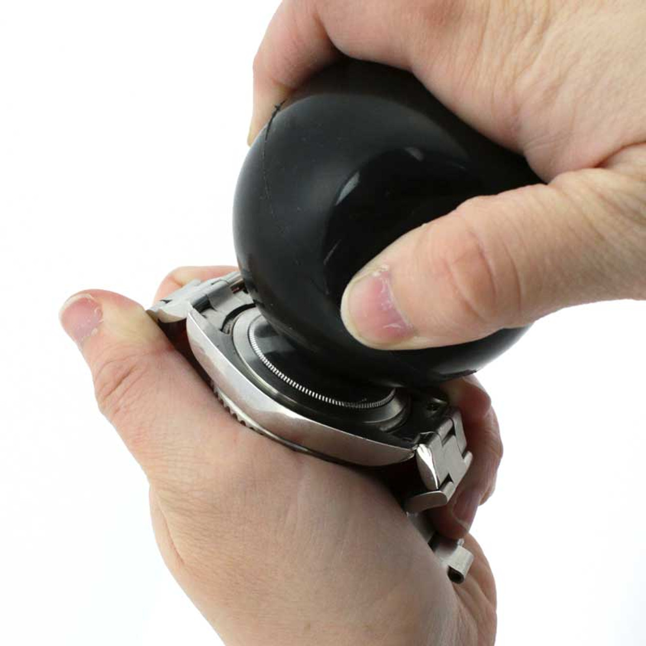

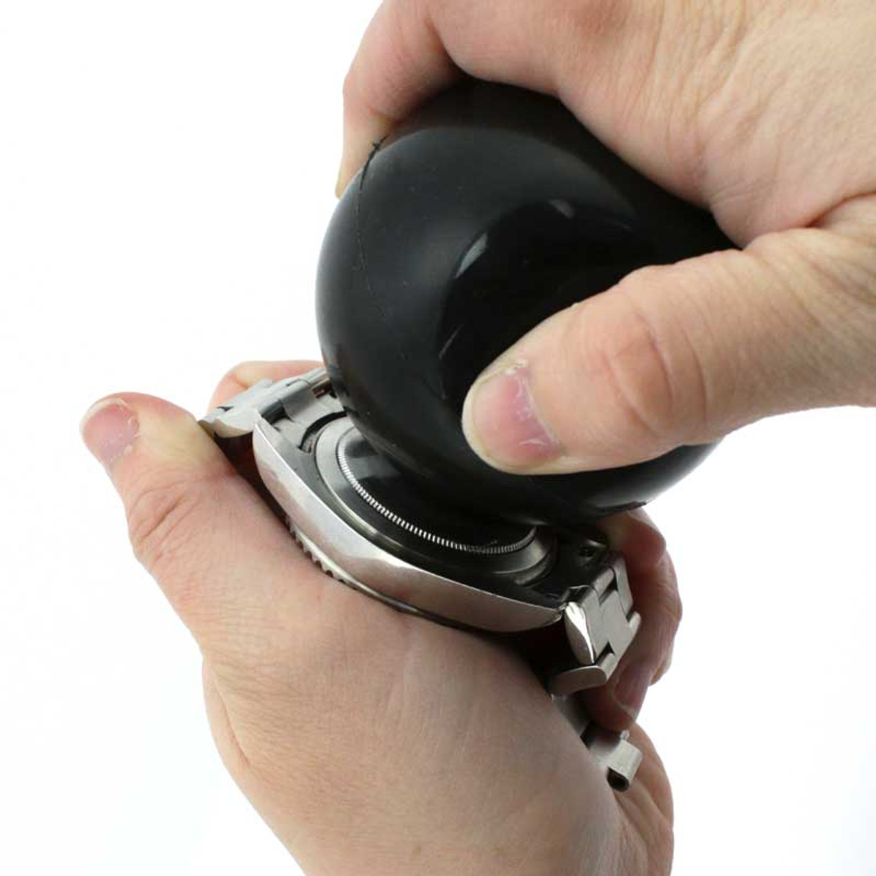

They sell conical rubber plugs to be used for removing lens elements in vintage lenses. I use them all the time. They are pretty inexpensive and come in various diameters, nested. They do allow considerable torque without fear of damaging anything. While they may not be useful for opening badly stuck screw in back, they are useful for less severely stuck backs.

The best case opener that will never leave a mark is Bergeon 8008.
True, but the Bergeon 8008 will also never open a correctly secured caseback.
It might, however, twist a gold Constellation medallion out of a steel case back. Which is something a regular opening tool would fail to “achieve”. Credit where credit’s due. 😁

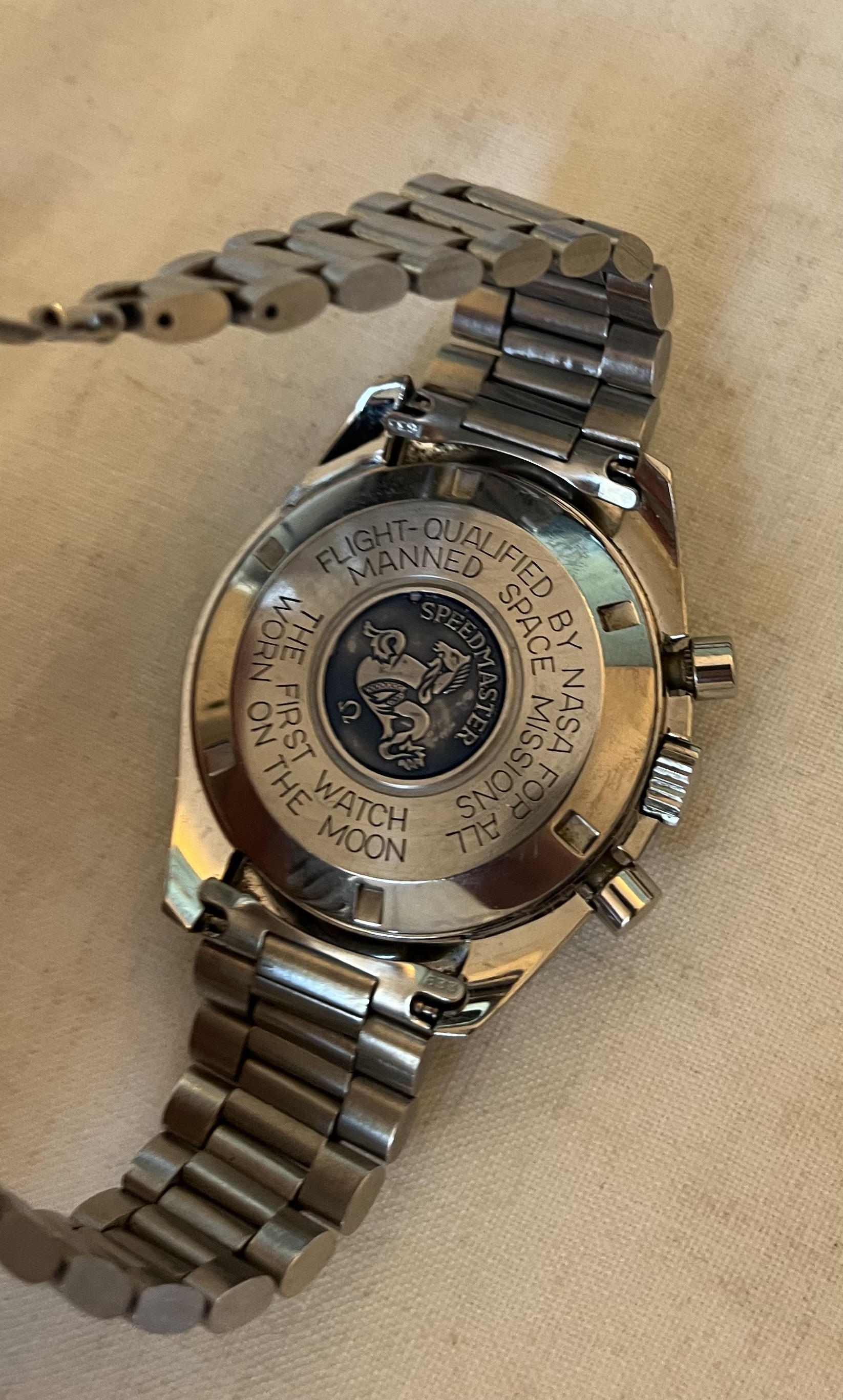

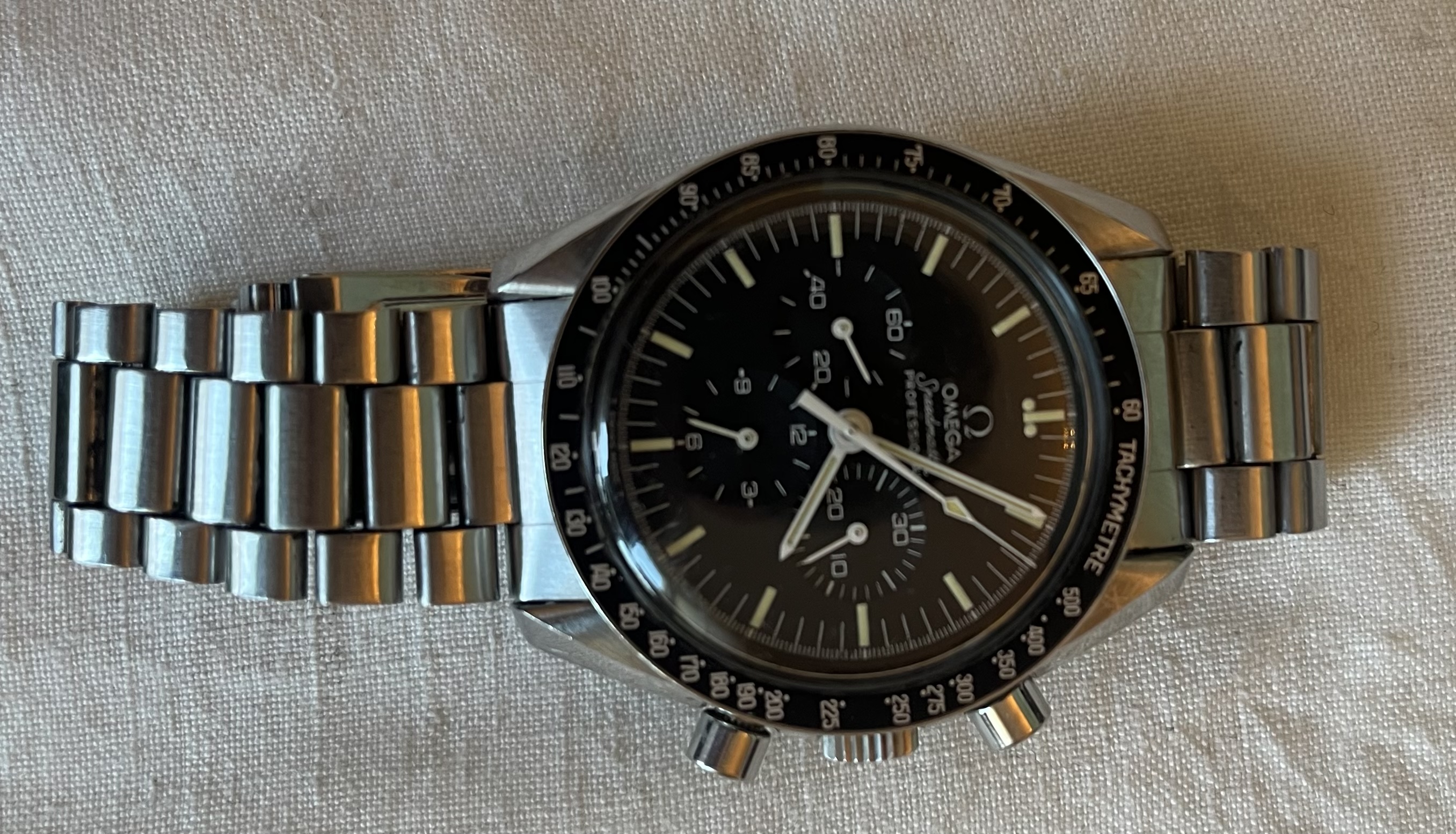

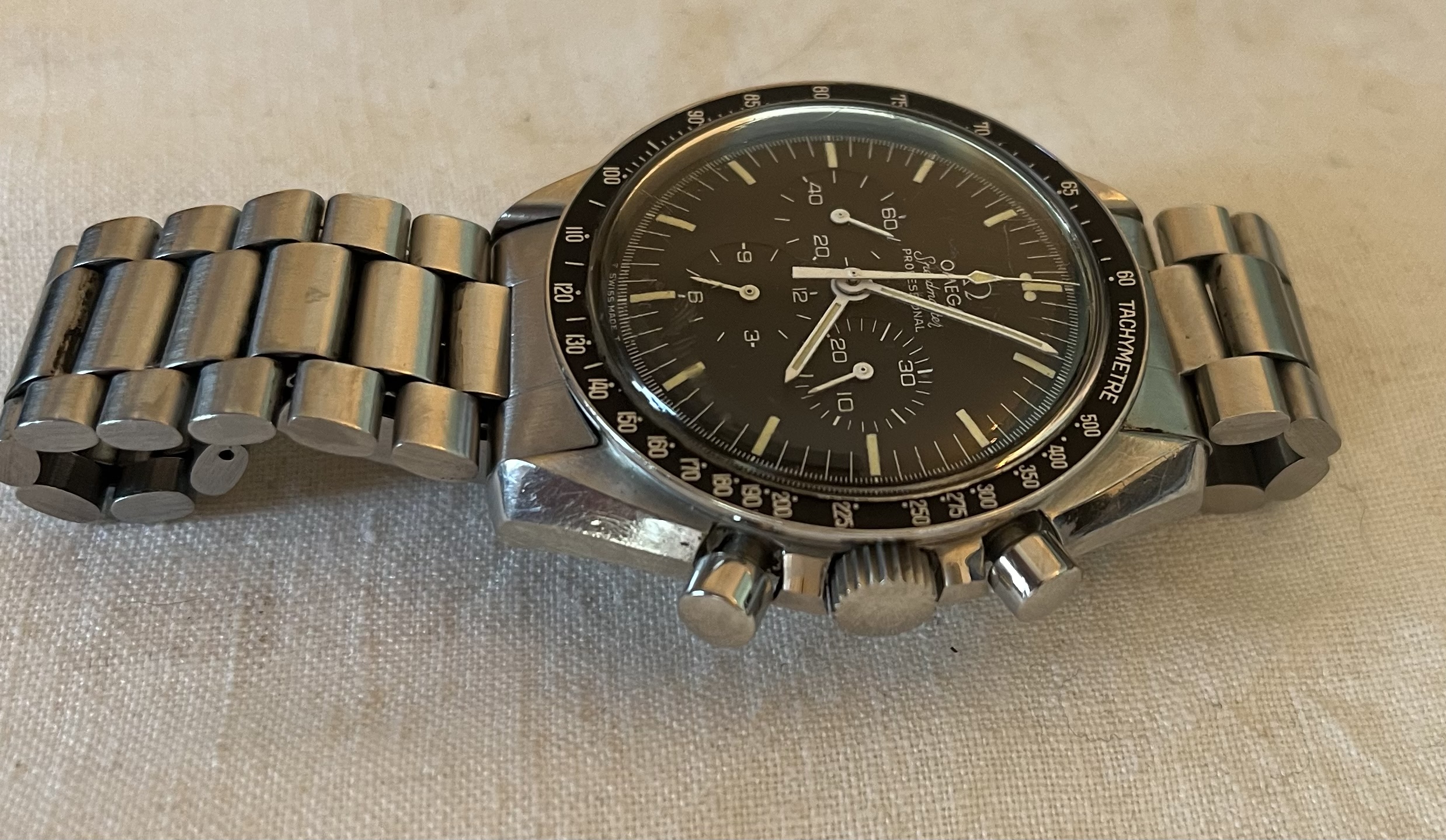

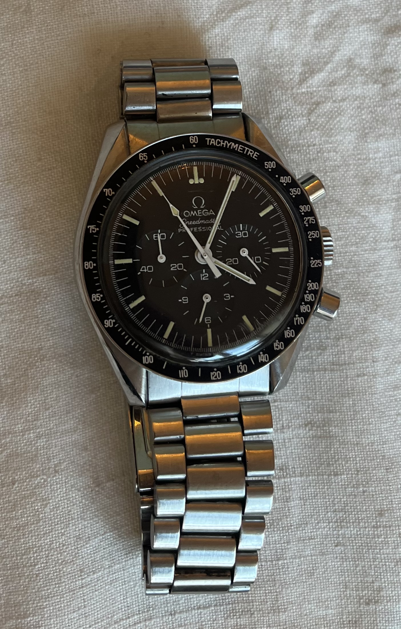

Hi, thank you for all advices. I will take the watch to a watchmaker. I have gently cleaned the watch but there is some weird blue color on the caseback. I Sony know how to get rid of it. Any tips how to get rid of it.
Can someone help me verify the model and estimate value so I know how careful I have to be with the watch. Thank you in advance

Another one for Pahawi, it works great without damage to the caseback.
Leave the blue stuff. It is original case protection and some collectors like it.
