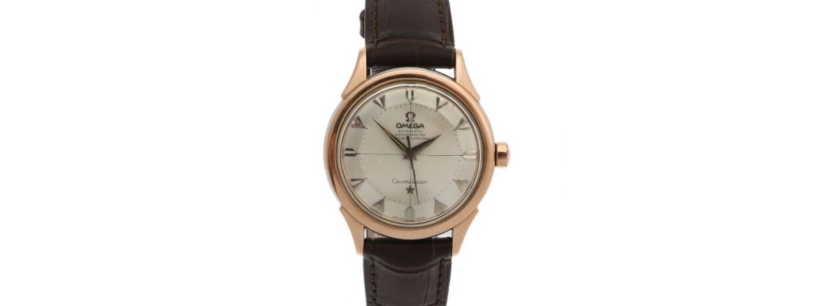

How much for a Constellation

With that much rust on the hands, probably a good idea to check out the movement first!
Weird that it says gold index.
From the list of verified connies it says:
501 /505 1956 KO 2852 Range of dials Gold-cap on stainless steel
I don't think there is a 502 cal for connies, I think seamasters have those.
Something doesn't match up.
This seems to be rose gold capped as well.
7,540
34,617
Doesn't look right to me with silver arrowheads/hands and a gold-cap case. I'd expect the markers/hands to match the case material. So for gold top the hands and markers match the gold colour. Cal 502 is a non-chronometer calendar movement so I'm assuming that's a typo....
As to value...value it for parts only
12,775
17,341
Looks like a frankenwatch to me.
If you have one with a steel case that needs a dial, that part looks very nice.
The pink gold capped case is nice also.
Cal. 502 movement is incorrect for this model.

Thank you very, very much, everyone. Yes, I was also apprehensive about the silver indices and the Rose gold bezel. I think you are right, it is indeed a franken. Moving on...
