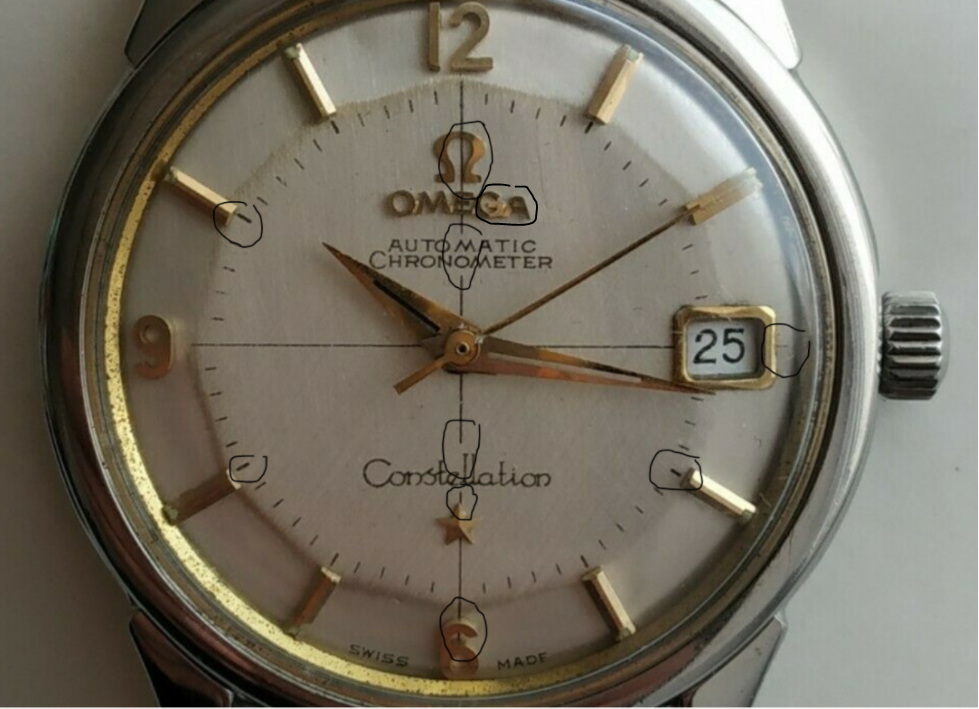

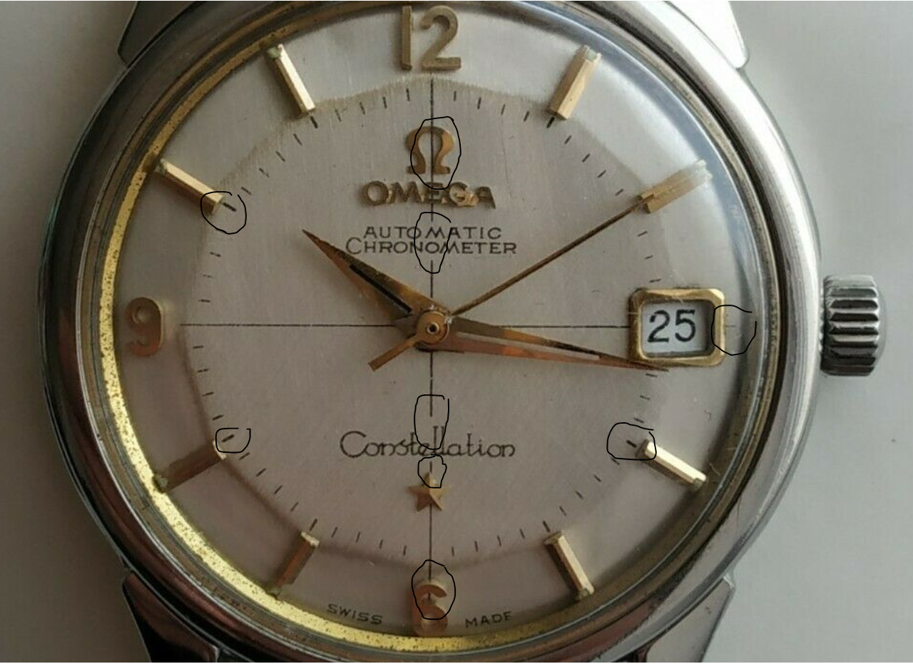

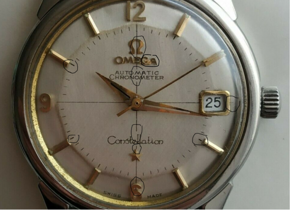

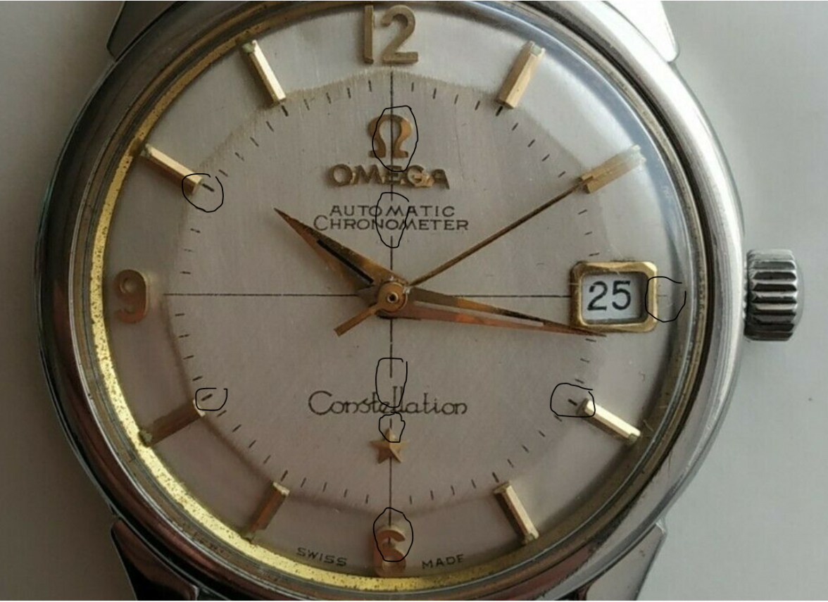

Posts 1,546 Likes 3,357 Engee ·Aug 13, 2020 OMEGA is wonky, like it's slipping down hill. Think this may be the same watch I posted in bad redials the other day.
Posts 414 Likes 551 Mr.Bliss ·Aug 13, 2020 Engee OMEGA is wonky, like it's slipping down hill. Think this may be the same watch I posted in bad redials the other day. Added..
Posts 2,012 Likes 3,409 rob#1 ·Aug 13, 2020 Also, not dial-related, but the second hand should end before the indices, not overlap them. And the minute hand should almost touch the minute markers, not go past them. OK, so maybe dial-related then 😉
Posts 334 Likes 247 OmegaRody ·Aug 13, 2020 Dont know if the Chronometer C had to be same sized as the other letters of the word.
Posts 10,123 Likes 57,923 gbesq ·Aug 13, 2020 YIKES. 😲 But not to worry because the seller says that it will all buff out . . . Edited: Aug 13, 2020
Posts 2,298 Likes 3,157 Passover ·Aug 13, 2020 Crosshair lines should be thinner than the minute markers, I don't know if you already tried to say that with one of your circles
