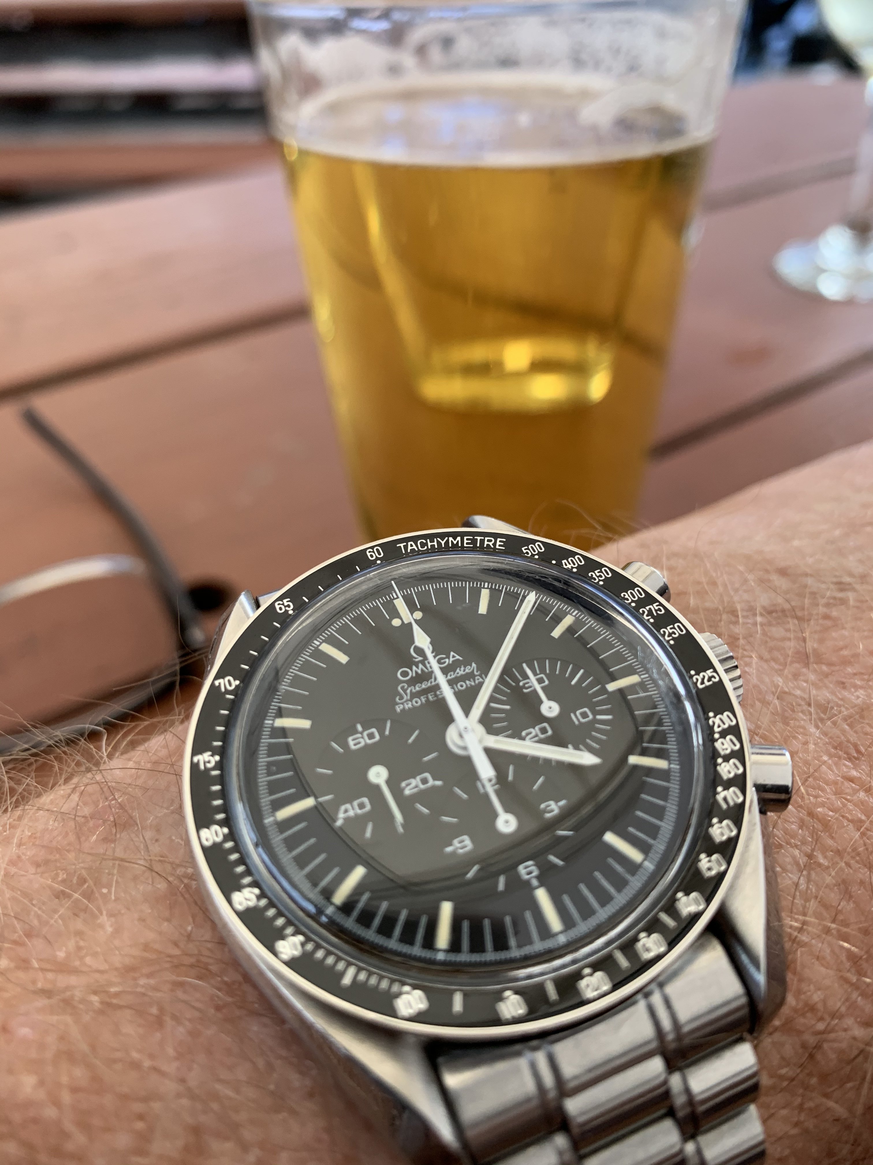

1991 Omega Speedmaster 145.0022 at 24 hours plus so far. Will update further when it stops. This is like watching water boil
2,840
14,971
1991 Speedmaster 145.0022 up to 47 hours on a full wind. What a beast it is.
I did not know having a thread about winding a watch could be so interesting.
I have also determined I must lead a boring life if I give shit how long a wind lasts.
My bezel does look pretty good.
This is all very exciting. After careful investigation, I find the 1991 Speedmaster has a 52 hour power reserve.
