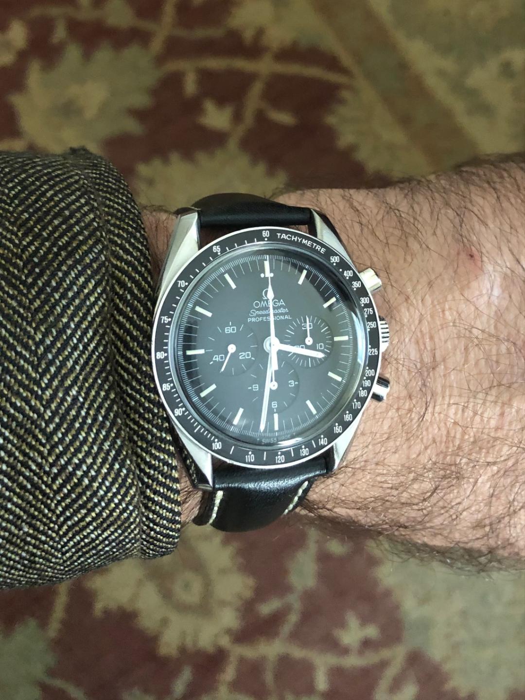

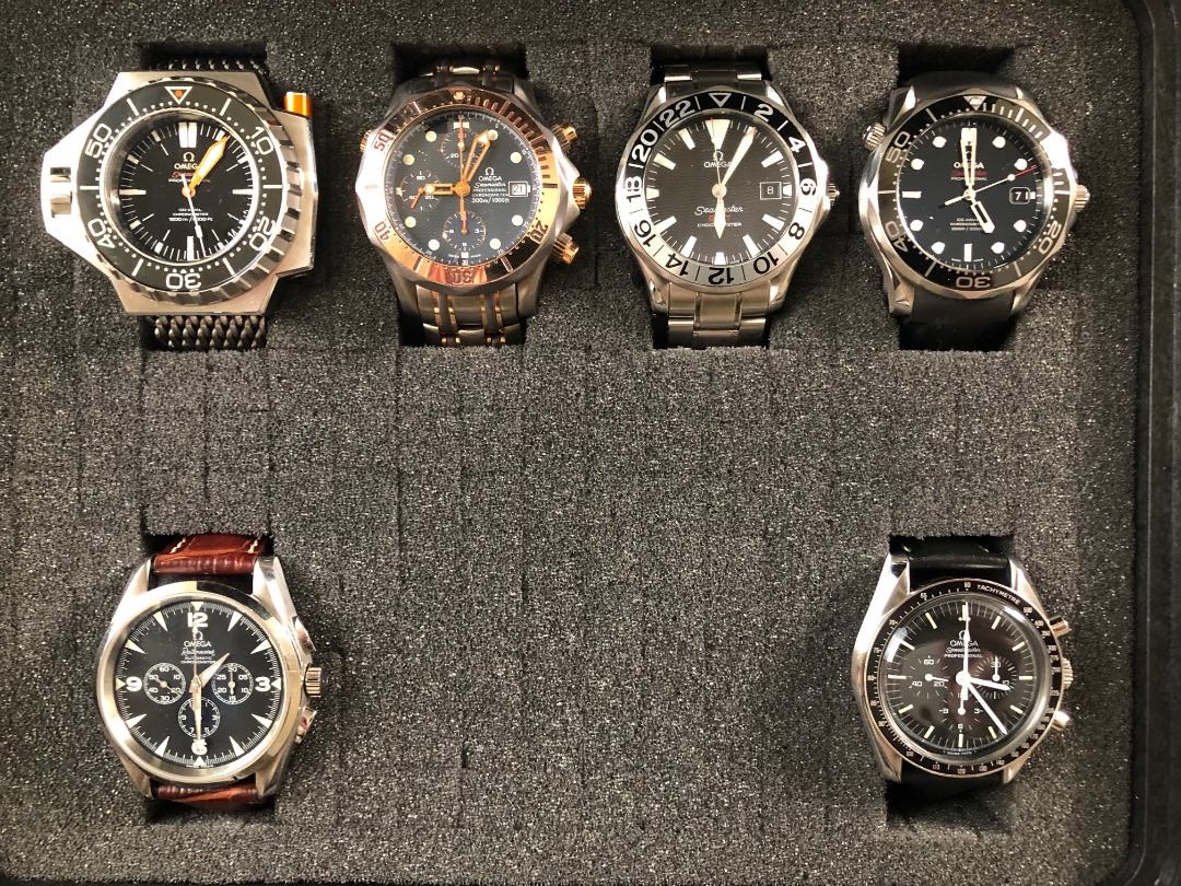

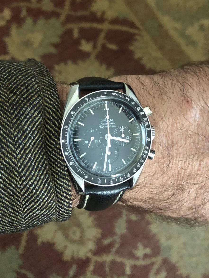

After posting my current wait time for service, I got an email later that day letting me know the watch was repaired and was sent from the motherland to Secaucus and was en route to me. Four months to the day. My 3590.50 got an all expense paid round trip to Europe. Nice to have it back with its siblings.
Putting the band back together.
