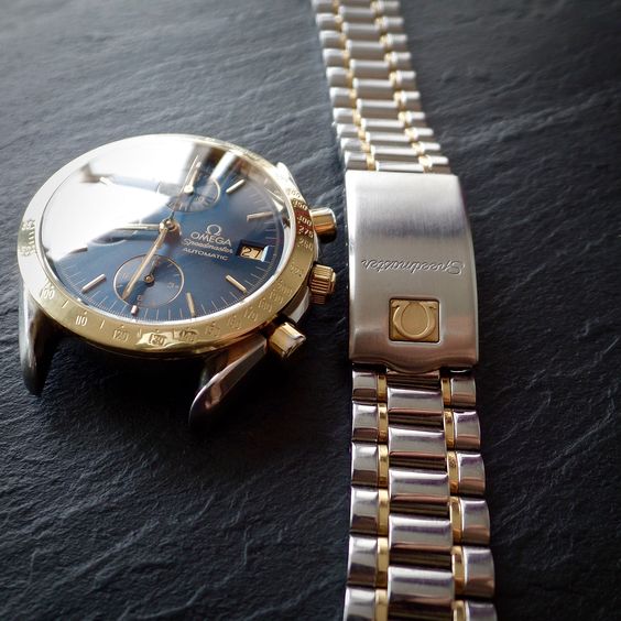

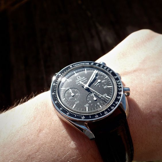

    I dunno man some of the earlier rarer or just more interesting reduced are becoming very collectible! the white dial and the early black particularly... there is also the ultra rare all steel white dial on the 1042 style strap... japanese racers i think the reduced are the next little bubble
    Here have some pics of some speedy reduced!

    The early black tritium reduced models are not even remotely rare, they were made in enormous numbers over many years, and they pumped out more "LE" reduced models than most people could count including the white two tone and the various pandas.
    Also half of those watches in those photos are not Speedmaster reduced watches at all, they're Speedmaster Date and Speedmaster MK40, a totally different model of watch.
