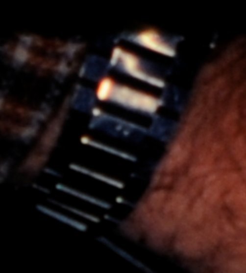

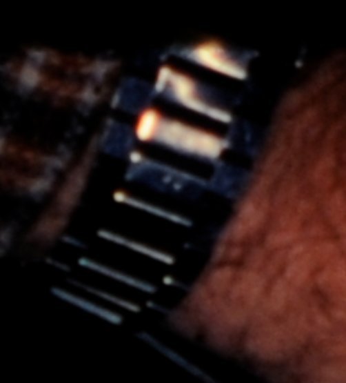

Finding a correct bracelet is part of a journey to restore the watch to originality. I have fuzzy pictures of the original bracelet, see https://omegaforums.net/threads/which-moonwatch-bracelet-is-this.155479/
There is no consensus, but I am leaning towards the original being a 1039. Feel free to weigh in on that thread.

This photo makes me think it was a 1039:
1039s have a habit of developing a little bit of flex on the center links. I think you can see some of that in this photo form the way the light hits and bounces off of the link. 1175s are thicker and don't usually have that. Plus the center brushing.
The appearance of the brushed and polished links in this photo made me think it was a 1039. Interesting observation on the center link flex you had.
