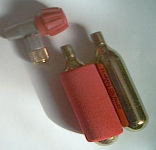

Careful with the syringe method. I used to collect Omega Dynamics and Cosmics. I had that method damage a few dials. I eventually just bought the right tool and it's night and day better.
1,978
2,138
IMO, the "Tool 10X" crystal lifts are straight magic. They are designed 100x better than any other crystal lift. One thing they do that others don't: They do a slight compress, THEN 'press' against the case as you tighten it further, so it 'pulls' the crystal out. Traditional crystal lifts tend to break crystals since they are constantly 1-milli-milli-meter from over-compressing it, so there is a 'touch' component with getting them right.
I've got 2 sizes now (102, and 105 IIRC), and they are among my best purchases.
17,934
37,503
Funny you should mention that............
