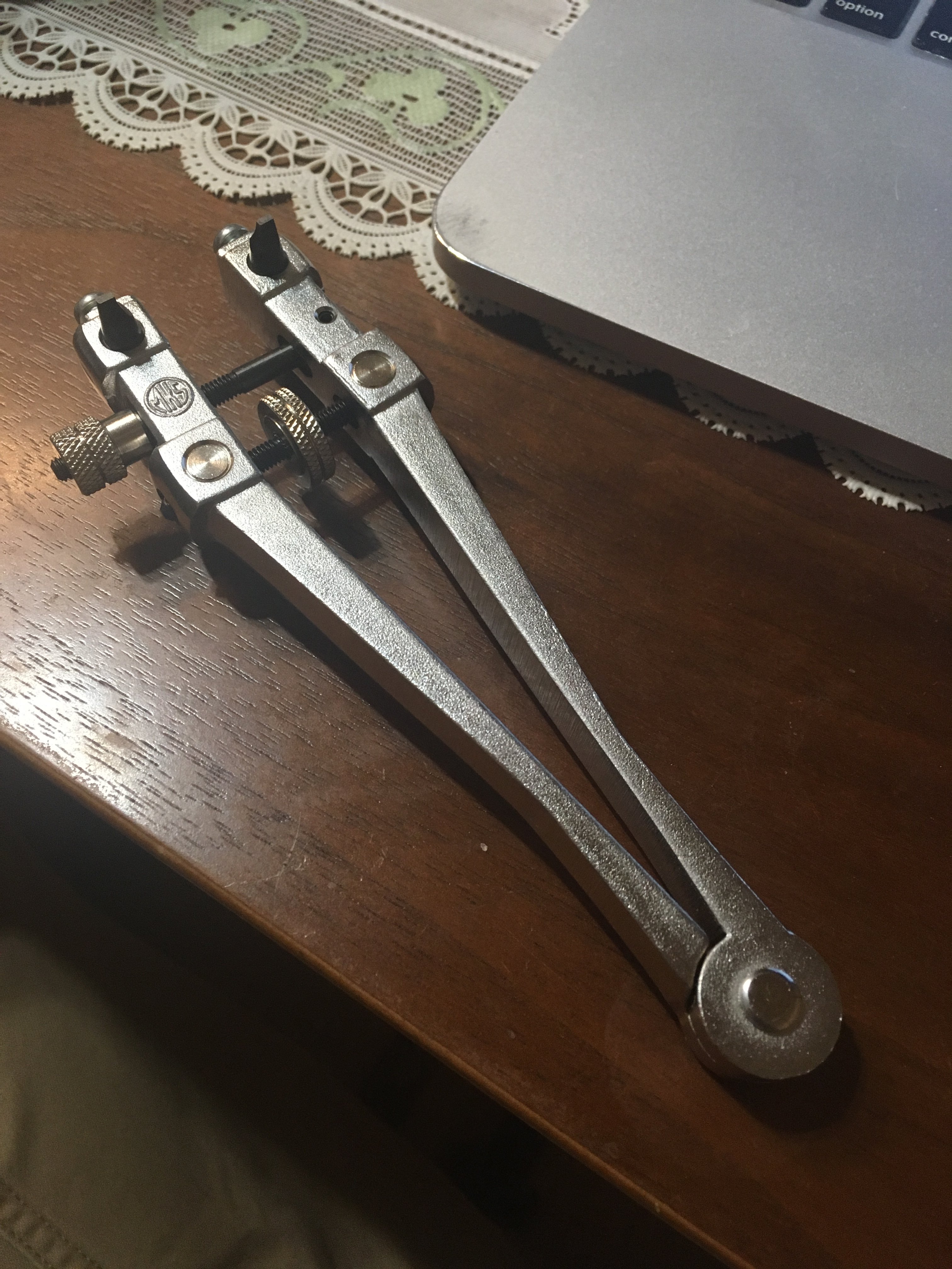

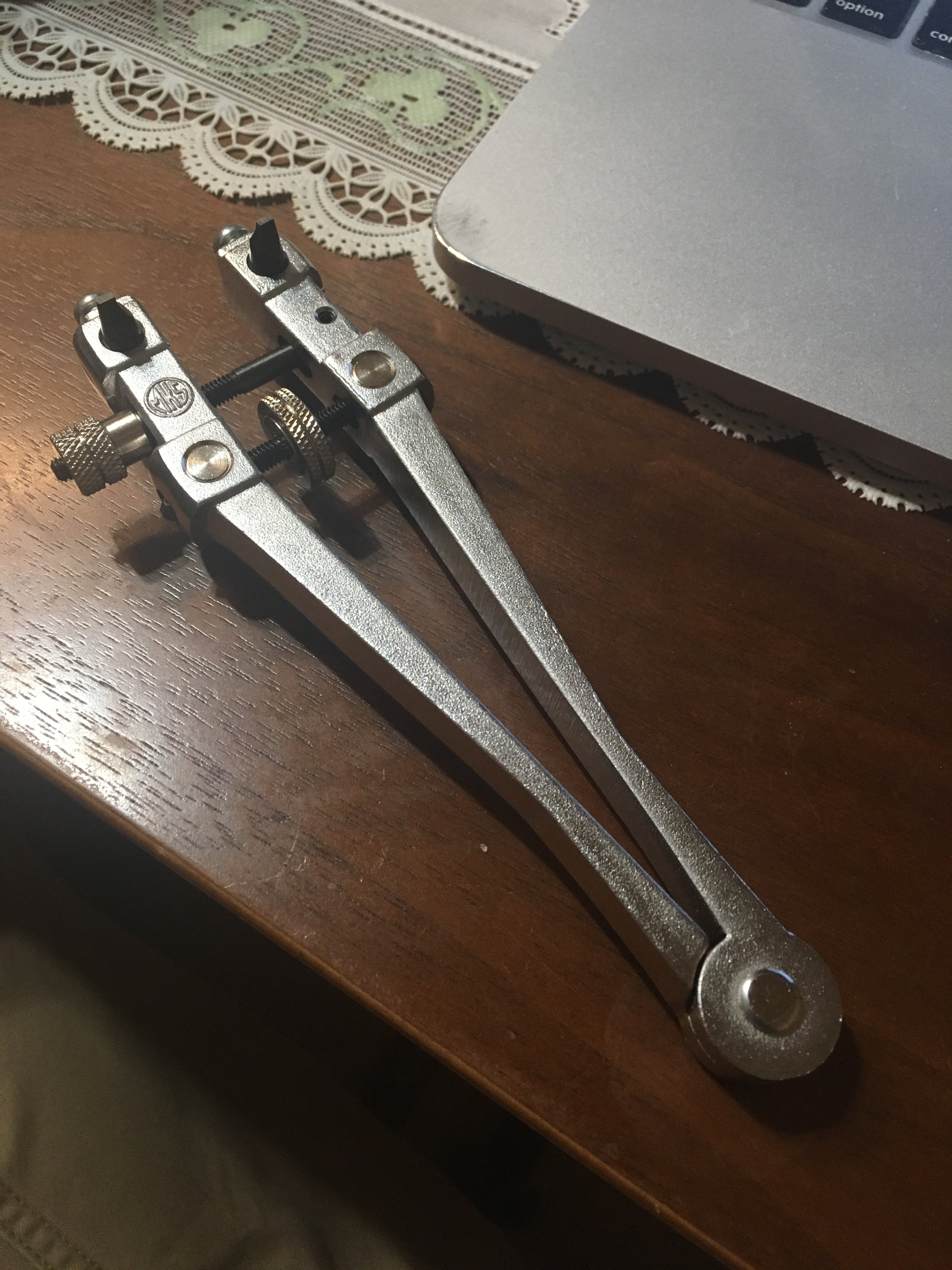

I got a cheapo three-pronged case wrench that probably wasn't much better than taking a pair of pliers to my watches. The tool I use now is this proper Meikosha two-prong device that's also optimal for messing up any table you place it upon.
