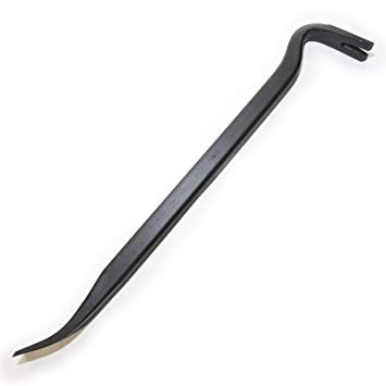

Yes, I always use this great tool. No I bought proper tools at cousins.uk, I just wouldn't take the cheapest options as those often break and damage your Watch.
61m7oml1wtl-_sy355_-jpg.858567
Hey. When I moved into this house there was one of those tools in the workshop. I guess the guy who lived here before me was a watch maker. I'll give that a go. I guess I just need to clamp the case good and tight in the vice and give it a sideways whack with that thing. Happy days.
